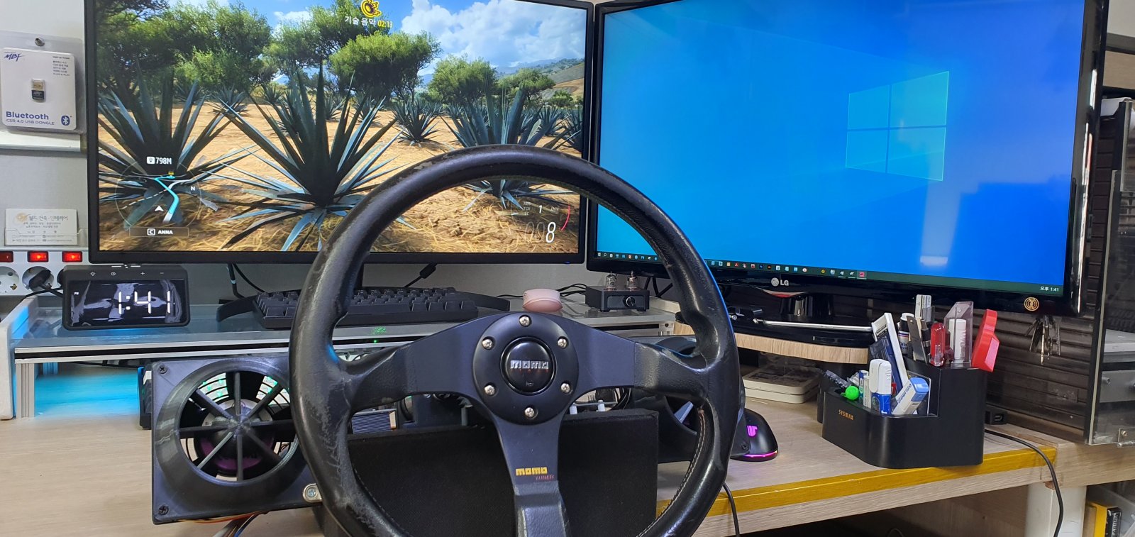

    Arduino and motor driver connection
    3D phase after the player to connect the variable resistor connection parts
    SMC3 test

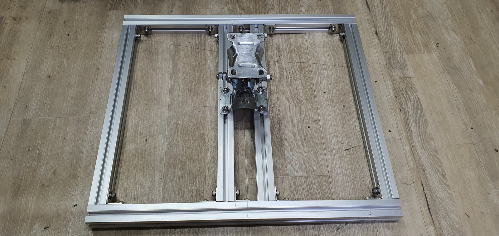

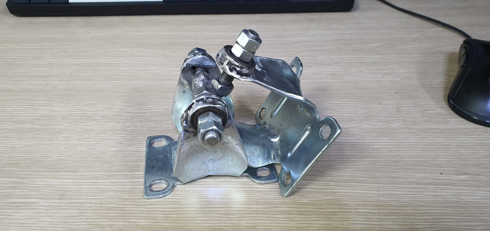

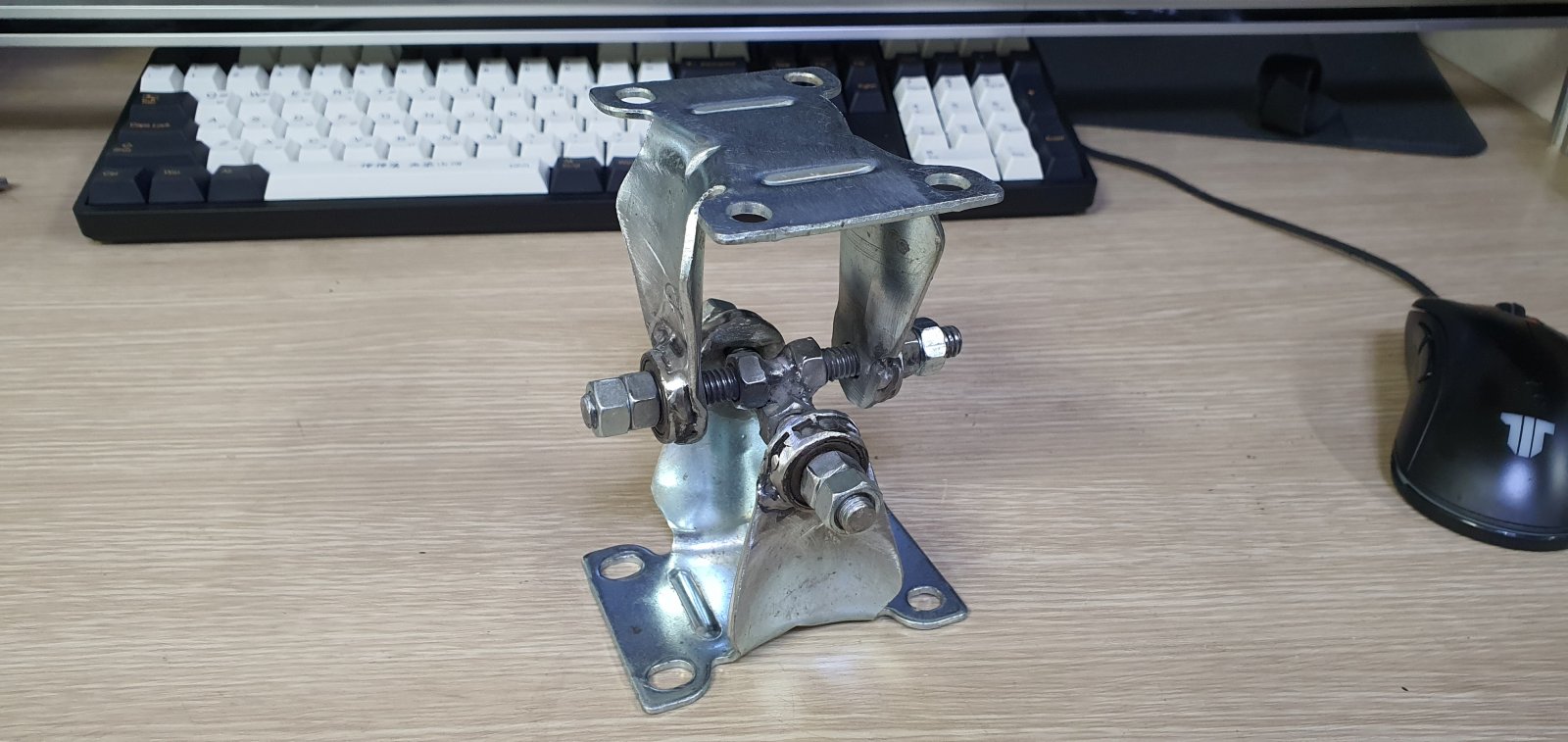

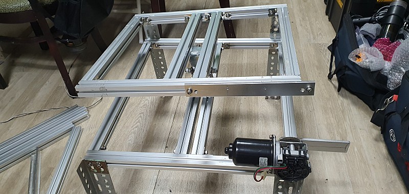

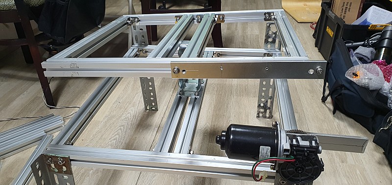

    2023 06 13
    0623 U-joint DIY
    30x30 aluminum profile frame

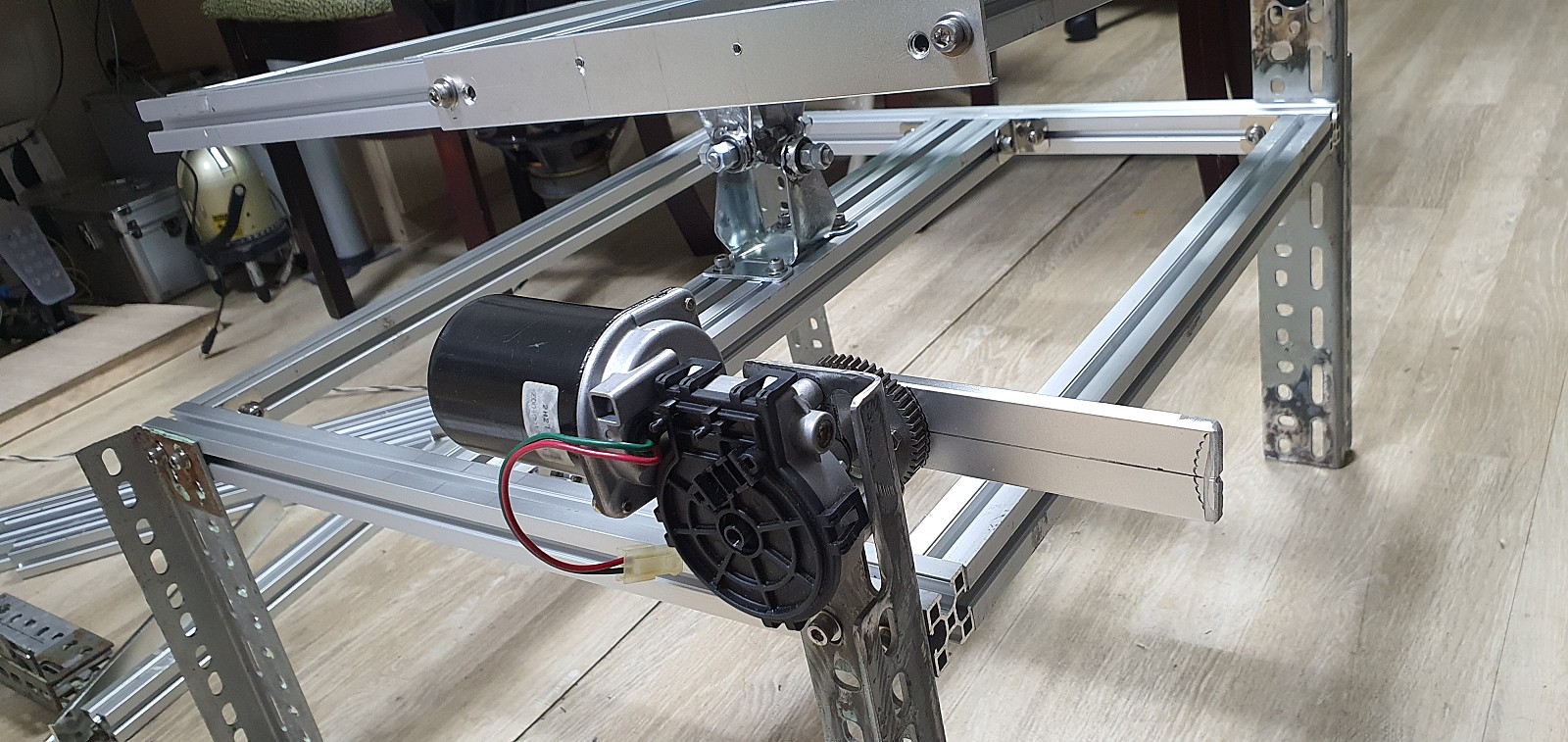

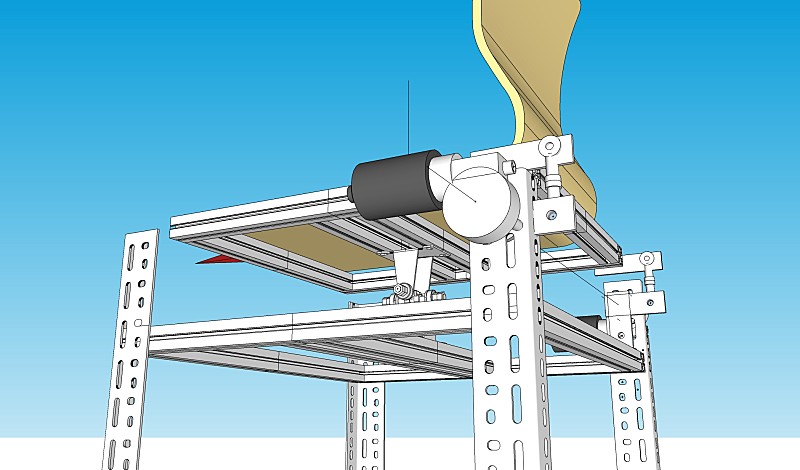

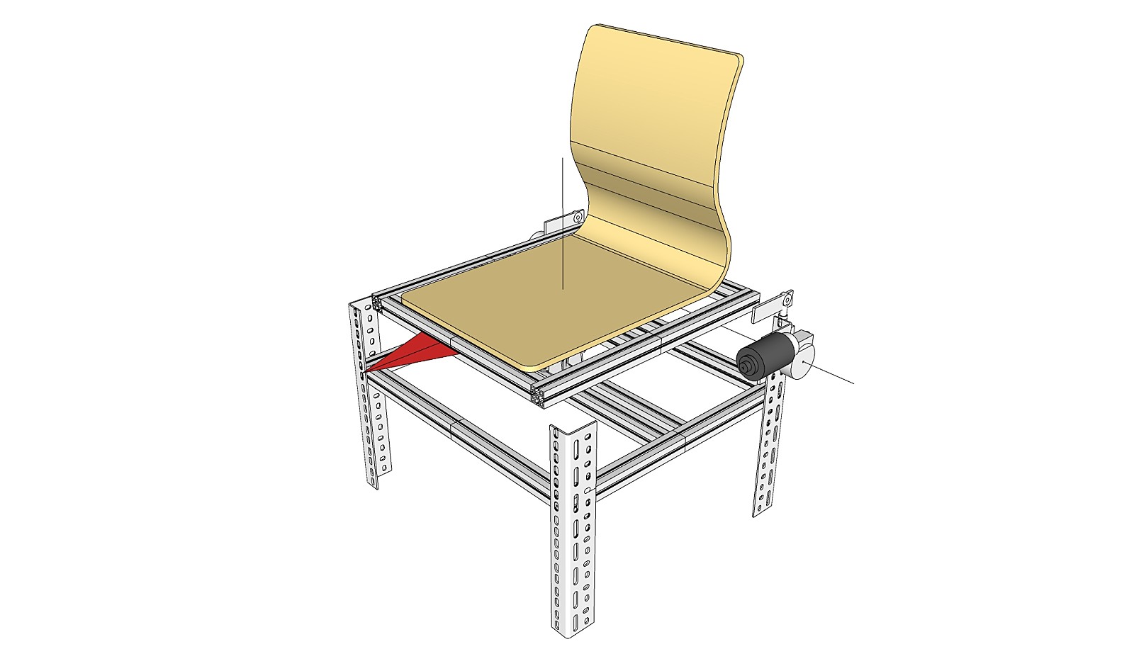

    2023 06 14
    Today, following yesterday, I completed the frame and made a bracket for fixing the motor.
    In order to make the most of the materials we have, we are designing and proceeding with sketch-up in advance.

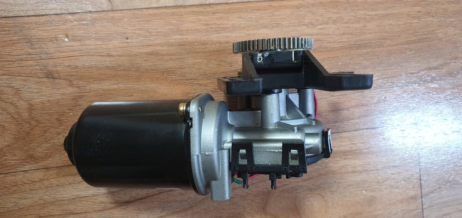

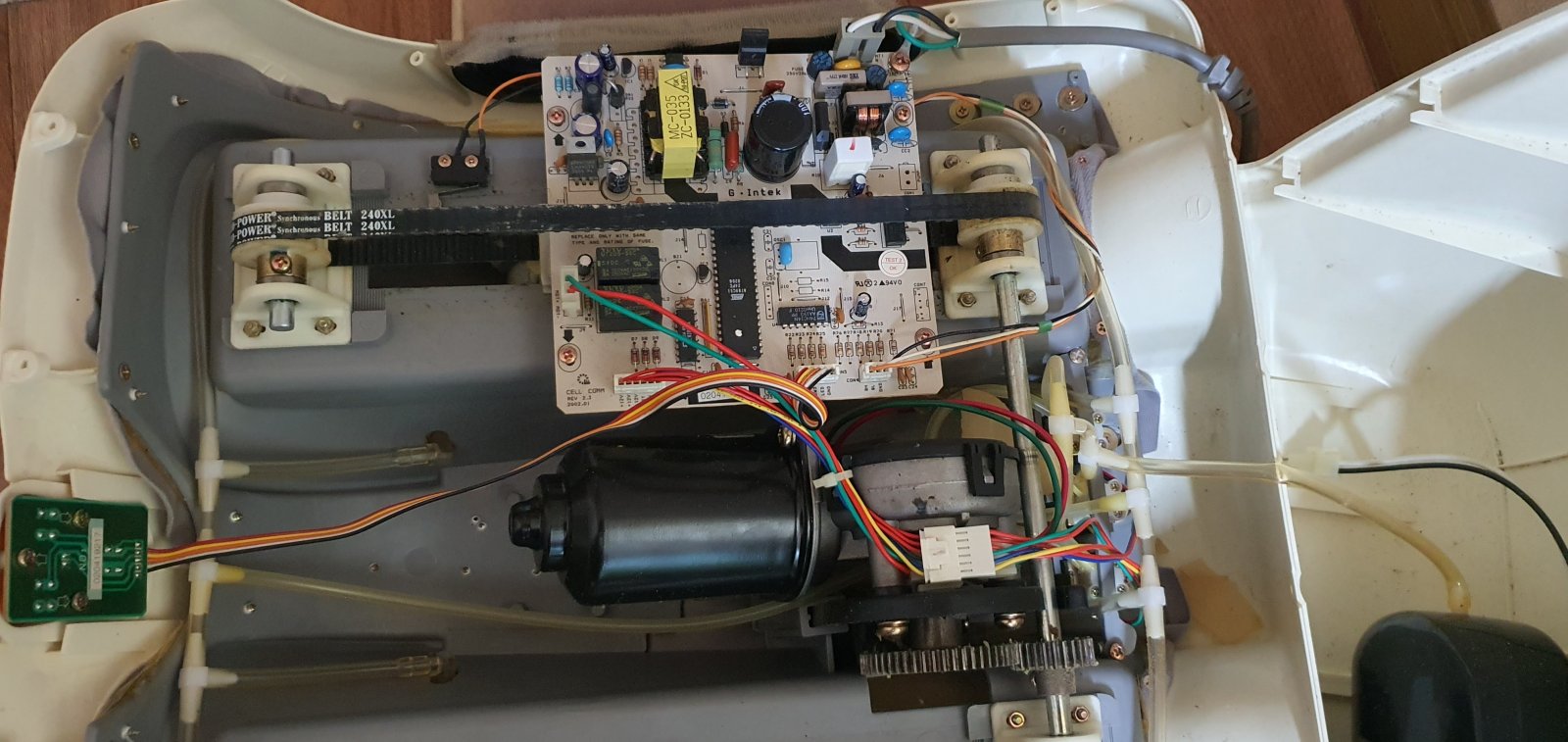

    One of the motors is broken, so to obtain the same motor, disassemble one of the products, and then accumulate the motor
    It takes some time to remove almost all accessories to remove all accessories.

    Motor rotation shaft to end rod bearing connection
    Replace one failed motor

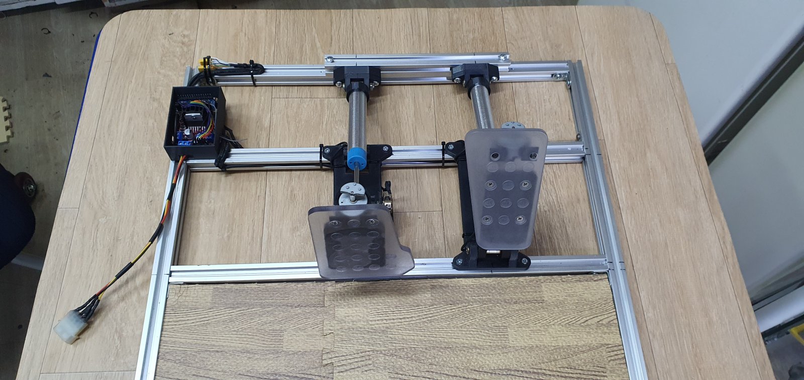

  14. art031515
    art031515 New Member
    Jun 7, 2023
    26
    161Coins
    +16 / 0 / -0
    I've done so many LFS demo versions that I don't even want to think about it anymore, so I hope it becomes a month soon and I apply for a DIY license.

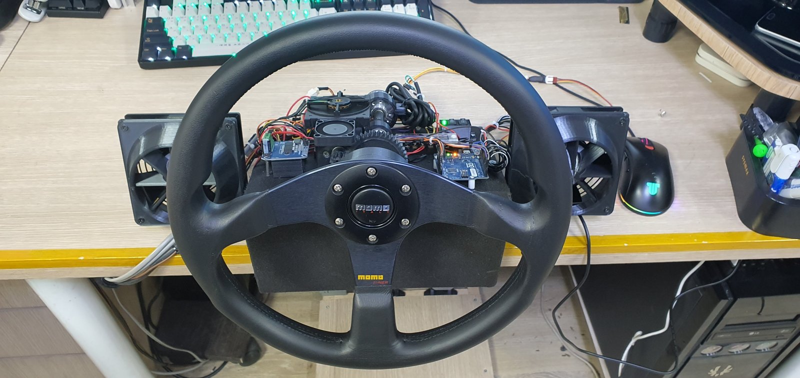

    0626
    Output the motor bracket to the 3D printer
    Add one more motor on the handle
    120mm fan for motor and gear heat dissipation

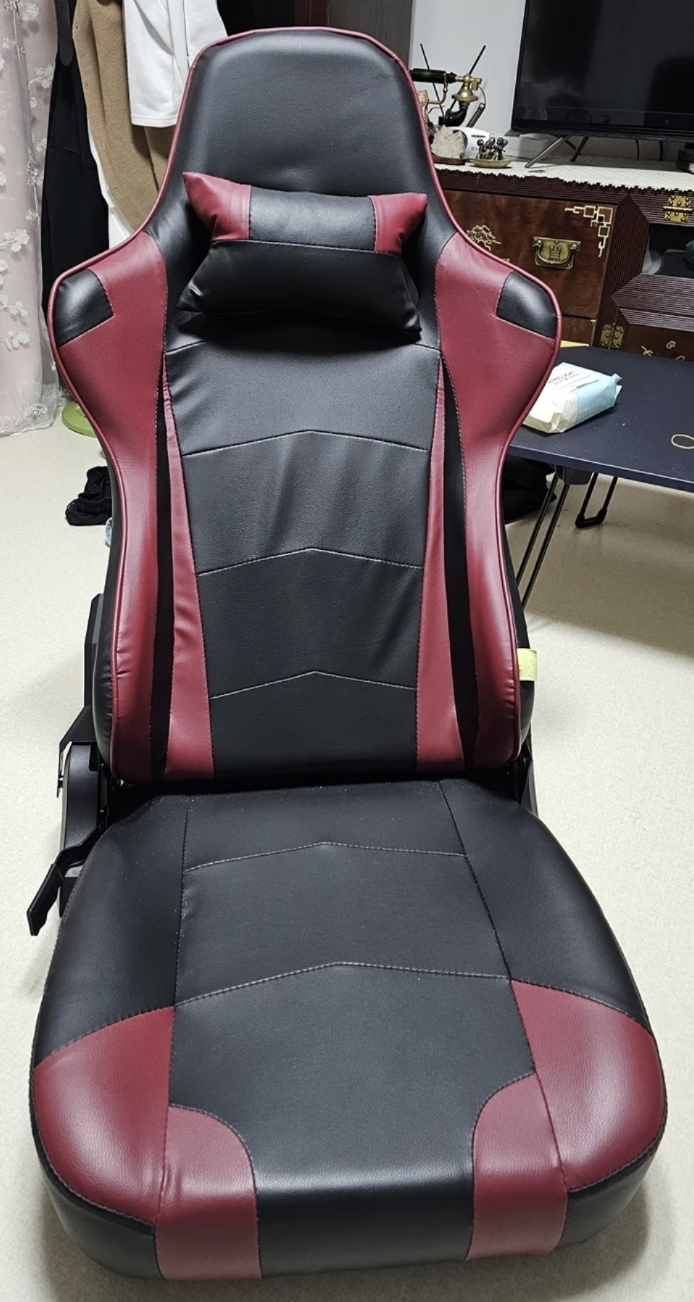

  20. art031515
    Jun 7, 2023
    26
    161Coins
    +16 / 0 / -0
    Separate the sheet from the frame
    Seat Combination
