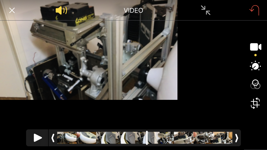

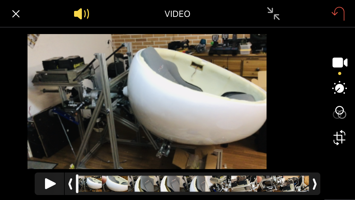

    Hello community,
    I would like to share my build with you. It is a unconventional setup (don’t know what was driving me when i started ) but now it’s getting to a stage I think it is worth showing. Main sim will be DCS.
    The main idea was to use as much of equipment I had already at home. But as you probably all experienced , I spent much more for getting everything to work
    I use 2x Wheel chair motors for each axis in combination with 2 Sabertooth 2x60 with Kangaroo X2 and Quadrature Encoders. Two 12V/50ah batteries to supply the 24VCD. I may add a 24v PSU in parallel if necessary later on.
    i would appreciate your feedback and suggestions
