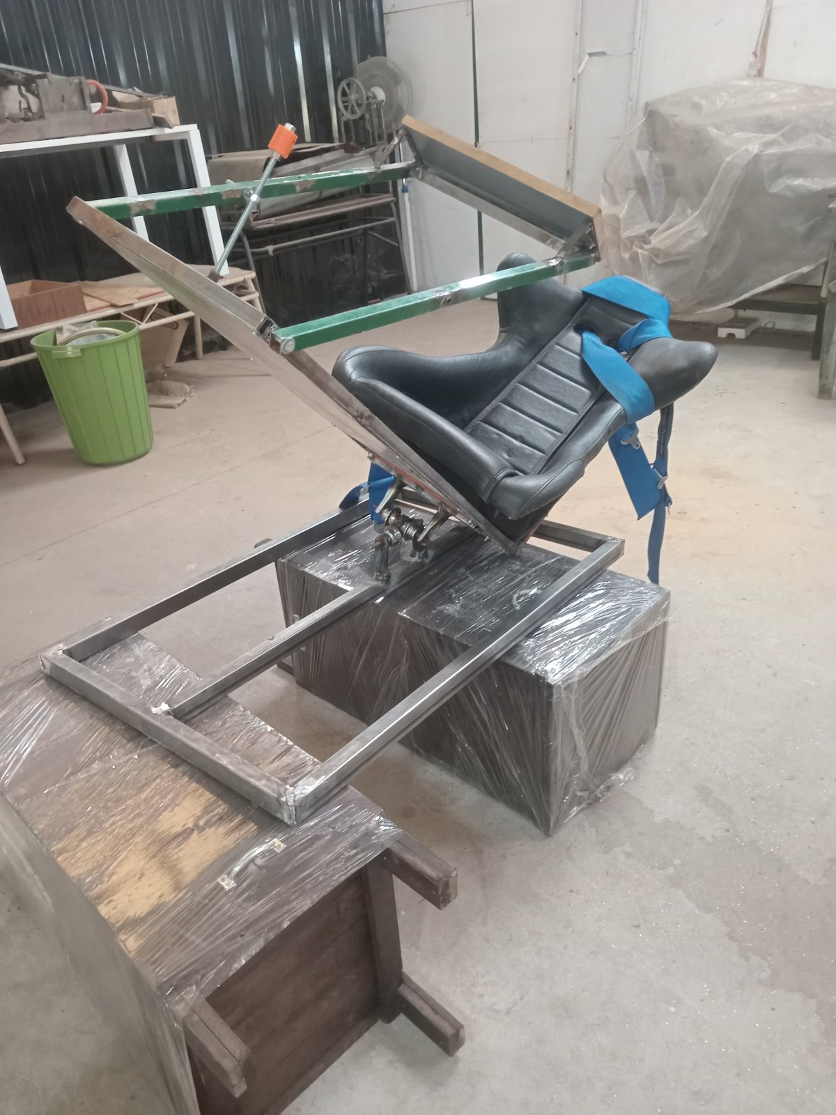

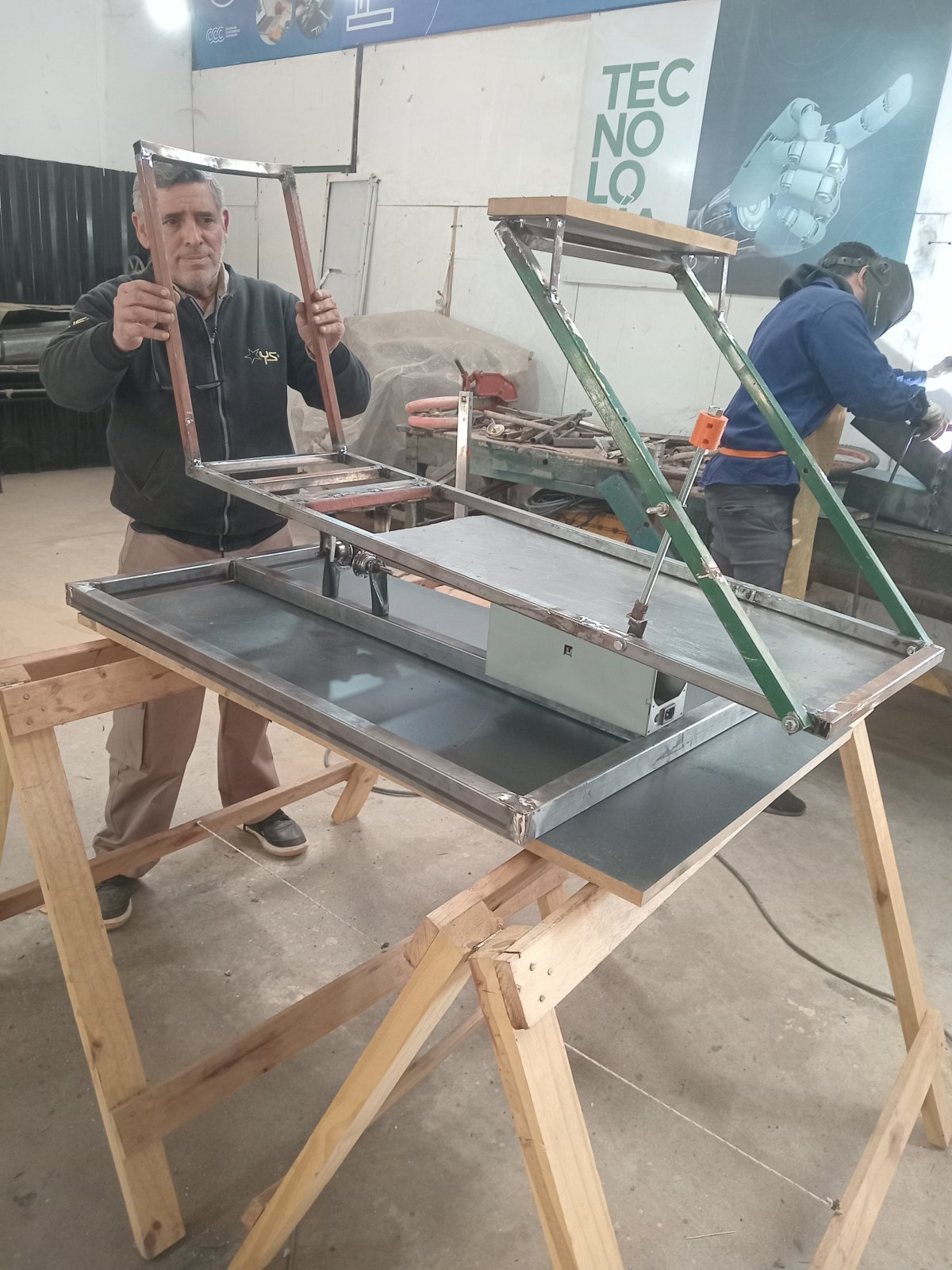

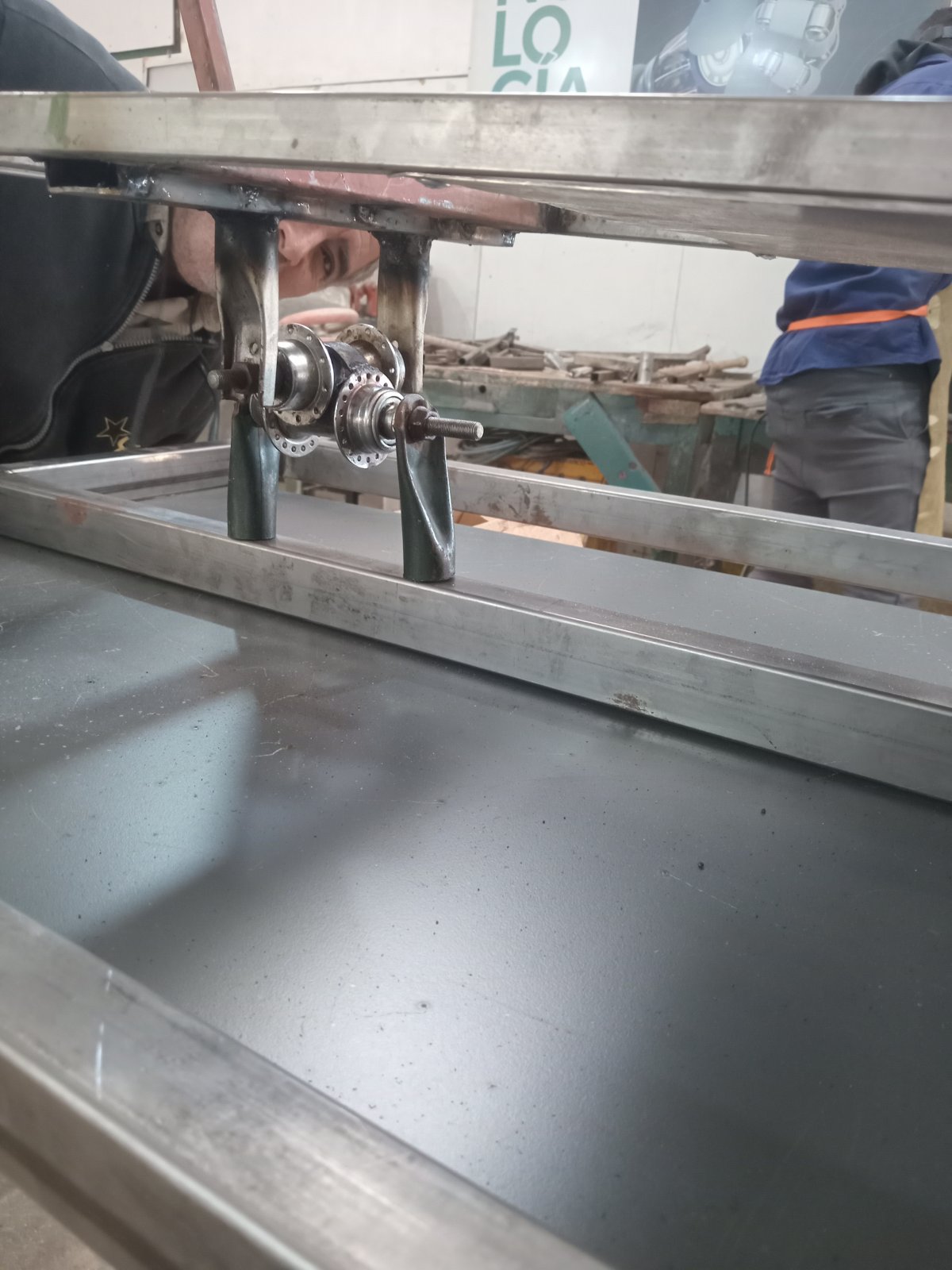

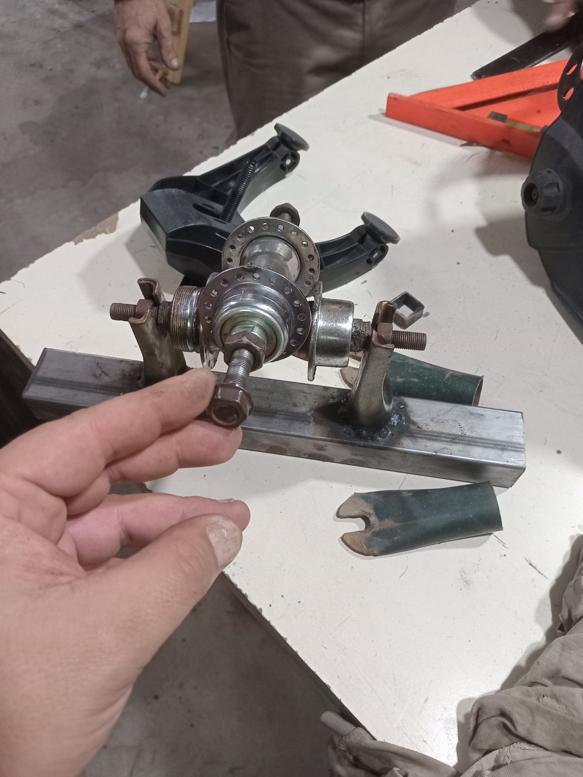

    Hi everyone, I'm going to show you what I've done so far, it's the simulator in demo mode of Live for speed, and the designs I've made so far I show you the movement system I made with 2 bicycle masses I use 2 12v wiper motors with its feedback of 2 pots of 10k
    To calibrate use the simtools
