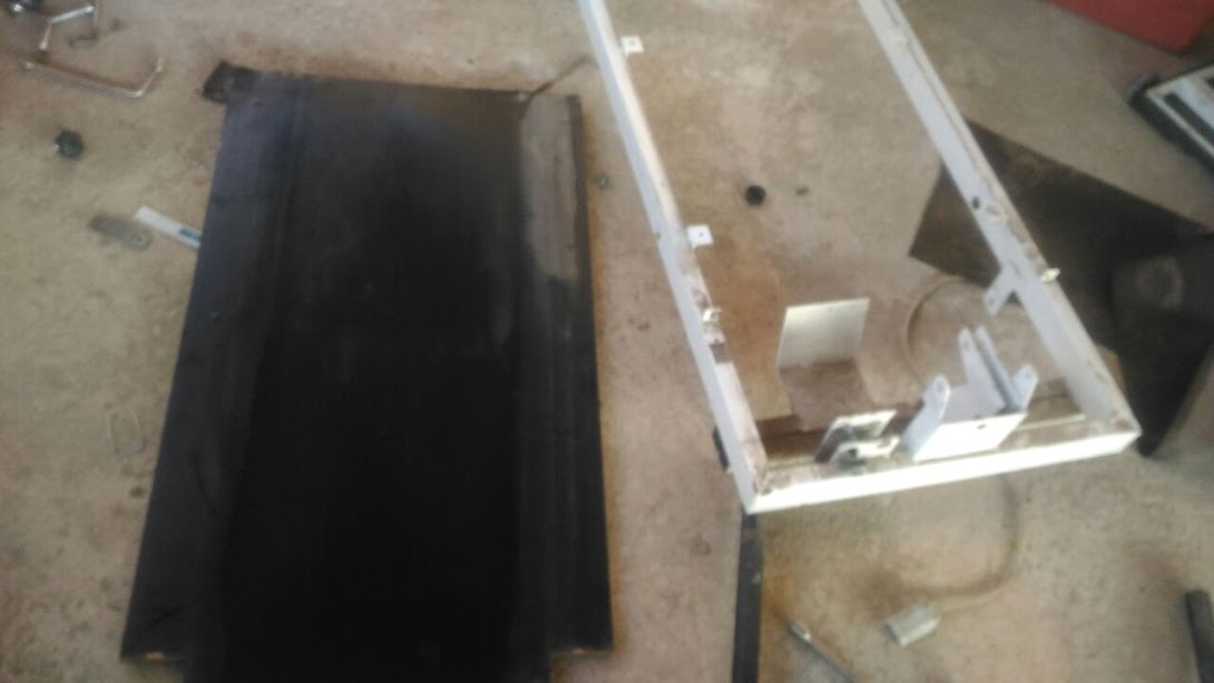

    I had here at home an old treadmill , so i disassembled it :

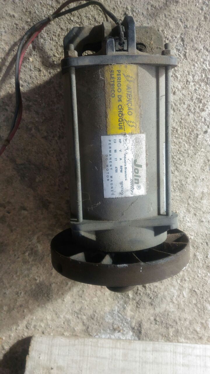

    I found this motor inside, but i think i cannot use this, because it do not have gear reduction box :
    This is how the treadmill look disassembled :
    This black piece is a very strong wood used inside the treadmill, i think i can use it later.
    I saw the base of the treadmill ( The white part in the right) as a good base for the 2dof, but i have to weld a iron bar in the middle of it to weld the car gimbal in it.

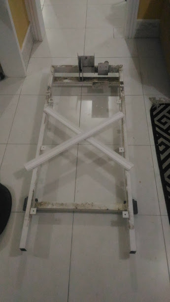

    I put a plaster bar i had here at home just to give me some notion of how its going to be :
    - First option :
    Iron bar ( that i use a plaster bar just to see the model) in the middle, so i can weld the car gimbal in the middle and weld directly in the chair.

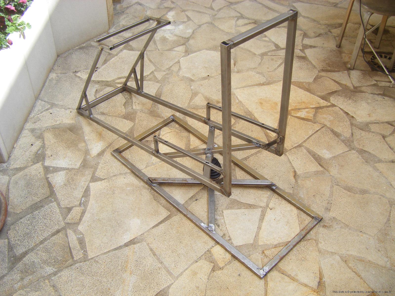

    - Second option :
    2 iron bars crossing, just like @RacingMat model.

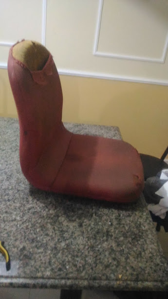

    To the chair i found an old one here in my home :
    I'm going to change the cloth to a new one.

    Can I please clarify your intended design, is it to be a shoulder mount, compact, foot mount or some other design variant?
    A sketch of your intended design is always helpful.

    Hi noorbeast, so i'm looking to do just like @RacingMat did , that i think it's a shoulder mont right ?

    @D Lima : good project! you will learn a lot and have a lot of fun as well :)
    yes, this design is "shoulder mounted"
    no indeed, your motor is not convenient (4700 RPM is toooooooo fast!)
    If you don't know how to weld, you could bolt the structure... but this will require some reinforcements in the corners to prevent angulation
    like these
    or wood structure
    like here https://www.xsimulator.net/communit...-ricmotech-rs1-clone.10377/page-3#post-137362
