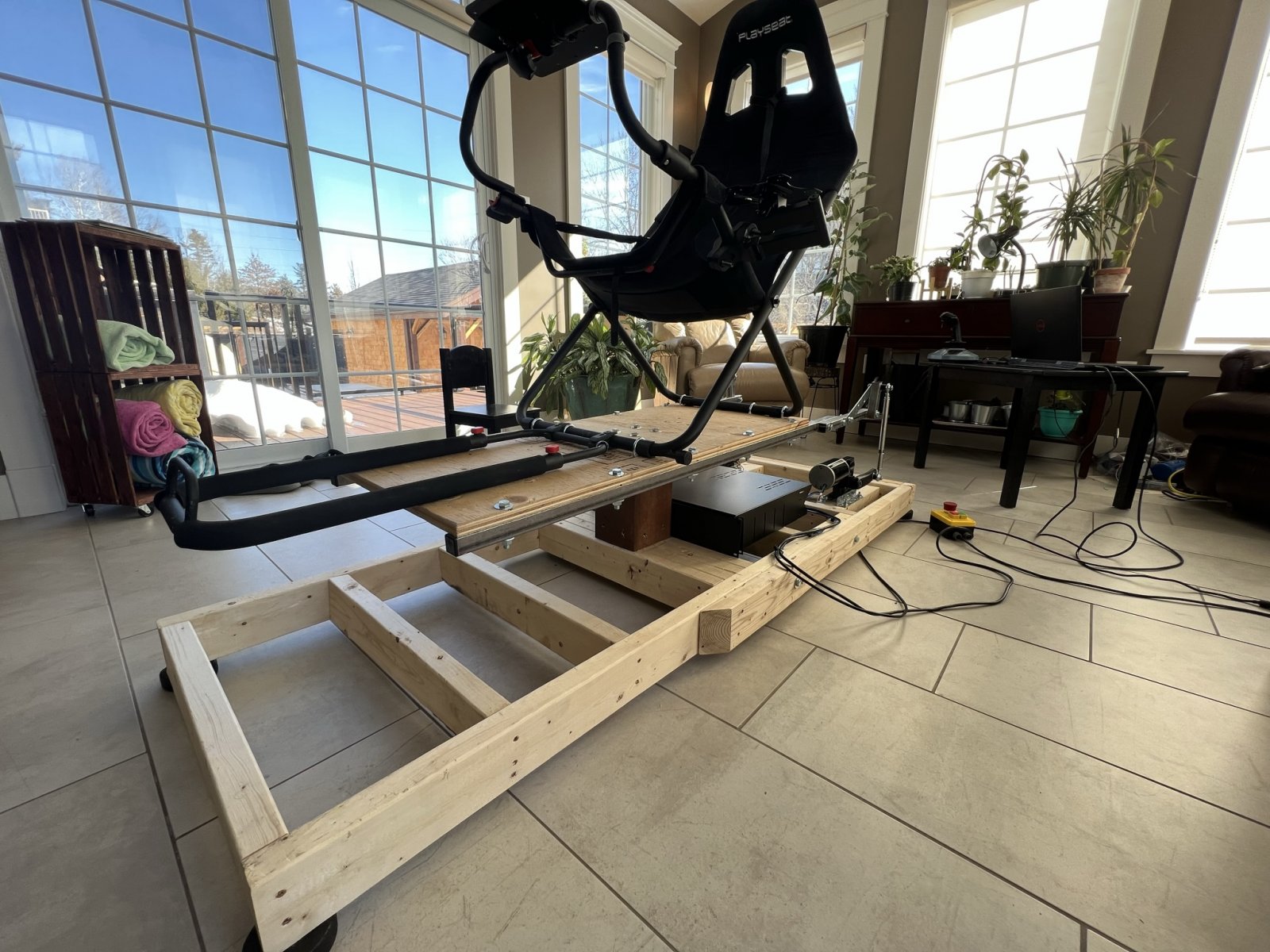

    Hi Everyone. I’ve started my journey down the road of “motion simulation rigs”. I’m attempting to build a 2DOF rig for MSFS2020. I’ve been playing the sim in VR (Valve Index) for well over a year and have been having a complete blast. I had never considered a motion cockpit before (knowing they were several thousands of dollars), but after seeing @Ronan Design passionately describe his experience with his own DIY rig via the MSFS2020 forums, I was inspired to try my hand at it.
    My initial research brought me to this site where I slowly began reading through posts and threads in an attempt to get my head wrapped around this thing. I’m far from where I need to be to get a good, stable working platform for MSFS2020 in VR, but I think I’m on my way… I just need some guidance!
    I’m not one to ask many questions, and usually try to figure things out on my own. But this is project has kicked my butt, and I’ve finally come to a point where I need start asking questions so I can finish (plus my wife wants her sunroom back… it’s became command central for this project since the start of the year!)

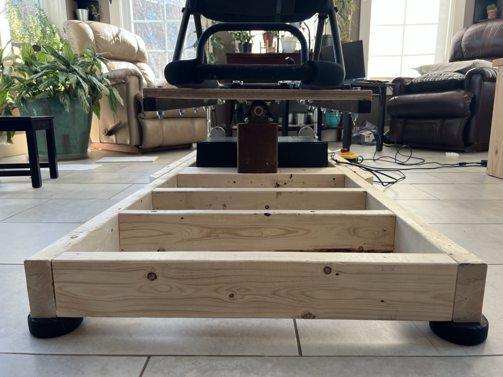

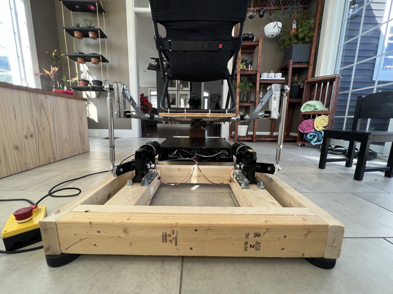

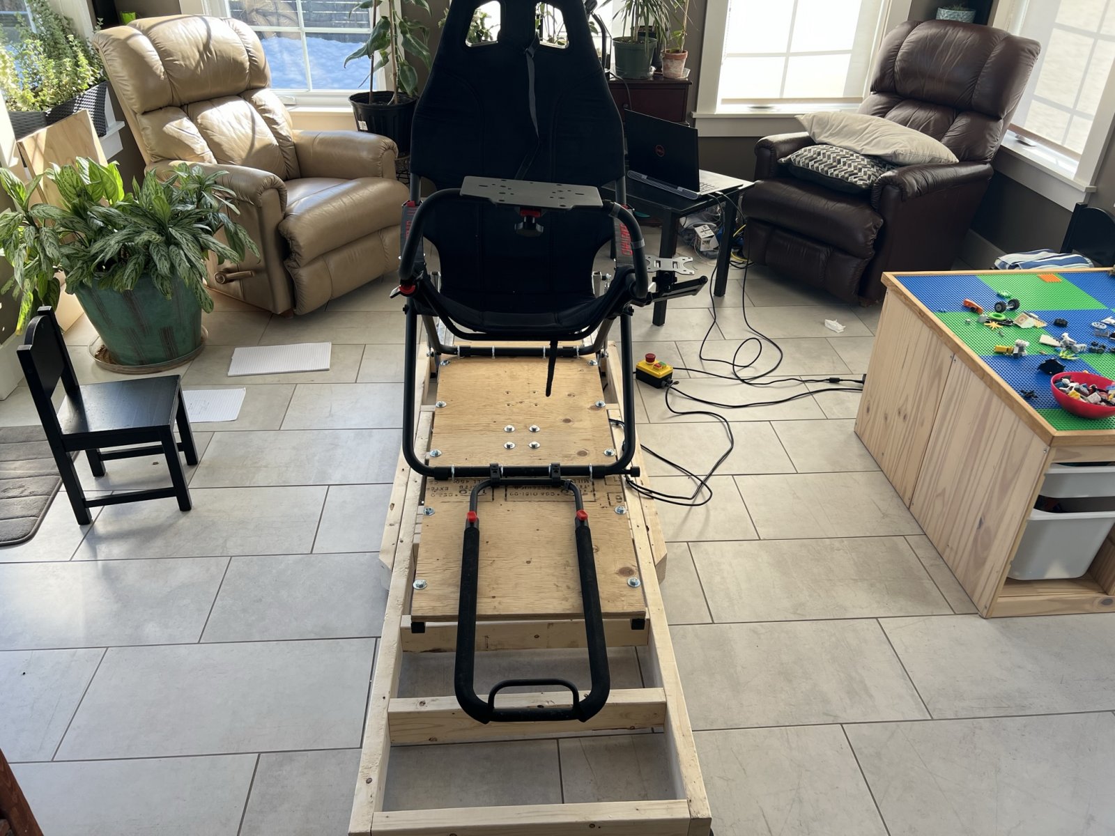

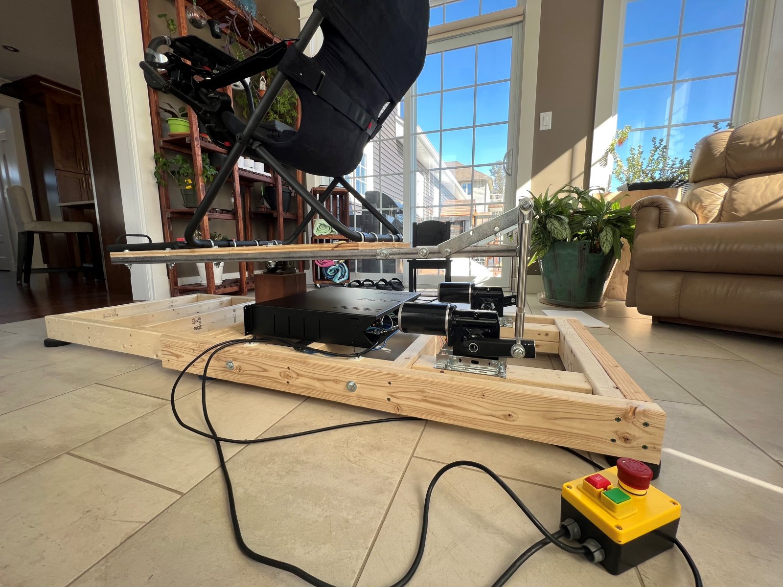

    THE CHAIR

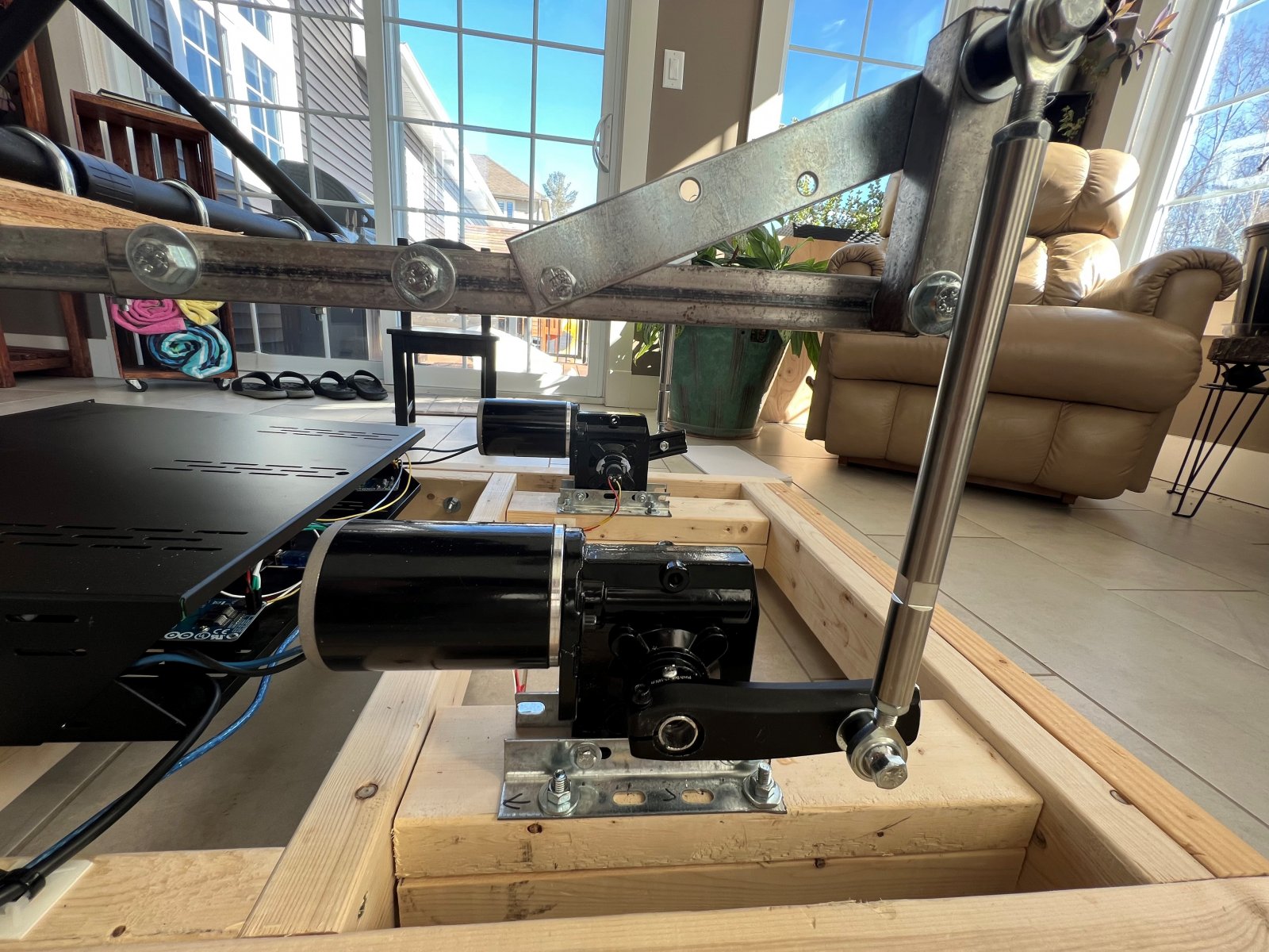

    Base construction is 2x4s screwed and bolted together on hockey puck feet (also screwed to the base). It’s very solid and heavy (although my motors have easily managed to launch it several inches into the air when they have made severe movements)

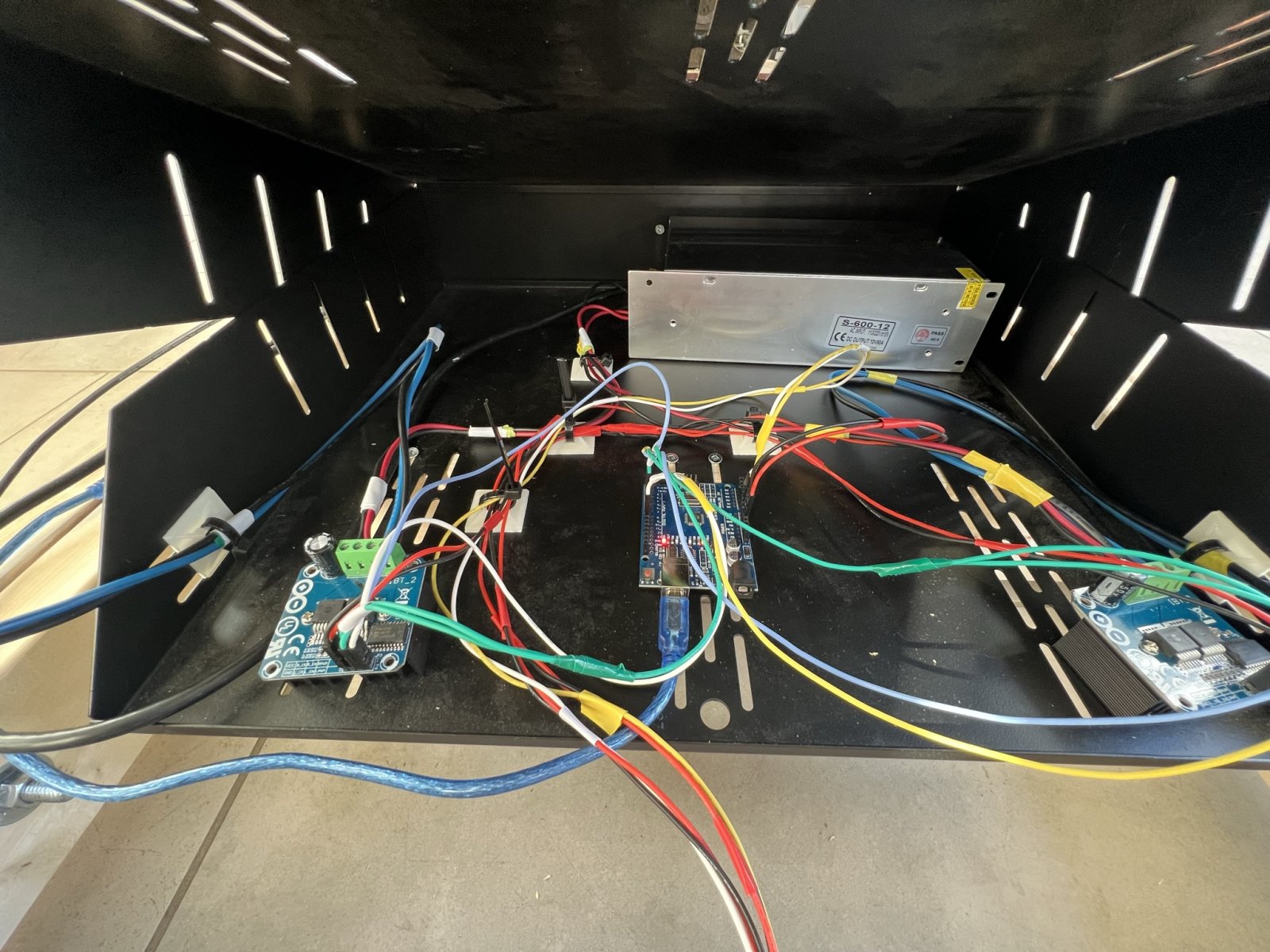

    The motors are from PGSAW on EBay (12V 150/160RPM 25:1 gear ratio). I’m using 2 IBT2 motor controllers from Amazon wired to an Arduino UNO clone.
    Some basic measurements.
    Crank arm: 89mm
    Vertical Rod is: 279mm (attached 88mm above the horizontal plain of the moving platform)
    Horizontal distance from center of motor axle to center of U-joint is: 736mm
    Height from center of motor axle to top of the horizontal plain of the moving platform is: 209mm
    The chair itself is a “Playseat Challenge” mounted to a 5/8 plywood platform which in turn is reinforced by inch square tubing. The chair gives me several “built in” mounting options for peripherals and is light weight with its steal tube construction and light weight seat material.

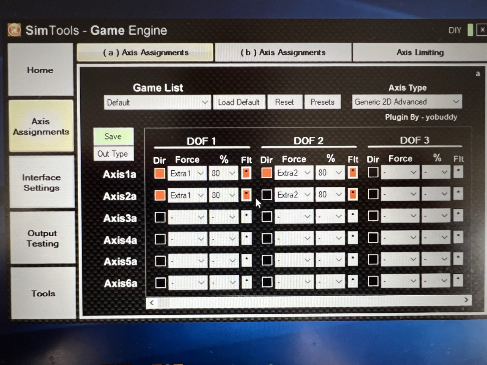

    SIMTOOLS (Game Engine)
    Although I’ve not (as far as I know) properly configured SMC3 yet (Do I need to do that? Or is SMC3 only to confirm that my wiring is good and my Arduino/controllers work?), I decided to jump into SimTools with the hope that I would be able to fix my jerky movement and super long range of motion (I’ve read that “less is more” for VR).

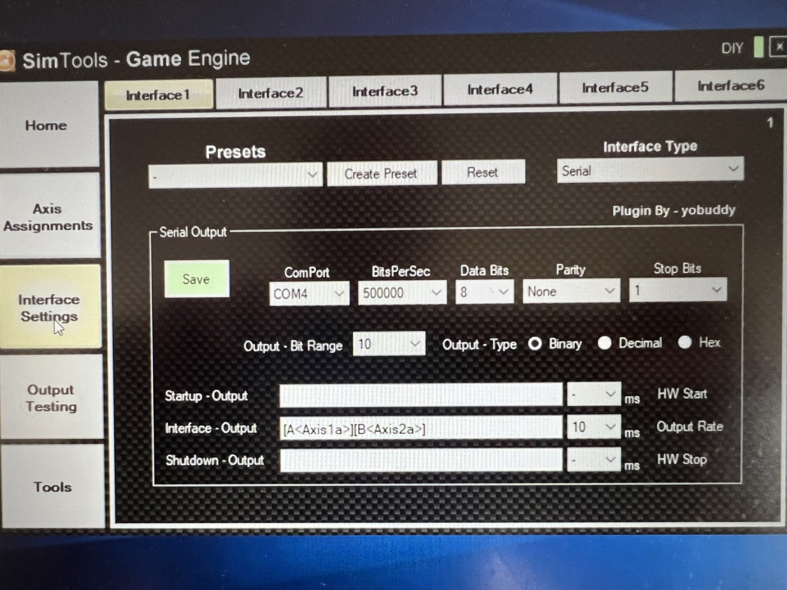

    I purchased a DIY license and jumped in. I was able to get the Interface set up easily enough. I copied these numbers from somewhere on this site. My comport changes between COM4 and COM7 depending on what USB port the Arduino finds itself plugged into, but other then that, I think this is good?
    I installed the MSFS2020 game plugin and patched the game easily enough, and saw that it shows up in my “Game list” under Axis Assignments.
    I’m confused between “Default” and the actual game in the dropdown. Which one do I configure? Both? Just the Default? Just the Game? I don’t know… so I’ve just been duplicating everything on both.
    As for settings, I’m just guessing here… reading what others are saying... but I don’t really know what I’m looking for… I’m using “Generic 2D Advanced” so that I can check off the “Anti Roll”. Before that, I was going past the range of my motor arm, causing it to shut down and lurching the chair to one side.
    **Even with the Anti Roll checked, I’ve still been able to go past the limit and shut the motor down…not sure why?**
    Under Filter I’ve set smoothing at 100% everywhere… but honestly I’m still feeling the “stepping” during the movement. The jerkiness is more pronounced during Pitch up and Pitch down maneuvers. The Rolls for some reason feel a bit smoother?
    The only other setting I’ve changed is under “Axis Limiting” where I’ve set 40 to 50% movement range in and effort to reduce the movement range on my arms (VR LESS IS MORE?). But I’m not getting good fluid movement. And it seems to reverse direction to early (Anti Roll? Not enough defined Rang of Motion?).
    I’ve "set" the min/max under TOOLS while flying the sim (easy, slow movements) and saved the new settings. Not sure I’m seeing any effect doing this (Can someone explain what effect this should have on the movement?)
    That’s as far as I’ve gotten with SimTools. I’m hesitant on investing to much time on it if I’m not configured properly in SMC3…

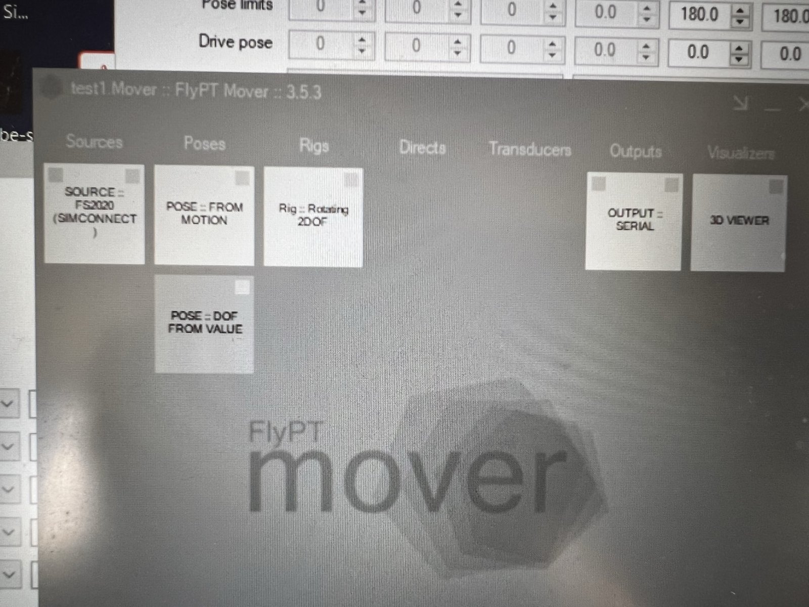

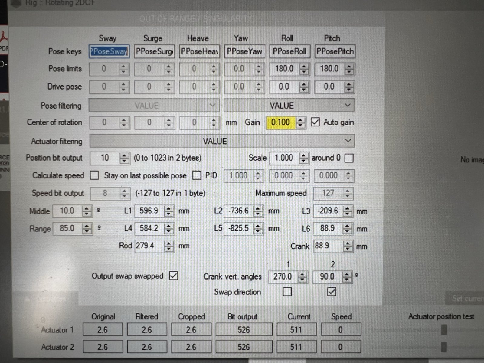

    FLYPT MOVER
    I stumbled on to FlyPT Mover while digging through @Ronan Design ‘s thread. It looks to be a very cool piece of software with some apparently powerful applications for seamlessly integrating different sources to control movement.
    I’ve yet to get FlyPT Mover to have ANY effect on my rig whatsoever. It seems to be connecting (It says CONNECTED under the Outputs window (but the word Connected is RED… shouldn’t it be GREEN??). I’ve defined my Rig under the Rigs window (entering all measurements).
    But I don’t know what else to do with this? MSFS2020 connects and shows movement but doesn’t effect the Rig… I’m using the same output string as SimTools with Brackets, but still nothing… It does say CONNECTED but its red? I wish I could find a basic user manual or basic tutorial that really starts at the beginning….
    When using FlyPT Mover, do I need SimTools? Is it an either/or kind of thing? Is Mover to be used in conjunction with SimTools or is it stand alone. I’ve not been able to find any info on this.

    Grab a copy of the SimTools manual and keep it handy for reference: https://www.xsimulator.net/community/faq/rtfm-start-with-the-official-simtools-documentation.117/
    The Default profile should be configured first and the rig tested in Output Testing, to ensure everything works and is configured as expected, before messing with individual game profiles.
    If everything is working as expected then see the motion profile tuning tips in the FAQs: https://www.xsimulator.net/community/faq/steps-to-create-a-motion-profile.228/

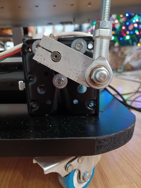

    Ok! So you think my arms are too long? I was wondering about that... I can easily drill out the arm for 50mm. Thanks for the observation!

    The levers may be a tad long, but you can always try it as they are and see if the motors get warm and if they are able to handle the load.

    So I took your advice and shortened my arms to 50mm. It has solved one of my issues!
    My motors kept shutting down when passing a certain point on a roll. The roll side arm that would swing down would go past it’s limit and shut down, not being able to return up again. I think the mechanical force needed to lift the arm with my weight in the chair was too much regardless of settings or axis limitations in software. With my shorter arms, I was not able to shut down my motors in multiple rolls. Ive only had time for limited testing but it looks promising and I am encouraged by this! Thank you!
    Shortneing the arms has changed some geometry and I will have to move my motors back on the base. I think this will even go further in improving the mechanical advantage that shorter arms seems to have given me.
