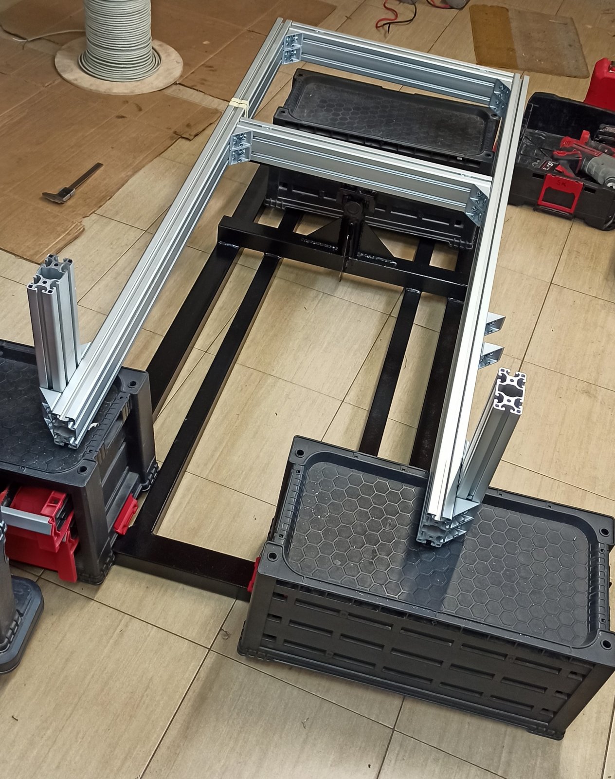

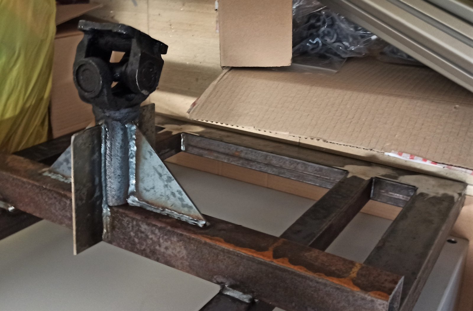

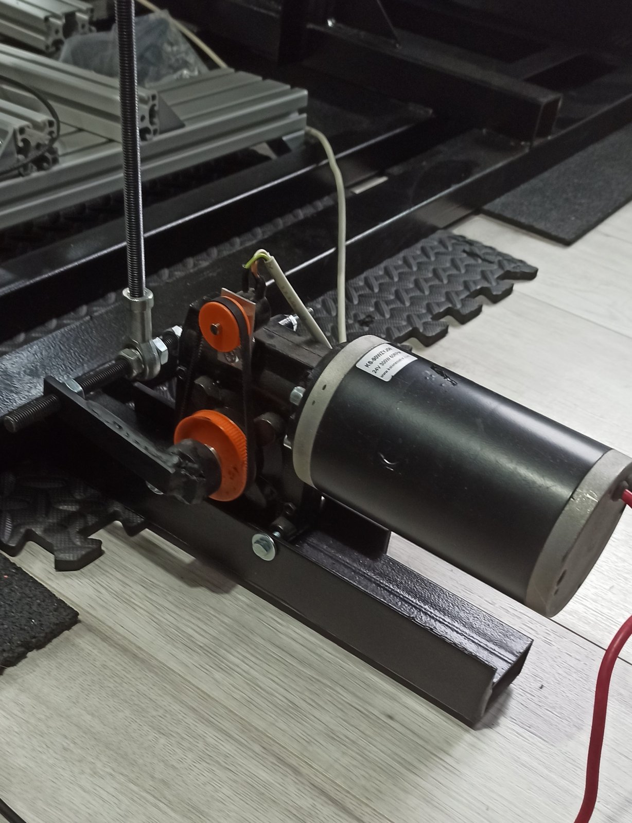

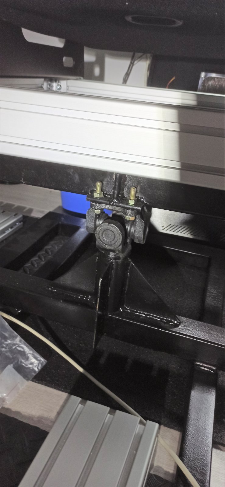

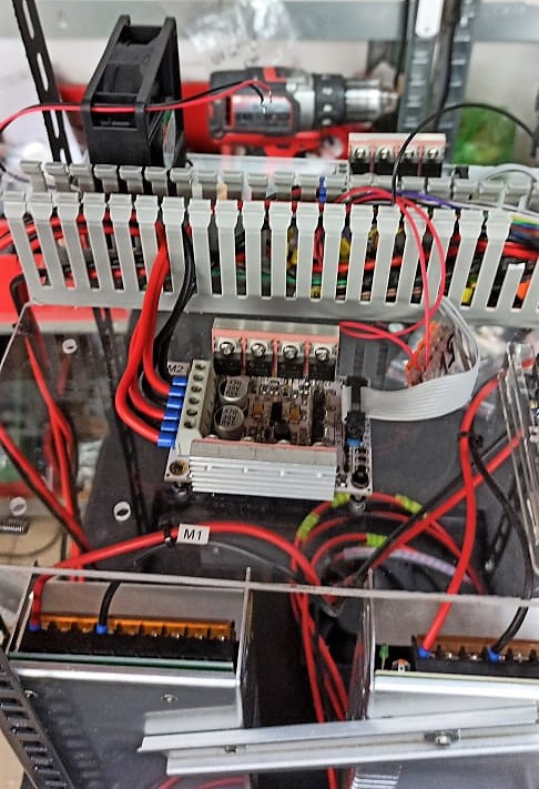

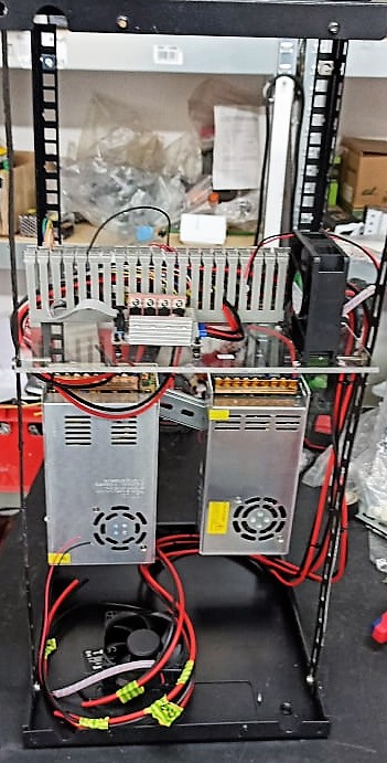

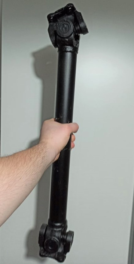

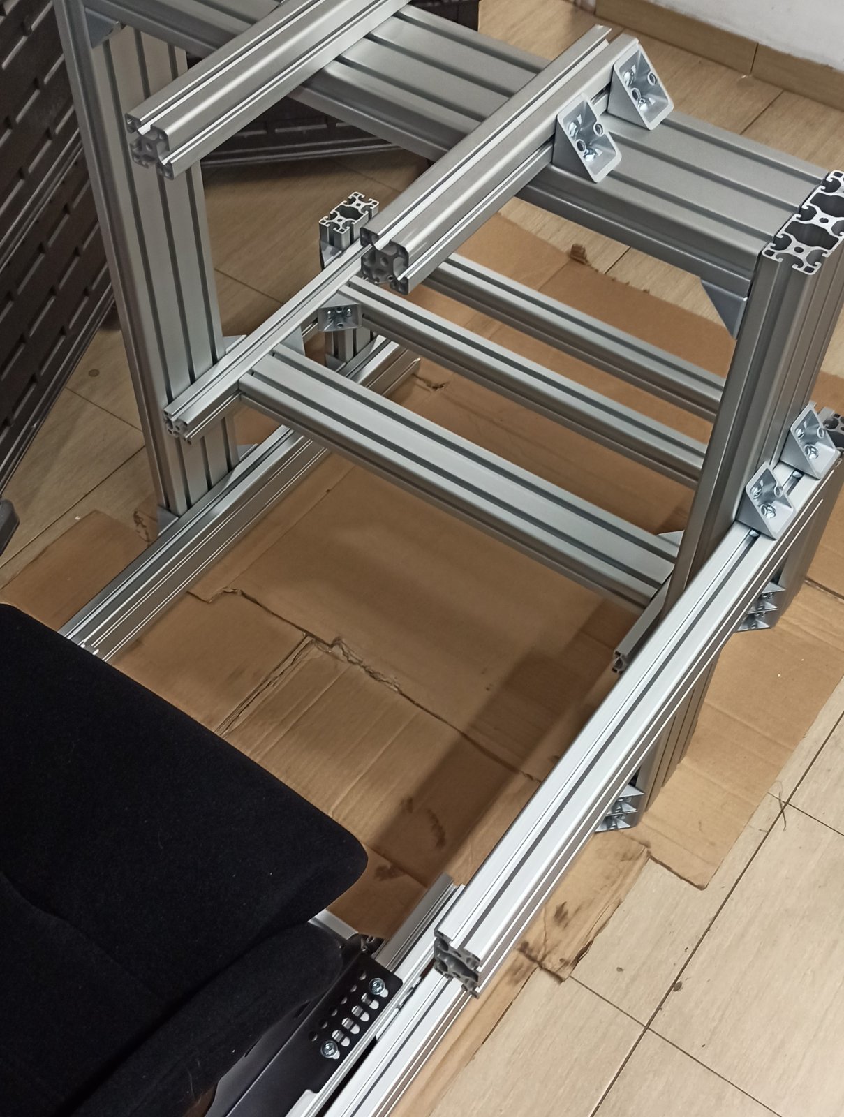

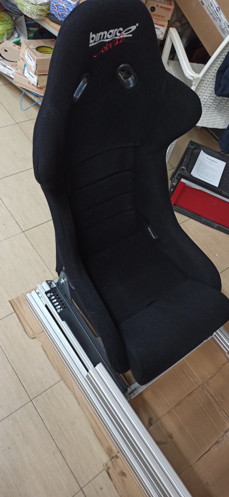

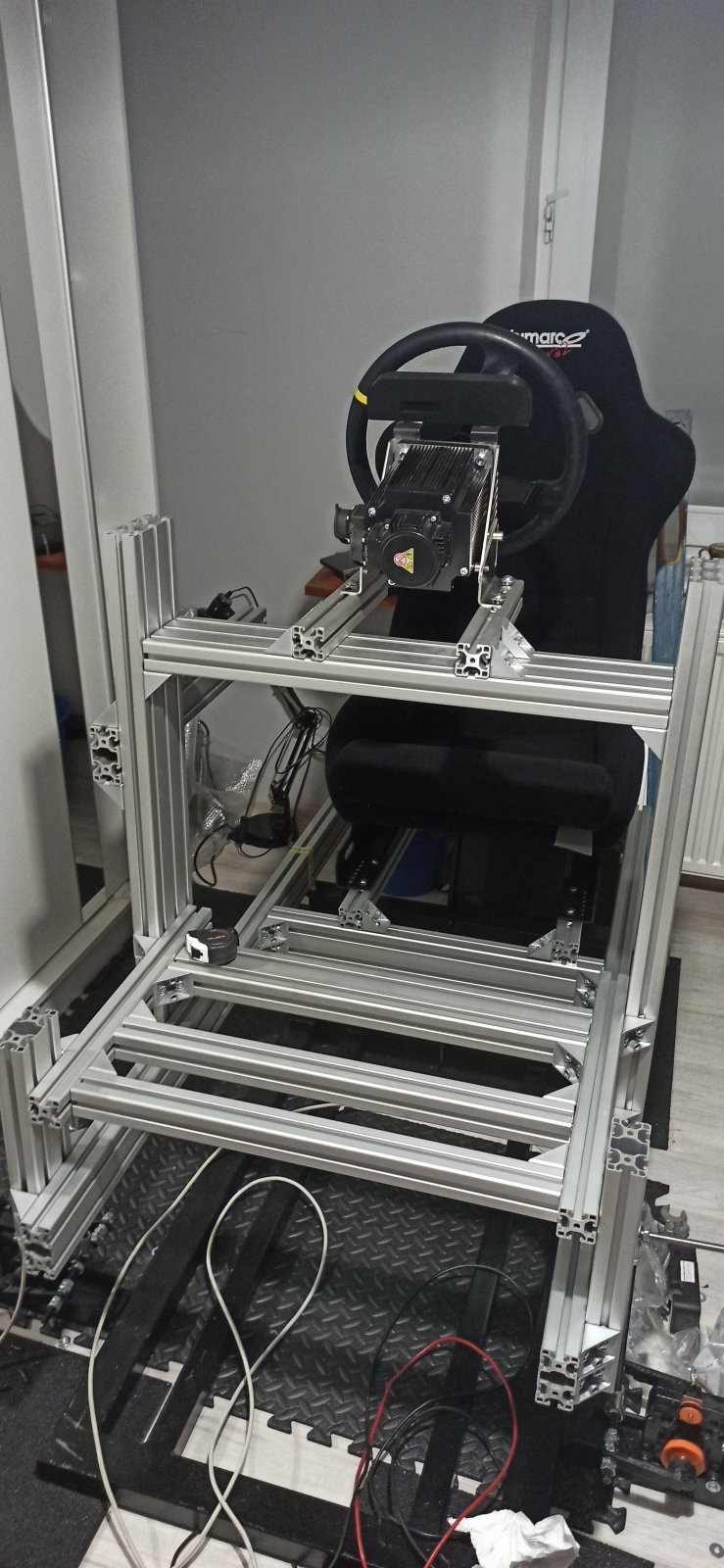

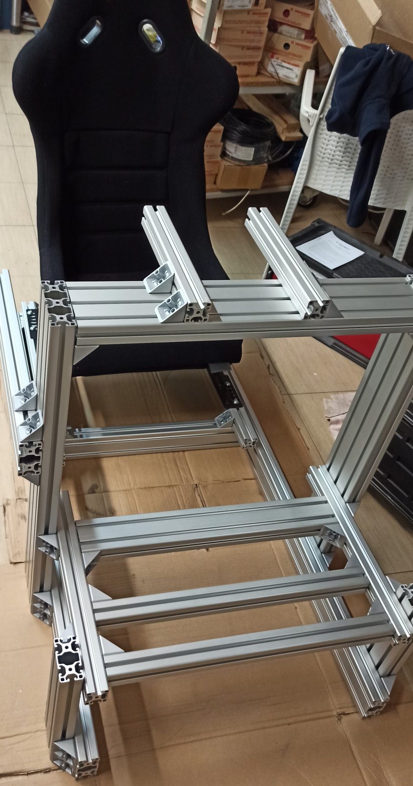

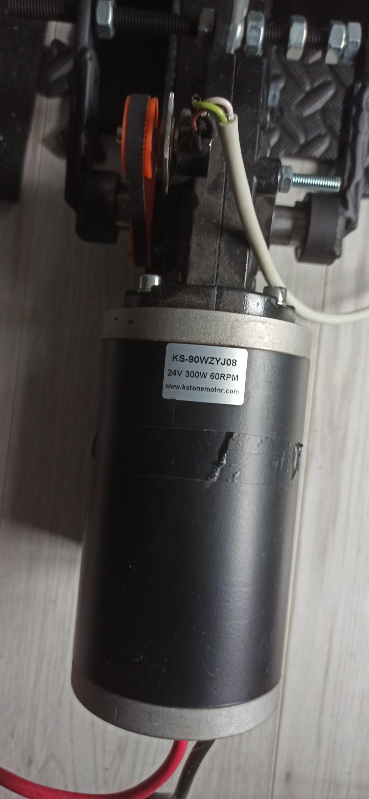

    Hi, im building my own motion rig. It's simple construction based on motedis project aluminium rig. Potentiometers are with halla effect. Reduction ratio 50:1.
    Motors: KS-90WZYJ08 24v 300w
    Potentiometers: FCP22E

    Nice work :thumbs
    What control boards, PSUs and control code are you using?
    When you get the chance a video of your rig in action would be great.
  3. Dominik2111
    Dominik2111 New Member
    May 25, 2021
    6
    Poland
    - 20Coins
    +8 / 0 / -0
    Thanks, really appreciate

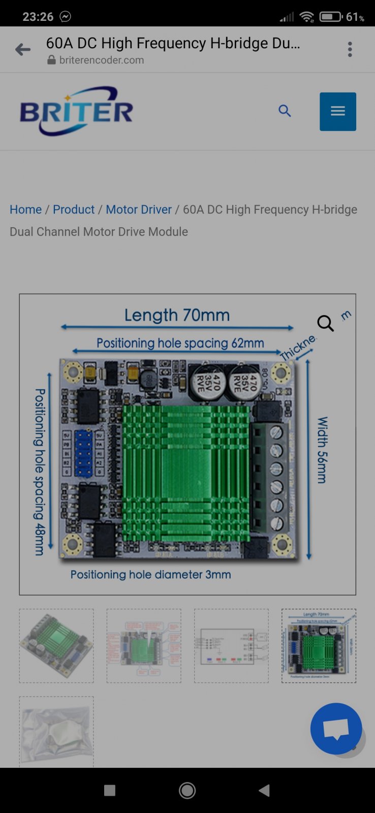

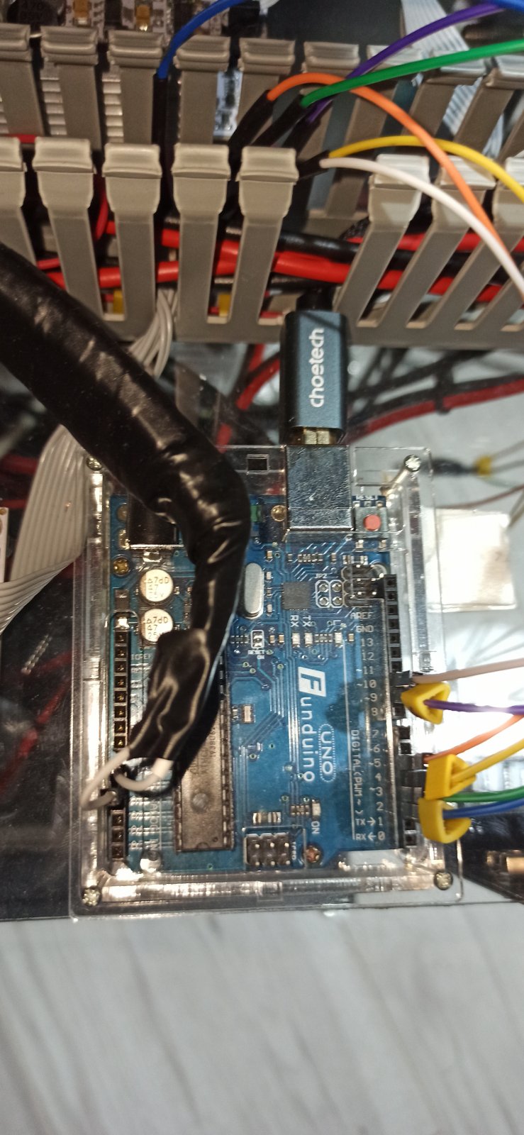

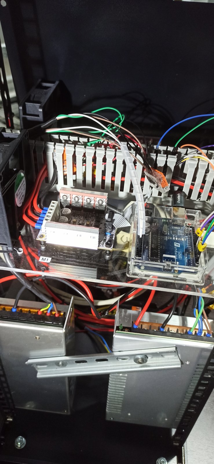

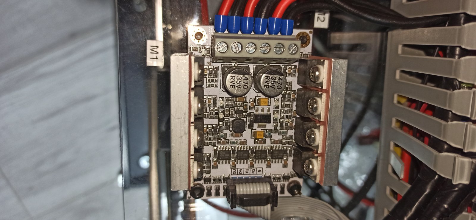

    PSUs- one is some noname 21A 24V, second is led power supply and he is 25A 24V too. Last one is only for fans, because he is 12V.
    Control- arduino uno (funduino)
    Motor controllers are some noname, bought on alie

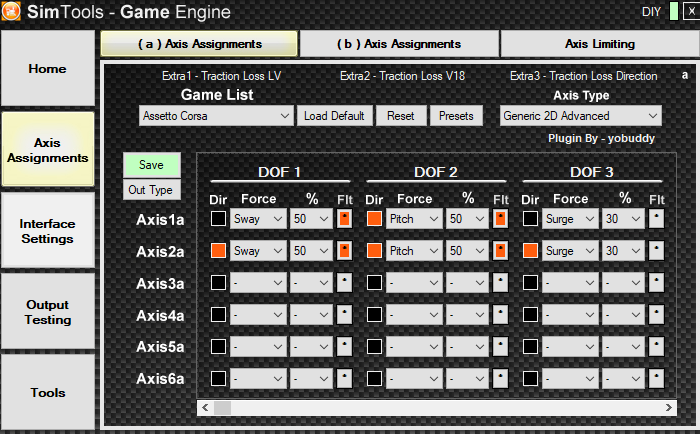

    I'm using smc in mode 1, that's all right now because I don't have license for simtools yet. i can make video only in manual motion in smc right now
