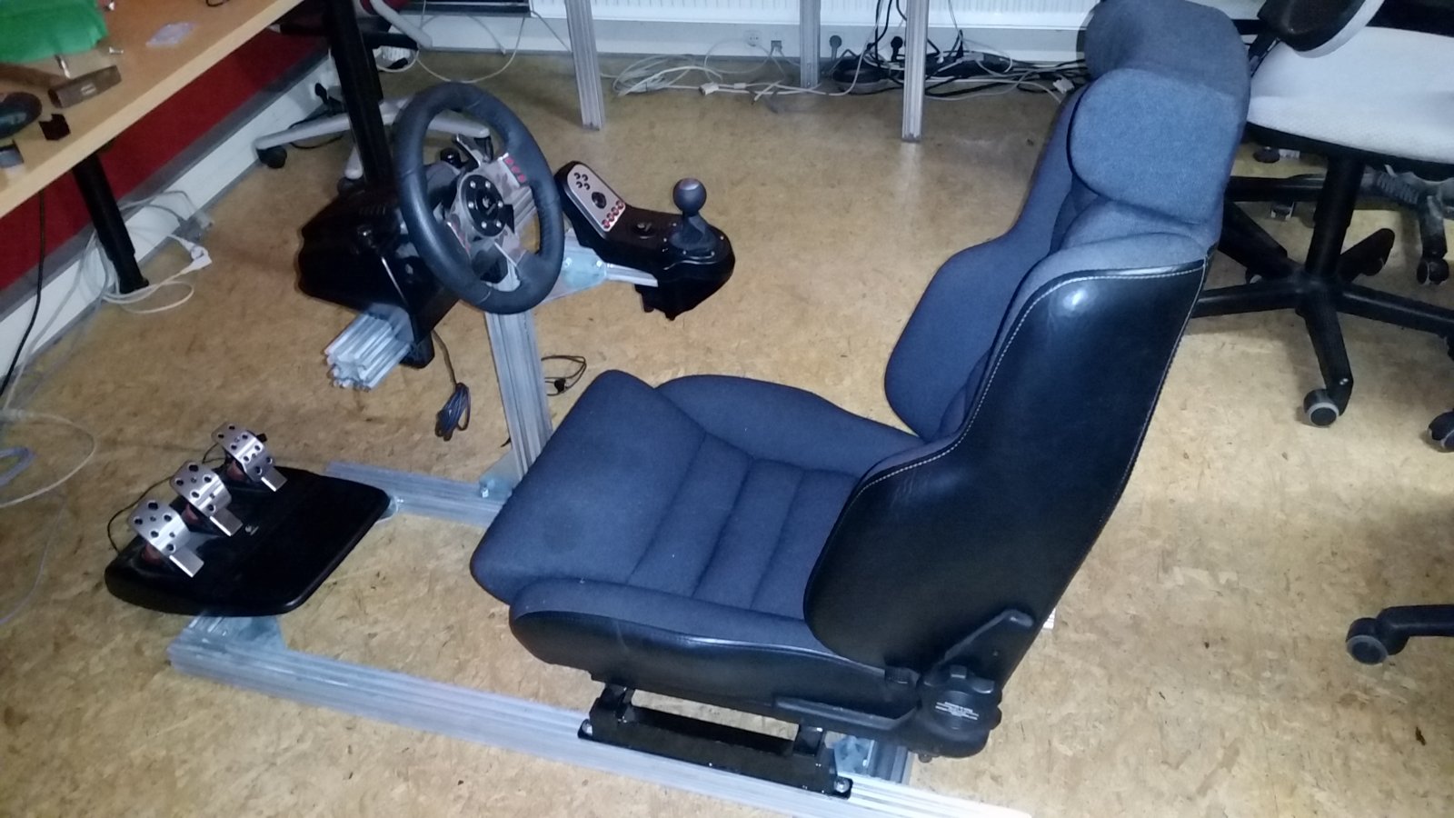

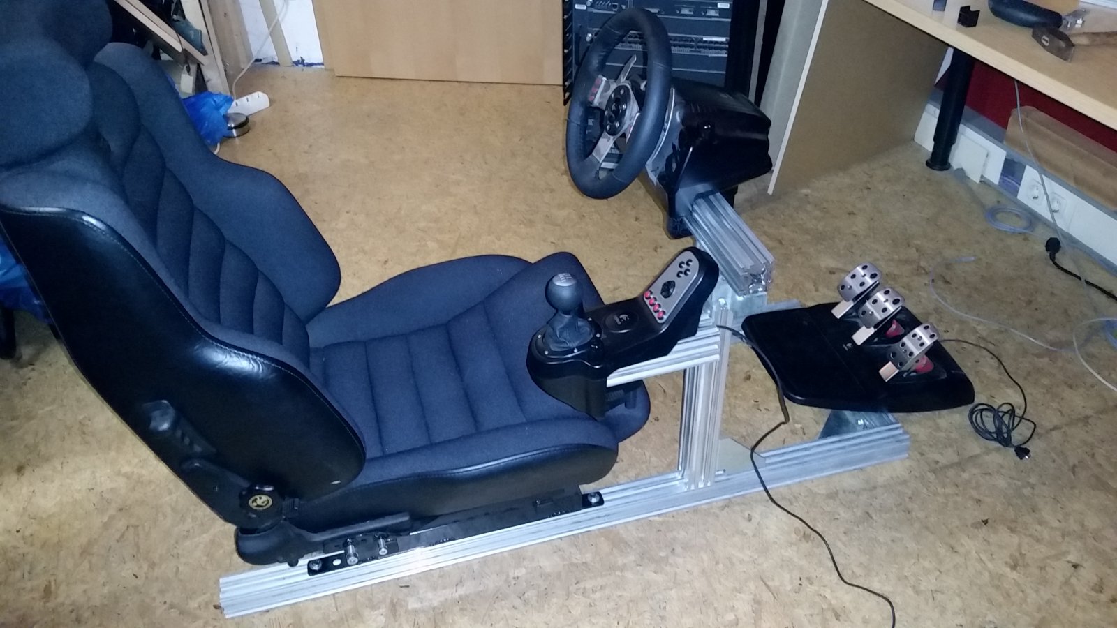

    Today I build the upper part of the seat. some corrections are still necessary. the accelerator pedal has yet to find an attachment. i am looking for an lighter seat... might be too heavy for the motors. 20151112_165808.jpg 20151112_165829.jpg

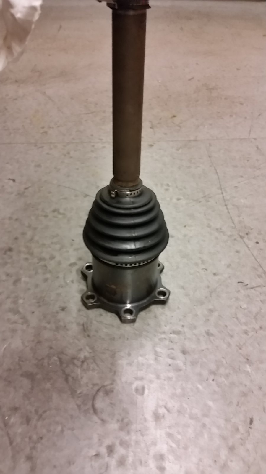

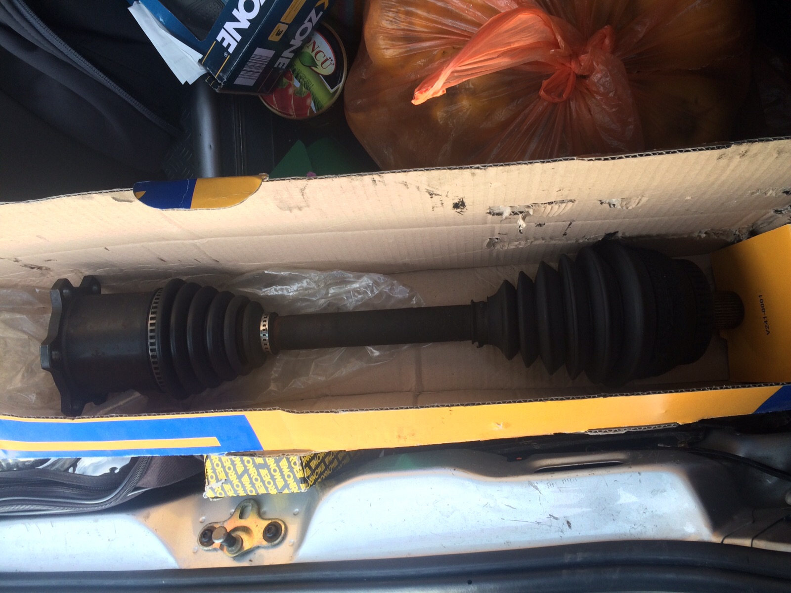

    cv joint??? universal joint was the translation i think it is an drive shaft ( another translation) ... there is a picture of the whole part. IMG-20151108-WA0001.jpg

    Translation can be tricky, so here is the difference:
    CV or Constant Velocity Joint
    = Used in front wheel drive cars it allow a drive shaft to transmit power through a variable angle. When re-purposed for use in a motion simulator it can allow some unwanted rotational twist, which can be eliminated by constructing a diagonal pivot bar across the width of the simulator between the top and bottom frame. Not to be confused with a Uni joint: https://en.wikipedia.org/wiki/Constant-velocity_joint
    Uni or Universal Joint = Commonly used on the end of a car tailshaft and re-purposed as a pivot point for a motion simulator. It is a joint that allows a rod to 'bend' in any direction. It consists of a pair of hinges located close together, oriented at 90° to each other, connected by a cross shaft. Not to be confused with a CV joint: https://en.wikipedia.org/wiki/Universal_joint

    Yesterday I started the substructure, made the bracket for the cv. tonight I'm going to drill the hole for the cv... a very enormous drill 30mm. and I still have the cv to cut to size. the frame has made of aluminum profiles

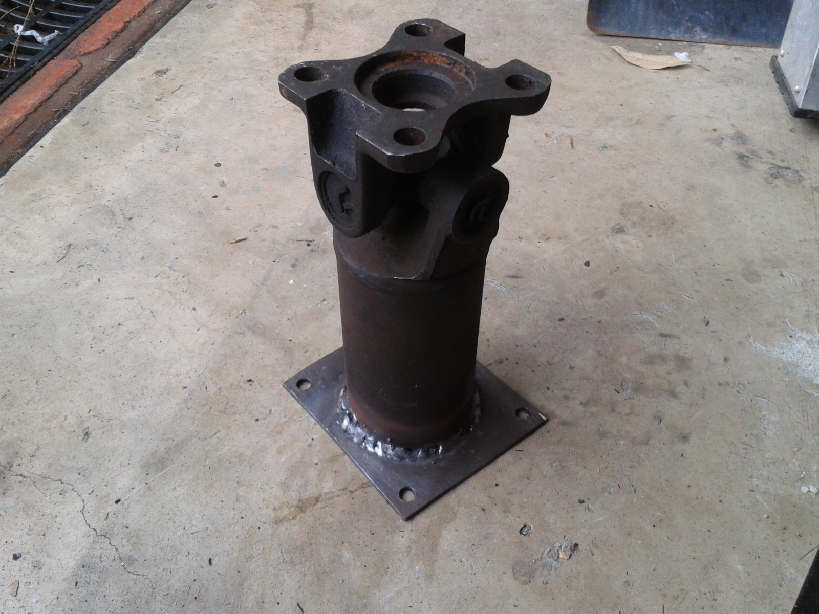

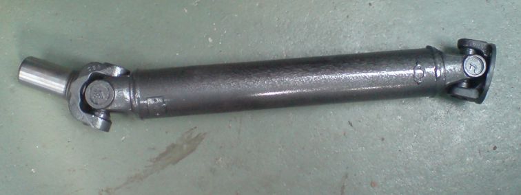

    With the CV joint, it will have lateral twist in it, so if you plan to use it, look at adding a draglink to the frame to stop that twist.
    If you can find a rear wheel drive car driveshaft, XJ-SC V12 tailshaft w.jpg
    that is better as the shaft does not have lateral twist. Then you can cut it to size like this
    Keeping the swivel point (universal joint) as close as possible to the bottom of the seat
    Now, with your frame, where are you going to mount the motors? Shoulders at rear? Foot motor mount?
    You also mention a lighter seat, how heavy is the current seat?
    Cheers, David.
