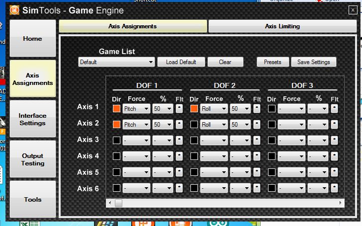

    Tuning Center
    I would suggest that you use a “medium” track and car while using the tuning center.
    Then once the game is going, click “capture new Min Max” and then click the “Reset” button.
    Now drive for a short while at 80% as hard as you usually would, being careful not to hit any walls or anything unusual. A lap or less is usually enough.
    Now save the new settings.
    Game Profile
    Now for the profile, build it one DOF at a time.
    First get surge working, so add surge to axis 1 and 2 at 50% (so you leave 50% for sway on both axis). Once it looks good set the % for surge to 0% for both and then do the same procedure for sway. Once you like what you see, simply set the % for surge back to 50% for each axis.
    Doing it this way will enable you to see exactly what is happening with each DOF.

    Thanks heaps @yobuddy. I will take some time to try the things you suggested. In the meantime, here is the profile settings that I think were used at the time of the video being created:
    Interesting that you mentioned surge and sway because most of the write-ups I have seen have been using roll and pitch.

    Pitch and surge as well as roll and sway often behave likewise. The hood of the car goes up when accelerating → pitch up, the car rolls in a curve, where you also experience sway. [Just to mention: yaw and heave are not in sync.] Therefore sway/roll, surge/pitch are somewhat similar.

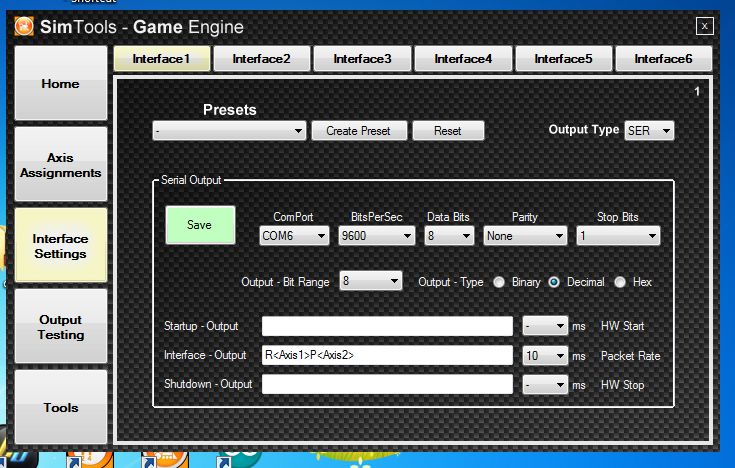

    As far as i can see you @marky000 are using the Arduino code of RacingMat, please have a look to the linked screenshot below and correct your settings (BitsPerSec, Outputtype...) http://www.xsimulator.net/community/attachments/com-output-simtools-jpg.9478/
    PS!!! Interface output is wrong, you have mistyped using "P" instead of "L"
    Just my friendly advice: @Guys, if you have any issues we will help ASAP but first read thoughtfully the manuals or instructions. Thank you.

    @Pit Not true. Using @eaorobbie arduino code. As you can see in the code, Actuator Name = R, P

  11. Pit
    3,012
    30,457Coins
    +3,094 / 31 / -0
    mea culpa, this code was not known to me. Sorry for the false information. Anyway I suggest you to try out the proven SMC3 code.
