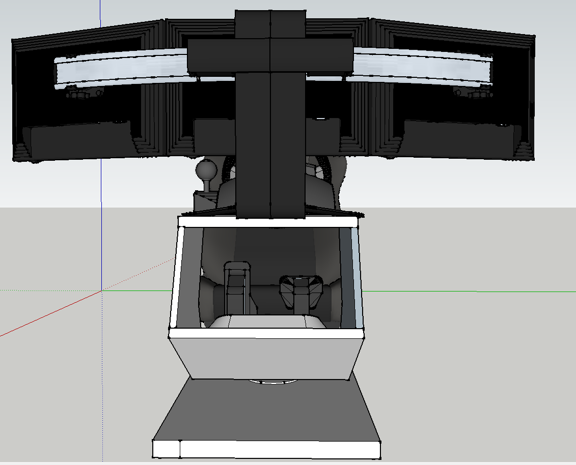

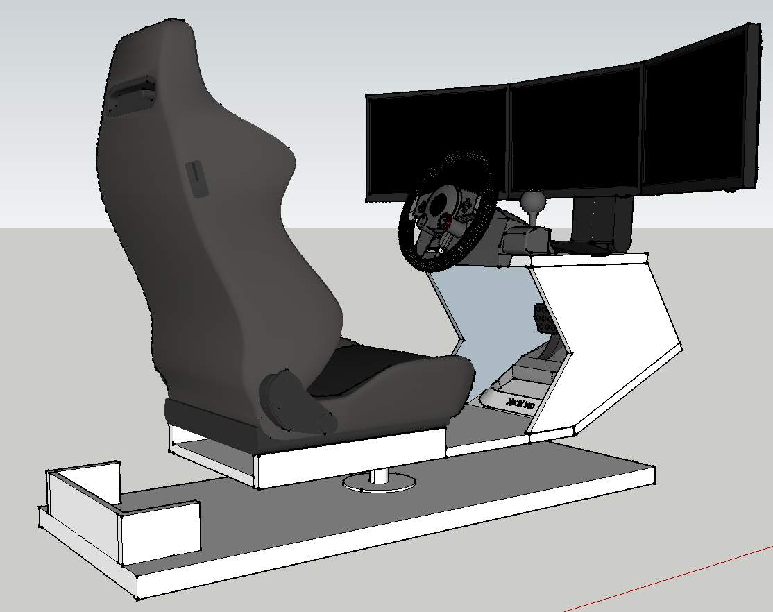

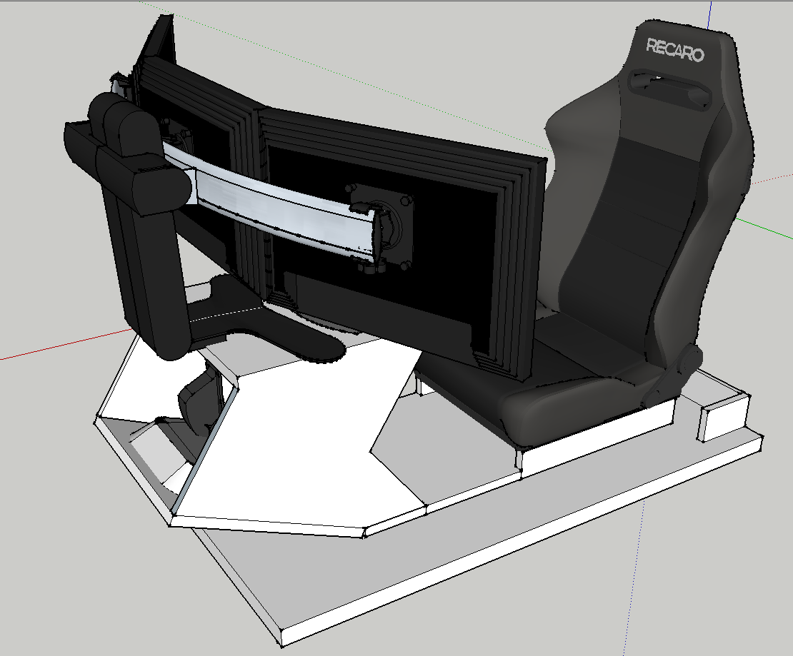

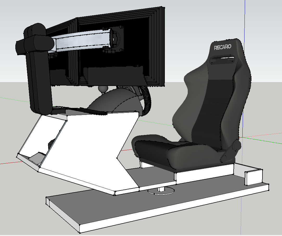

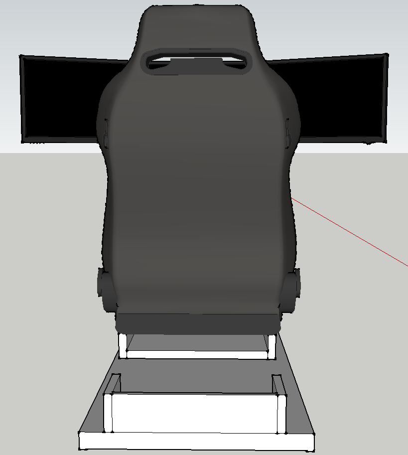

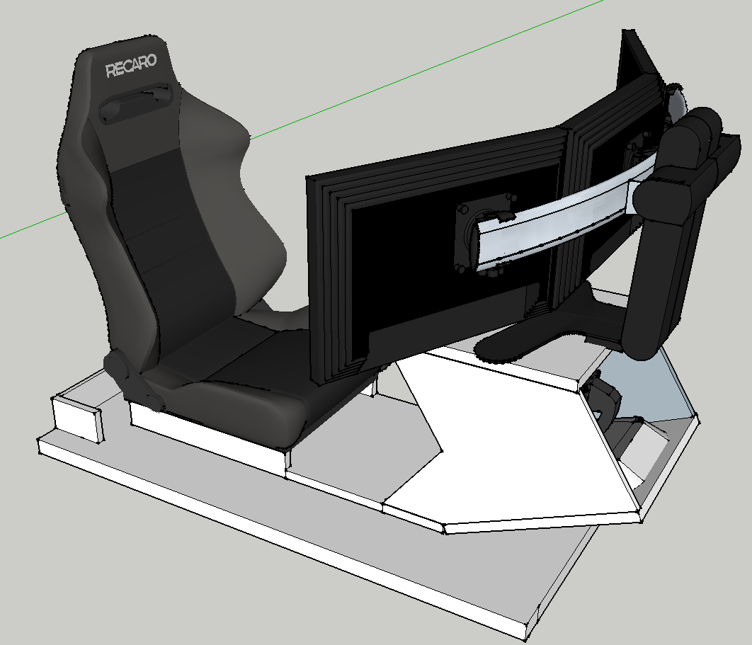

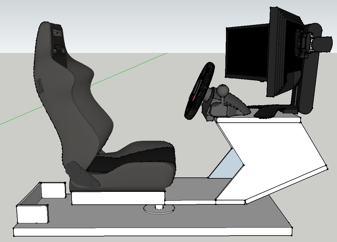

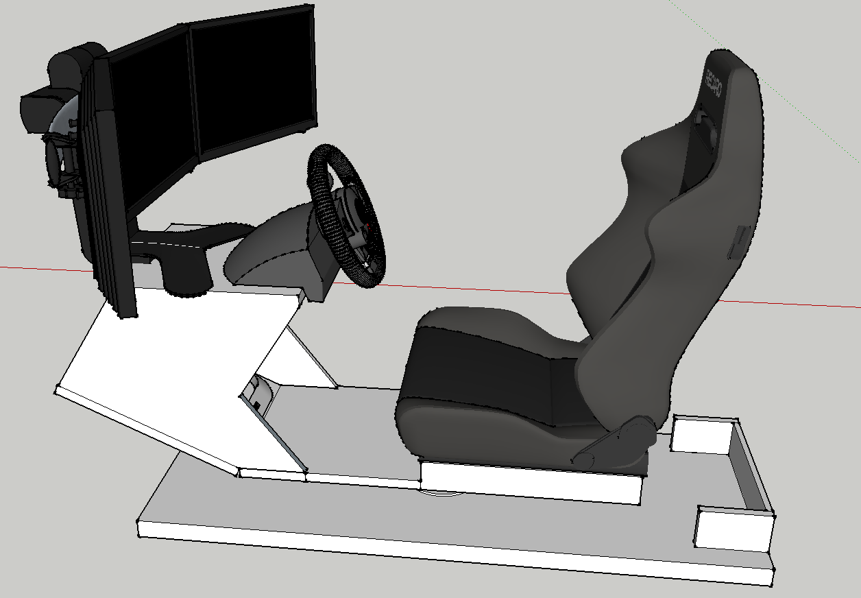

    I would like to thank @bsft , @noorbeast , and @prodigy for encouraging me to start this thread and post my project.
    My project is primarily inspired by racingmat's 2dof racing sim using wiper motors.
    Here are the first 3d models I designed: 1.PNG 1.PNG

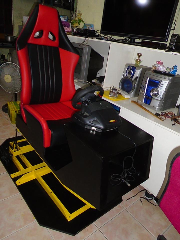

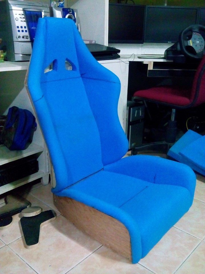

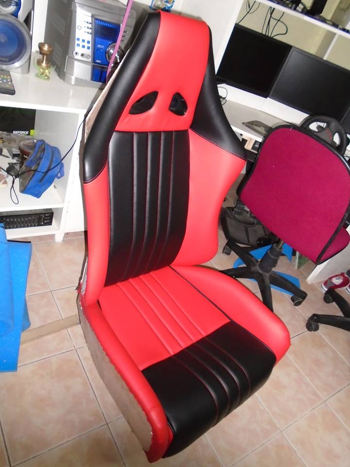

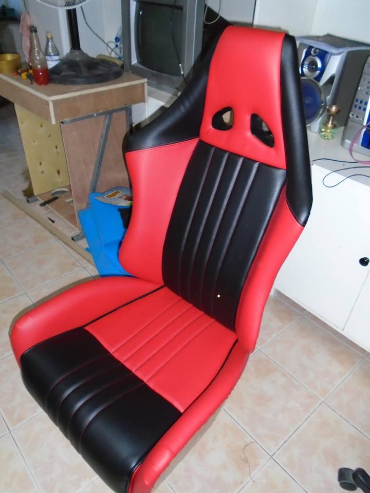

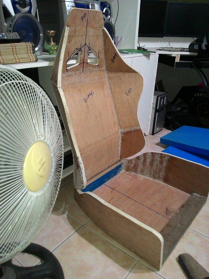

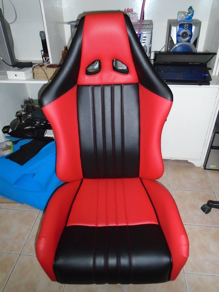

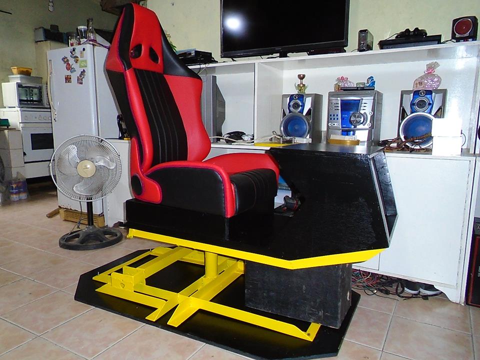

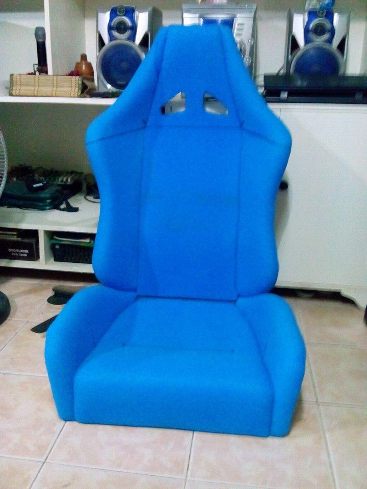

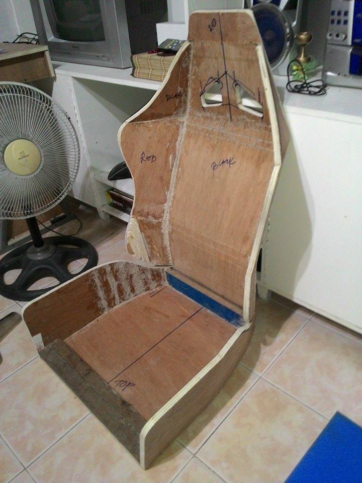

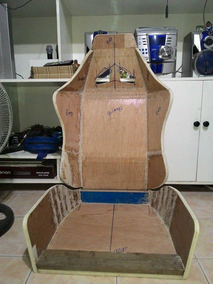

    as this project was intended to be a low cost one, we decided to make our own seat:
    • Like Like x 6
  3. prodigy
    prodigy Burning revs
    Oct 27, 2013
    459
    Croatia
    6,698Coins
    +399 / 4 / -0
    Your project sketch looks very nice :thumbs
    On other side, it also looks very heavy full frame platform with triple monitor stand - for wipers to move all that. It must be perfectly balanced for wipers in that case..
    Where have you planned to put motors and connect them?
  4. Wanegain
    Wanegain Active Member
    Nov 6, 2013
    564
    Bruxelles
    1,971Coins
    +298 / 2 / -0
    I like your Seat :thumbs !! Is it you who made sewing ?
    It's not too heavy ?
    I would like to build mine, but I have no idea how to make the upholstery (not sure about this word, sorry...) :(

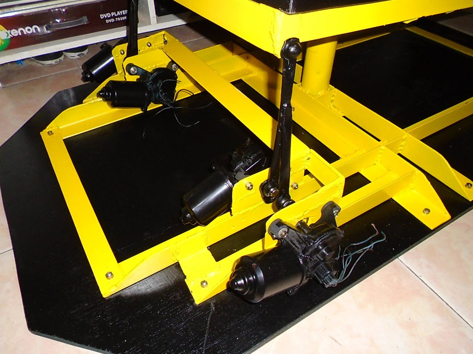

  5. Jomar_Sarto
    Jomar_Sarto Member
    Dec 29, 2014
    35
    Kampong Padang Kulim, Kedah, Malaysia
    79Coins
    +12 / 0 / -0

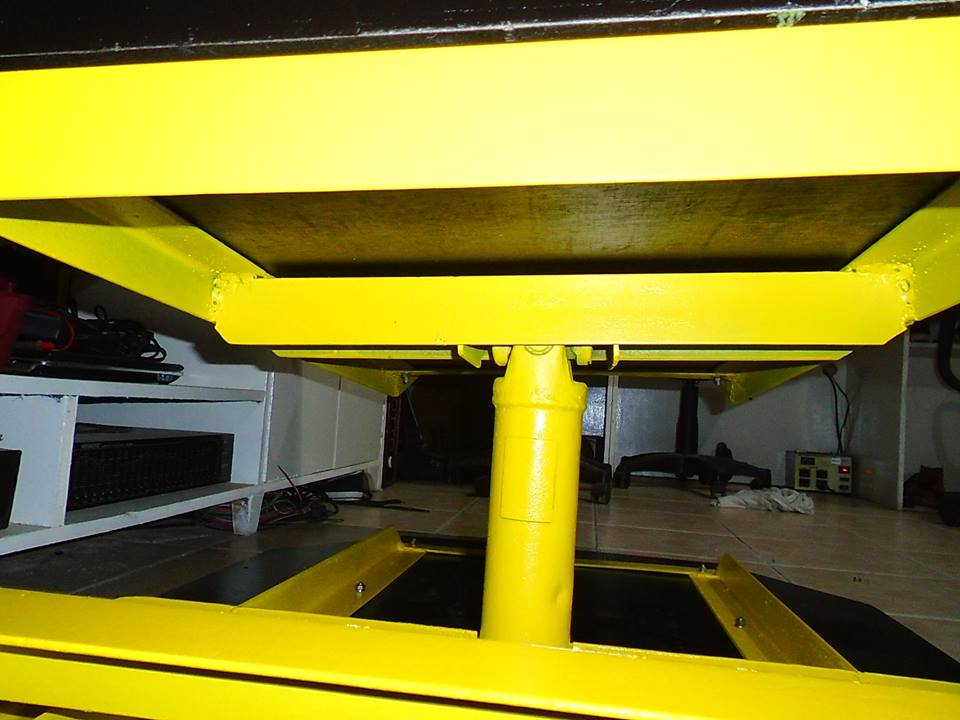

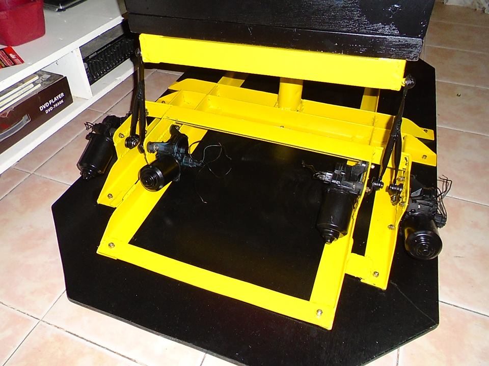

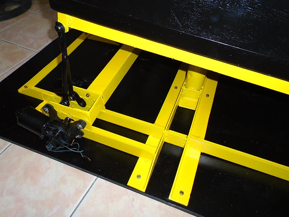

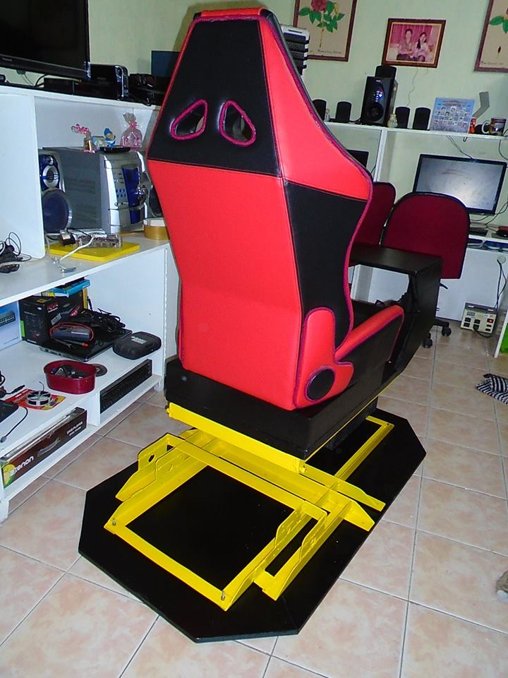

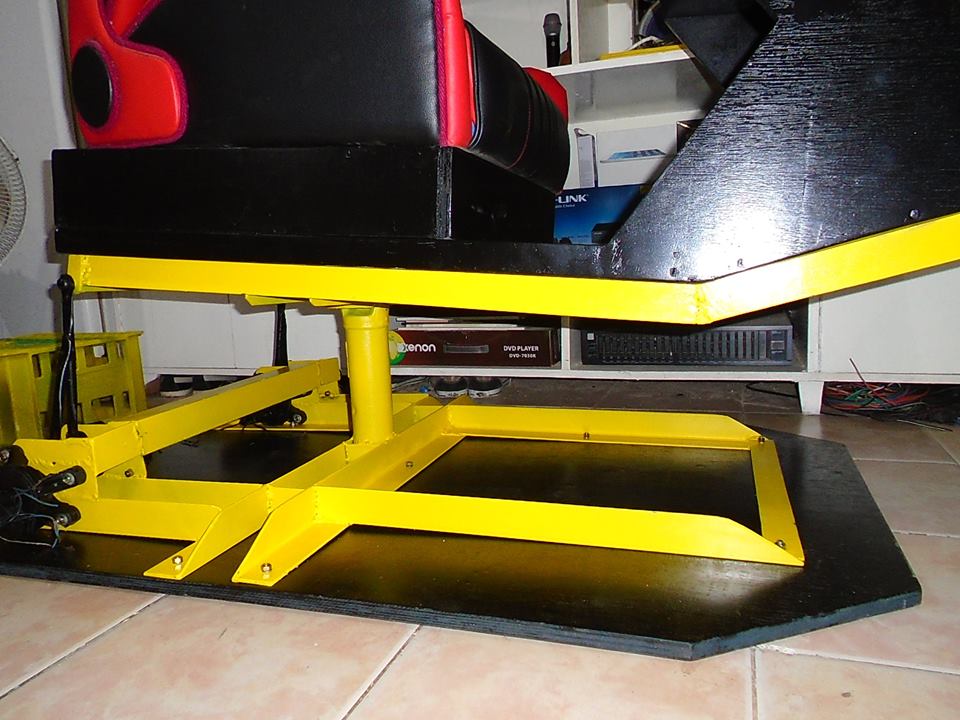

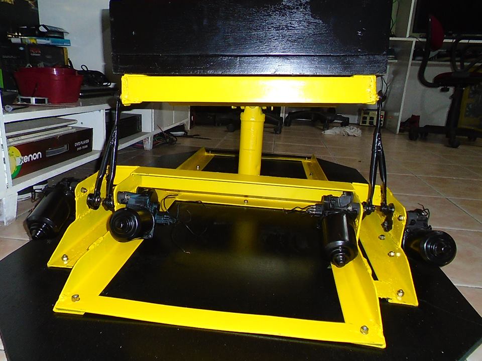

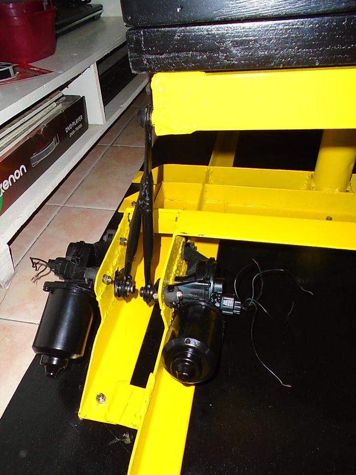

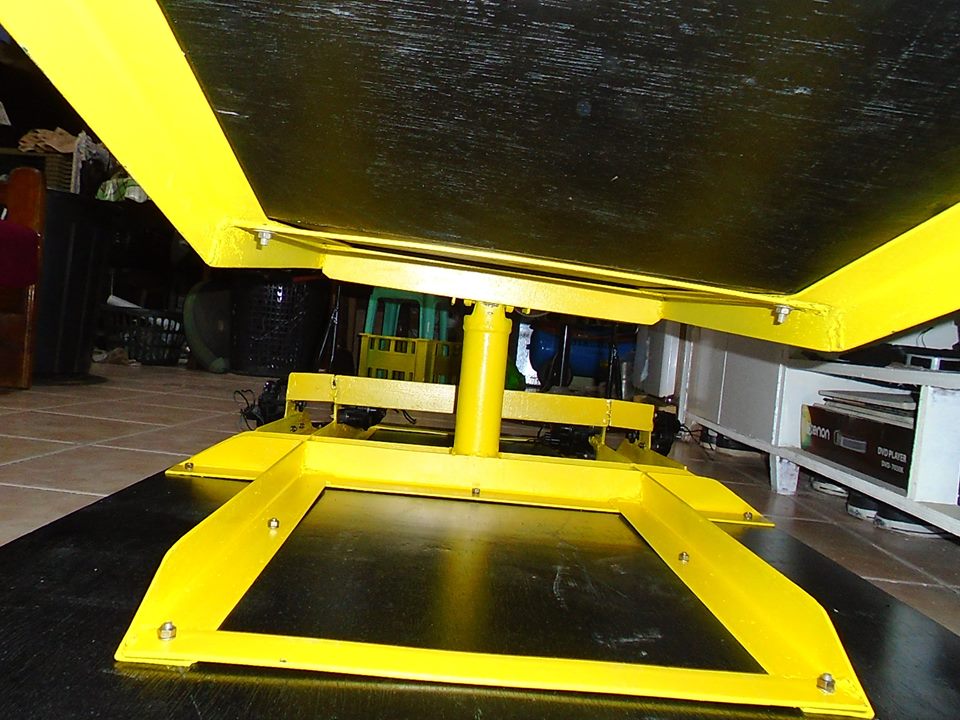

    here are the metal structures of the project:

    very curious how synchronized you get those motors
  7. Wanegain
    Nov 6, 2013
    564
    Bruxelles
    1,971Coins
    +298 / 2 / -0
    Hmmm...
    Using 4 motors is a good idea but what will happen if your motors rotate in opposite directions o_O ?
  8. Jomar_Sarto
    Jomar_Sarto Member
    Dec 29, 2014
    35
    79Coins
    +12 / 0 / -0

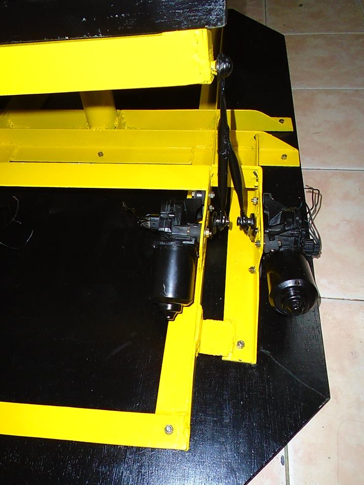

    my father is the one who did most of the work as I am currently here at Malaysia. I just direct him what to do.. the project is slightly heavy but we manage to find the center of gravity.
    we plan on using 2 x wiper motor per side..overall it will have 4 motors.. here is where I need your help guys! I need inputs on how could I run two motors simultaneously.. :)
  9. Jomar_Sarto
    Jomar_Sarto Member
    Dec 29, 2014
    35
    79Coins
    +12 / 0 / -0
    @Wanegain, if the motor turns on opposite directions, you just need to swap pout the polarity of the motor to change it's direction..
    @shannonb1 , I read something about using two Arduino uno's to control the other motor..the problem is the code for it. i'm still new to Arduino coding..help would be much appreciated.. :)
  10. Jomar_Sarto
    Jomar_Sarto Member
    Dec 29, 2014
    35
    79Coins
    +12 / 0 / -0
    @prodigy, we manage to find the center of gravity sir including all the possible weight (monitors+seat+wheel+driver)..
    the positioning of the wiper motors is shown on the pictures sir..
  11. bsft
    Good luck! I recall someone else did it, but no longer saw an action from it after that.
    However, there may be an idea, as you are using arduino, whos code will you use?

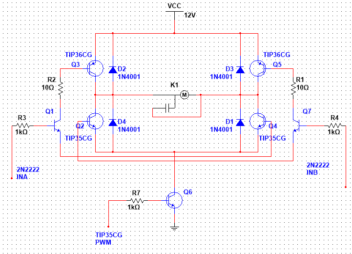

    Thanks for your inputs, @bsft and @noorbeast ! I plan to use and play around with the code used by @RacingMat.. Is it even possible to use 4 motors in one Arduino? ofcourse it will have 4 potentiometers also. If it is not possible through codes, maybe i'll try to design a circuit that will compare the voltage potentials of the pots and do some kind of a buffer to make a single output for the arduino's analog input.
    I plan on using an H-bridge to control the motor.. here is my design:

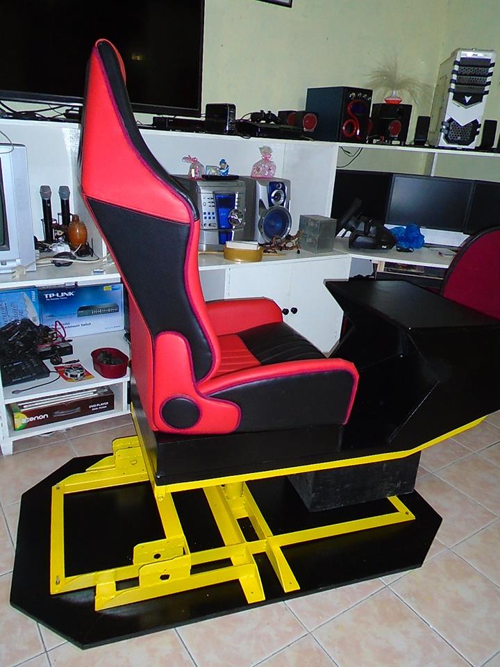

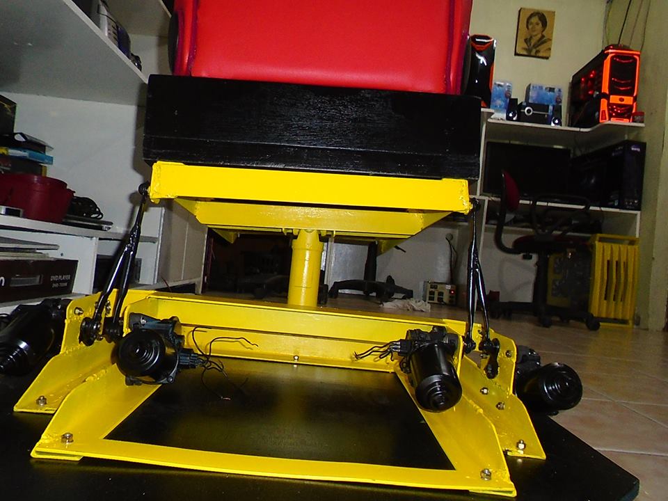

    here's what it looks like when the parts are bolted in:
  15. noorbeast
    21,032
    147,890Coins
    +10,880 / 54 / -2

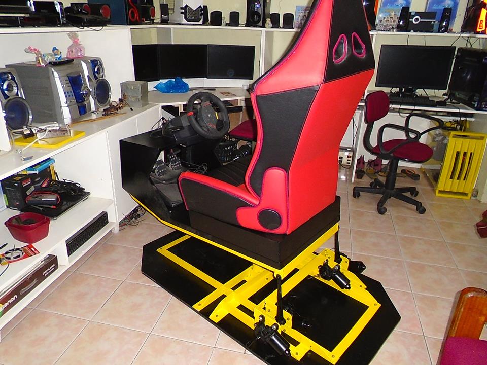

    It looks really nice and the custom seat is a work of art.
    Have you got a total weight for the top frame and all that goes on it, including yourself? I am guessing wiper motors would really struggle, particularly with triple screens.
  16. Jomar_Sarto
    Jomar_Sarto Member
    Dec 29, 2014
    35
    79Coins
    +12 / 0 / -0
    Thanks @noorbeast ! the weight is approximately 100kg (yeah, very heavy :) ) including my dad..whose weigh much more compared to me..we tested it with two motors only and it can still move but struggles a bit during lifting motion, so I think it can be improved with the 3rd and 4th motor attachment provided that they are synchronized.. we plan on making the monitors static if the motors can't really handle them..
  17. noorbeast
    21,032
    147,890Coins
    +10,880 / 54 / -2
    The static monitors is a good idea, given the weight.
    I guess you will find out one way or the other but I suspect that going to bigger DC motors with 60:1 gearboxes may be a more costly but simpler solution that trying to sync wiper motors. But as you already have the wiper motors it is worth a shot at trying to make the wiper sync work.
  18. shannonb1
    shannonb1 Well-Known Member
    Mar 12, 2008
    1,107
    Sales Intelligence
    Virginia
    8,909Coins
    +598 / 5 / -0
    I mean I suppose you could use just 1 arduino and 2 motor drivers each but I feel like getting those motors to be exact with each other is going to be a challenge. I would recommend going with a 50/60:1 gear ratio and prob just the 60.
  19. shannonb1
    Mar 12, 2008
    1,107
    Sales Intelligence
    Virginia
    8,909Coins
    +598 / 5 / -0
    just another thought..put 2 engines on the front and 2 on the back.....wont help with weight but man you got that thing high up in the air and I don't think you will end up liking that over time. To each his own.

    That seat is indeed a work of art as stated by noorbeast
