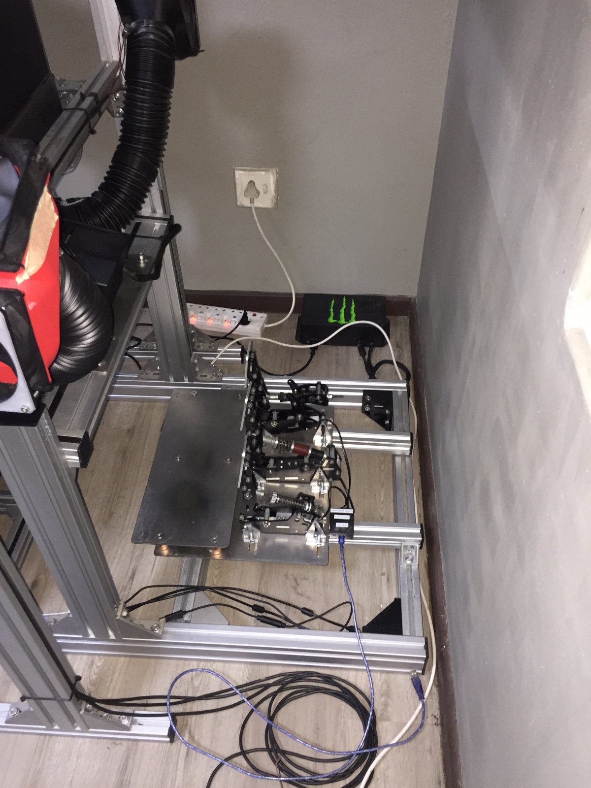

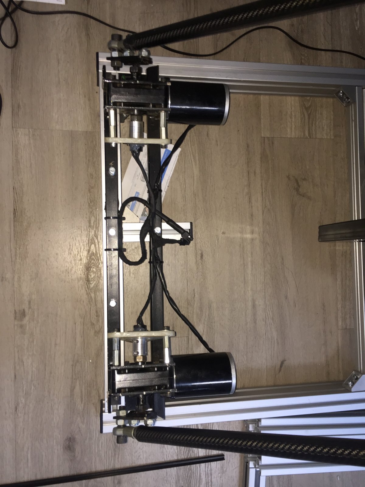

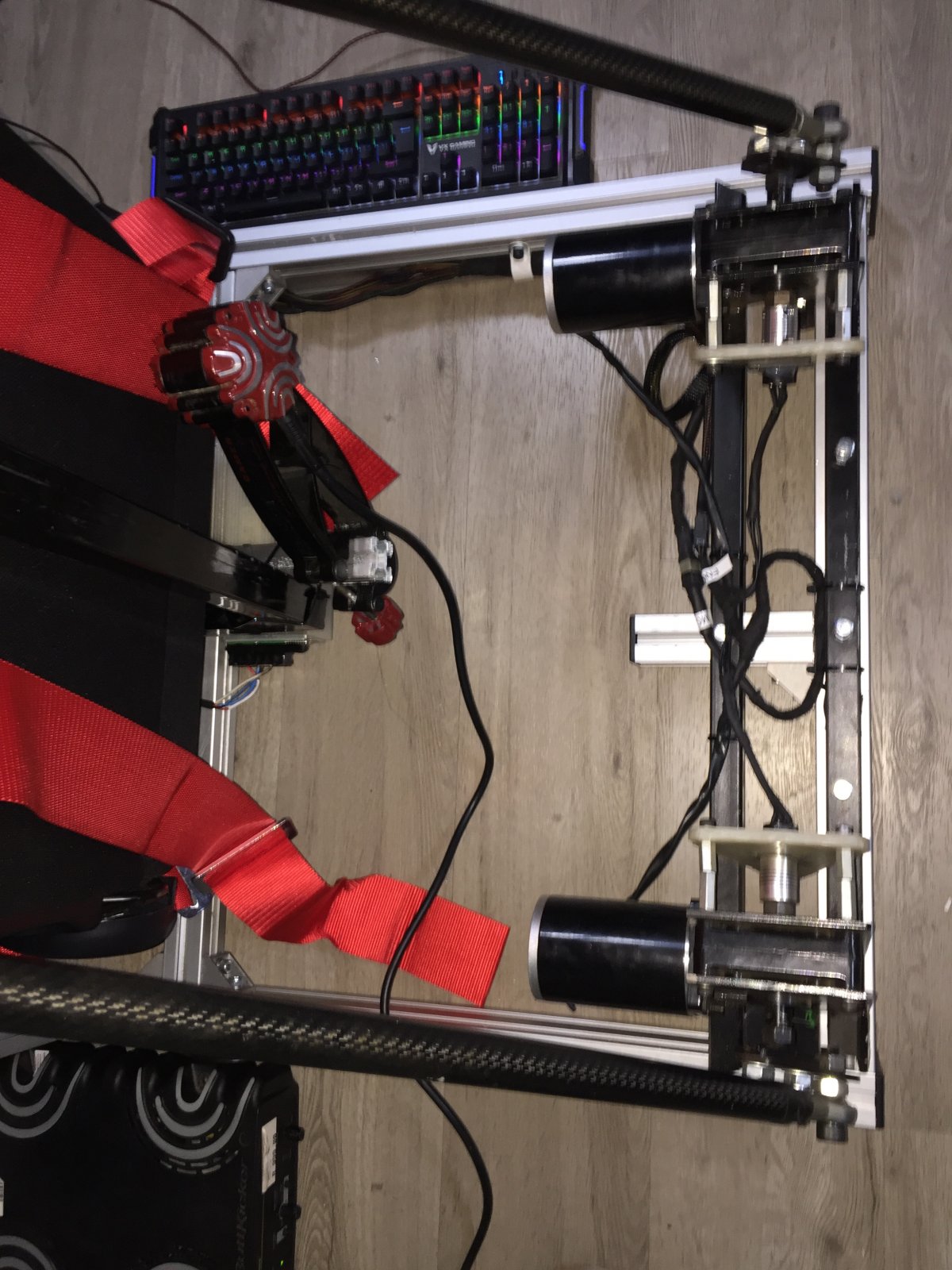

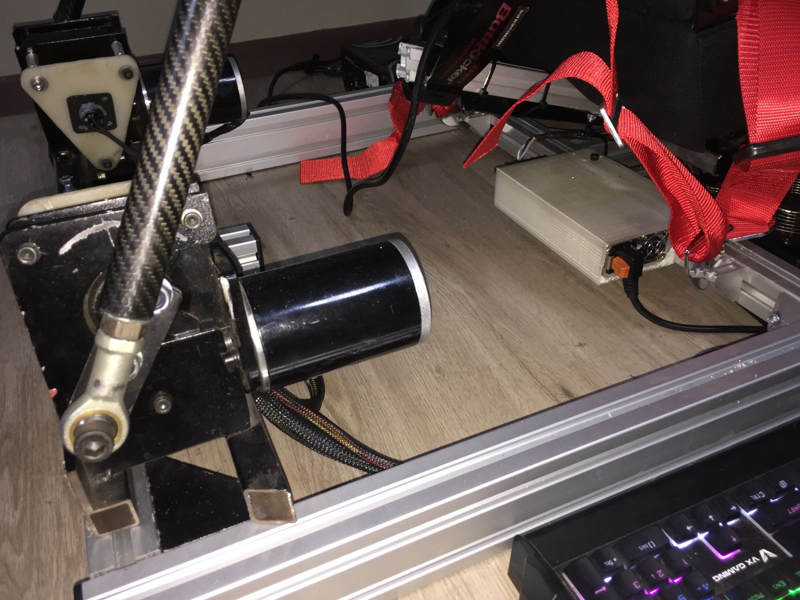

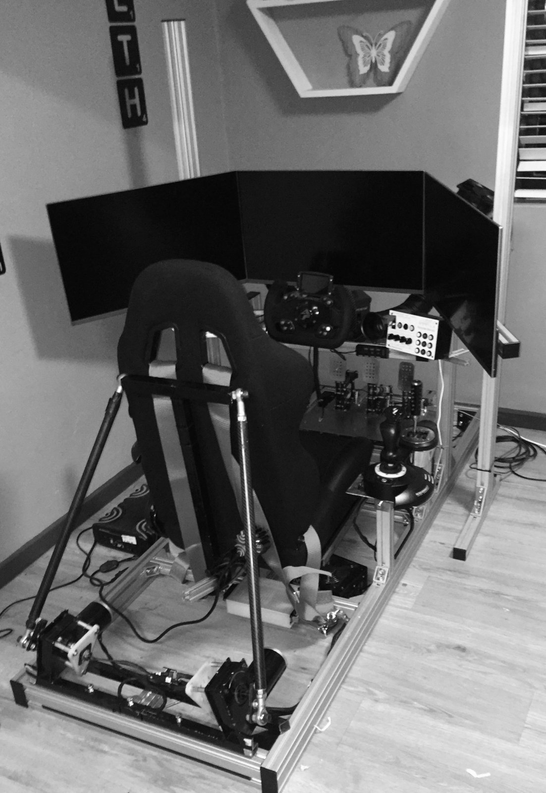

    Greetings All

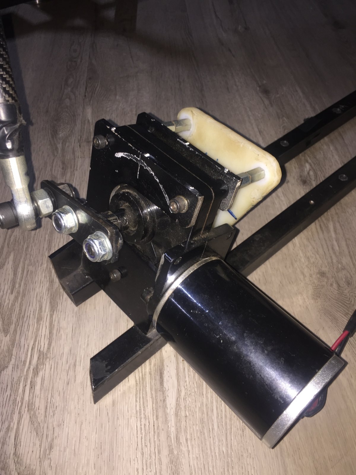

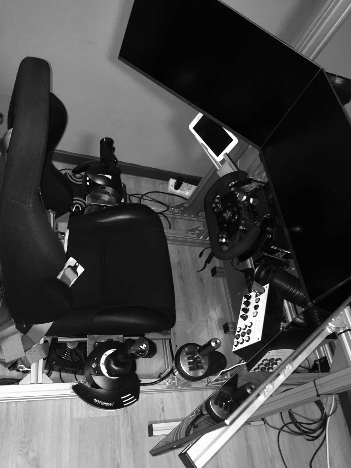

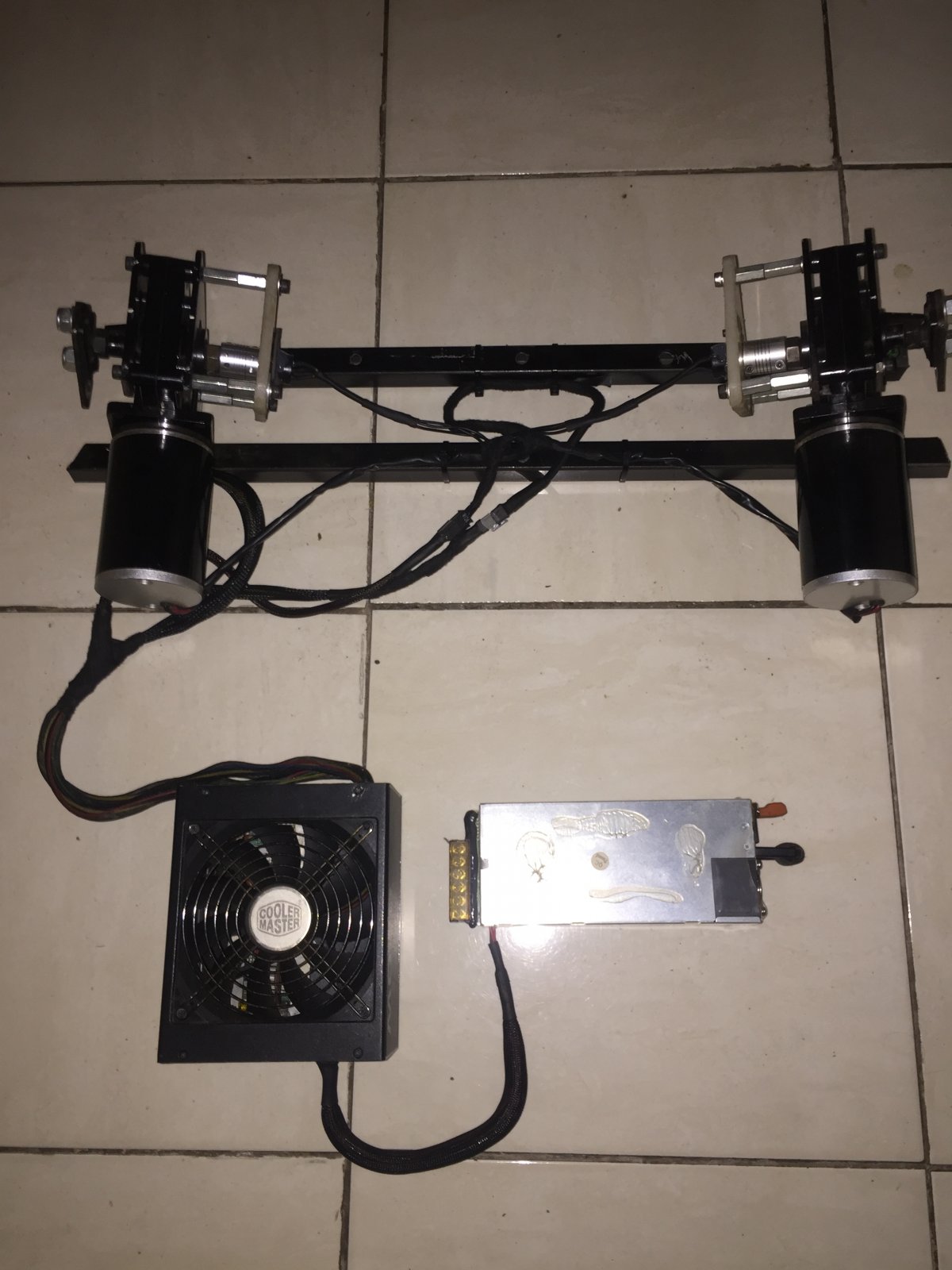

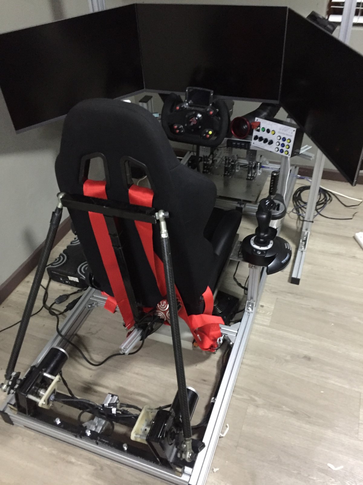

    Starting with the 2Dof motion platform, using dof reality gearbox kit. with 4080/4040 Alum structure.
    2 x 12v gearbox
    2 x JRK12v12 controllers
    2 x 12v 750w Psu
    Software Sim Tools.
  2. Takumivs
    Takumivs Project CPT
    Nov 6, 2018
    80
    Mechatronics / Mechano Engineer
    South Africa
    38Coins
    +69 / 0 / -0
    2DOF, 3DOF, DC motor, AC motor, SCN5, SCN6, Arduino, JRK, Joyrider, SimforceGT, Motion platform, 4DOF, 6DOF

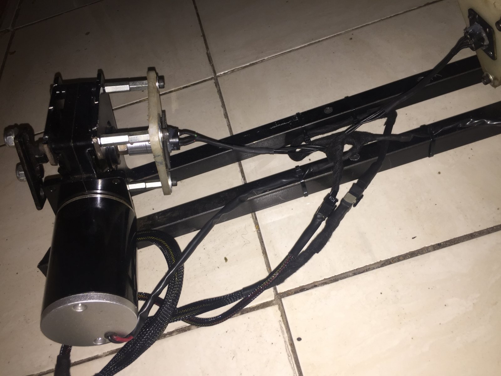

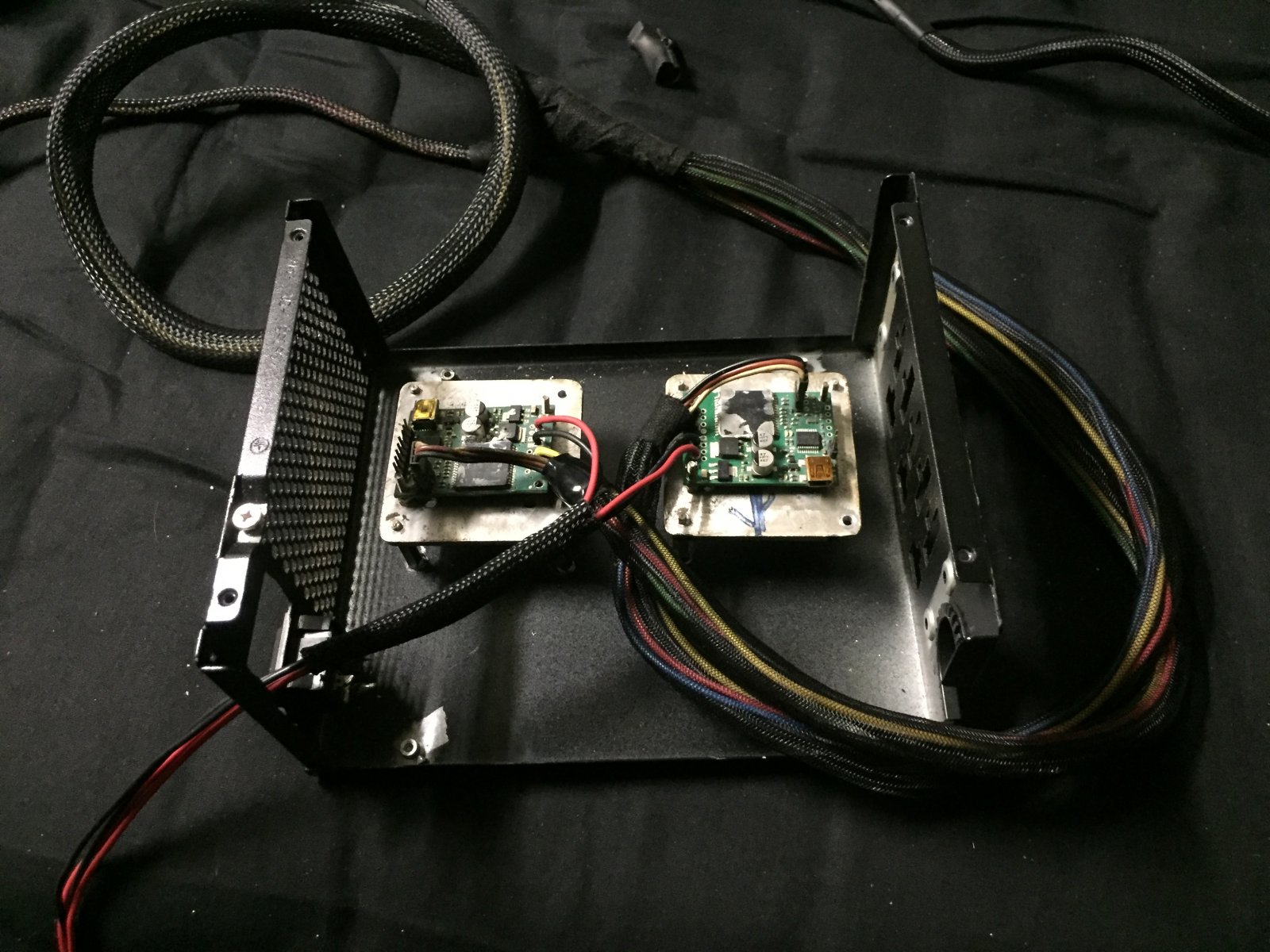

    Build the JRK12v12 controller into a psu box connecting the fan to the JRK controller. keeping the unit ultra cool.

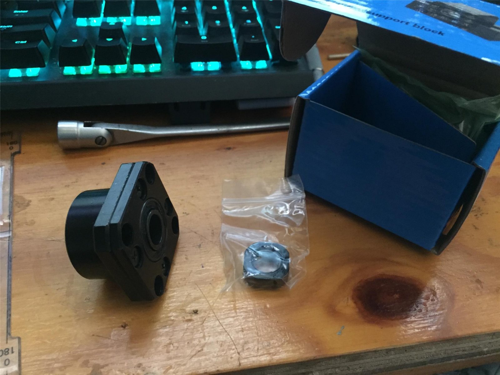

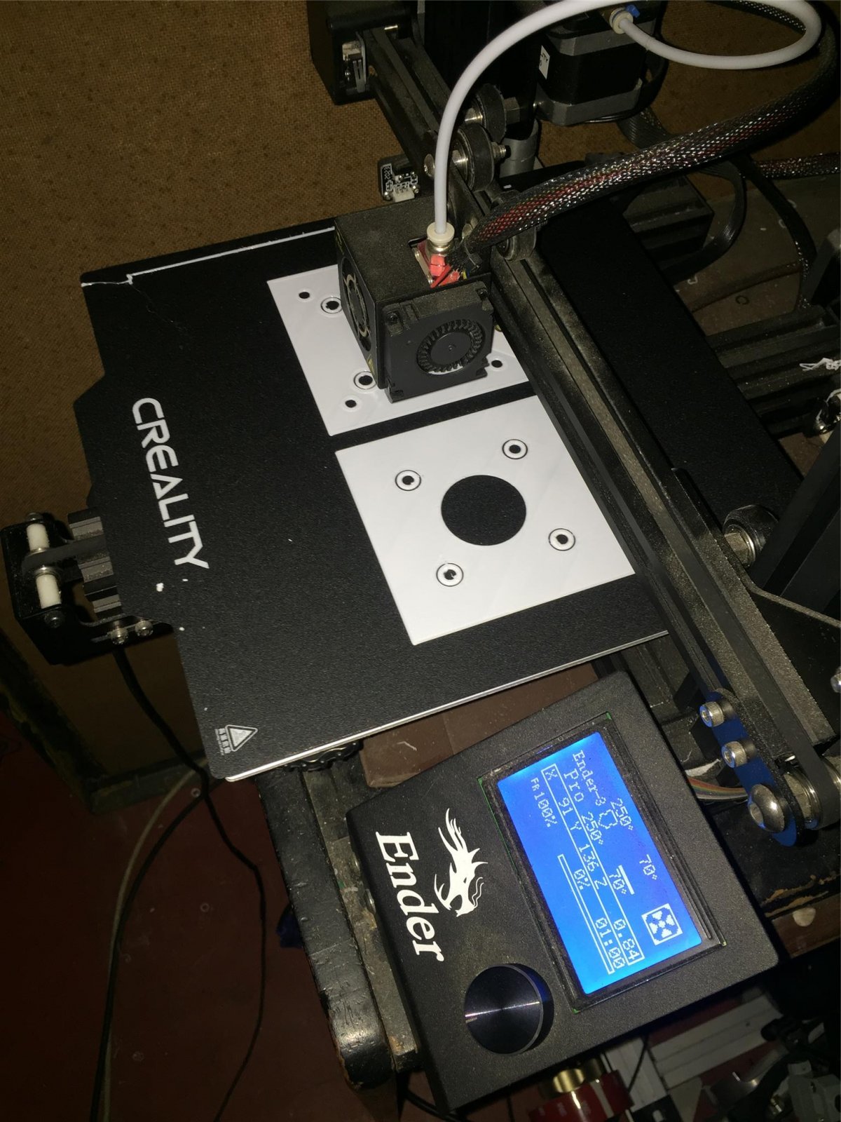

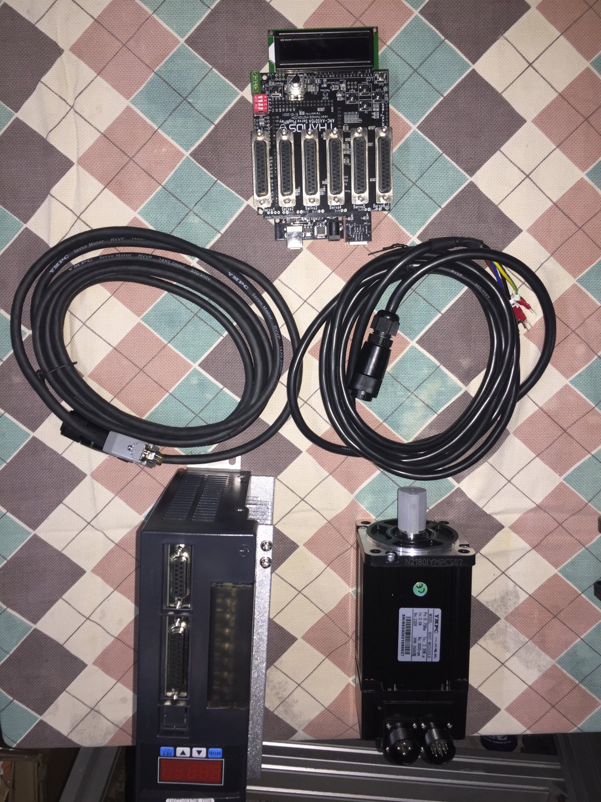

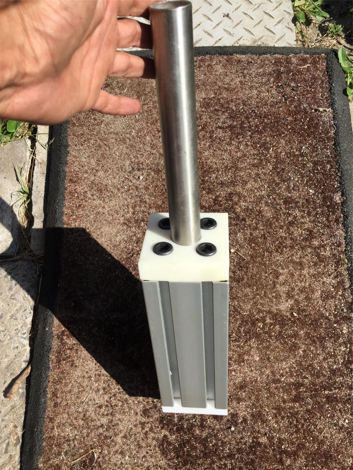

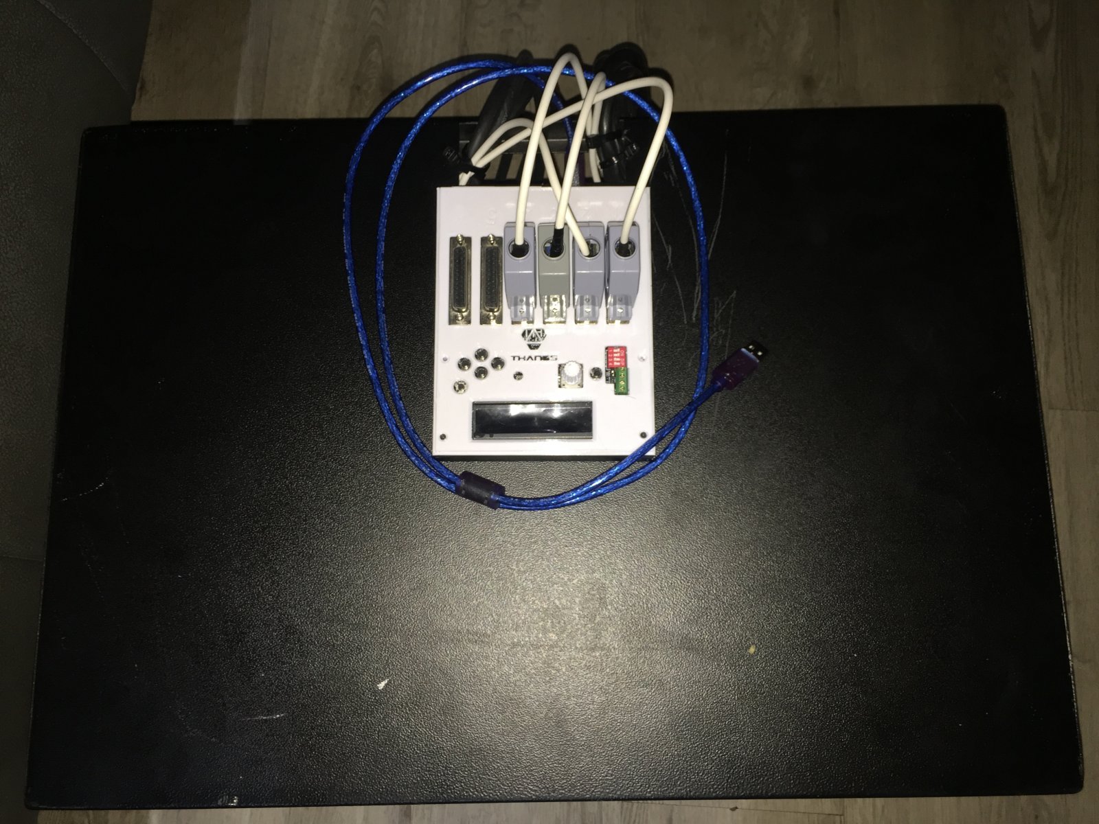

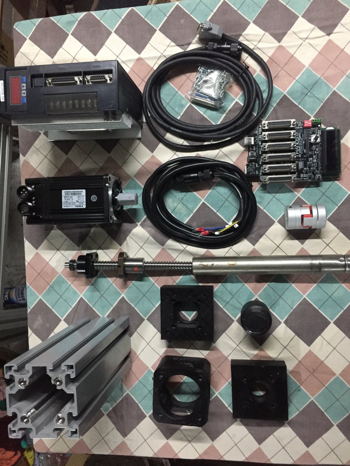

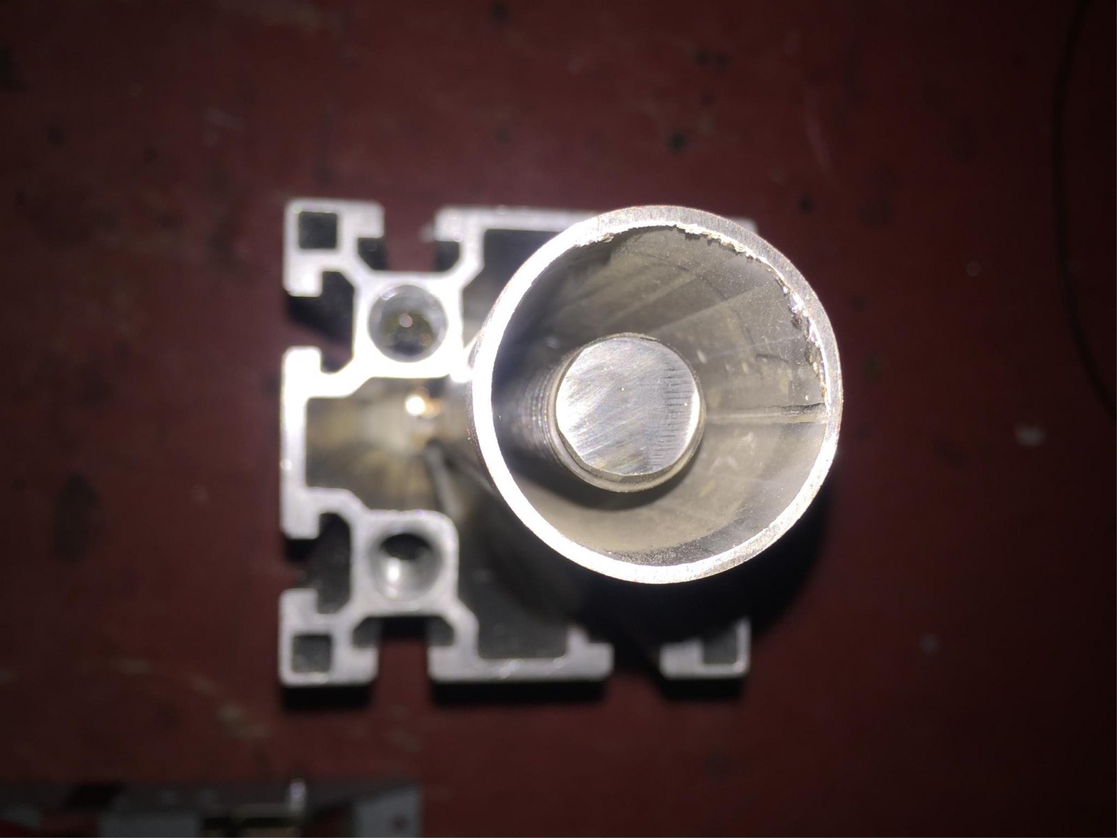

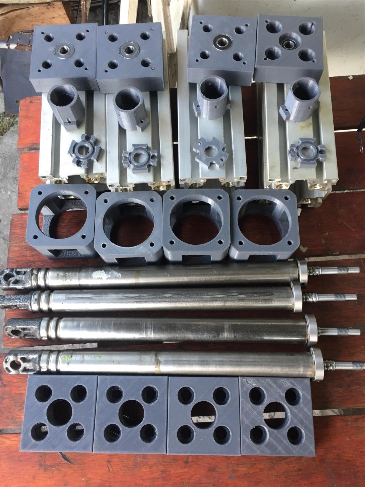

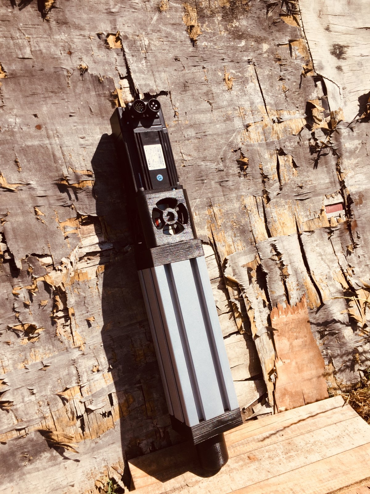

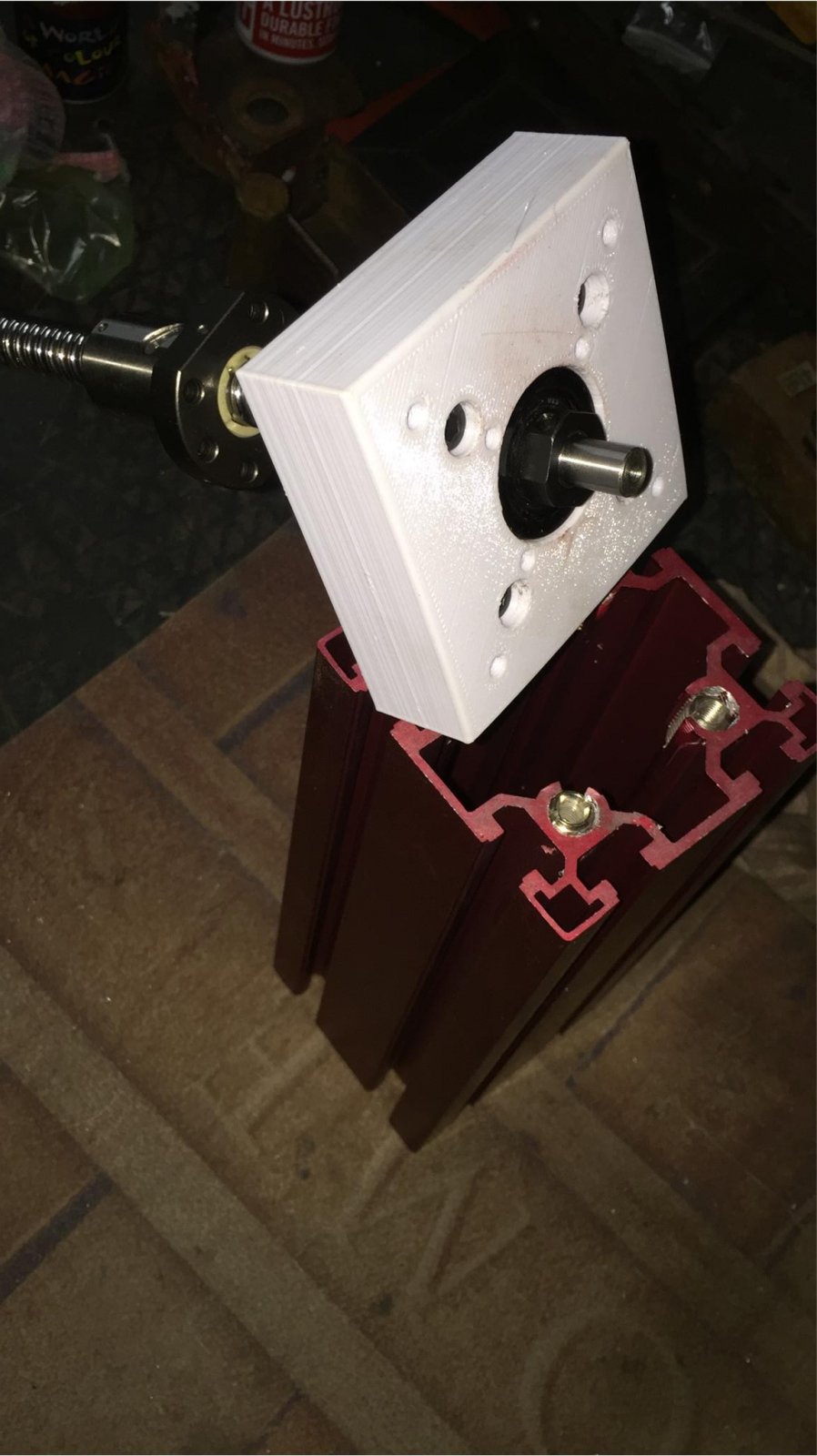

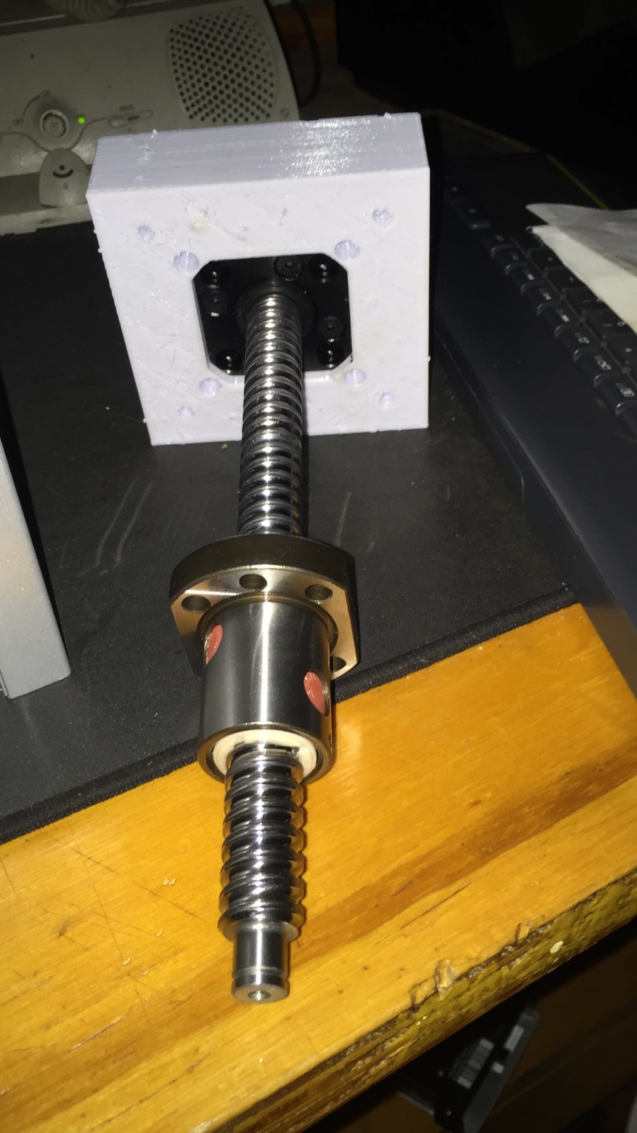

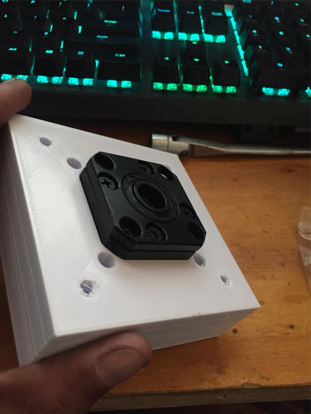

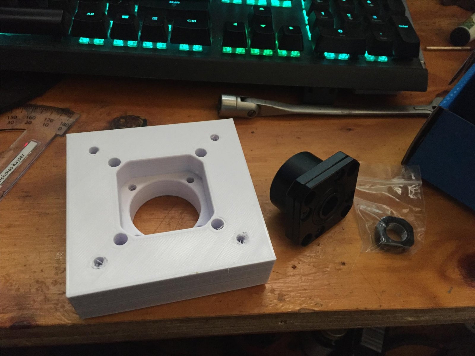

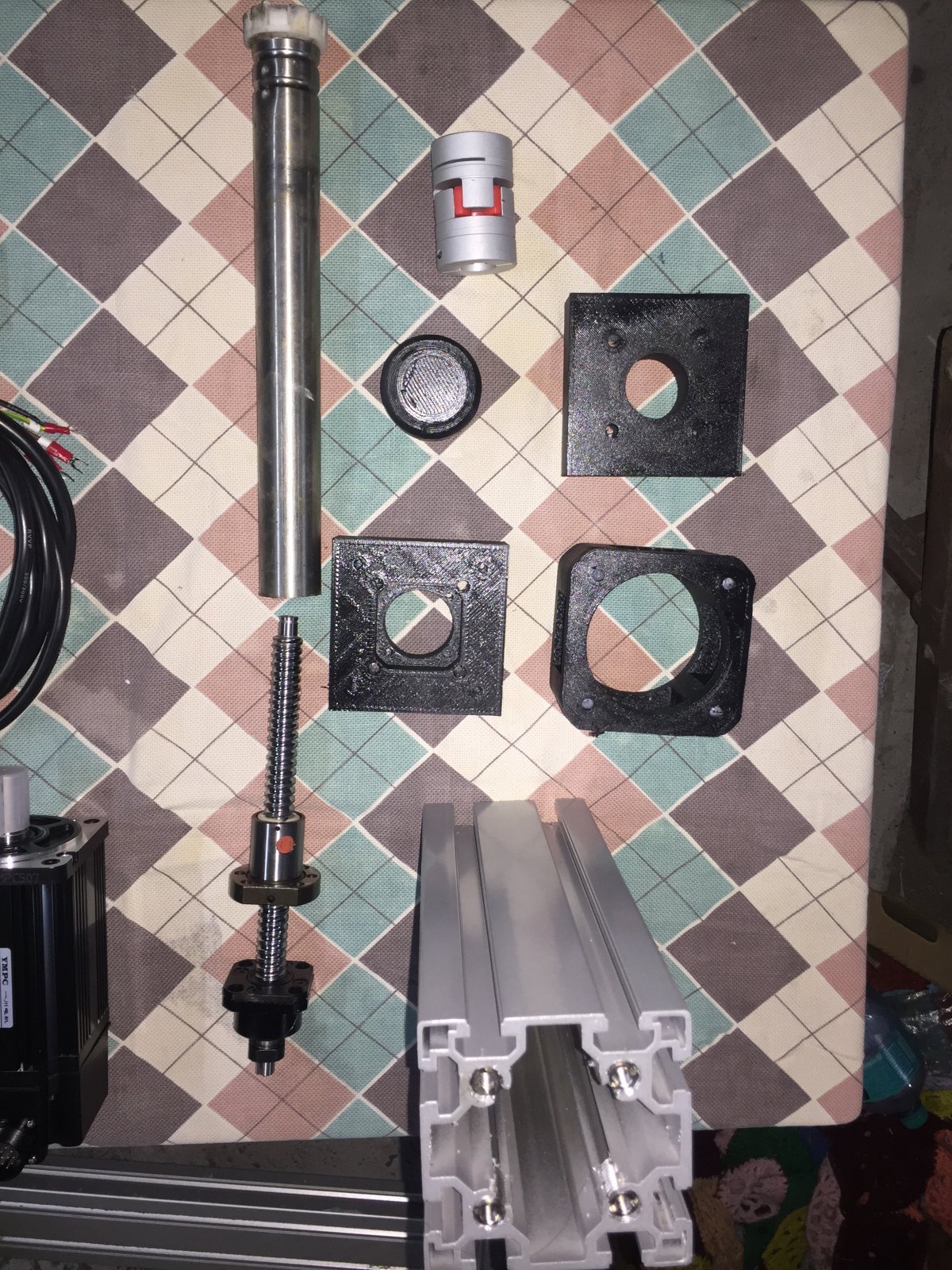

    While building the 2dof, I've ordered 90x90 modula profile and design the end caps to fit with the 80ST motors. The 1605 Balls diameter fit perfectly as the 100x100 profiles. going this route has been very cost effective in developing the SFX90
    1 x Thanos Controller
    4 x AASD15A driver
    Software
    Sim Racing Studios

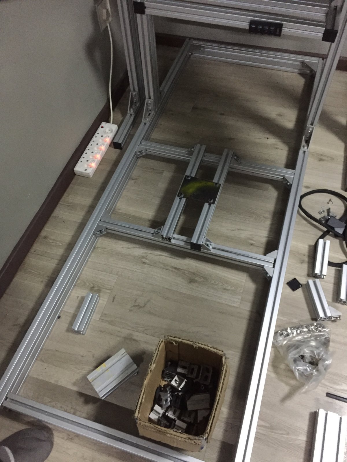

    Continuing with 2dof project,

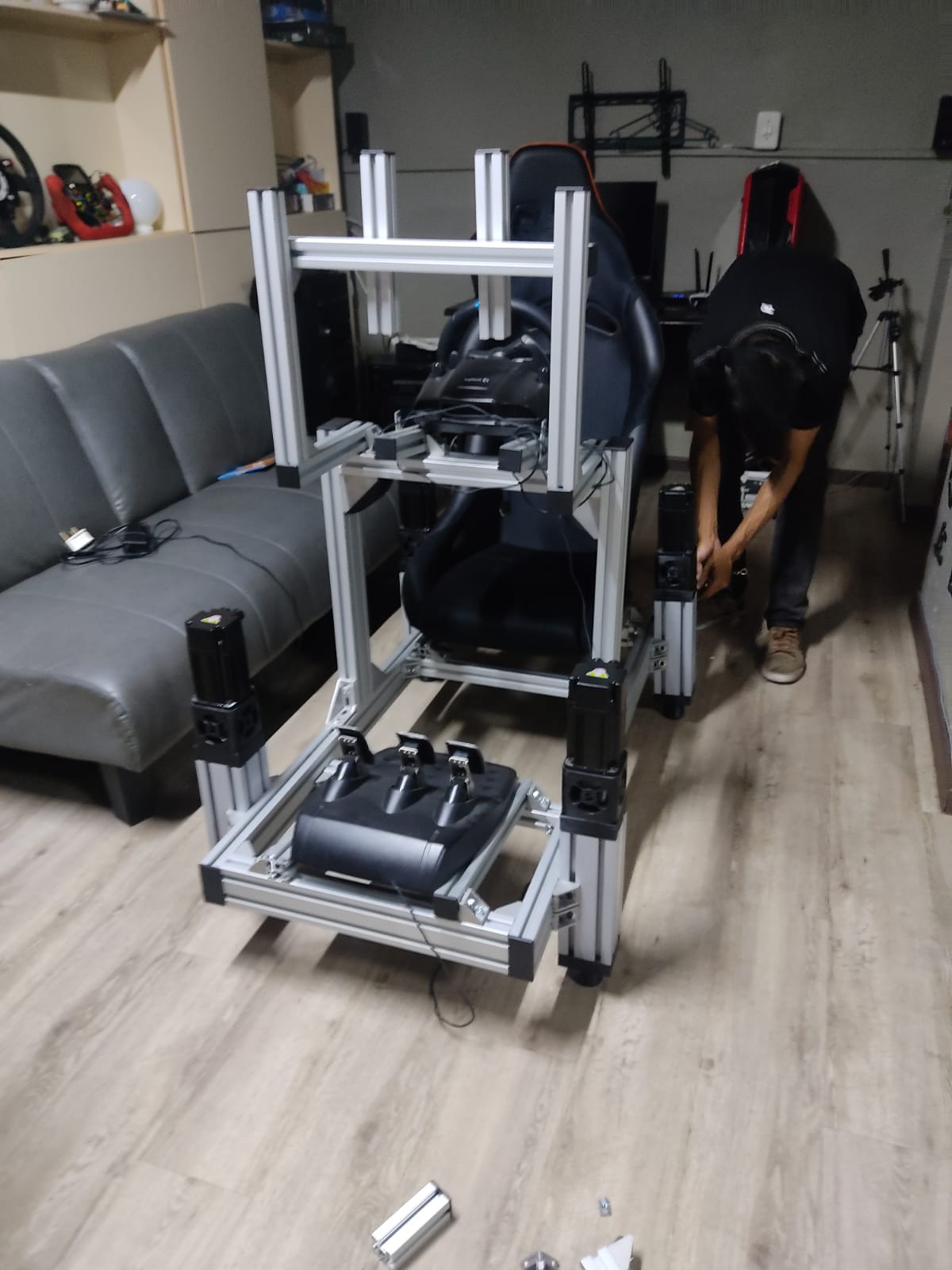

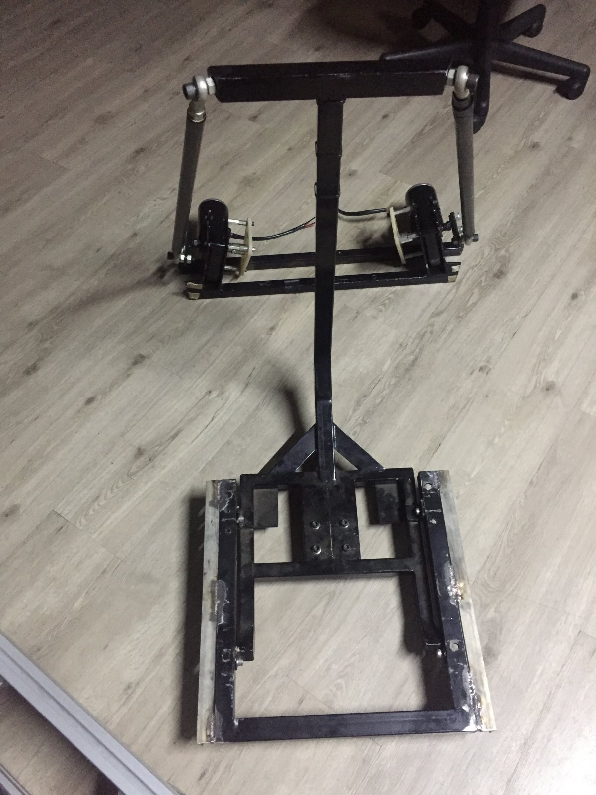

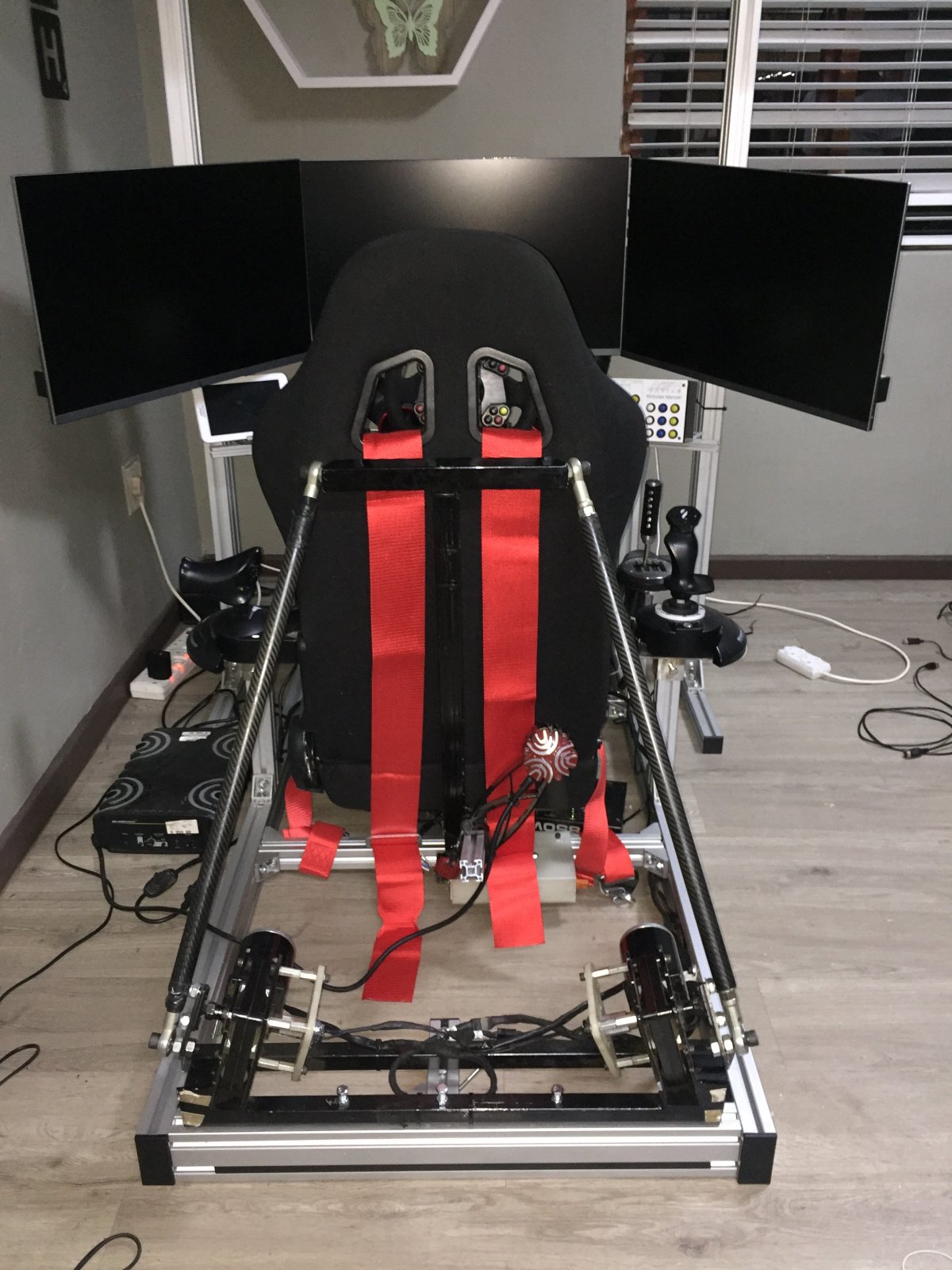

    Soon will update the SDF90 4Dof with 2Dof reality seat mover.

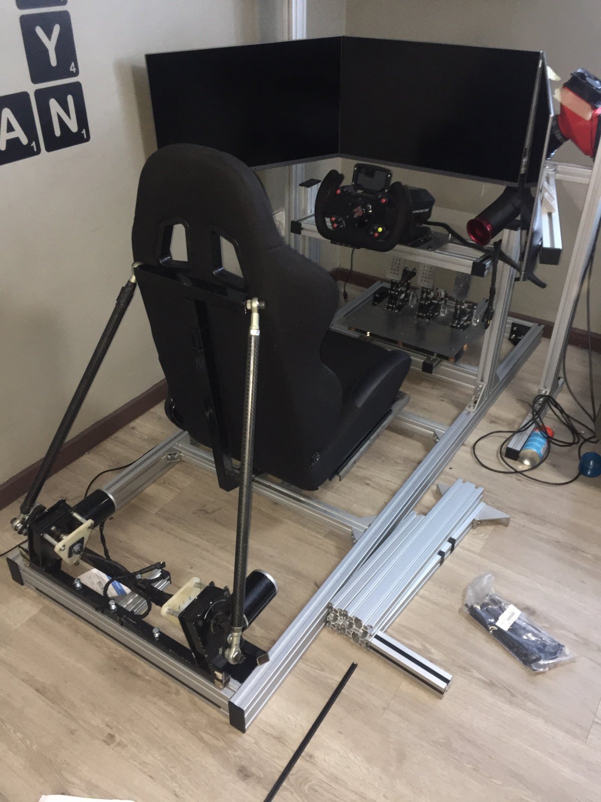

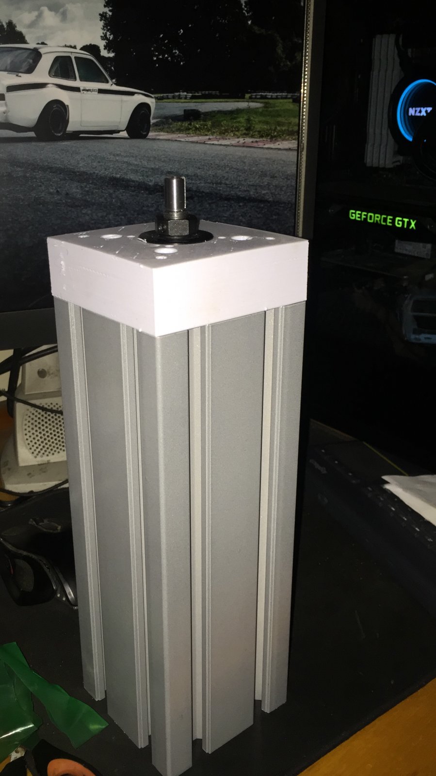

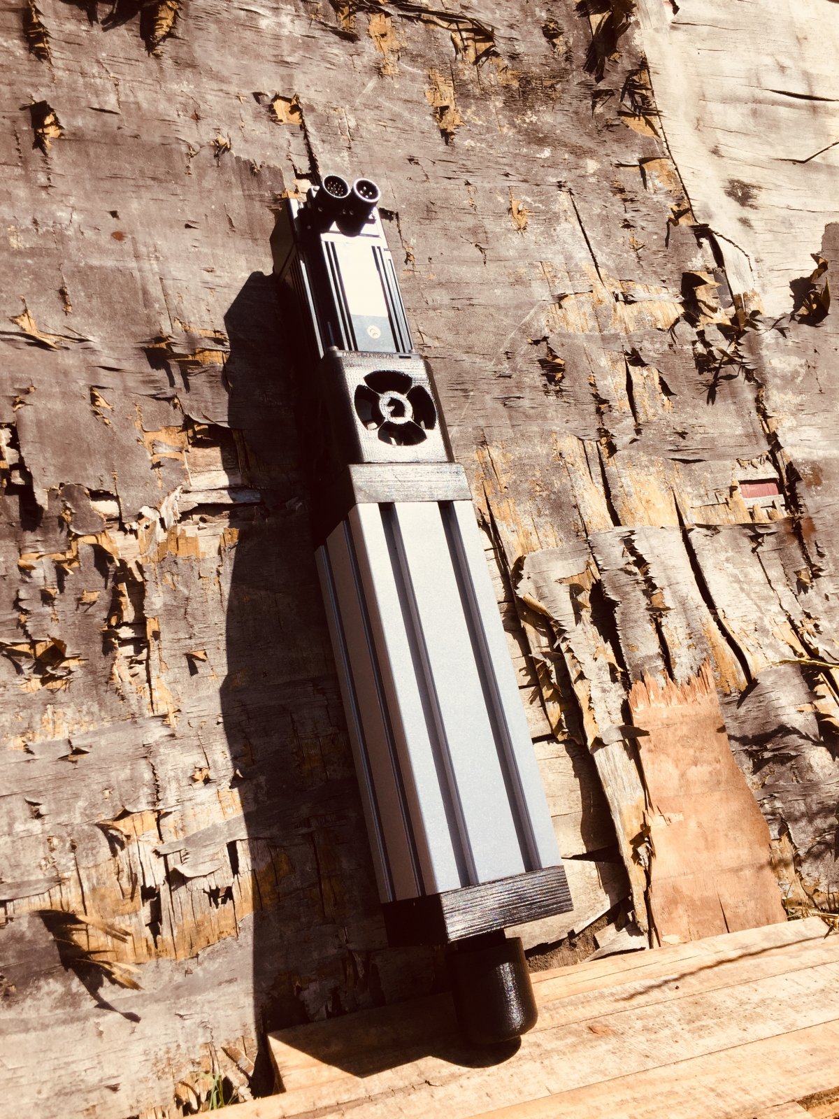

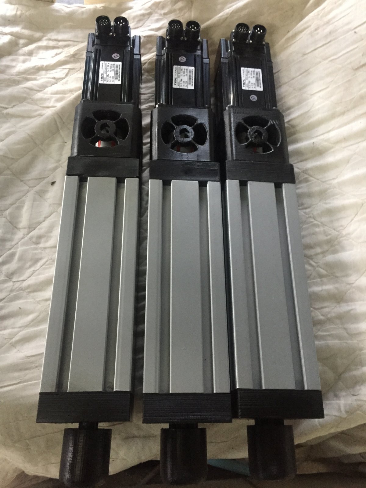

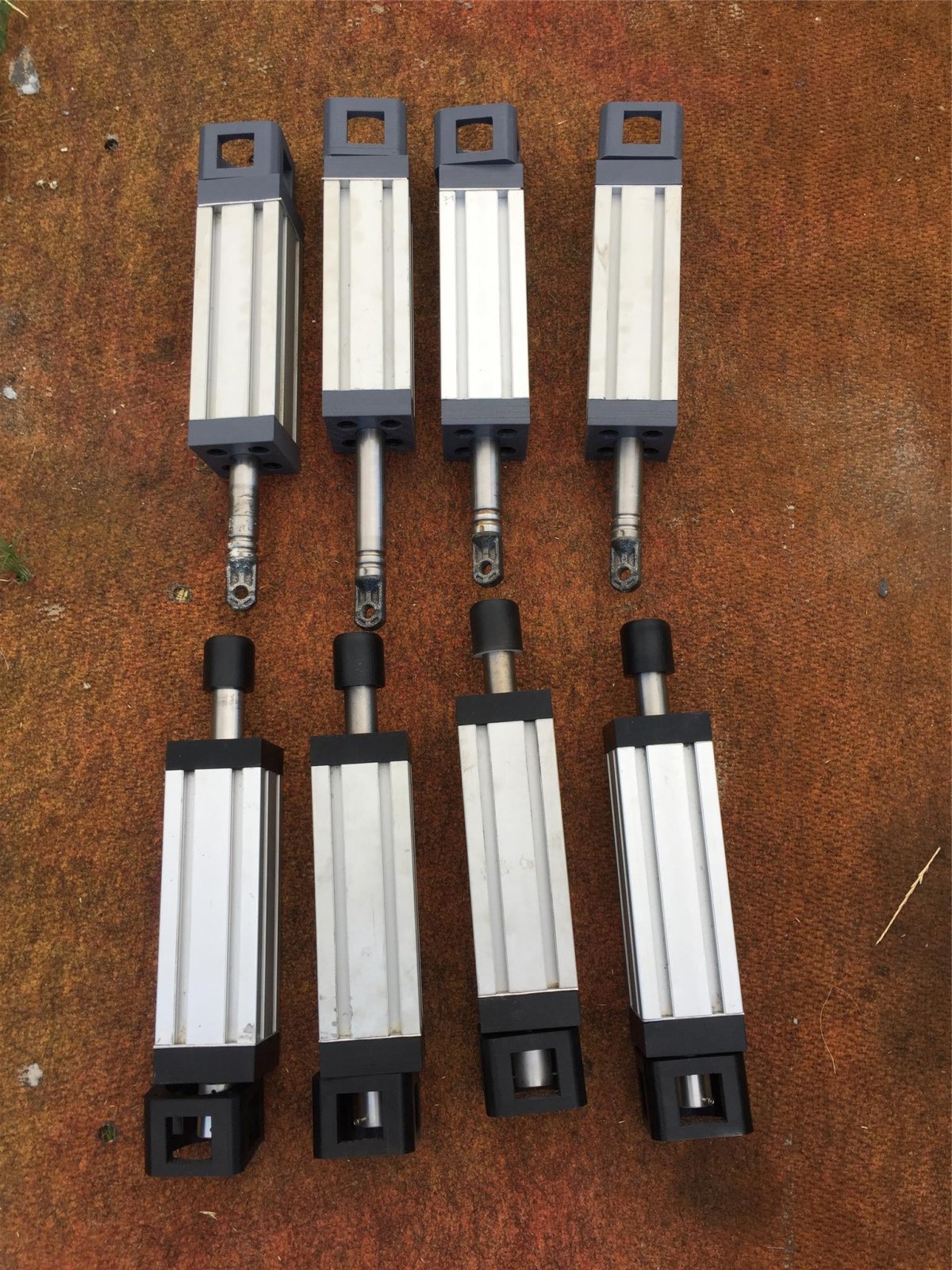

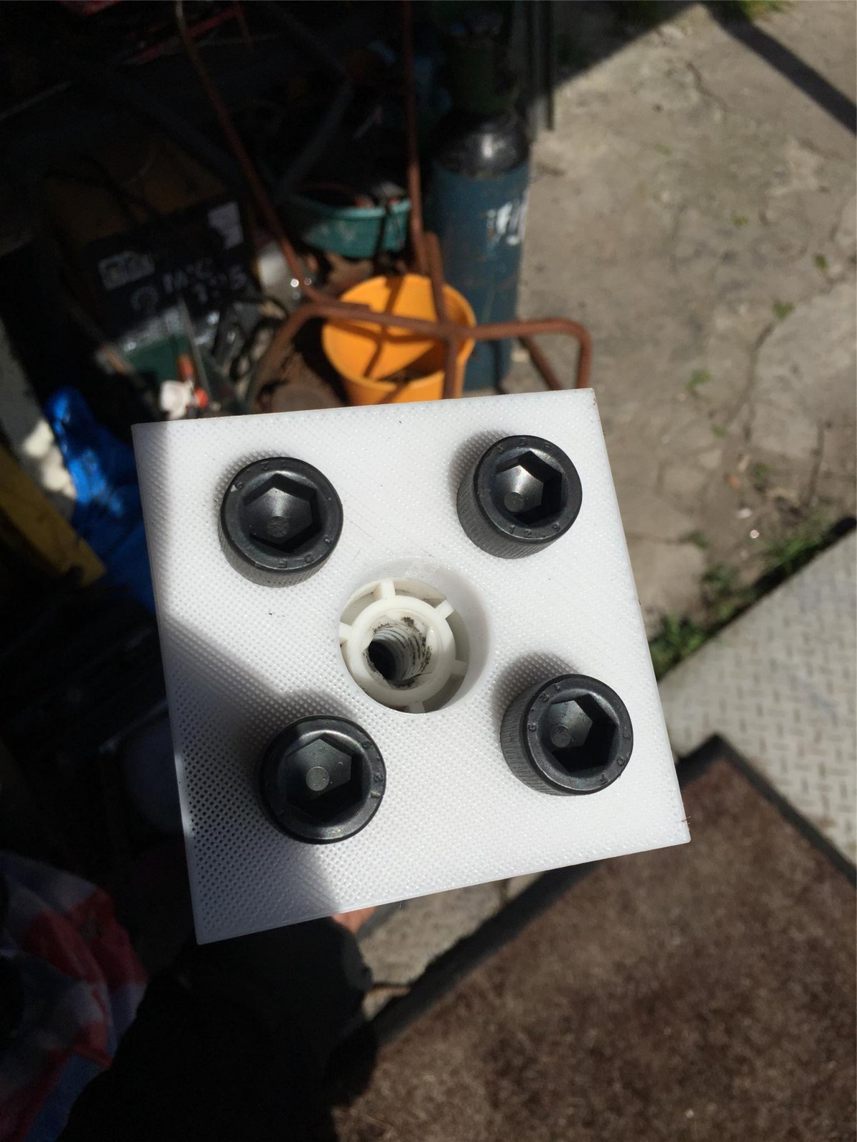

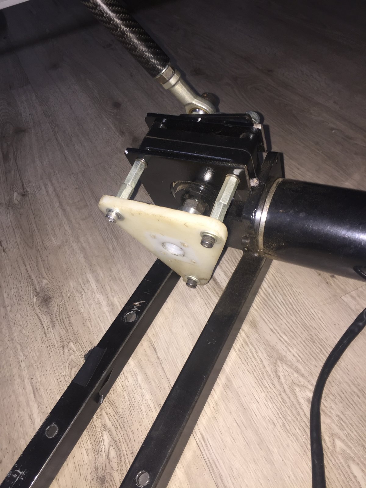

    First prototype design of the sfx90

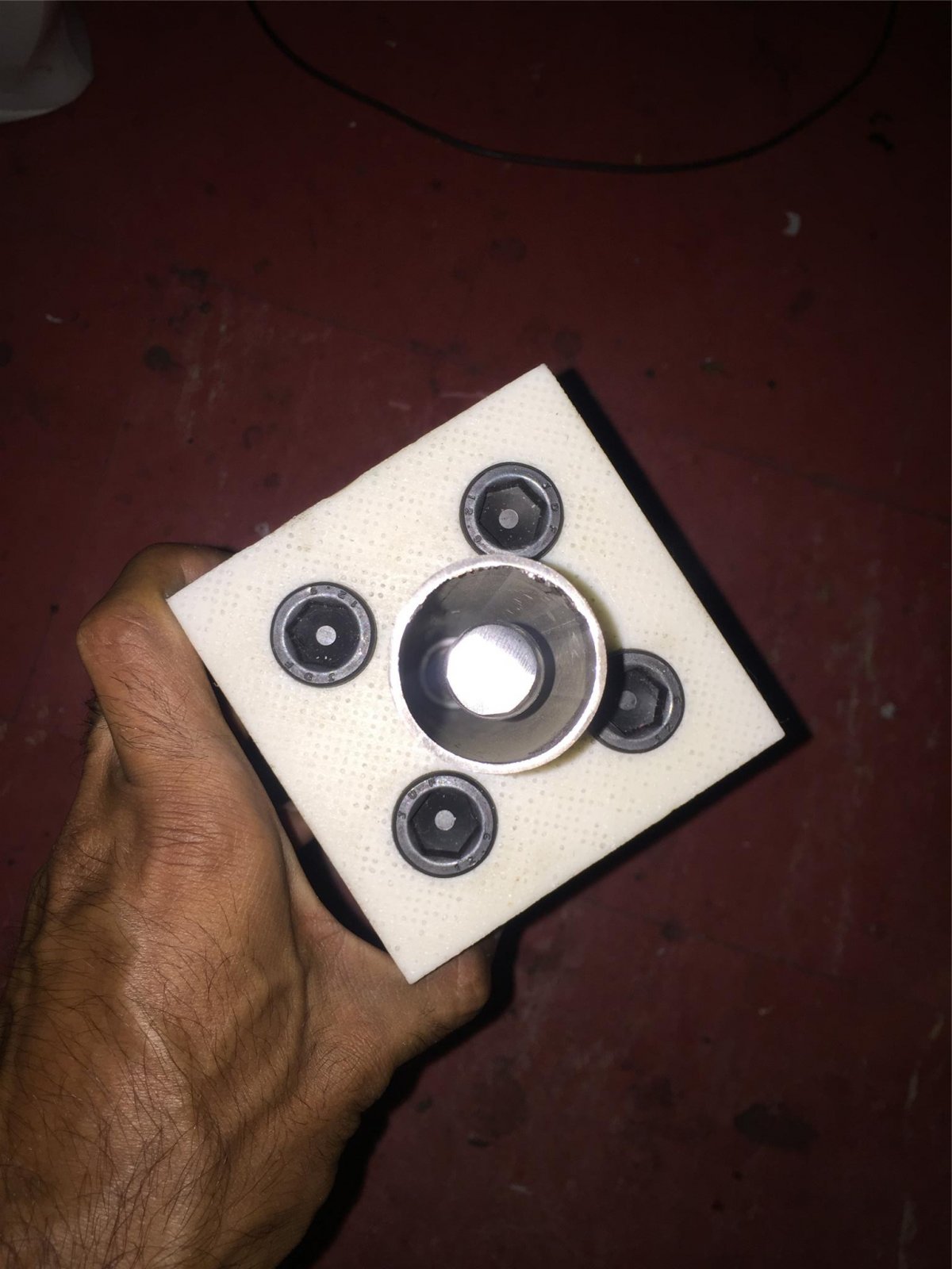

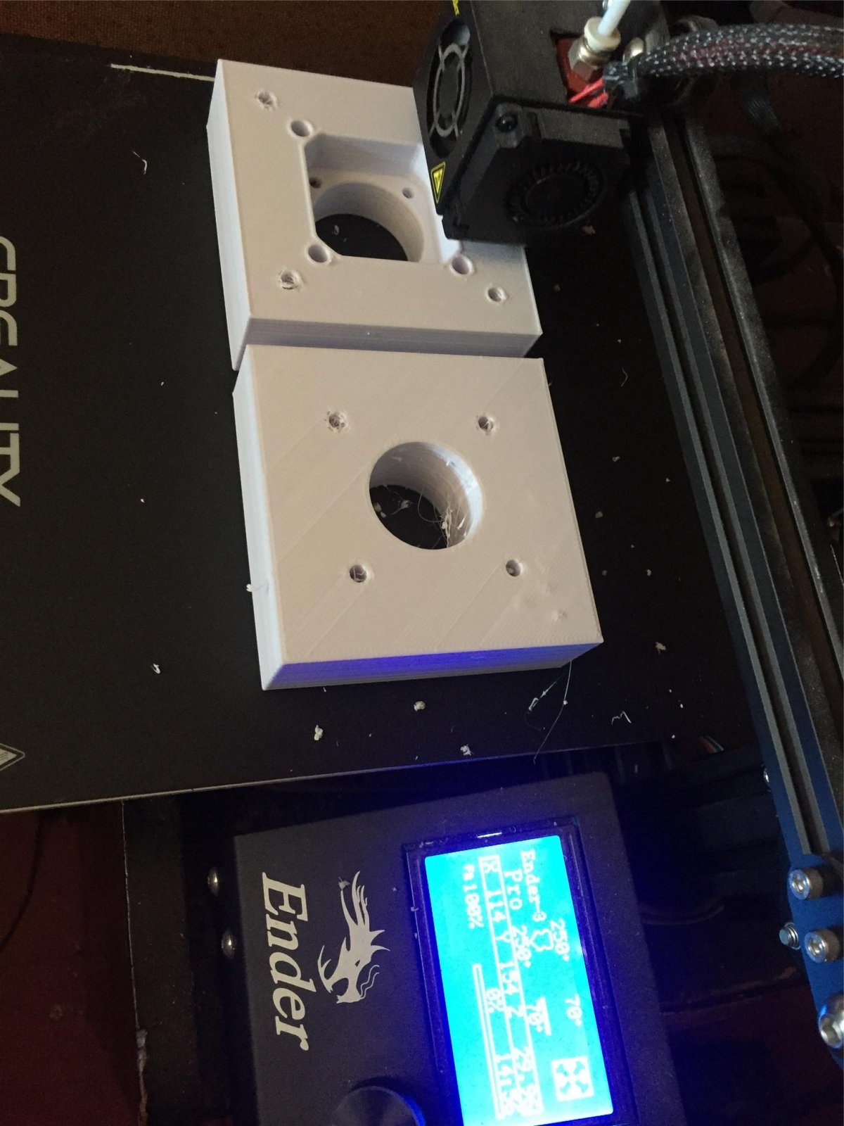

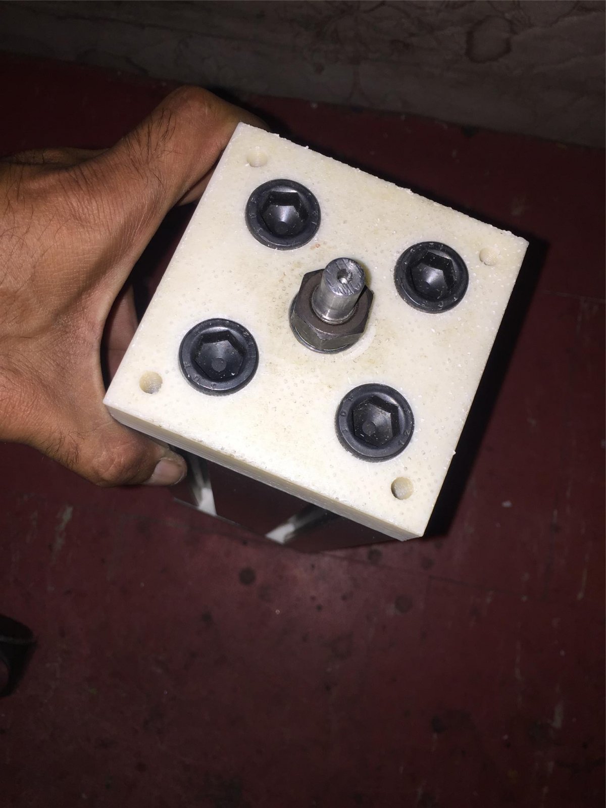

    Some minor improvements, due to load shedding in our country puts abit of a delay to print works 3 done 5 to go.

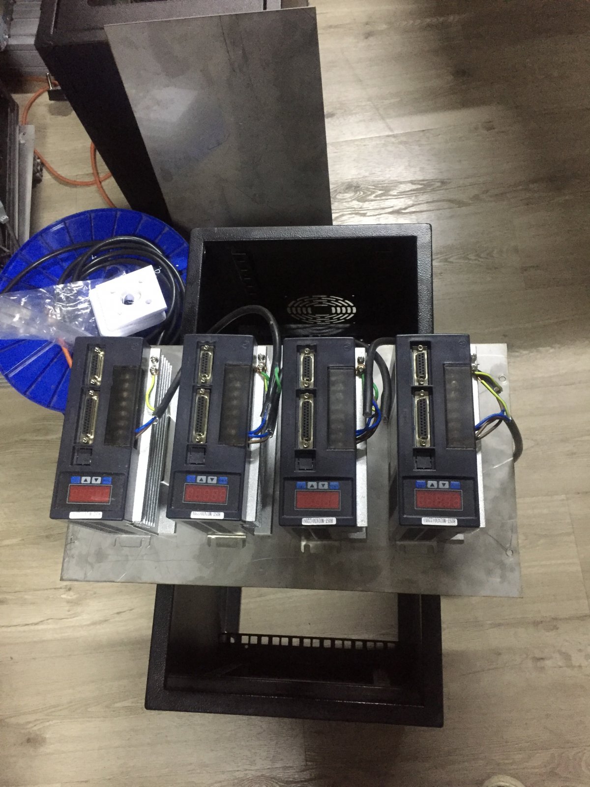

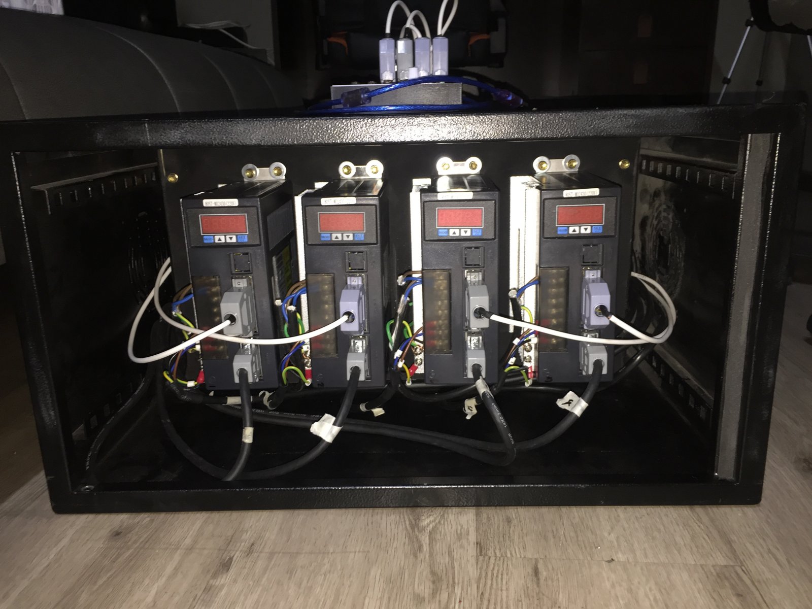

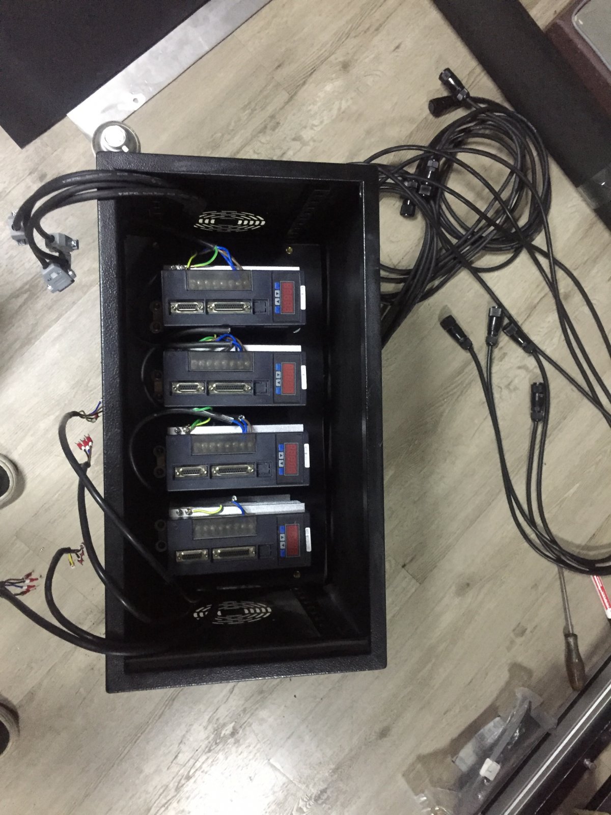

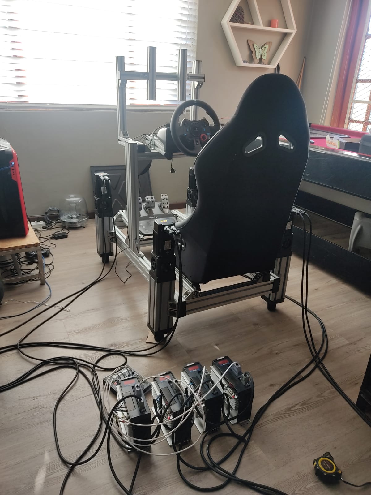

    Servo driver installation into the server cabinet

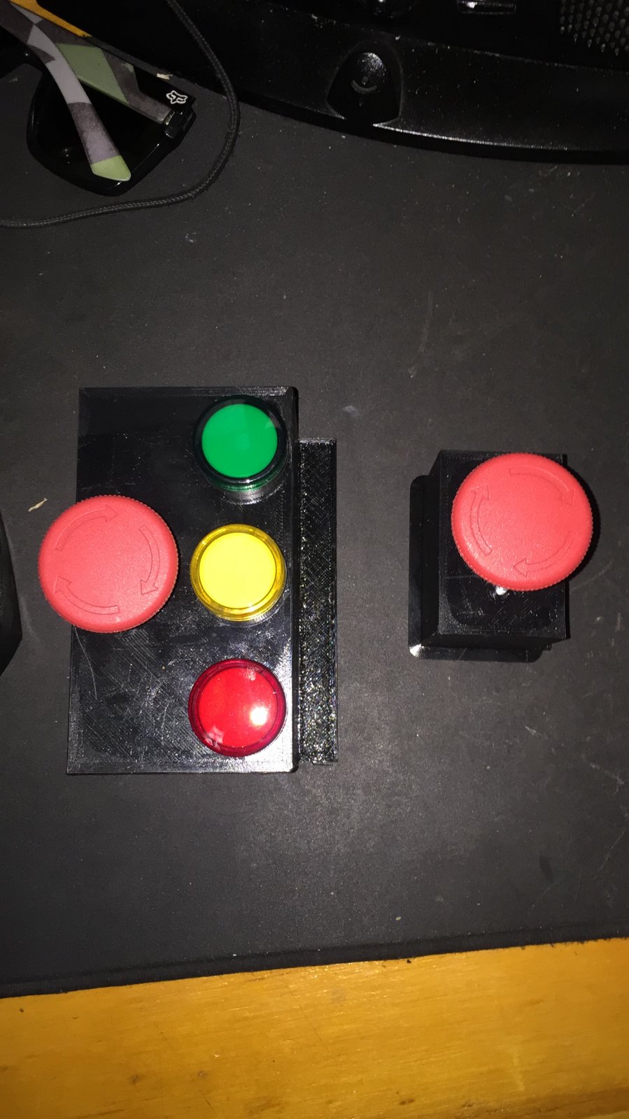

    Fab together E stop

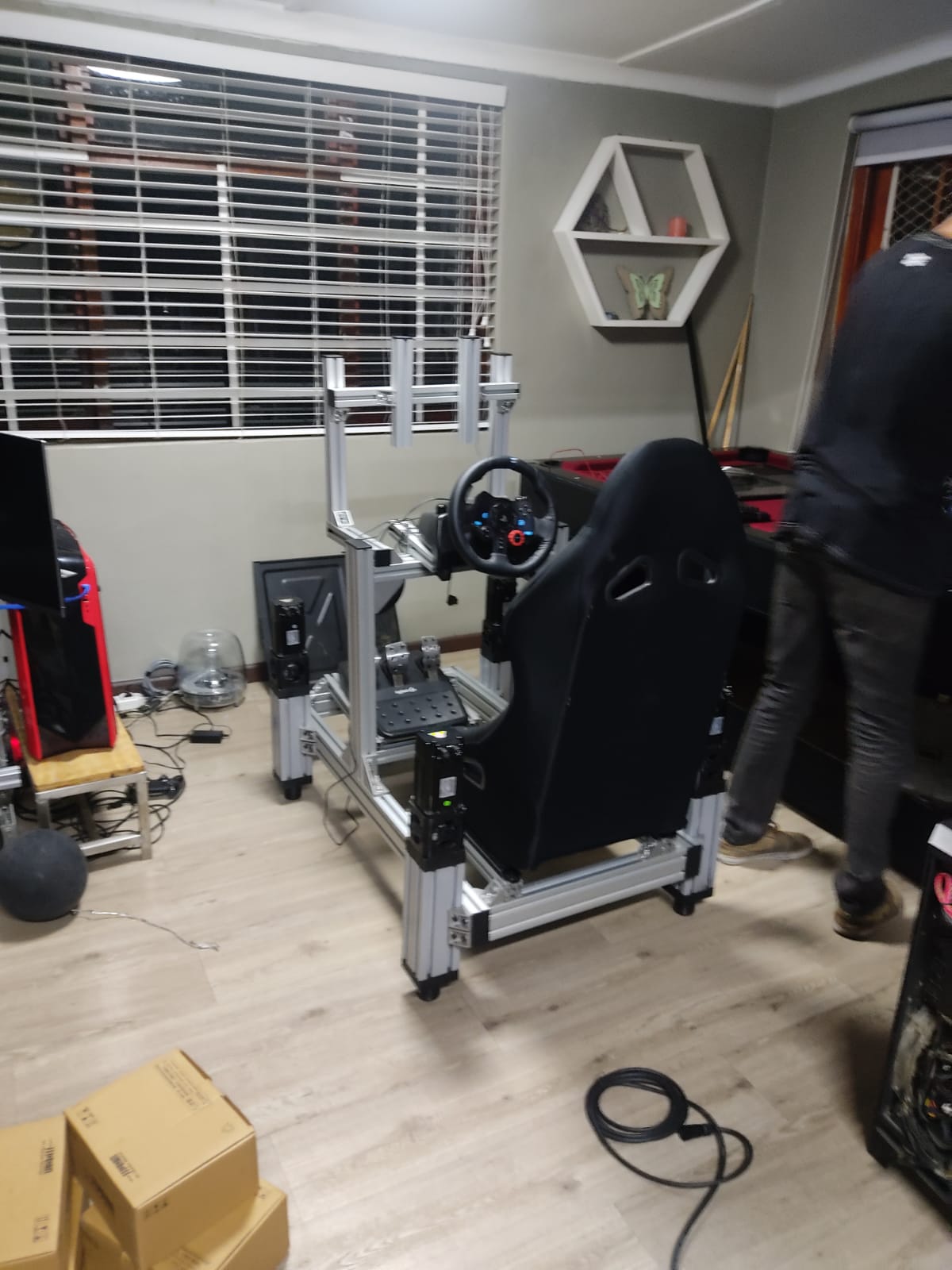

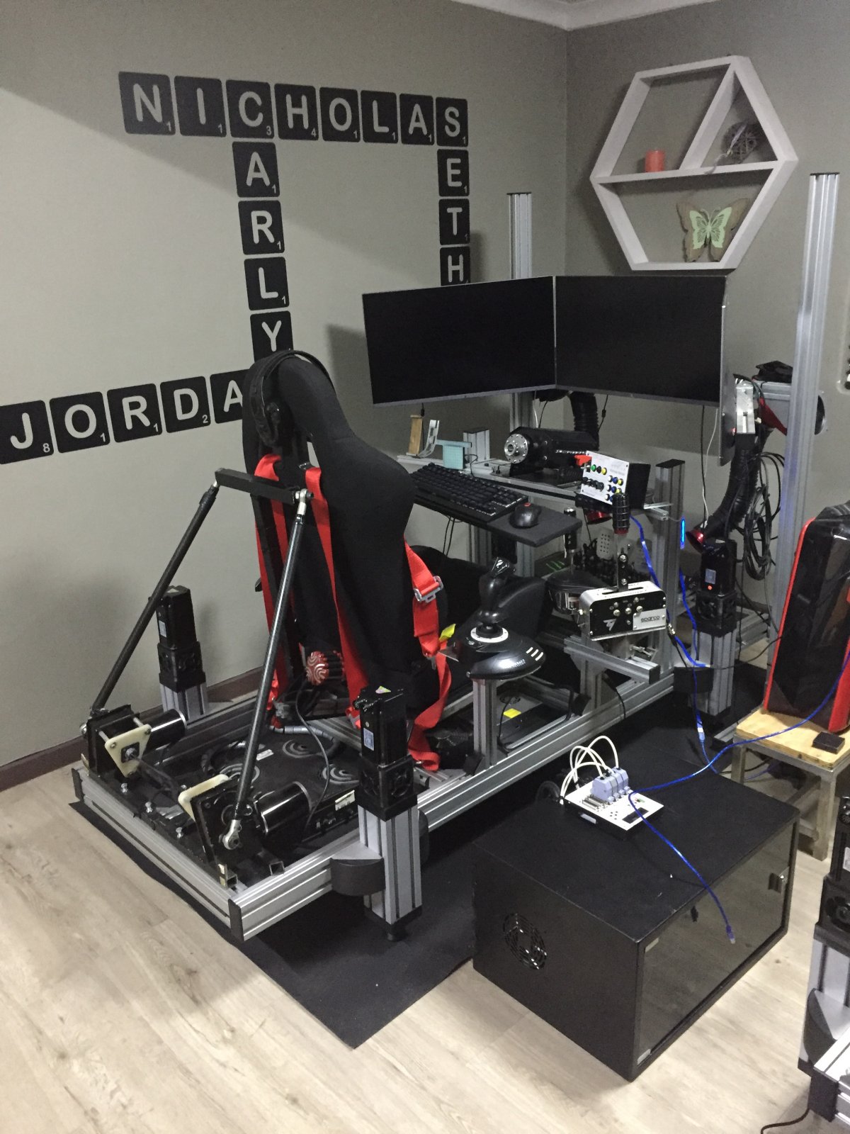

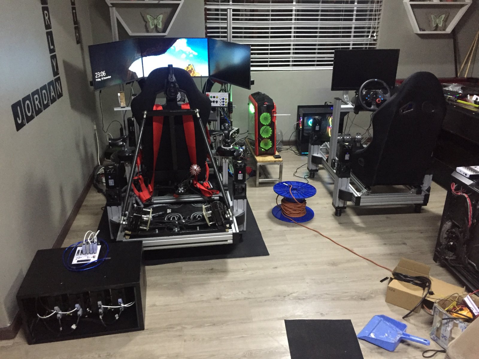

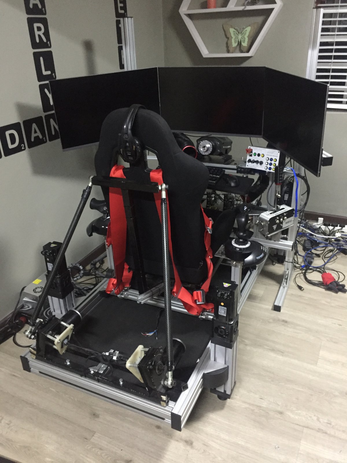

    Complete 4dof / 2dof package

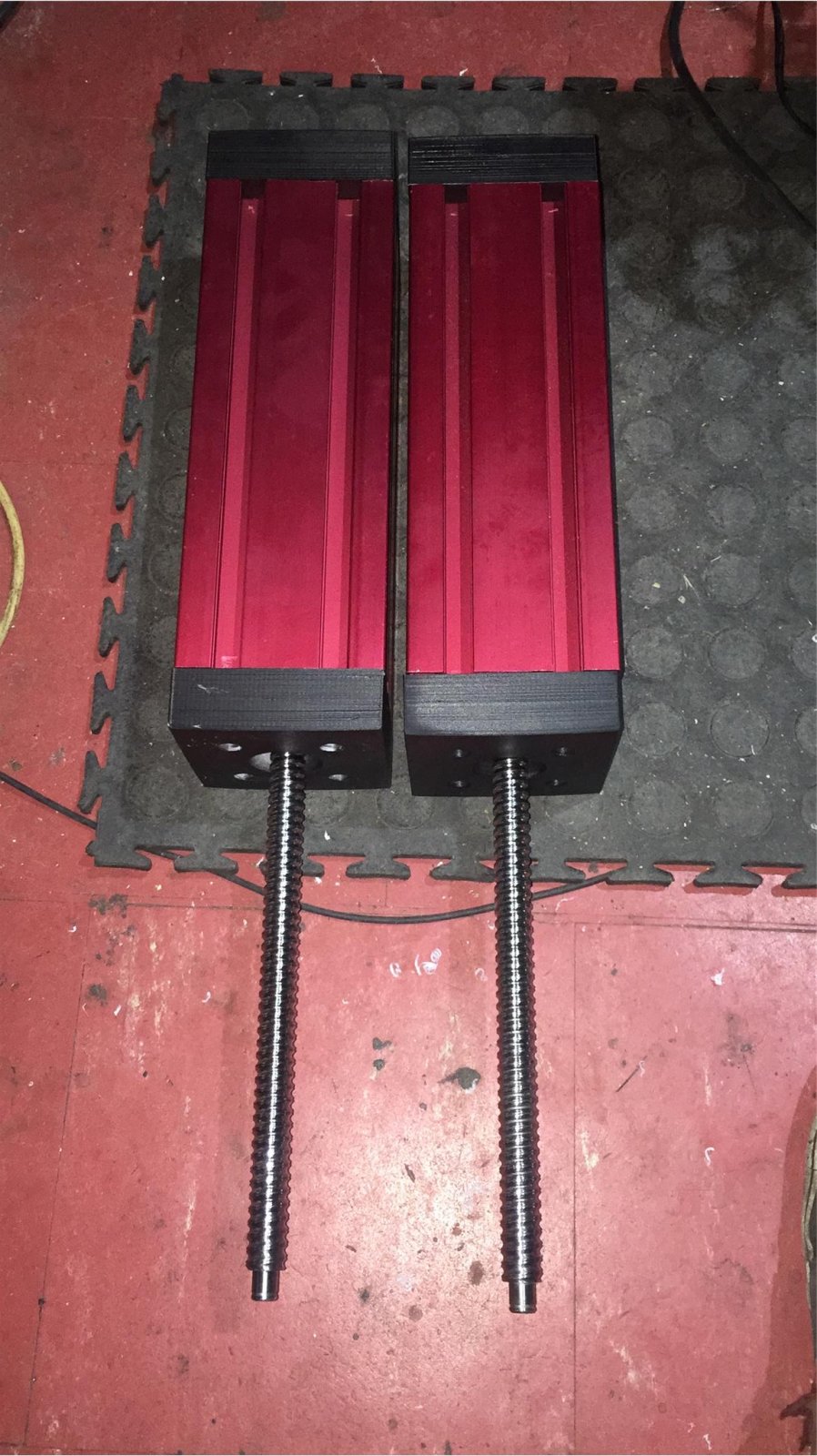

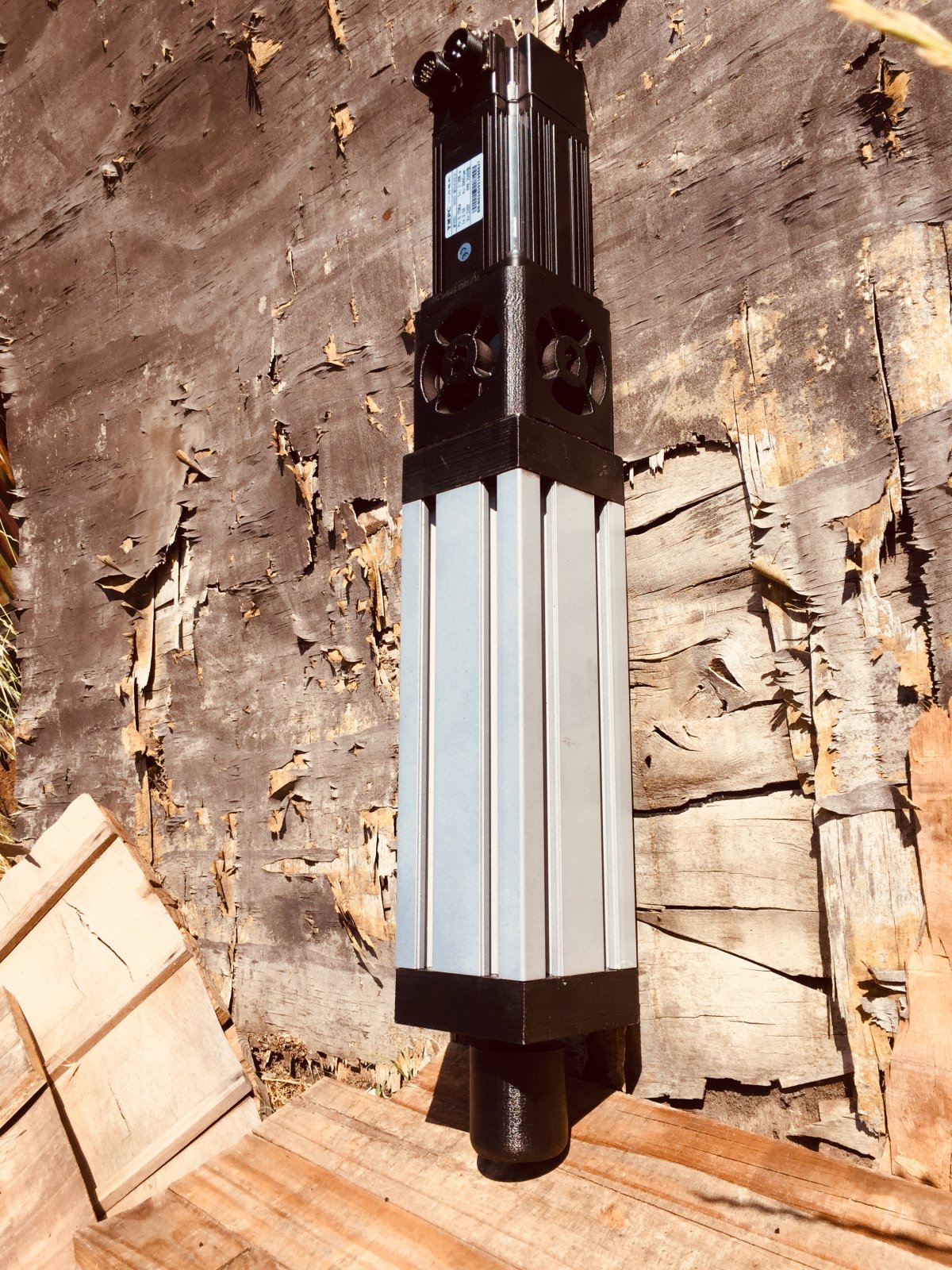

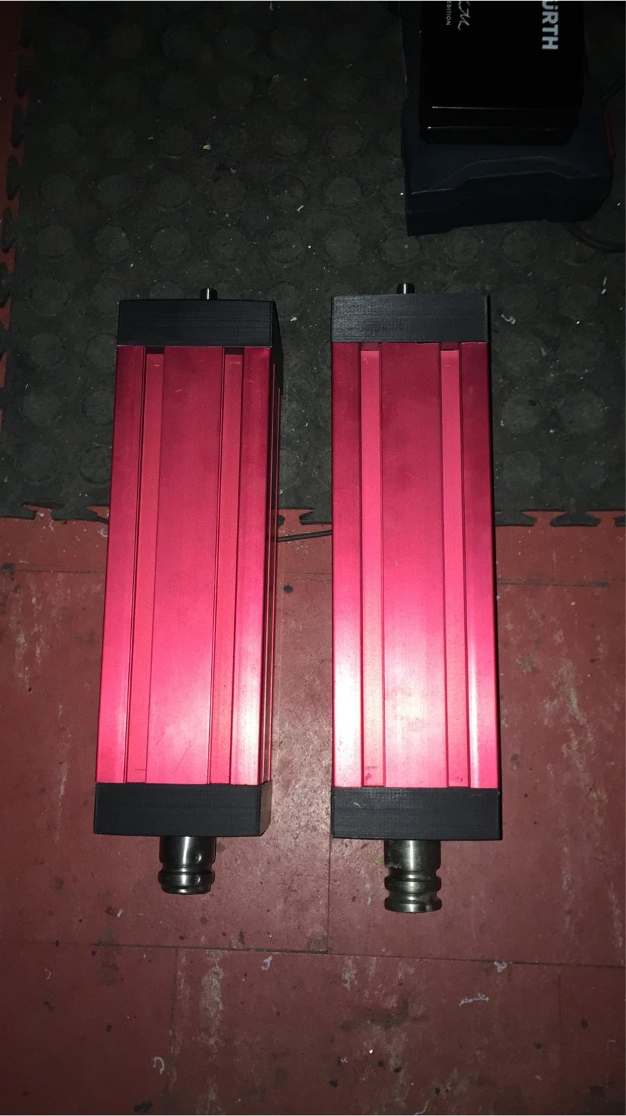

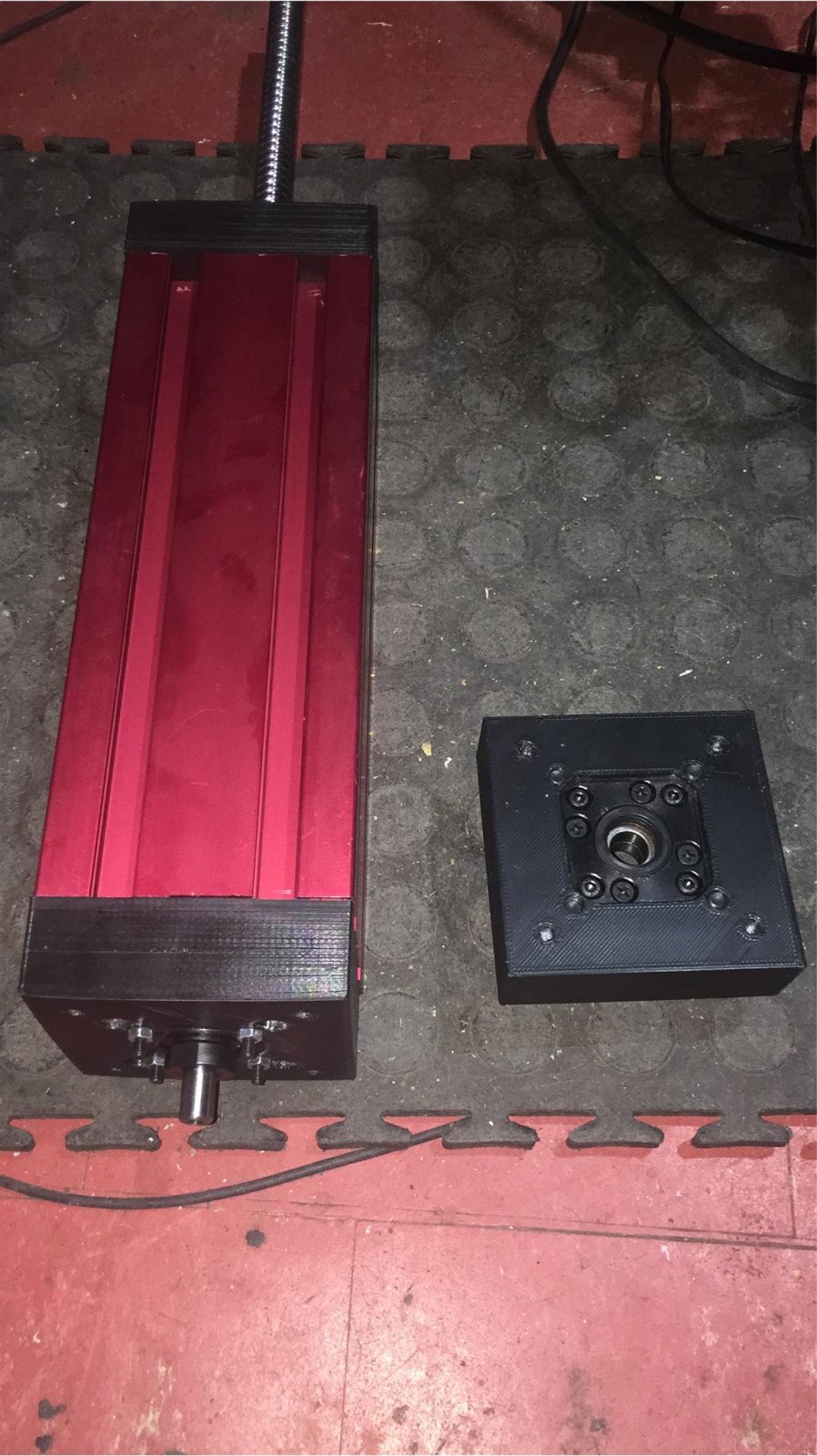

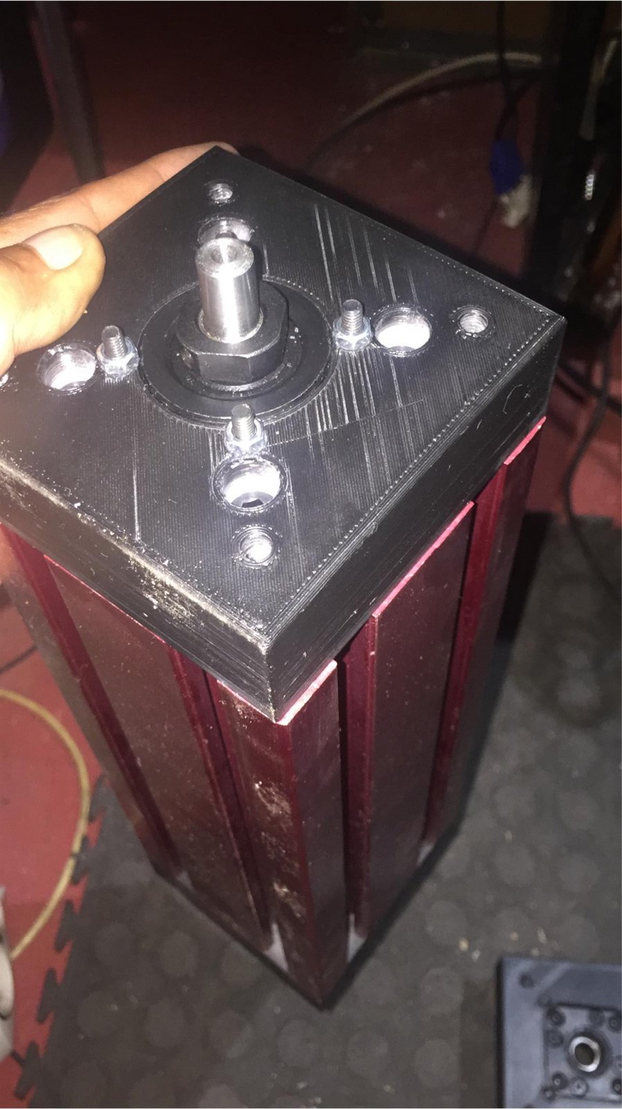

    Custom anodized red extrusion 9090 Sfx 90 profiles
