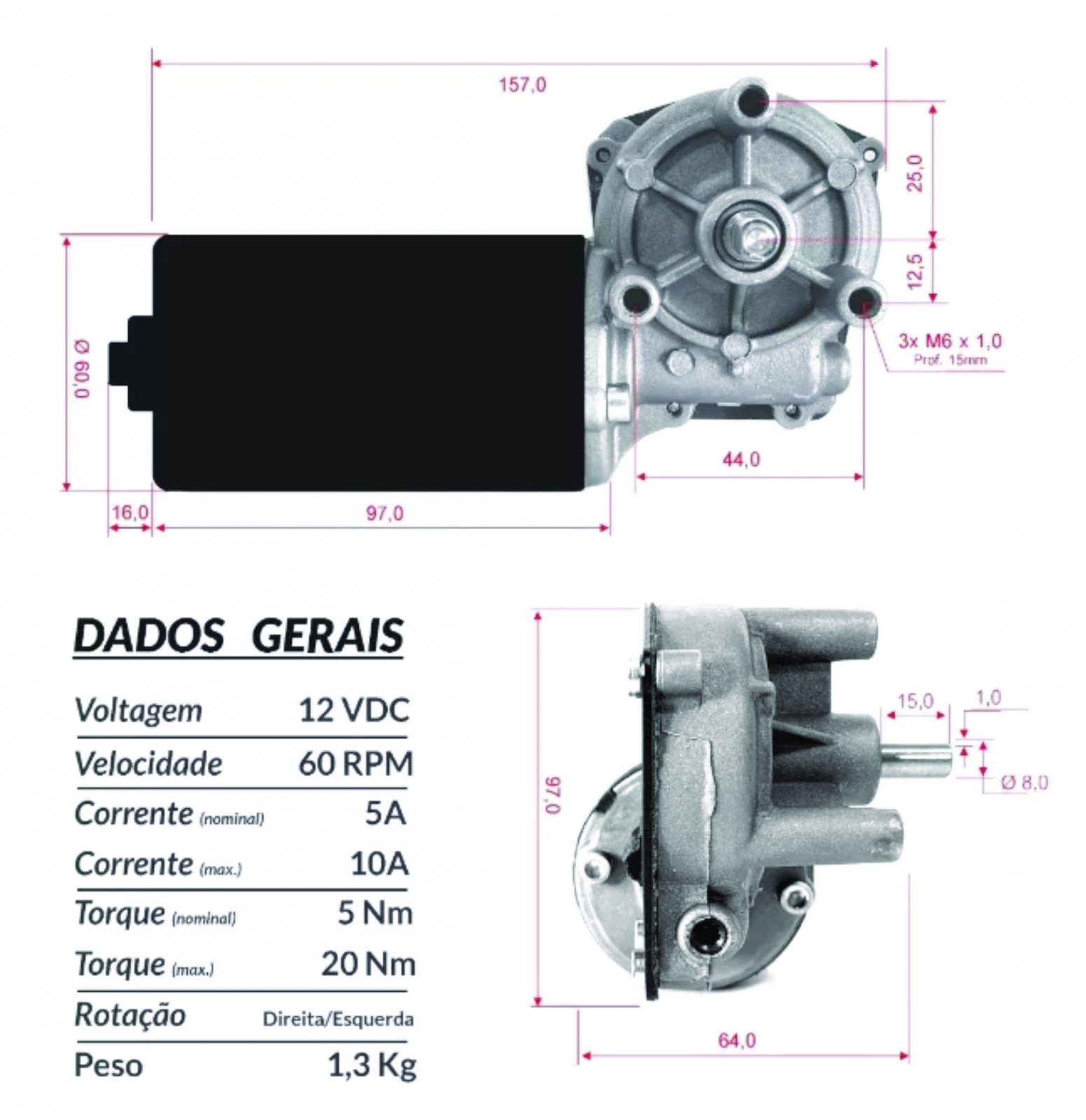

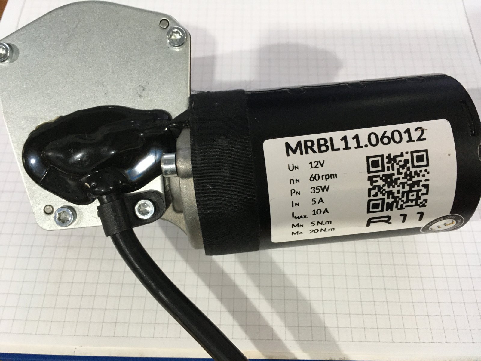

    The engines I will use will be these:
    https://produto.mercadolivre.com.br...cking_id=8de566ab-f2a1-4aa6-bde1-d20d33e8b415
    I will try to make low-cost equipment, and then, if it gets better, I will improve, maybe I will do a 4DOF or 6DOF, but I need to understand everything first ... let's talk and exchange experiences here. Could you see your project?
    Good luck.

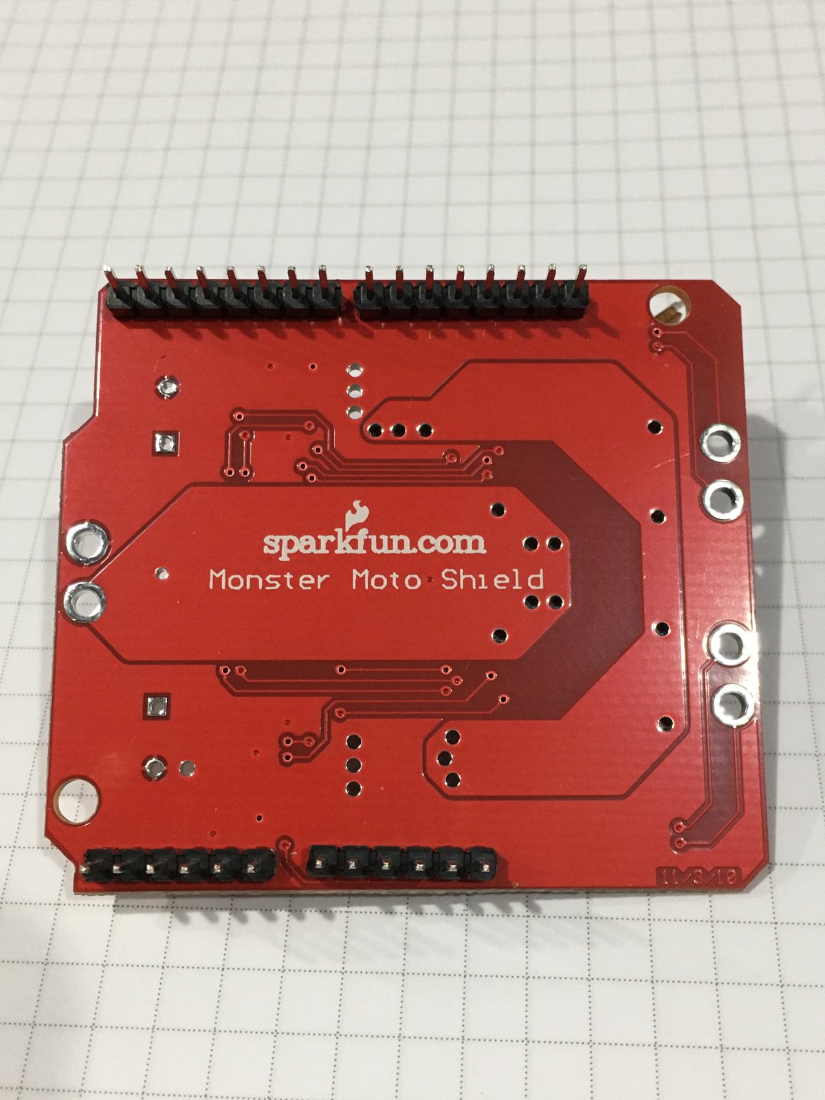

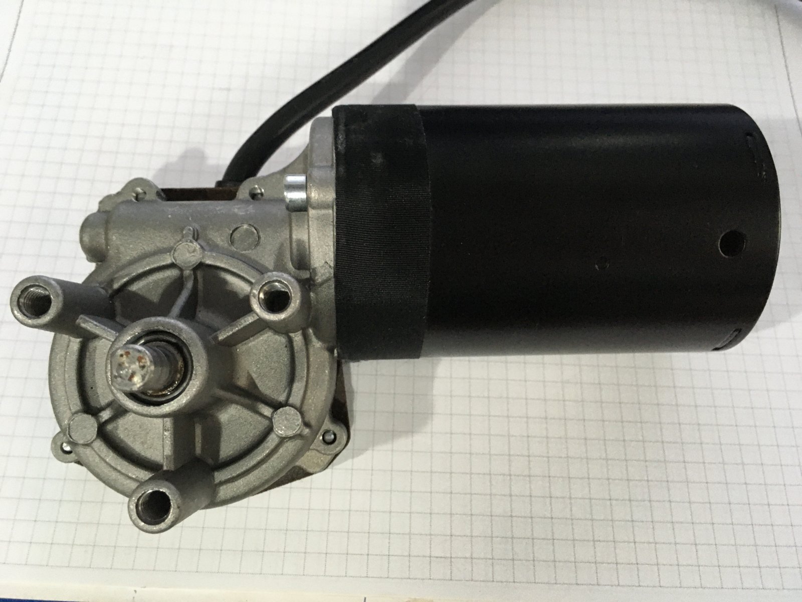

    ELECTRICAL PARTS
    Here I will post all the pieces used in the project as I move forward.
    PARTES ELÉTRICAS
    Aqui postarei todas as peças utilizadas no projeto conforme vou avançando.
    2X potentiometer 10k
    (1X bridge h monster 30A) DISCONNECT THIS !!!
    Update 2x H Bridge 43A
    https://www.xsimulator.net/communit...-projeto-2dof-brasil.14388/page-5#post-201899
    1X Arduíno UNO3
    cables
    (heatsink) DISCONNECT THIS !!!
    connectors
    1 emergency button
    1 power 50A 600W
    1 fuse 20A
    (2 motors 12v 60rpm) DISCONNECT THIS !!!
    Upadate 12v 30rpm

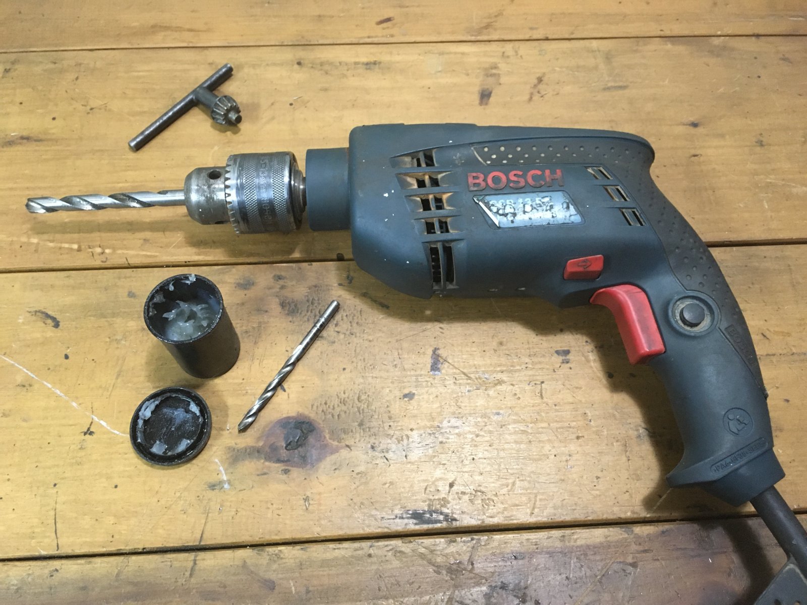

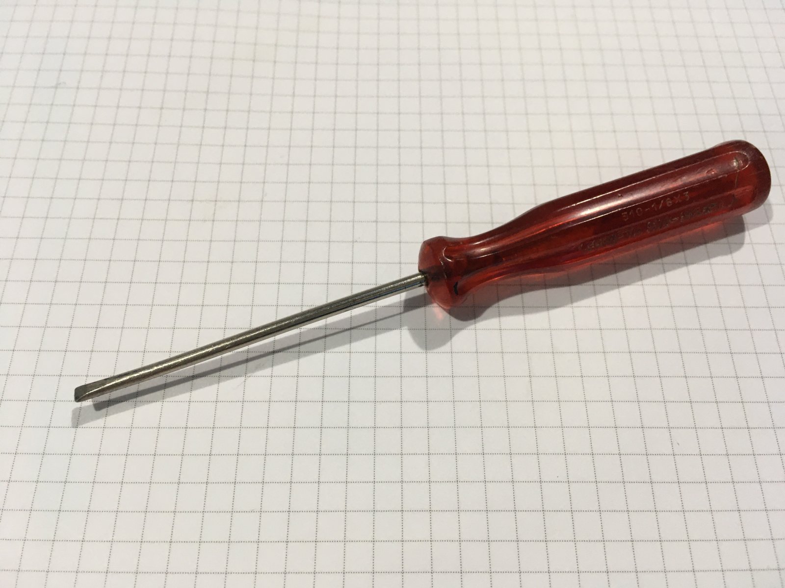

    ELECTRICAL PART - TOOLS
    Here I will post all the tools and other materials used in the project as I go along.
    PARTE ELÉTRICA - FERRAMENTAS
    Aqui postarei todas as ferramentas e outros materiais utilizadas no projeto conforme vou avançando.

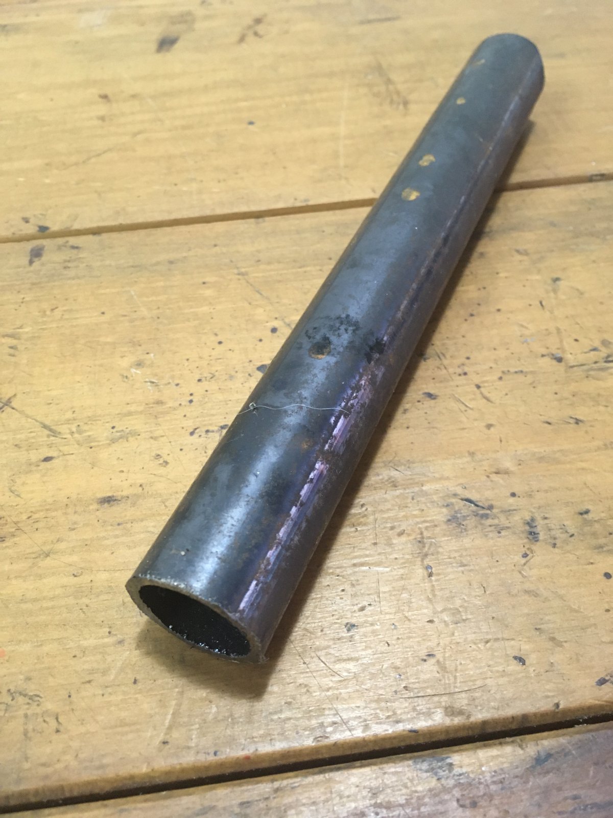

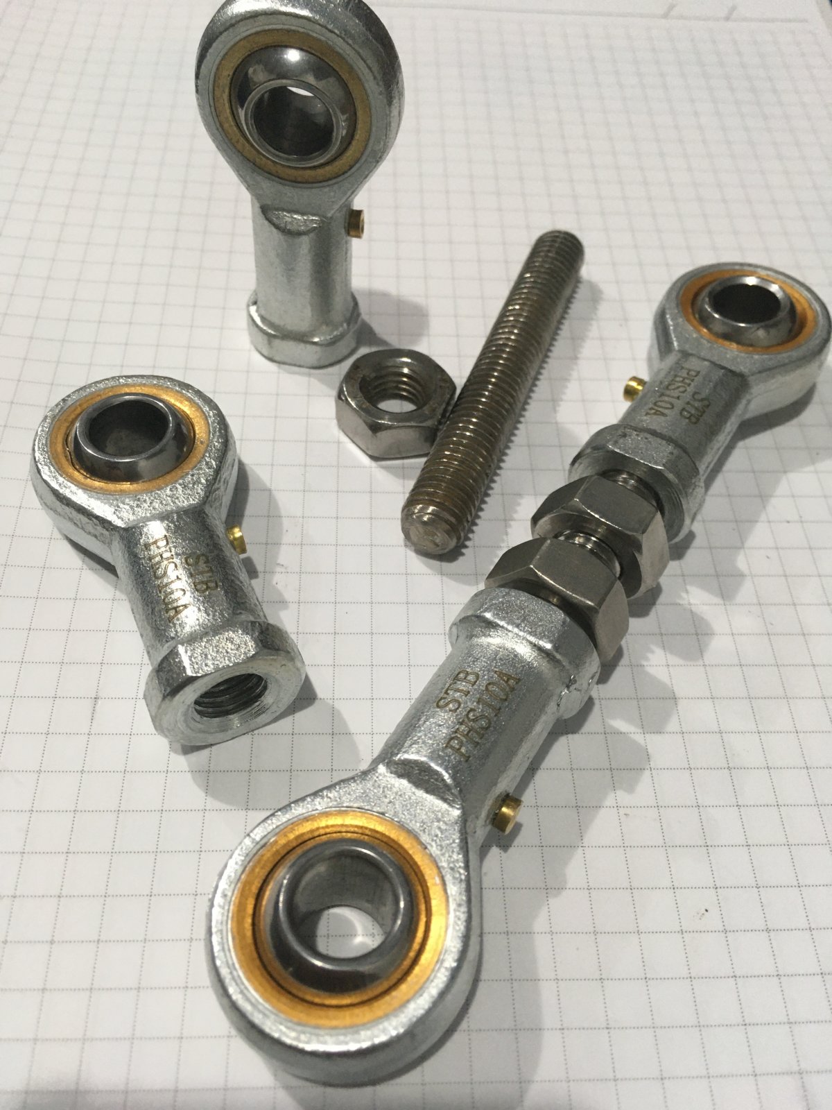

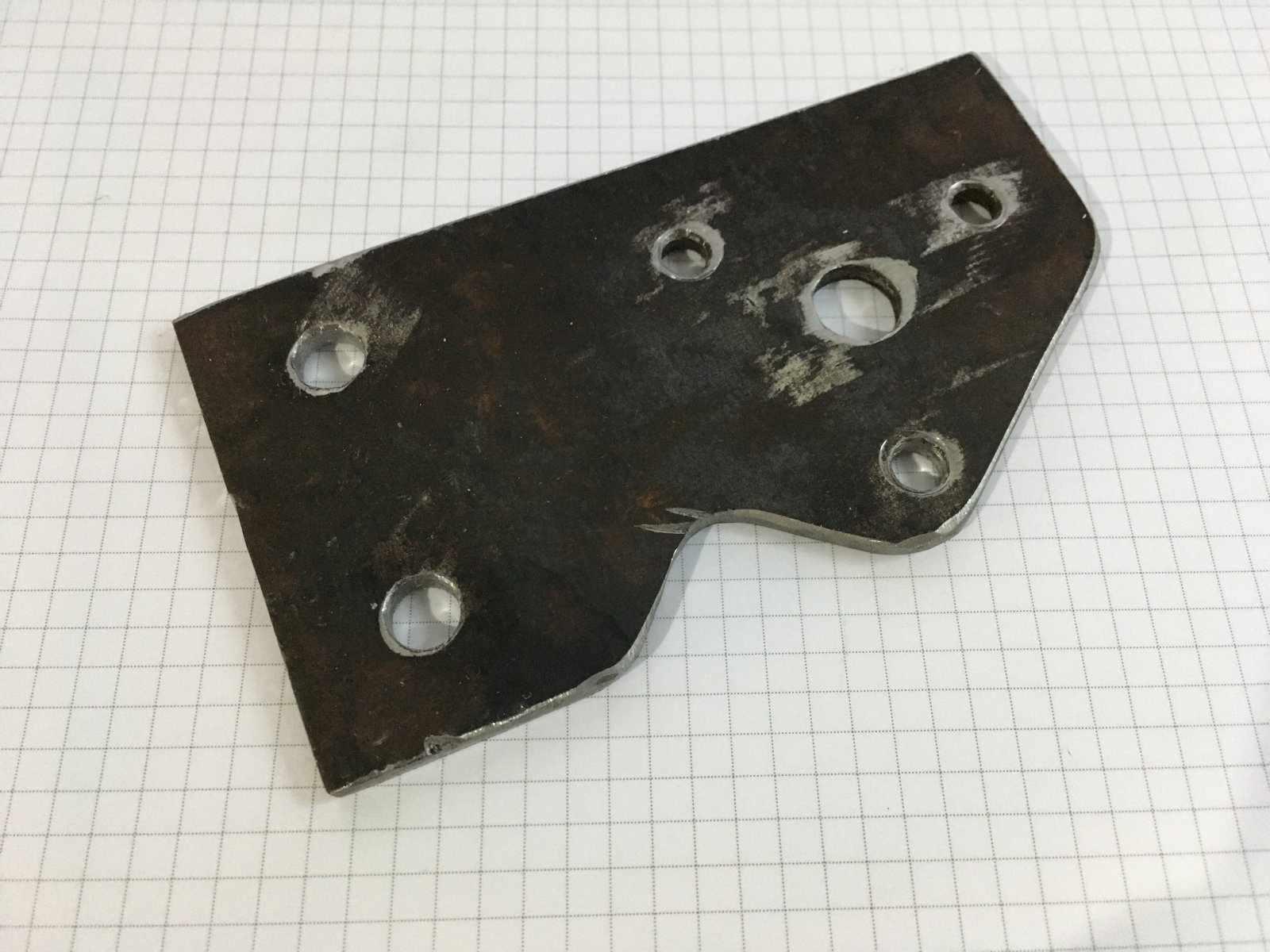

    MECHANICAL PART
    Here I will post all the mechanical parts used in the project as I move forward.
    PARTE MECÂNICA
    Aqui postarei todas as peças mecânicas utilizadas no projeto conforme vou avançando.
    01 Steering crosshead. (possibly VW)
    04 M10 spherical plain bearings, nuts and threaded rod.
    01 Rectangular tube 100x50x5mm x 90mm
    01 tube Ø25,4x2mm x 110mm
    01 tude 40x40x1,5mm x 3300mm
    01 Steel plate flap #5x160x160mm
    01 PP plate flap #4x150x150mm

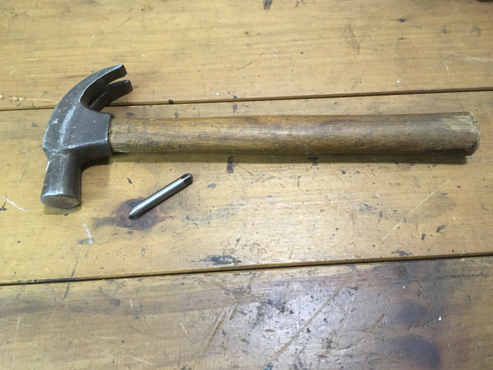

    99Coins
    +55 / 0 / -0
    MECHANICAL PART - TOOLS
    Here I will post all the tools used in the project as I go along.
    ! Use personal protective equipment.!
    PARTE MECÂNICA - FERRAMENTAS
    Aqui postarei todas as ferramentas utilizadas no projeto conforme vou avançando.
    ! Use os equipamentos de proteção individual.!

    Eu diria pra você buscar motores mais fortes que esse e talvez com menor rotação. Utilize o SimCalc (https://www.xsimulator.net/communit...e-linear-speed-and-forces-of-your-design.270/) que é uma ferramenta que anda me ajudando bem. Logo mais vou postar o meu projeto aqui, irei iniciar as montagens e testes no mês que vem possivelmente.
    Boa sorte aí, estarei acompanhando seus posts e do @BrazilianGuy .
    I would say to you look for stronger motors than that and maybe with lower rotation. Use SimCalc (https://www.xsimulator.net/communit...e-linear-speed-and-forces-of-your-design.270/), it's a great tool and is helping me a lot. Soon i will be posting my own project here, tests will be started next month probably.
    Good luck, i will be following your posts and BrazilianGuy aswell.
