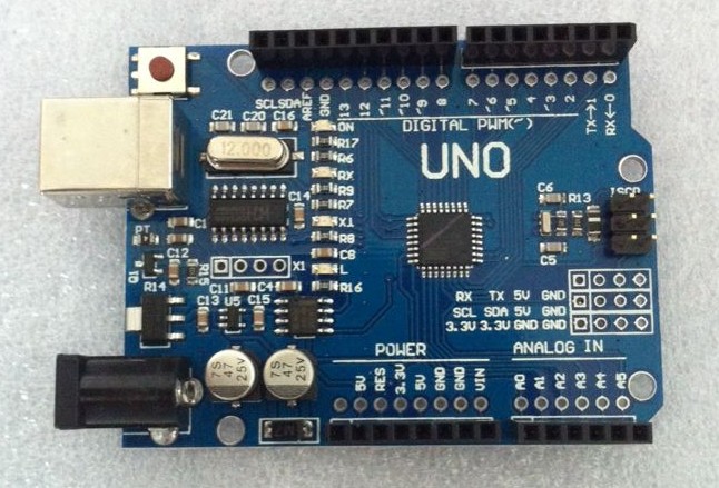

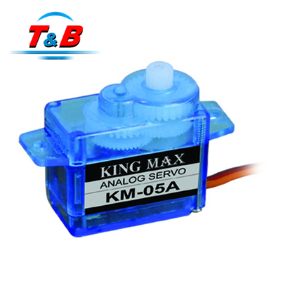

    Recently seen 2dof rc relevant information in forums and youtube, but this knowledge is little hope that everyone will help me to complete a model , thank you ! I'll have time to upload the production process , we hope to help !

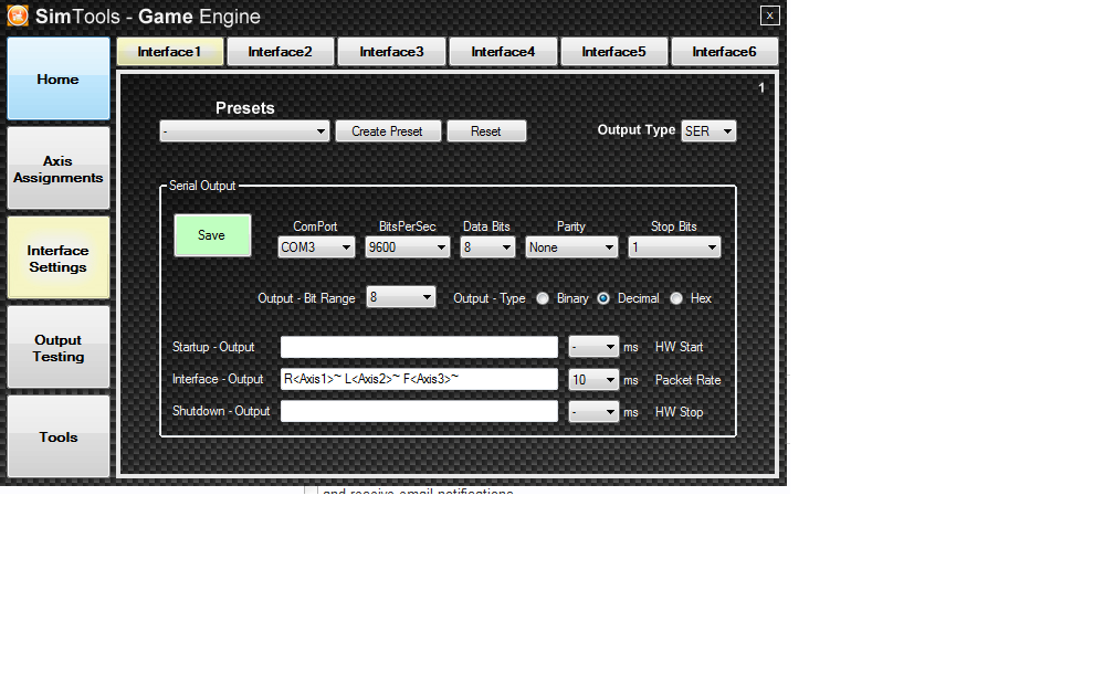

    Hello noorbeastVR, I'll be all hardware connections by SimTools tested, but the connection lfs, and some racing game there is no reaction, it is necessary to download the plug-racing game yet?
    21,030
    147,878Coins
    +10,880 / 54 / -2
    If you have the hardware properly configured and the code installed on the Arduino then it is likely a configuration issue.
    Please post pictures of all your settings and confirm if Output Testing works when turned on and if you have patched LFS for motion.
    The SimTools documentation is here: https://www.xsimulator.net/simtools-complete-documentation/

    You need to post pictures of all your settings, a video is too hard to read.
    Your interface settings should be like this:

    Sorry noorbeast, my shield in china, during the G20 networks, and other network back to you in a good point, I set you gave me this set, I can use the mouse controls ROLL, PITCH operation, very sensitive, and now just do not know why not recognition game, I have installed lfs, ac, dust 3, tension, and some racing games, sim games is not found, and so I made a good network diagram for you!

    You need to create a motion profile for LFS in Axis Assignments and ensure LFS is patched for motion.
    Again refer to the SimTools documentation.
    It is difficult to give clear advice without screenshots of your settings.

    Hello noorbeast, successful, but still some operational problems rc motor is to download the plugin to lfs manifested , I will have time to upload video
