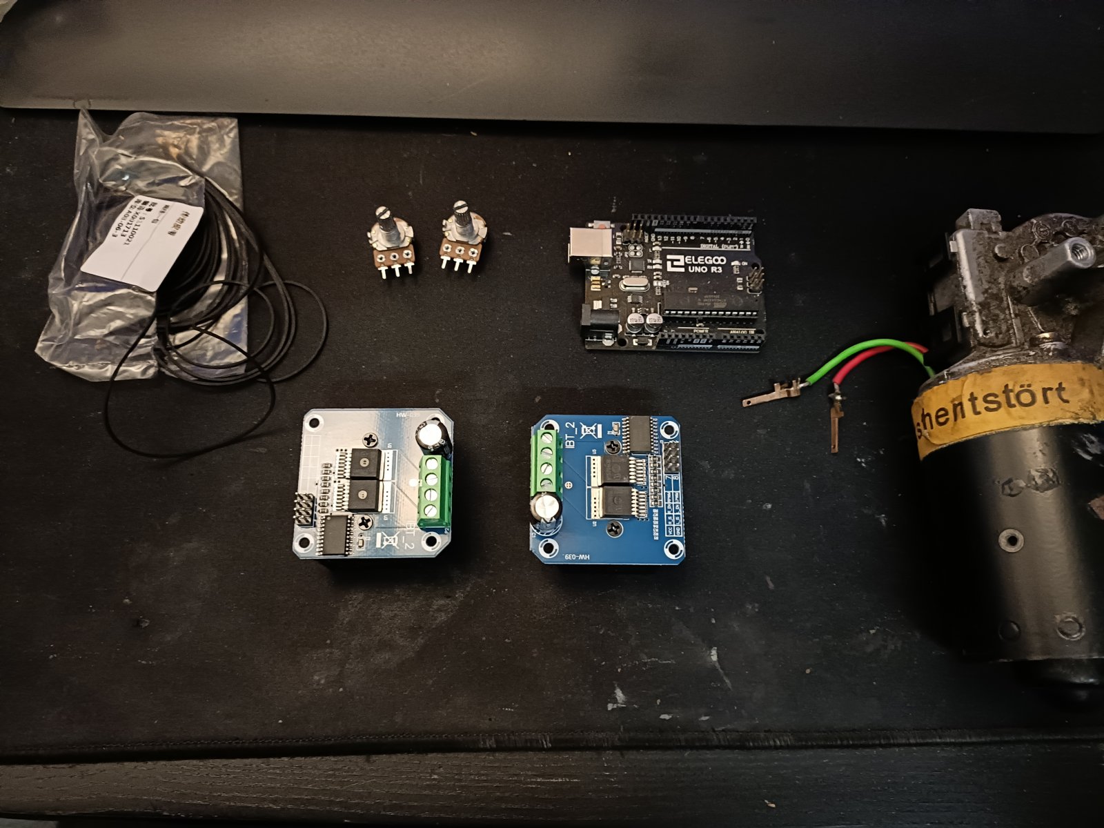

    Hello everyone starting to build my first motion platform this week. Can't wait. My supplies should be here tomorrow .
    My plan is to build one on a small budget. £240 without a rig. £380 with building a full aluminium rig.
    Will post regular updates and hopefully a tutorial and guild on how I did it.
    Thanks for the awesome forum and resources
    Matt

    First parts have arrived. I'll have other motor tomorrow and 10 gauge wire.
    Going to install software and do a basic test soon before I assemble it all.

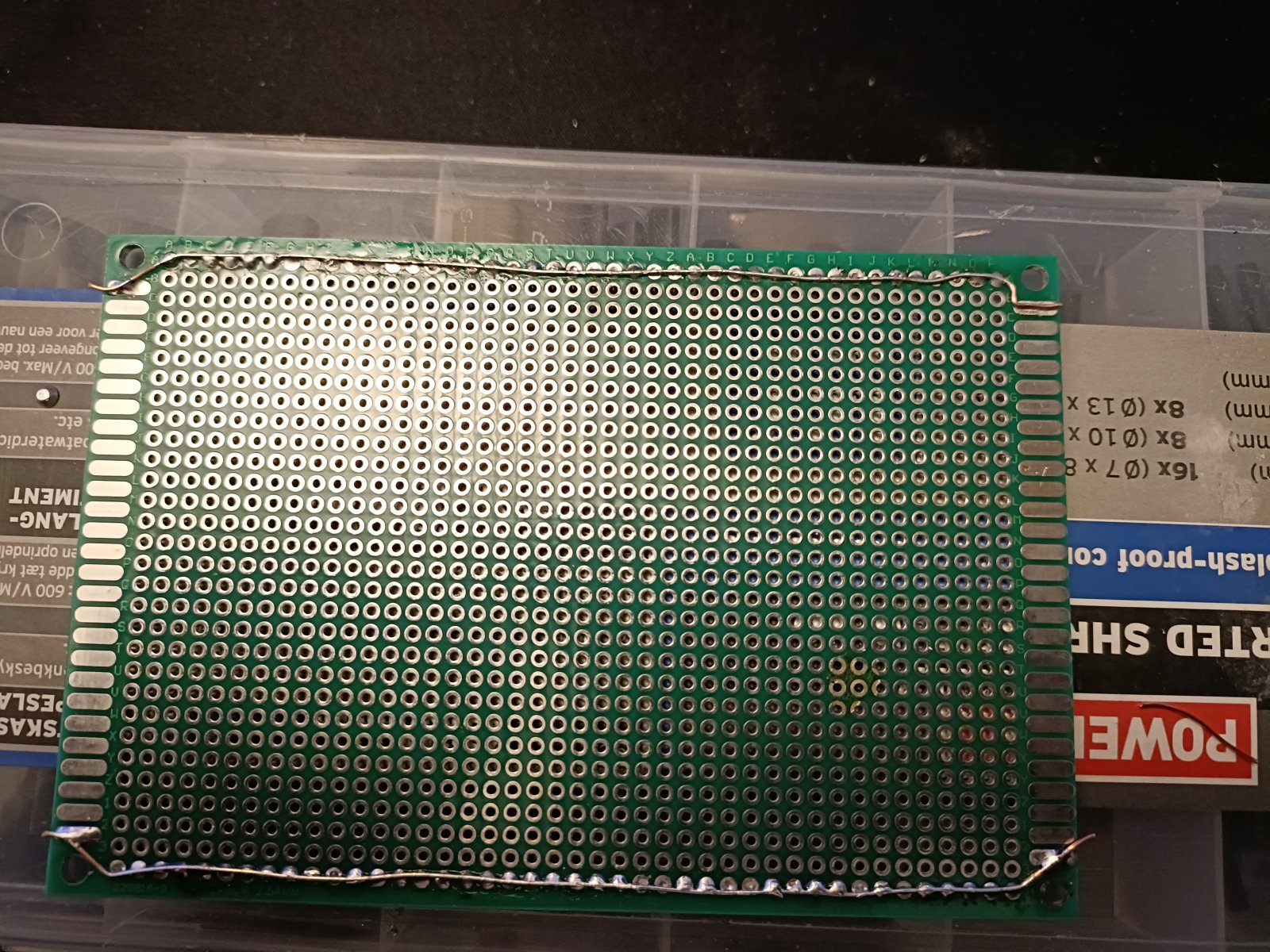

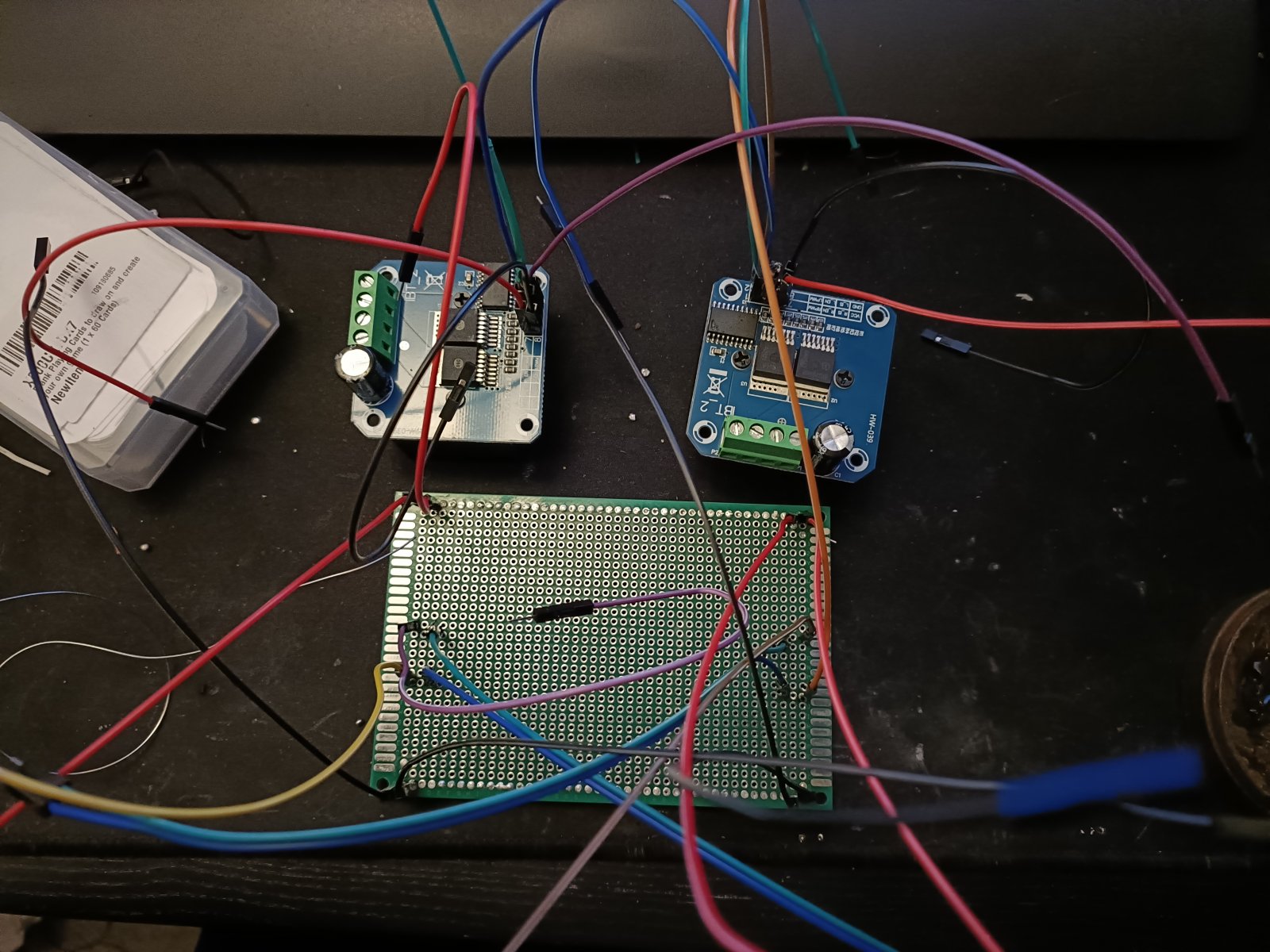

    So got myself a prototype board
    And soldered 2 strips of wire on the back so that I can have a positive and ground rail.
    Then iv started wiring up the wires I will need to the front.
    My plan is to leave space in the center for the arduino board and install it on top of the prototype board the. I can wire it up.
    Cost so far
    £52 becuase I already had some old parts lying around.
    Without them it would be £92
  7. zapata_h
    zapata_h Active Member
    Dec 25, 2013
    221
    España
    308Coins
    +43 / 0 / -0
    3DOF, AC motor, Arduino
    You can put arduino in the center connected female pins so that you can remove arduino without desoldering anything from the circuit

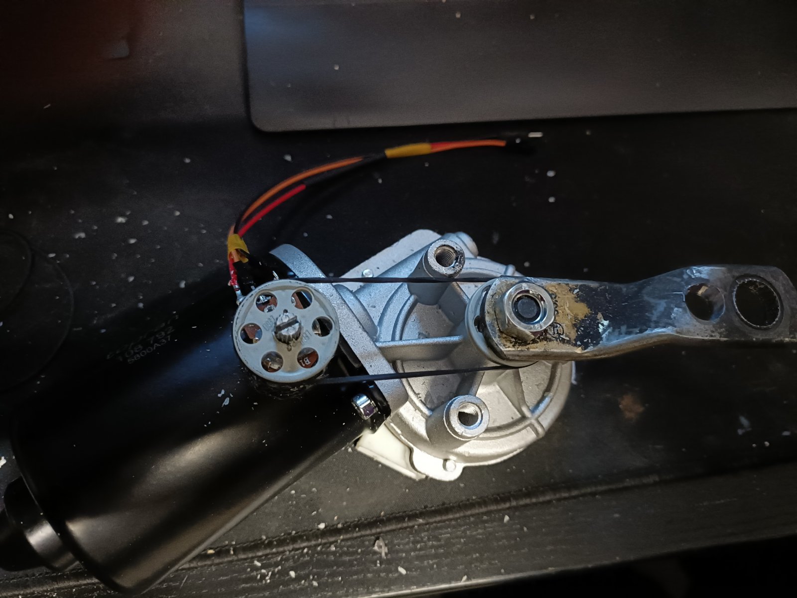

    So got my first motor connected to the potentiometer via a pulley. Seams to work well.

    Actually got the test working and motors running
    However the pulley idea not so good. There is way to much sponge and that causes an oscillation. Was going to upload a video but blew the only fuse I had
    I have a solution that should work which I will test when I get my fuses

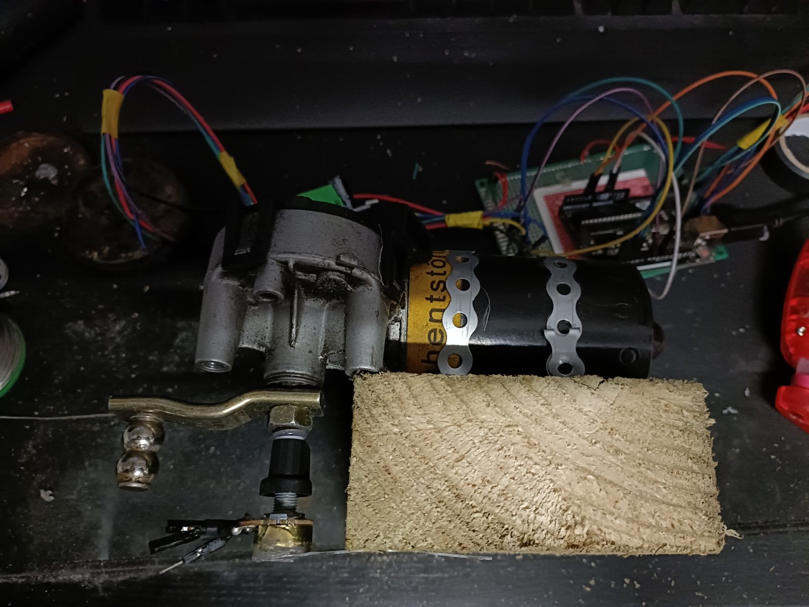

    Got a new mounting solution
    Plan to have a friend 3d print a bespoke part but do far so good.

    First problem. Like an fool if accidentally flipped the polarity to the h bridge!
    Boom! Blew capacitor, scared the living daylights out of me lol

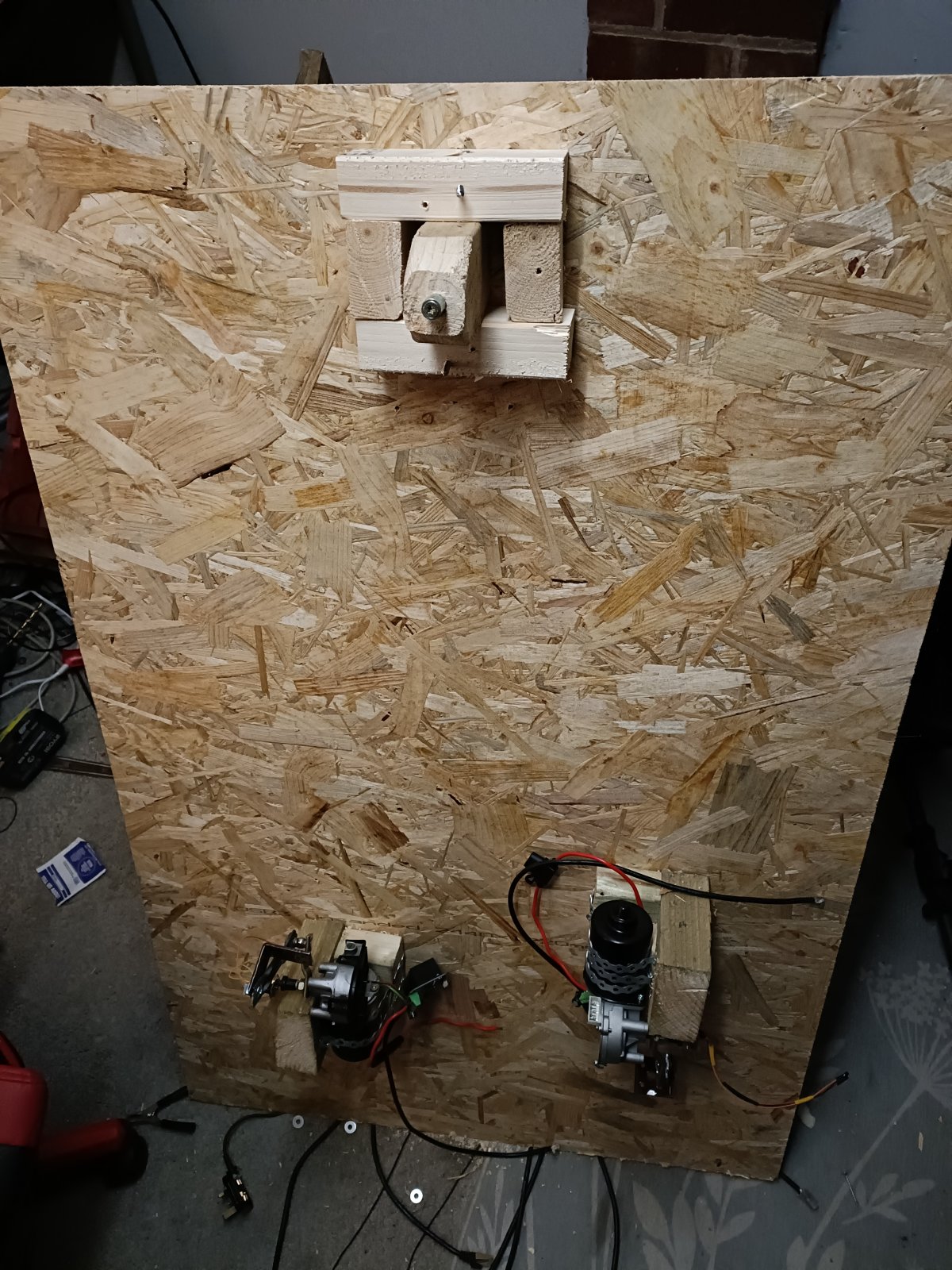

    +18 / 0 / -0
    So tested both motors all working good.
    Mounted them to the base.
    Now I have broken 4 potentiometers though. They seem to fail stupidly easily!
    Do hall effect sensor fail as easy or are they more reliable?
    I plan to upgrade to them in the future just when for potentiometers as I come to grip with the rig
  13. noorbeast
    21,029
    147,872Coins
    +10,876 / 54 / -2
    Hall sensors are more robust and won't break if over rotated.
    But what causes the damage? Are the pots being mechanically being driven past their limit or is it an electrical issue, as the latter would need to be resolved regardless of what you use.

    3 failed after soldering. Must have been to much heat, even though I was careful.
    They can't over rotate as it's not physically possible.
    The latest failure must be due to movement installing the mount in the rig.
    But still that's 4? Ether that or they are just crap ones.
  15. noorbeast
    21,029
    147,872Coins
    +10,876 / 54 / -2
    Too much heat could be an issue.
  16. Radje748
    Radje748 Member Gold Contributor
    Dec 26, 2022
    43
    227Coins
    +35 / 0 / -0
    Yep, looks like too much heat...
    These things are internally somewhat vulnerable.... So How I do it, first some solder on all parts....make a bit warm...and than put them together, where it only needs 1 sec to connect properly
    And also check if you did not drop some solder between one of the 3 legs.... can also create a short circuit
