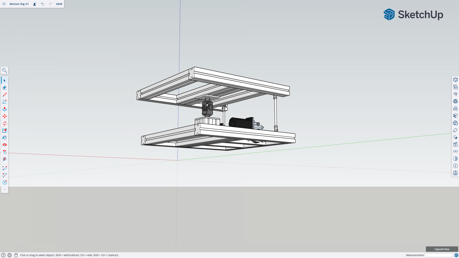

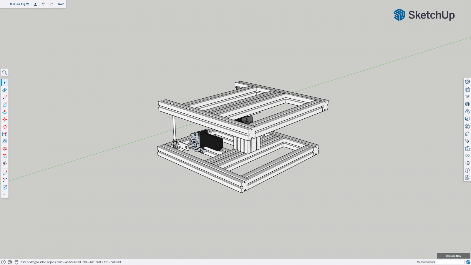

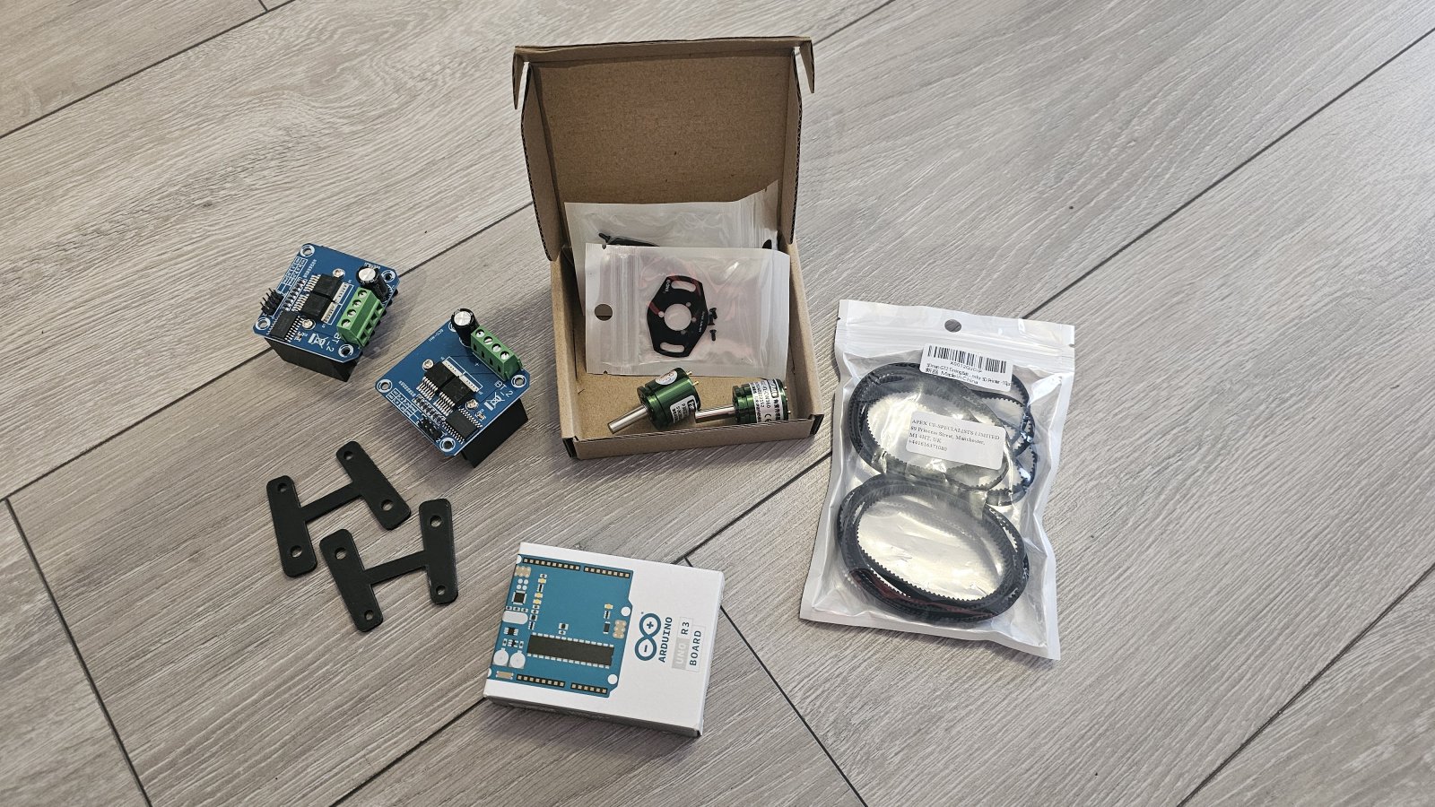

    I asked a question about a build in another section, but guess it's time to start on the actual build!
    This will be my first attempt, I was looking to buy the NLR V3, but have decided to go DIY instead. I have been reading a lot this past week and would really appreciate your input in anything I have missed, or have advice for.
    So, the build will be based on the Arduino UNo R3, which I have already had shipped. I have 2x BTS 7960s on the way too. The next part will be confirming aluminium profile sizes and getting them ordered, along with motors and pots. So far I am looking at;
    2x 250W 24V 75Rpm Low Speed Brush Motor, 44Mm Longer Shaft, 17Mm Shaft Diameter
    2x Mean Well LRS-350
    2x HEXEH DC 5V Hall Angle Sensor Non contact Industrial 0-360 Degree Rotation Sensor
    I have been following these threads mainly;
    https://www.xsimulator.net/community/threads/my-project-2dof.13425/
    https://www.xsimulator.net/communit...IOkgy61axSkrcg6EbI_aem_iDbS_PVI9aK711trnyAX0Q
    My questions start with, do I need 2x PSU?

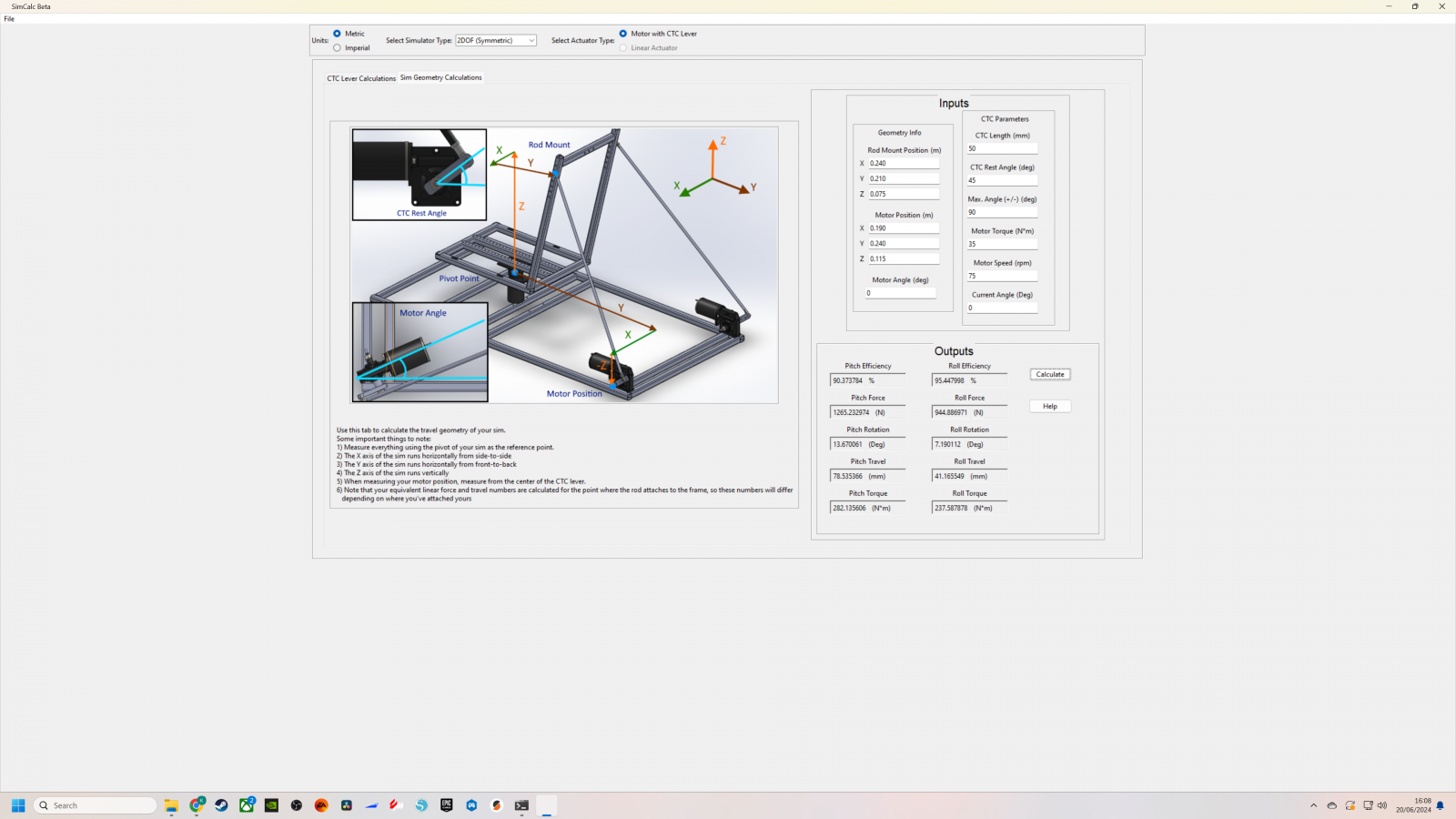

    I have been running simcalc but until I get the motors and frame here, I cannot be 100% on my results.
    I would really appreciate your input guys, want to get this right the first time if I can, I am UK-based if that helps for locating parts.
    Look forward to hearing from you, Kris

    I will repeat my earlier suggestions elsewhere, to adjust Max Angle to 80, as with a compact design torque matters most and over 40 degrees up and down effective torque utilisation drops off rapidly.
    The rest angle will be 0 in a compact design.
    Other members have found benefits in running IBT2s under 24v.
    While it is possible to use w single suitably spec PSU there are significant power spikes in fast reversals, so I consider 2 PSUs are better more fault tolerant option.

    Thanks @noorbeast, My apologies too, been busy with work.
    I think I need to understand the angle more, so that's 80 degrees, from rest angle (rest angle 90 degrees to lever?) So 80 up, 80 down if that makes sense?
    On the IBTs, I can turn down the voltage? I have seen they need thermal paste etc to keep them cool.
    Happy to run 2x PSU, sooner be safe than sorry!
    From the threads I have been reading the 24v motors and pots seems to be quite common for the type of build I am looking to replicate, would you say the items I stated were appropriate?

    The rest angle should be 0 with the levers parallel to the ground and rig frame.
    80 is total, so 40 degrees up and 40 degrees down from rest.
    Turning voltage down a little is via the PSU. The spec sheet of the LRS-350-24 lists the voltage adjustable range as 21.6 ~ 28.8V: https://www.meanwell.com/Upload/PDF/LRS-350/LRS-350-SPEC.PDF
    With the Hall sensor I would suggest a 180 for improved resolution, technically you could get away with 90, but a 180 gives a bit of operational headroom, at a slight cost in resolution.

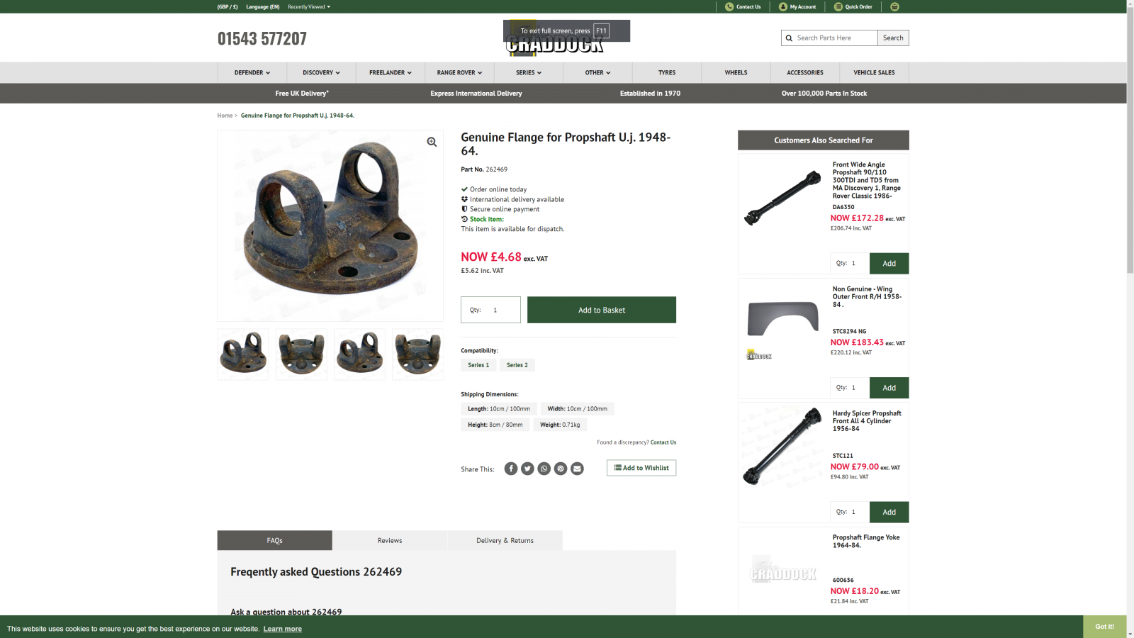

    I've just ordered the aluminium profile. motors, hall sensors, GT2 Belt (200mm) and also managed to sort a great Universal Joint from a Land Rover specialist, 2x flanges plus the centre bearing for around £24!

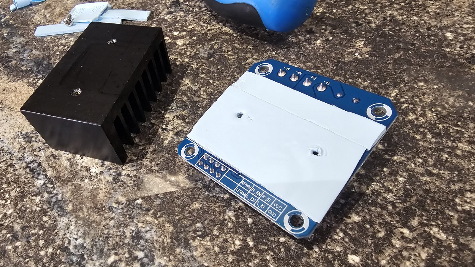

    Is it worth removing the IBT2 heatsinks and applying thermal paste, believe I have read they don't come with any applied?
  10. Gefahren
    Gefahren Member
    Mar 9, 2024
    55
    Electronics Engineer
    Central Mississippi, USA
    395Coins
    +66 / 0 / -0
    My experience with the IBT2's is that they do not have any thermal compound applied. Also, that they are utilizing the anodization on the heatsink as an electrical isolation barrier. If I remember correctly, you don't want the tabs of the two drivers to be electrically connected. When I used them, I applied an electrically isolating thermal pad.
    My other two observations about them are that they do not like 100% duty cycle on the PWM signal and that they should have a voltage suppressor if you are running them at 24V. Turning the voltage down on the supply will help, but I would still recommend something like a TVS diode.
    If you haven't gotten those Meanwell supplies yet, I would recommend the LRS-350N2 versions. They are made to better supply the current spikes that motor drive applications can pull. Other than that, they are pretty much identical to the regular LRS supplies.

    Thanks for the advice @Gefahren il take a look at the heat sinks, I have loads of thermal pads here from building PCs so should have some that will work. Il check out the PSUs too.

    Well since I am at a loose end Ive applied thermal pads to IBTs, now I wait some more for parts :)

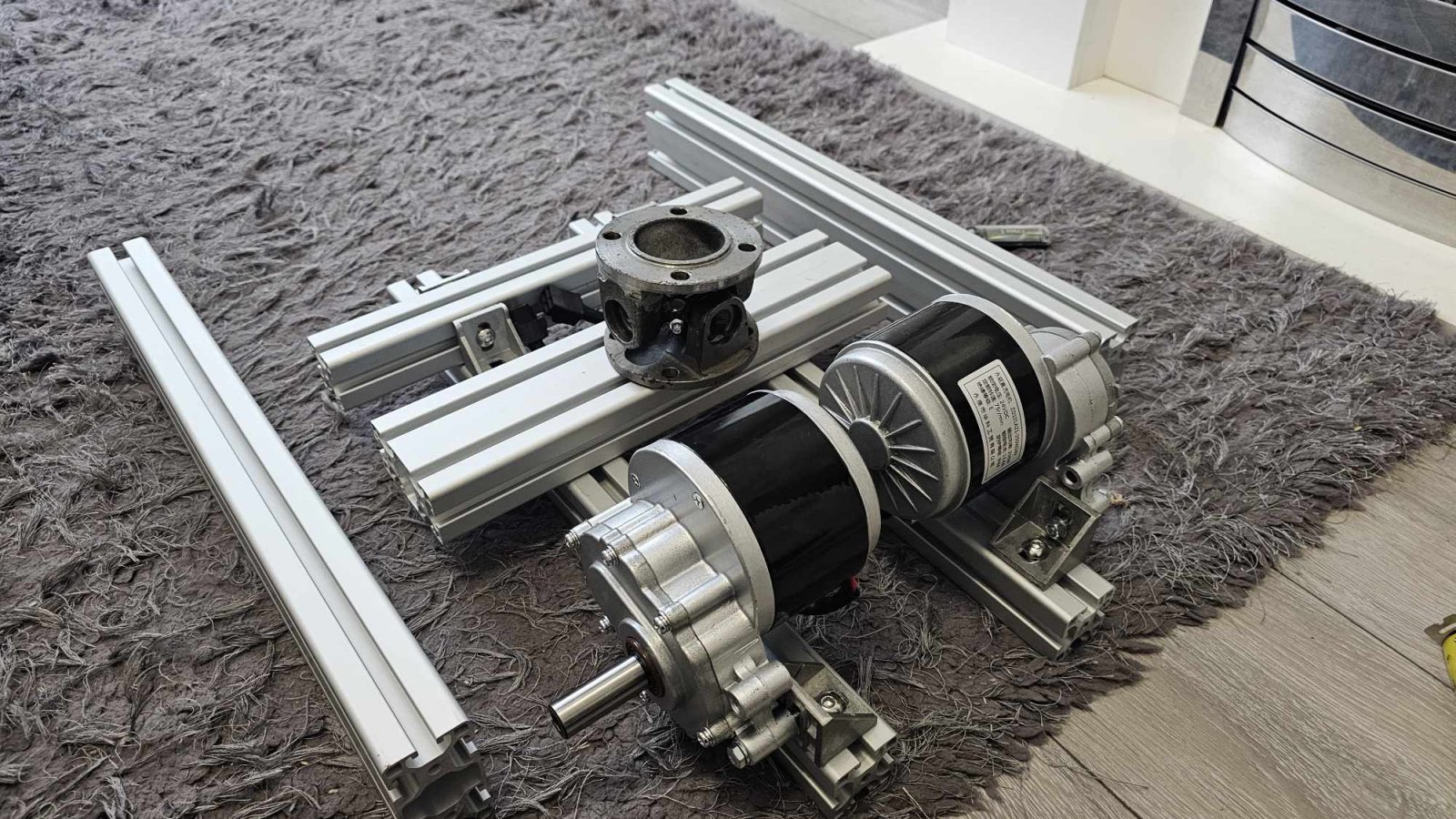

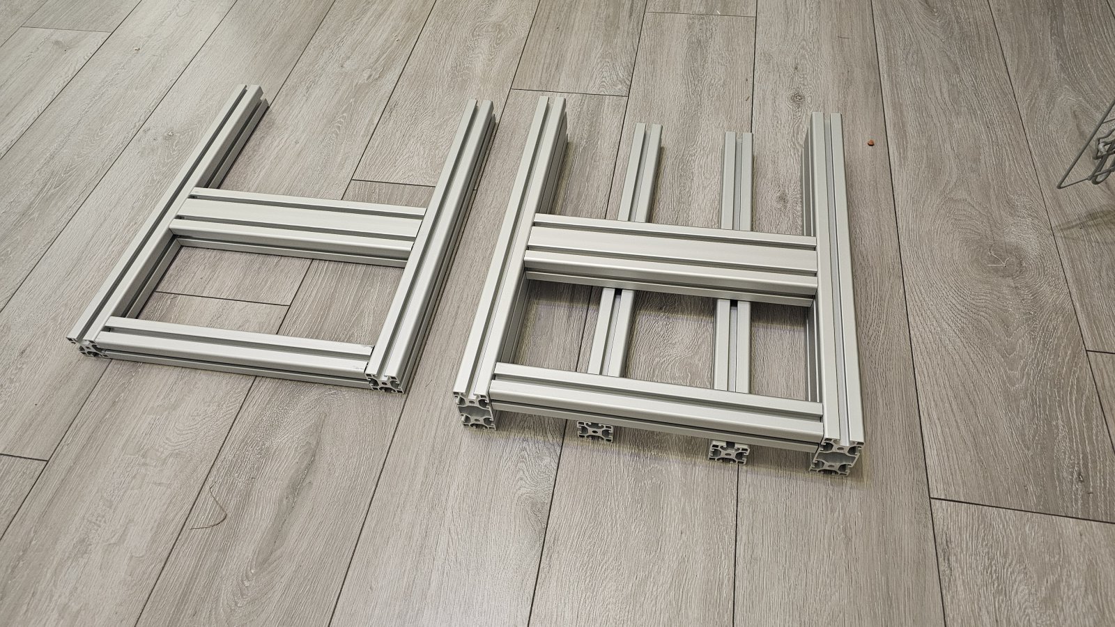

    @Gefahren I've gone for the N2 version of the power supplies, they will be here sometime during the week.
    I also had the 4040 connector brackets turn up so the frame is assembled to start looking at the universal joint mount options. That will be here tomorrow and I am hoping the hole spacing will tie in nicely with the profiles.

    I miscalculated a couple of aluminium pieces, so the replacements are on their way.
