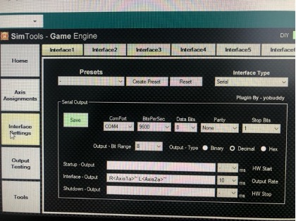

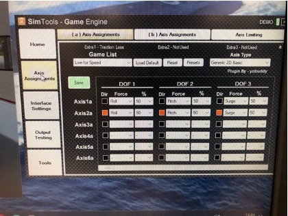

    Installation of LFS demo and Simtools demo. We played the game in “solo” mode as you advise on the forum. Setting up simtools:
    We reinstalled the plugin several times to get LFS and Simtools to communicate. We stopped and restarted LFS and Simtools. The method for LFS and simtools to communicate is not easy.
    Interface configuration:
    Arduino board connection :

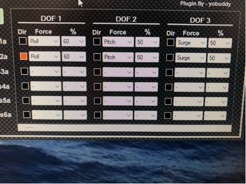

    The sequel with a small “Ferrari”.
    Changes in the settings, which will surely need to be improved further.
