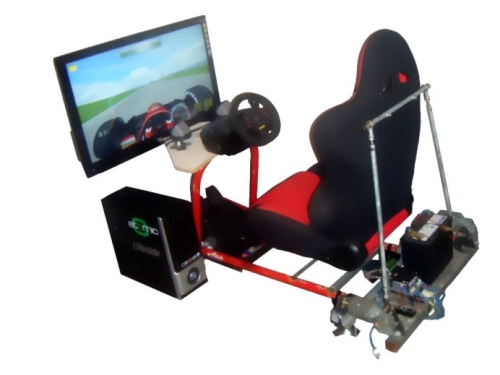

    My first ever attempt.. a simple seat and frame.. [​IMG]
    Then improved when sim sites found...[​IMG]
    (12V car battery [​IMG])

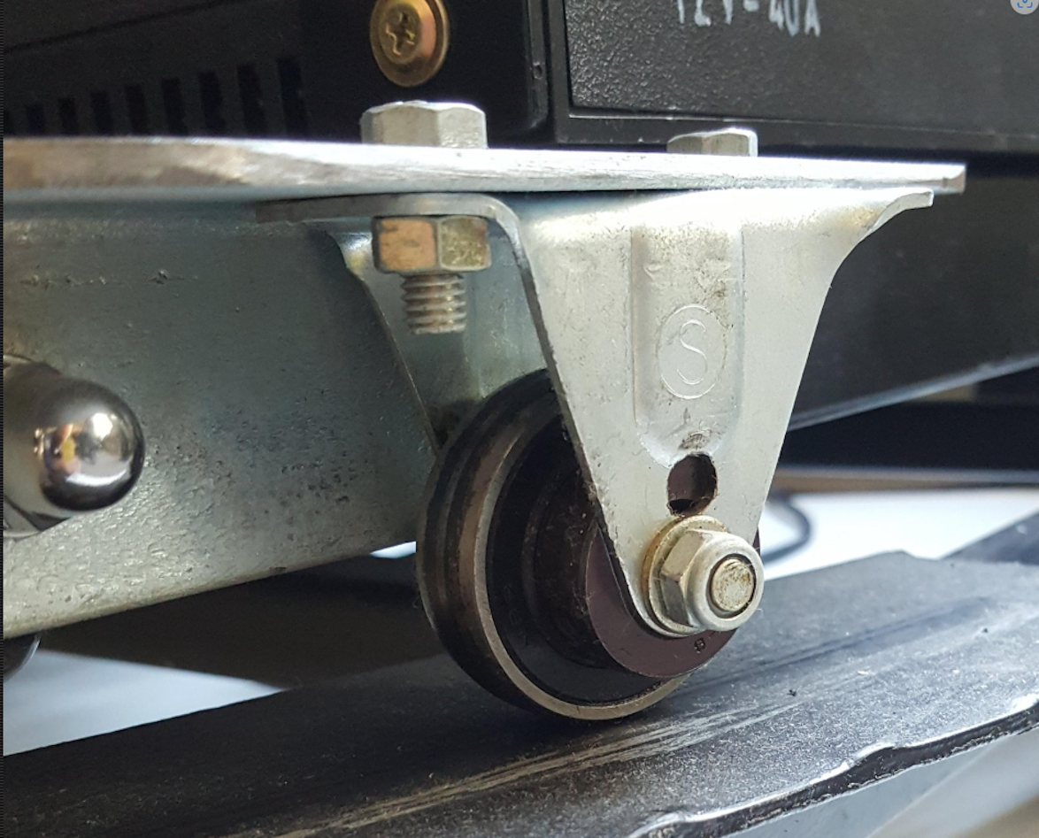

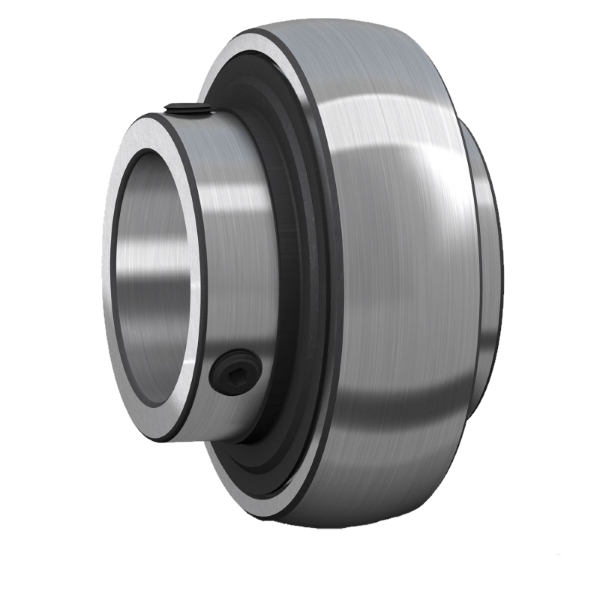

    The introduction of this frame added an extra sway feeling to my rig, but the use of standard rubber castor wheels made the movement slack and ' very heavy' when setting in the chair. Few types of wheels options were tested, first was the 2 castor rubber wheel which did not work, then swopped to nylon wheels, but friction still too high and movement still restricted.; and finally, the use of spherical metal bearing did the trick. The minimum contact point meant full sway effect with minimal afford.
    These bearing come with a large inner hole I used a piece of a timber rod as bush and the castor wheels metal holder as housing. The shaft holes of the castor wheels housing was also modified as the new bearing has a larger outside diameter.

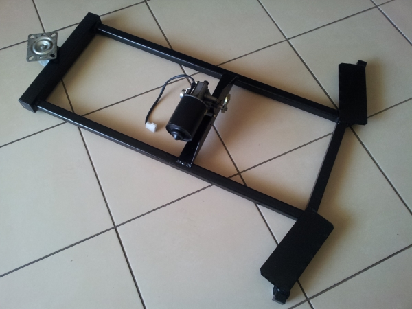

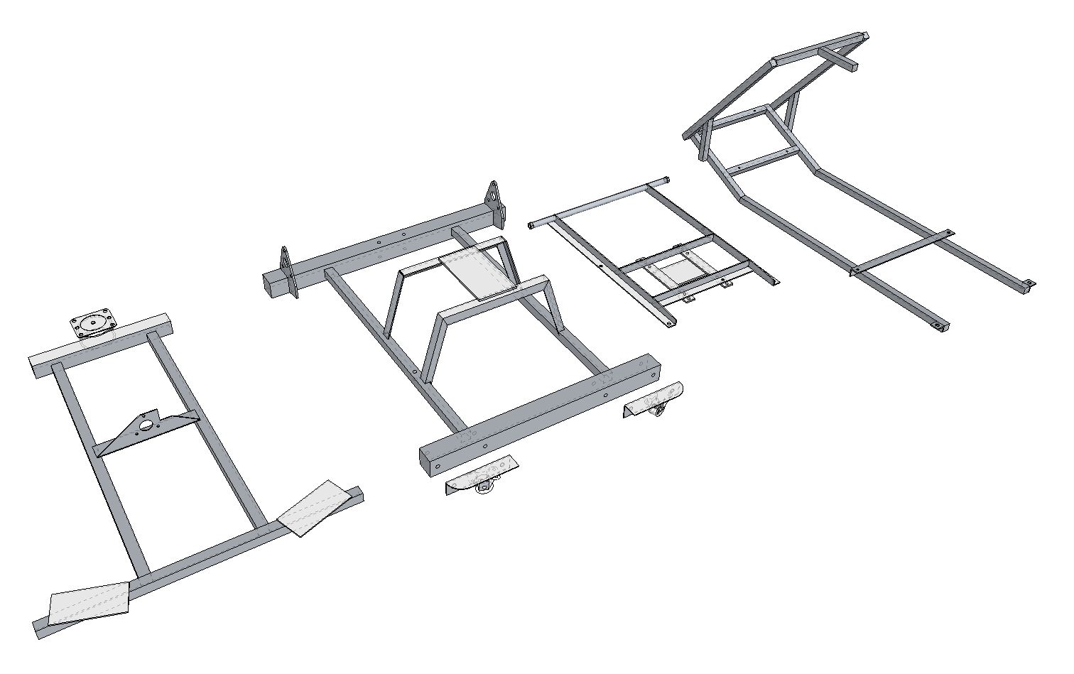

    DESCRIPTION OF UNIT:Full Square steel tube main structure.
    • The adjustable seat frame allows an intermediate frame to be placed between the adjustment slider and the actual seat. This allows only the feet portion of the main moving frame to move by about 120mm, thus keeping the driver body always in the same position.
    • Maximum amperage reached at full blast is a mere 10Amps total. (at +/-100kg full load)

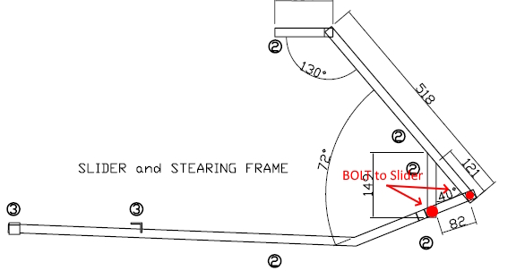

    Concerning the framework, I would like to suggest having the Steering frame bolted to the Slider frame rather than welded. (2 x bolts and nuts per side)
    This allows for dismantling if transport needed.

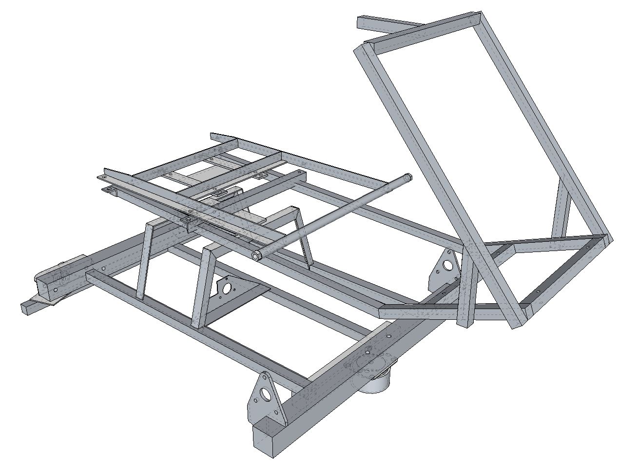

    The SketchUp 8 drawing can be uploaded from:
    http://www.mediafire.com/download/x0ibxpyz3c084ga/2DOF 3DOF chair.skp
    If interested in the actual components' sizes, you can download the CAD pdf drawing here:
    http://www.mediafire.com/view/i9tz9enm995jizv/2DOF 3DOF Chair Components.pdf
    But please, note that to match your motor or selected components, you will require to alter or adjust some of the component's size or shapes. So, use this as a guideline only!

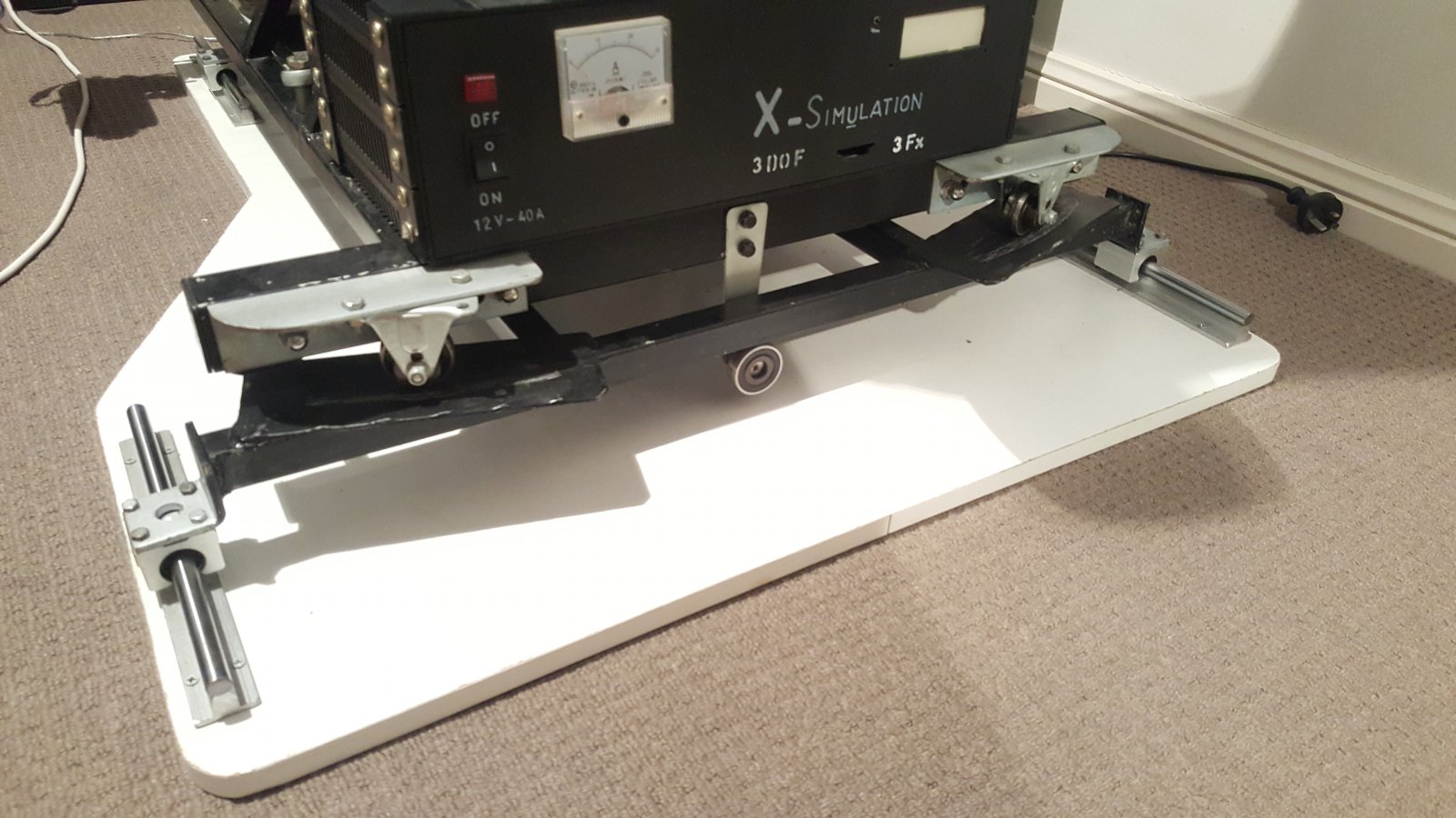

    Additional pictures below are showing the punched angle bar holding the aluminium footrest while strengthening the whole sliding frame. Also close up of the rear sway wheels and position pots.
    Bucket seat removed to show framing.

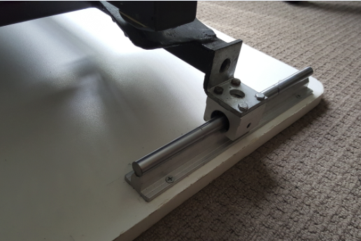

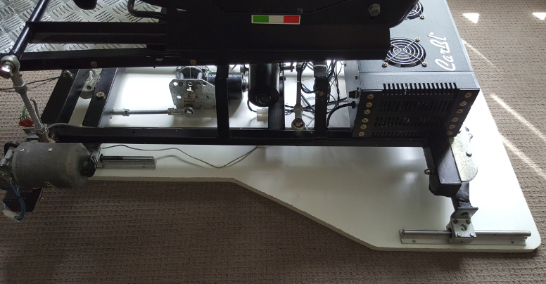

    But yet, not being satisfied with all the above work and mods, recently I added 1 extra movement to my rig, acceleration and braking. Giving a full 4DFO movement.
    This was easily done by welding 4x 40x40x40mm angle brackets to the 4 extremities of the bottom base and then bolting the 4 sets of linear bearing to them.
    With the linear bearing shafts are mounted on a MDF base
    MDF components in the pdf file:
    The motors driver (Micromite controller) then upgraded to allow the 4 inputs.

    Image 1.jpg Image 2.jpg Image 3.jpg Image 4.jpg Image 5.jpg Image 6.jpg Image 7.jpg Image 8.jpg Image 9.jpg

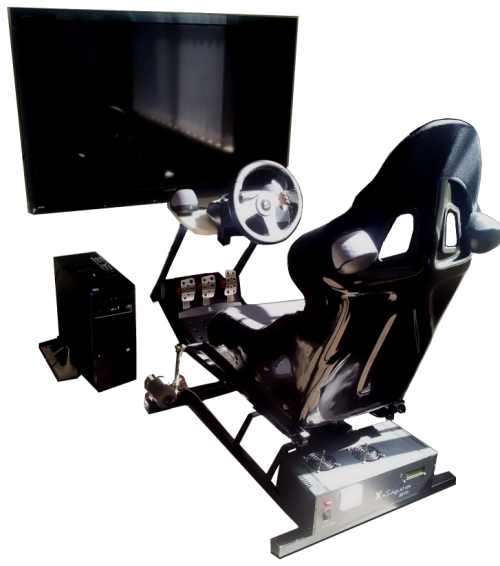

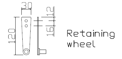

    But finally,
    This has taken few years to developer to this top 4DFO model. Although the structure might look a bit 'soft' to many, the unit was tested by drivers of double my weight... With the analog current meter showing only few Amps under loads and no flexibility in the frame structure.

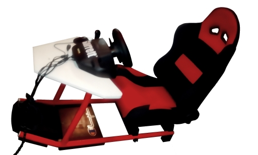

    Final unit sizes/movements:
