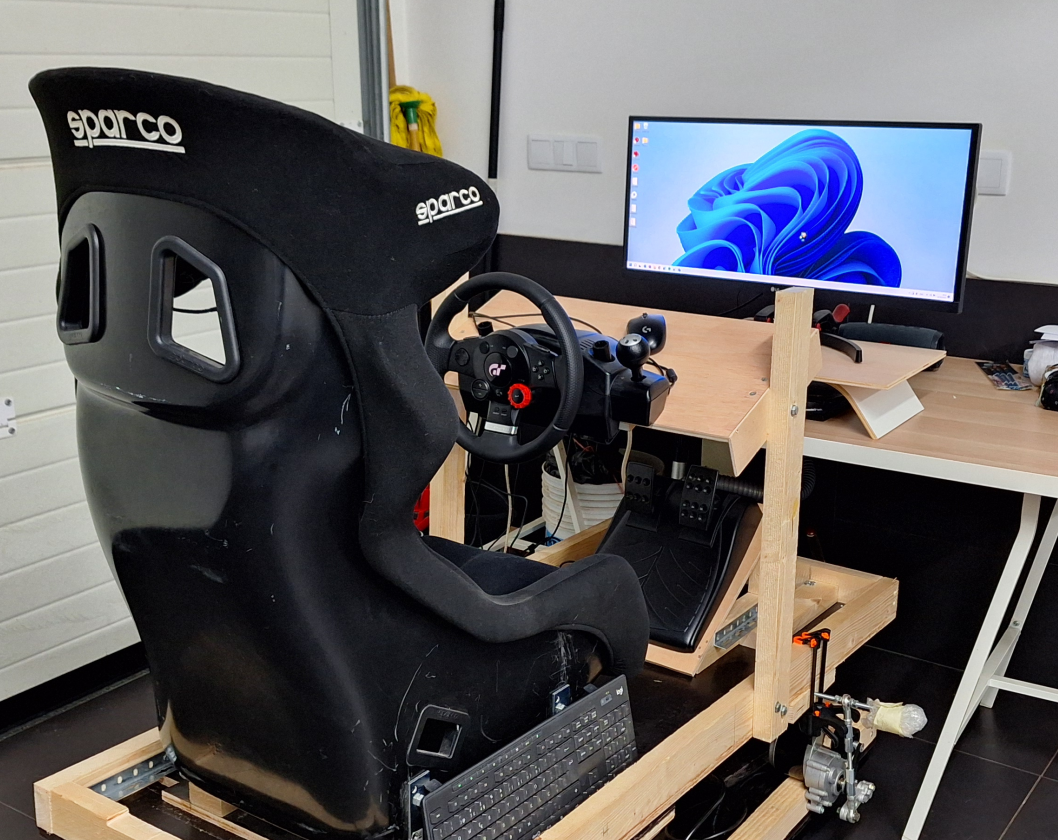

    Since I don't have any metal tooling I decided to build the sim rig in wood, so I went with (15 mm) sheets and some timber (30x60 mm and 50x50 mm - the 3x2's that I see much in this site wasn't available in the places I looked for - I'm in Portugal, don't know if that measurement is much in use around here).
    @flipflop was fantastic in his help and was able to provide the measures that he used to build its rig. Starting with that information I adapted to the tooling that I've (I have a small manual saw and an electric jigsaw) and came up with this:
    The seat from Sparco was an offer and it's an old seat from a classic rally driver who could not use the seat anymore (FIA no longer accepts this model).
    As you can see, I have a very old Logitech wheel that comes with some s**y pedals, hope to invest in these later (especially the pedals).
    So, this is the top frame, 140x60 plywood sheet with 30x60 mm timber. These pieces are held together with a lot of screws :p
    I then started to work on the middle or lower frame (3DOF or 2 DOF), so, once again, following flipflop inspiration, I created a wood tower with a 20 cm height to hold the universal joint.
    This is screwed to a wood sandwich composed of the top layer, plus 2 plywood sheets with a matrix of 15 screws.
    The middle frame has the same dimensions as the top layer but the wood around it is 50x50 mm, I chose this wider wood to support the pressure of the 2 motors.
    To discover where to place the joint, I followed a video from D Max () and, although the seat plus the wood are heavy, I can move them around with just a finger.

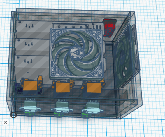

    I'm now building a box to concentrate all the electronics.
    Initial plans:
    Real life (I know the power supplies are not in the correct order, but I don't have any more wire terminals to fix the wire length and fix this, hope to have some time to go the shop this weekend):
    The fans are not mounted, yet, because I need to buy the electric circuit to reduce the voltage from 24v to 12v).

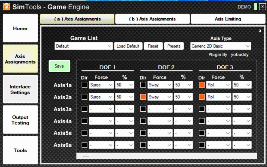

    1 AM and I'm reading the documentation for SimTools and trying to understand how the axis mapping work :p
    At first, I thought there was a 1 to 1 relation between columns and motors.
    One Axis was one DOF, so, at this moment I have 2 motors, I would configure Axis1a to the left motor and invert the direction, and Axis2a to the right motor, but it seems that this is more complex than I thought, at least, looking at some examples, I see people with 2 DOF configuring more than "2 columns" :)

    Great to see you have leapt back in and progressed your rig :thumbs
    When it comes to SimTools first grab a copy of the SimTools manual and keep it handy for reference: https://www.xsimulator.net/community/faq/rtfm-start-with-the-official-simtools-documentation.117/
    Then see the motion profile tips in the FAQs: https://www.xsimulator.net/community/faq/steps-to-create-a-motion-profile.228/
    While you have a 2DOF, SimTools can simulate and mix on the fly other axis, so even with a 2DOF configure sway, surge, heave, roll and pitch.

    Well, I reinstalled LFS in the root directory (before, it was inside Program Files), installed Sim Tools 2, set the Axis Assignments to:
    And I got it working :)
    I don't know why version 3 wasn't working for me, I set the same settings as I did here, even on the test area, the rig would not move (I will check this later).

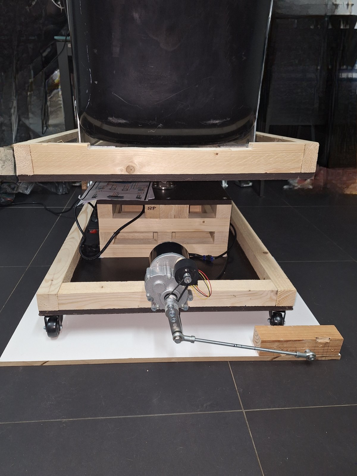

    Just added the 3rd DOF, traction lost and it's fantastic.
    Just run several laps in Imola and in SPA and it's great and it was simpler than I thought, my front wheel was replaced by two metal Ls screwed to a sheet of plywood and the motor was placed on the middle of the bottom frame.
    Another sheet of plywood was used and block of wood was used as an anchor, ideally, the sheet of plywood should be the same as the one used on the front,but I had these two pieces from an IKEA project and it worked .
    @flipflop one again I used one of your ideas (I was going to use a lazy Susan), you are the main source of the ideas in this project, kudos to you. BTW: the power supplies are working great, at least, until now, I had zero problems.

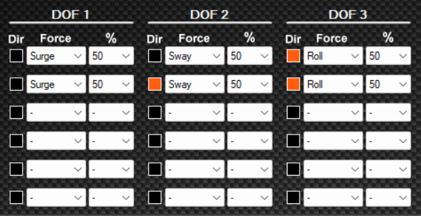

    Regarding the simtools V3, it was my fault, I didn't notice that the configuration of the axis is different from the V2, what was on the rows, now goes into the columns
    Thank you all (it's 2:45 am and I'm going to bed with a smile on my face)
