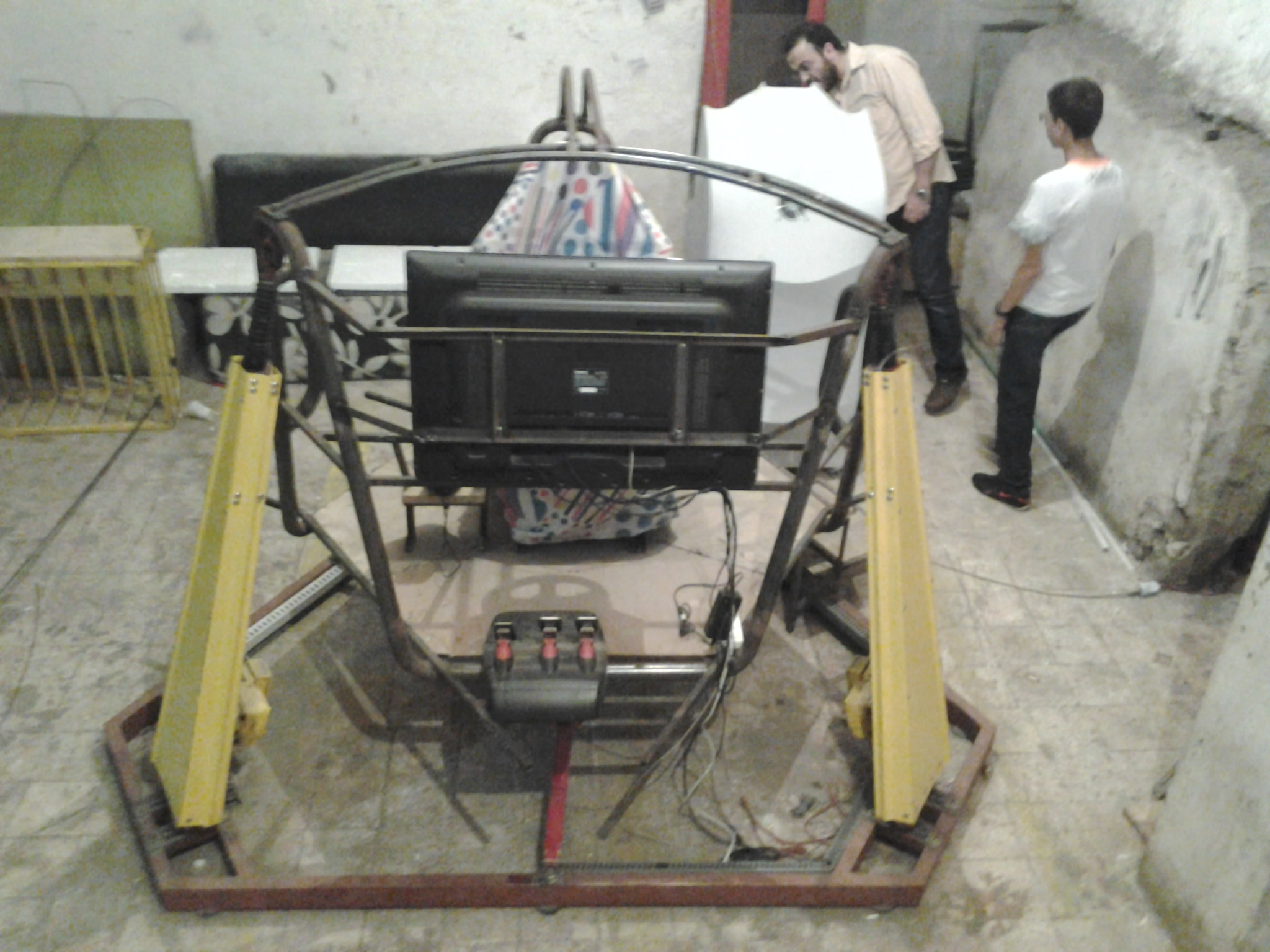

    Good day every one ...
    I'm from Alexandria/Egypt ... I here present a 4DOF simulator running the LFS game ... 3 channels of them is for motion actuators [right, left, and back ] .. and the 4th channel is for the air speed blower motor for overall actual speed sensing while driving ...
    Enjoy the video ... Sorry ... the air blower is still not ready here .
    On Early point ... I've searched for a complete simulator system that can be DIY and found that this xsimulator.net forum contain the most wanted information ever needed ...
    Basically every one will encounter some problems in his way to build his own simulator that needs to be solved ... And the AMC 1.5 and 1.6 controller have some problem with me [It is not that kind of DIY universal technology for every one wherever he is ...]
    1. since that I don't have ATMEGA644 in Egypt local market "I don't know why ?" ...
    2. the most recent computers have only one 9pin serial port to connect one AMC board , if any are found ...
    3. the Arduino board is expensive and very complicated "for me I guess " ...
    4. the spark-fun USB-to-UART module is related to the ATEMA644 in the AMC1.6 board project only ...
    And as many others may share this case with me ... Mr./Prilad managed to make the Revolution FW and SW for the ATMEGA8535 to communicate with the USB port as most new PC's preferred built in communication port ... a point that Thanos couldn't give a hand through it with all my respect to only his valuable projects ...
    For the controller board here I used the ATMEGA8535 micro controller ... With a USB connection to thecomputer's USB port as many controller boards are today [and here I've got a big FW programming help into this] ... For a 4 DOF simulator I used 2 controller cards with 2 controlling channels for each one of them ... placing each card [as housing case ] inside a computer Old CD-ROM drives covers with the LCD stuck in its plastic front face ... and used the back side of the housing case for various connections ... I'm using ATMEGA8535 IC with an external 22Mhz crystal and running with that Russian multifunction FW . Also an excellent peace of work of my big hero [​IMG] @prilad and @CraCk ... I like multifunction in every thing .
    to be continued ...
    coming soon the cook-bit with doors and windows and some Illusion design in exterior and interior of the car .

    Well done Speedy , Im glad you found the site again, all the worries are gone and Sim Tools is so easy to use and adapt. A real pleasure to use. More details on ya build is welcome, mmm a new controller that is more DIY , please post the details for other who may want to build a controller of such.
    And welcome back to the most friendly sim site in the world, yes we are trying our hardest to make everyone fell welcome and wanted.
    BTW I do like the ride.

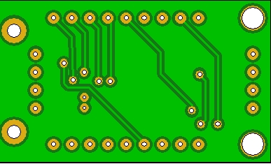

    Using the stander design for the AMEGA8535 as a micro-controller and the Cheap, Simple and easy to build circuit ... but uses the serial 9 pin connector to the computer ...​

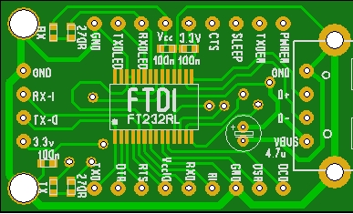

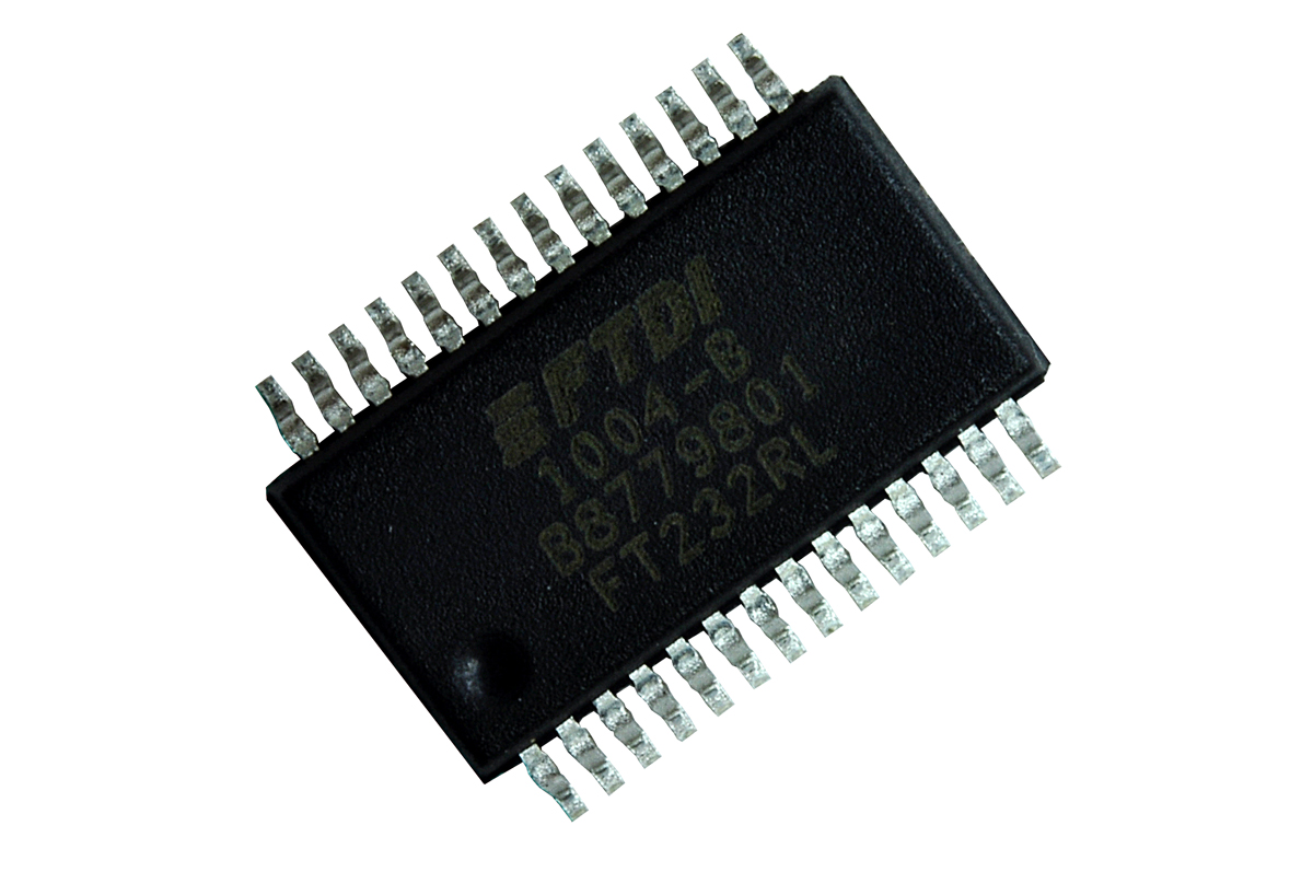

    So, I had a problem that I guess limited many others for there simulators to a 2DOF only ... That is many PC's now today rarely have a 9 pin serial port with a lot of USB ports ... and I needed 2 serial 9 pin ports to make 2 controllers :( .
    I didn't find the FTDI USB to serial converter that is used in the forums as suggested to connect more than one controller ... and found the blue converter " Prolific Technology" which is helpless :(.
    I didn't find the ATMEGA644 ... and found the Spark fun USB-UART module is so expensive .:(
    but found a blank FTDI232RL IC very cheap ...
    MMMM :think... So, decided to make my own USB-UART module and try it with the ATMEGA8535 with Prilad FW .
    Sparkfun FTDI USB to serial UART DIY board
    http://www.xsimulator.net/community/threads/sparkfun-ftdi-usb-to-serial-uart-diy-board.4789/
    Nothing is impossible ... :grin
    It is a pin compatible like the original Sparkfun and can be used as a direct replacement in any similar uses ...

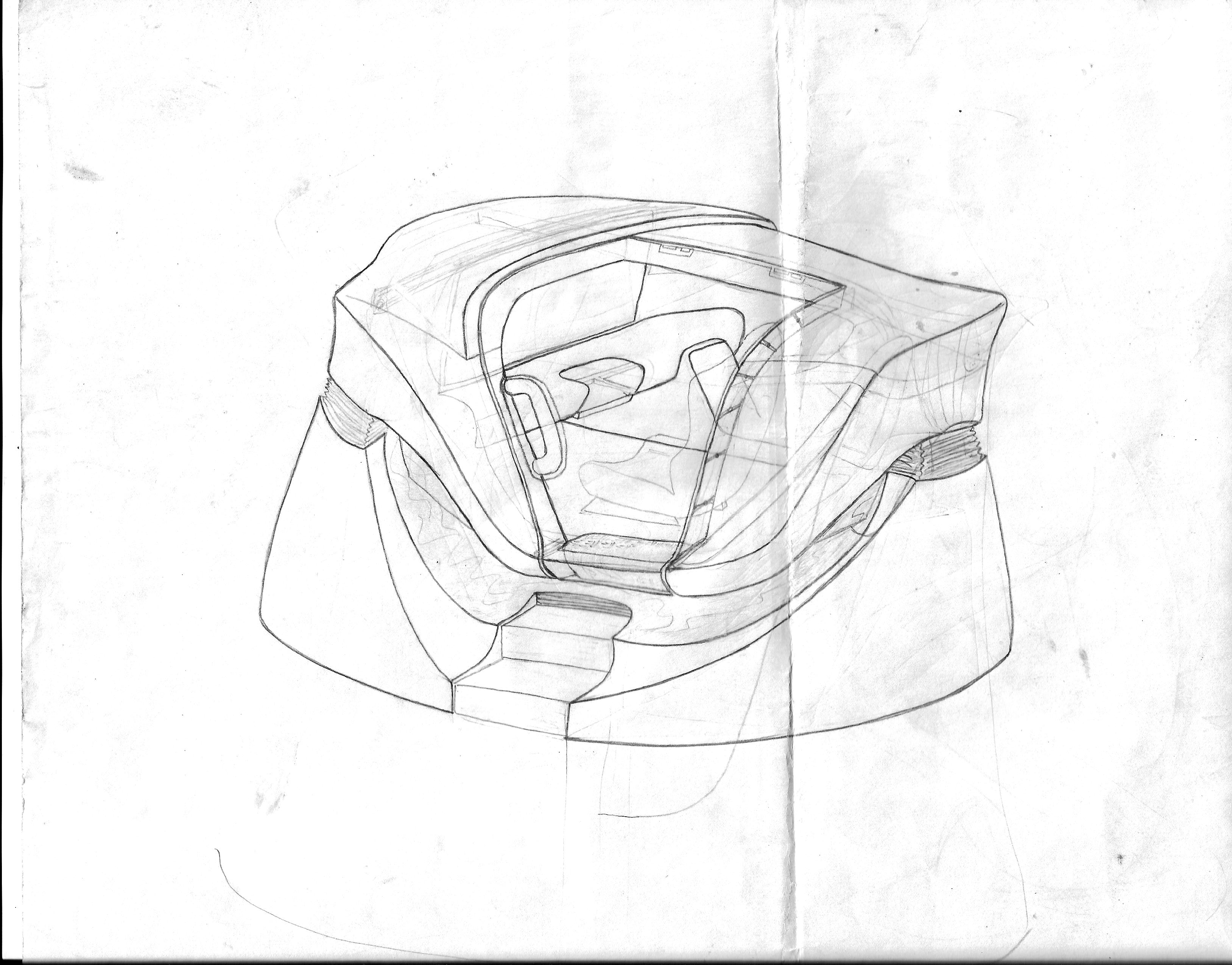

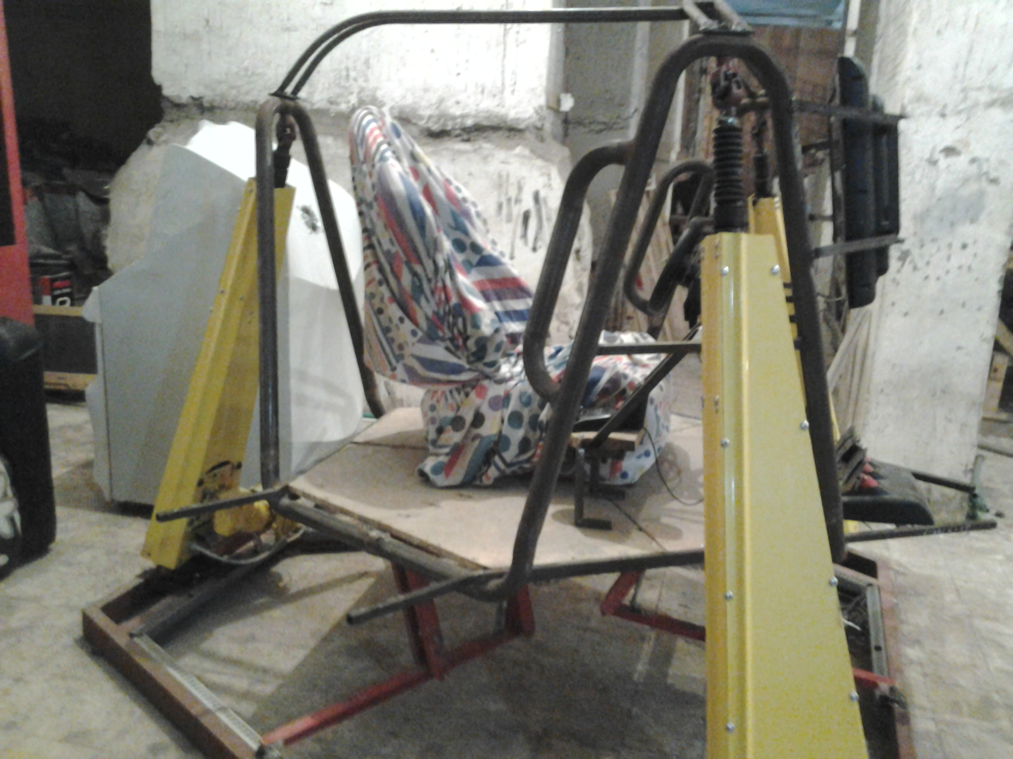

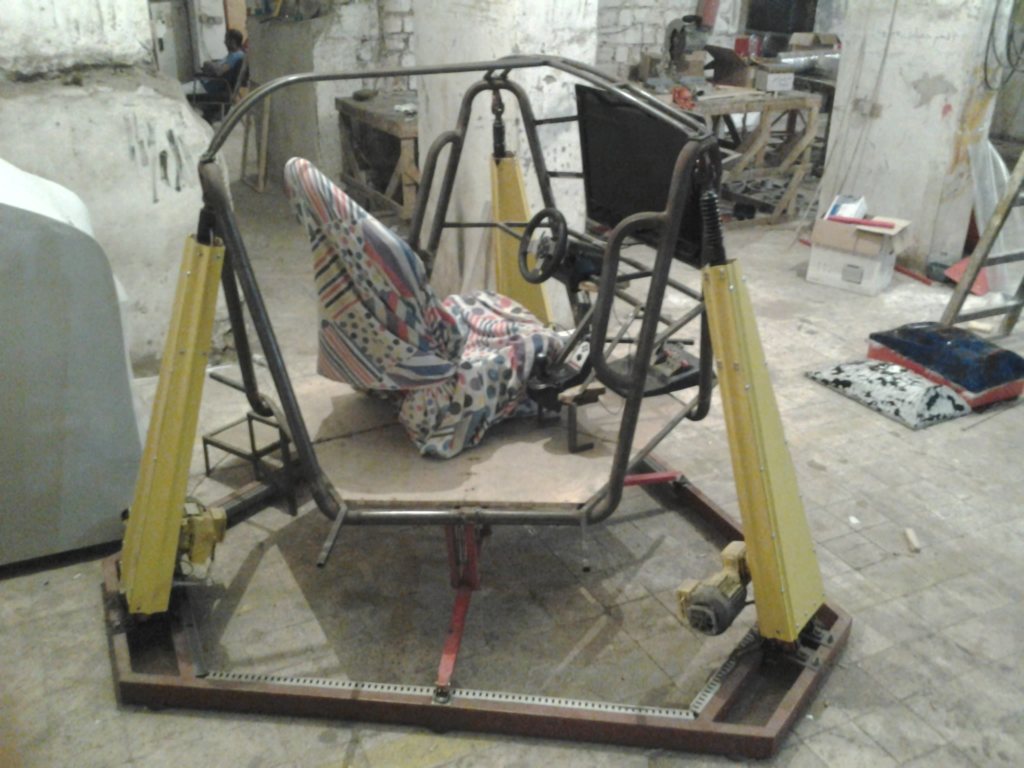

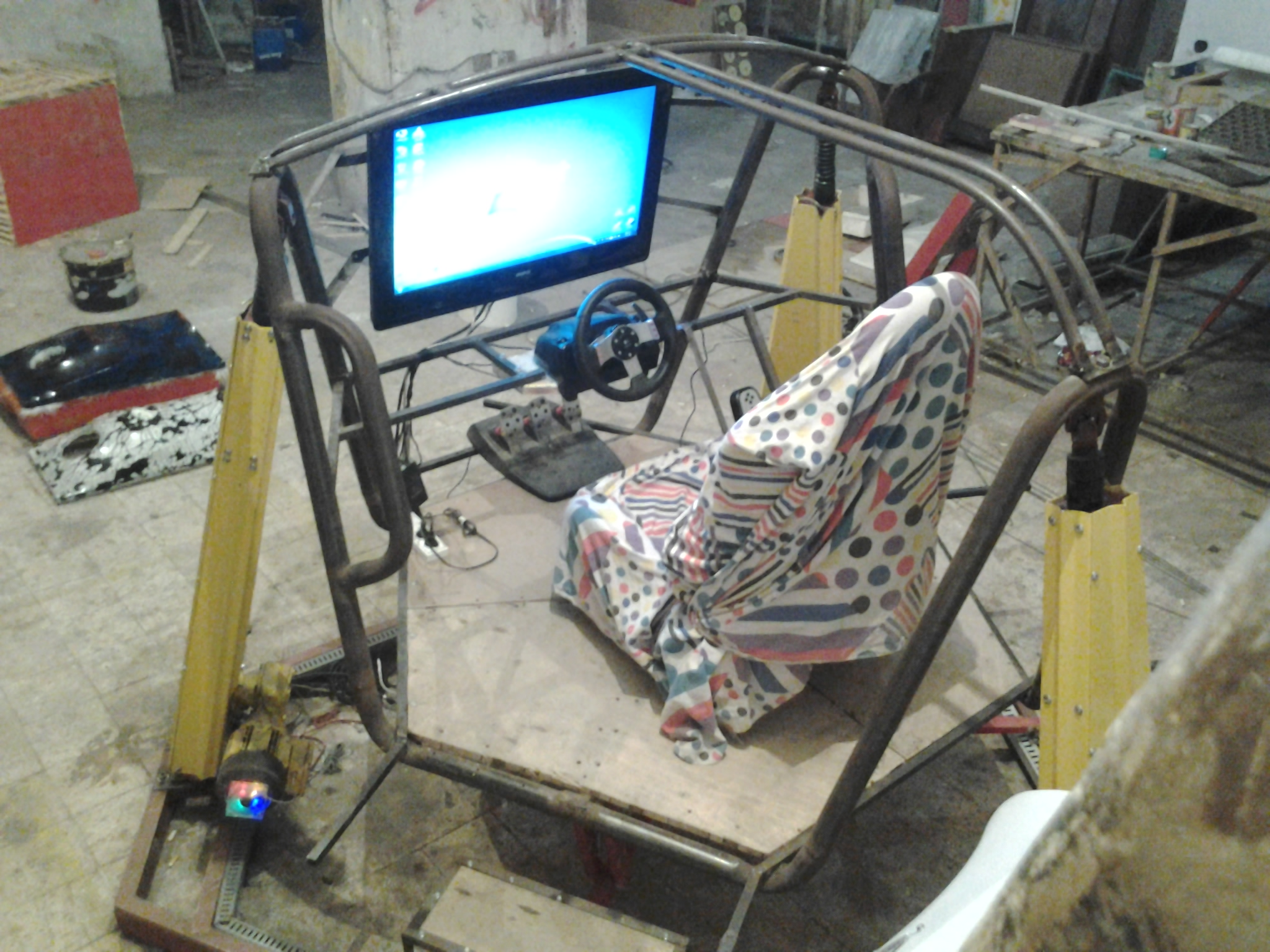

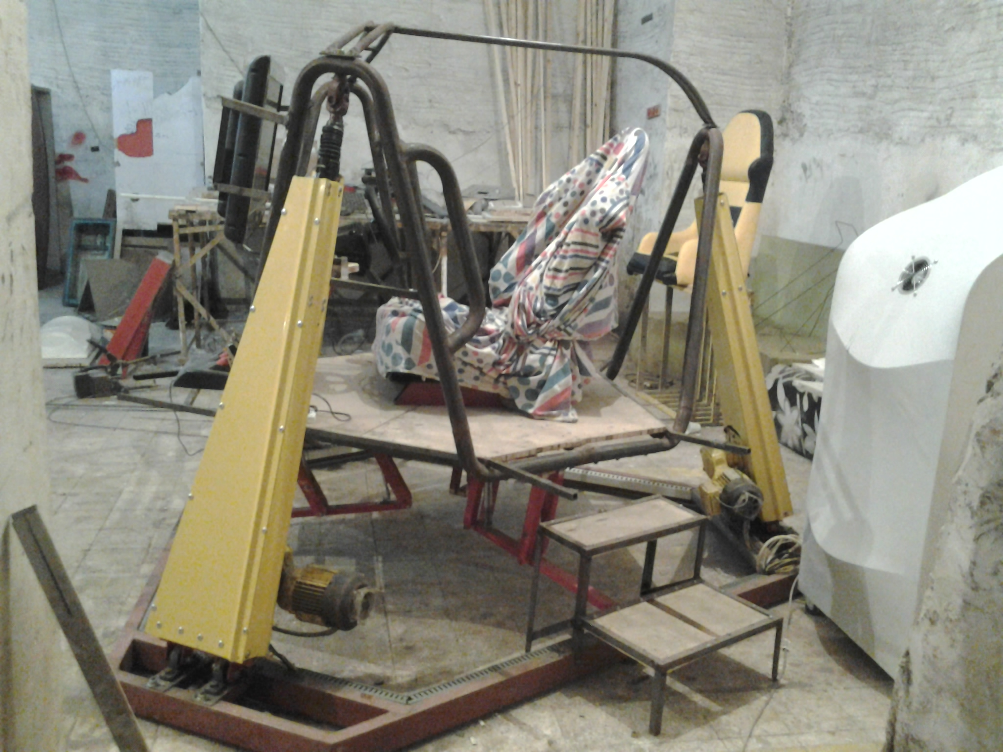

    Hi every one ...
    really sorry for not documenting all frame cutting and welding steps ...
    I took these photos and the video of lubricating the actuators ...
    and a freehand sketch of what it is going to look like soon ...
    2013-07-07 16.06.11.jpg 11.jpg 2013-07-07 16.10.43.jpg 2013-07-08 16.07.05.jpg 2013-07-08 16.07.48.jpg 2013-07-08 16.08.50.jpg

    Quick question , proberly a dumb on , is it running SimTools yet ?
    I wanna see this puppy rock in game. Keep us informed please.
