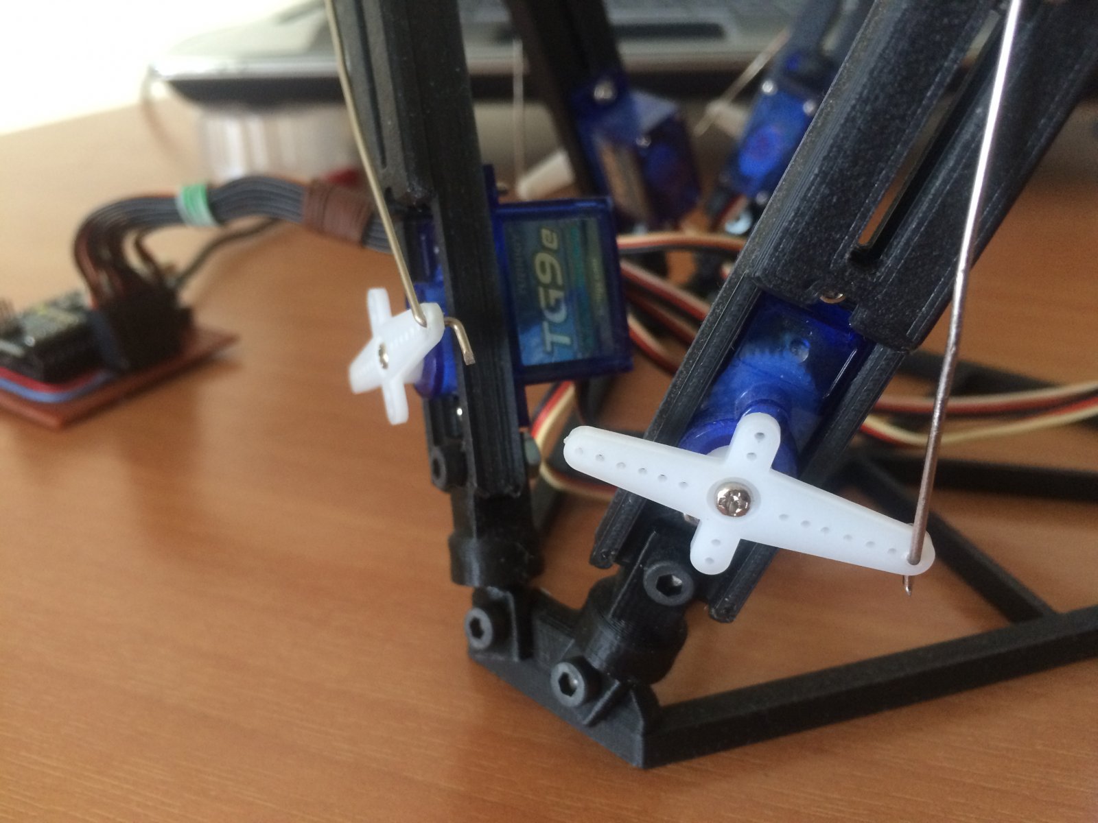

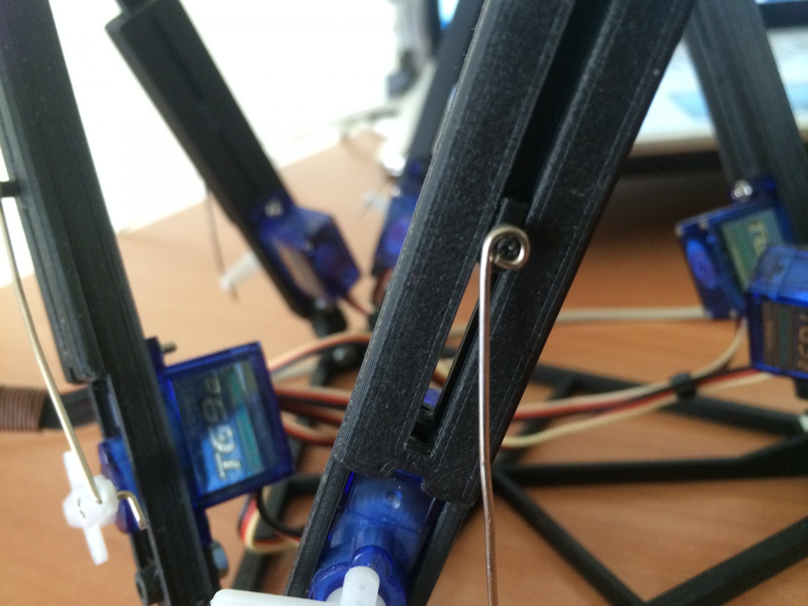

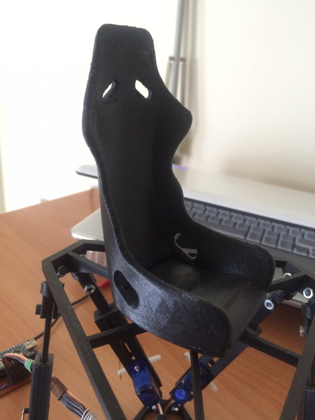

    as i wont be making a full scale 6 dof simulator in the near future:(, i made a scaled one i found on thingiverse https://www.thingiverse.com/thing:2038246 to have some fun with it:grin.
    IMG_0438.JPG IMG_0439.JPG IMG_0442.JPG IMG_0321.JPG IMG_0440.JPG IMG_0441.JPG IMG_0444.JPG IMG_0443.JPG
    seat is from thingiverse too https://www.thingiverse.com/thing:32318
    Parts list
    • 6 paper clips
    • 6 small screws
    • 24 m3 x12mm screws and nuts
    and of course a 3D printer:grin

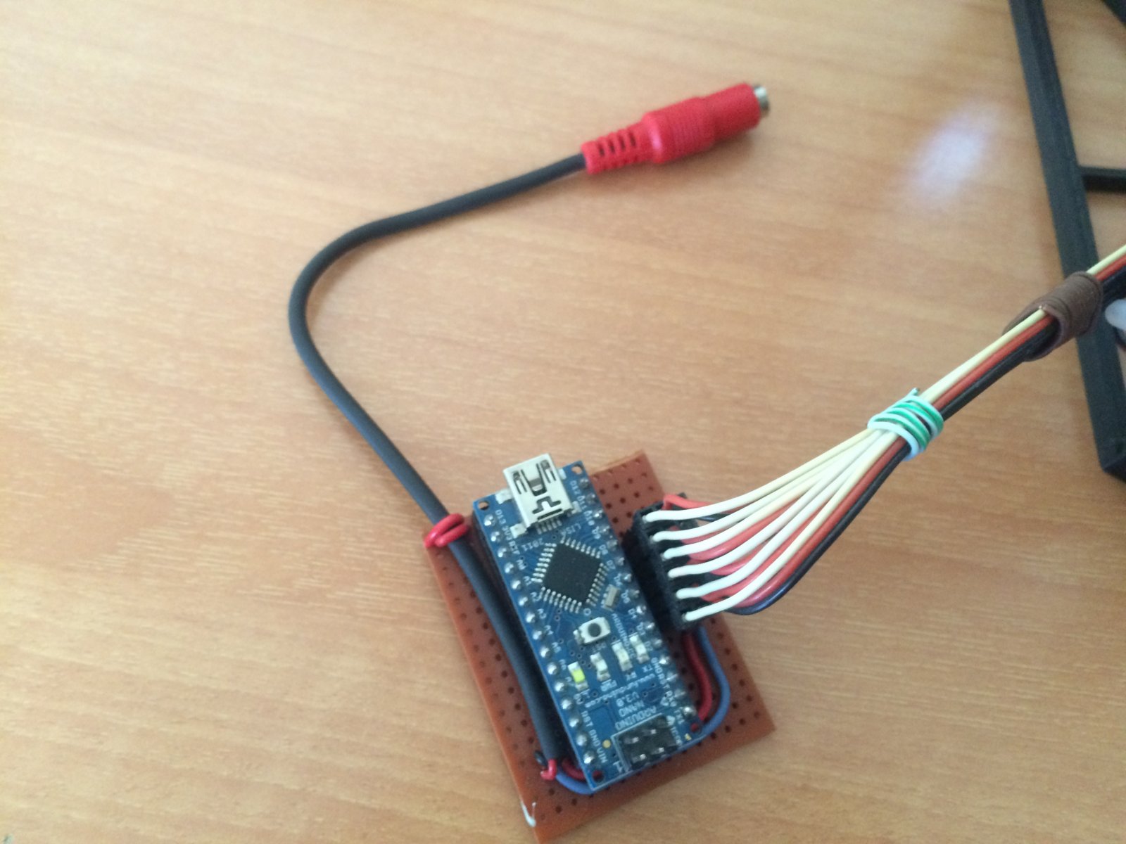

    Arduino code
    arduino code i used is from here https://www.xsimulator.net/community/marketplace/rc-model-code-for-arduino-uno-2dof-expandable.89/
    modified for 6 servos https://www.xsimulator.net/community/threads/my-project-guide-me.5682/#post-59262
    i had to use a external power supply 5V 1A because at some quick movements simtools was crashing.
    power supply solved it.

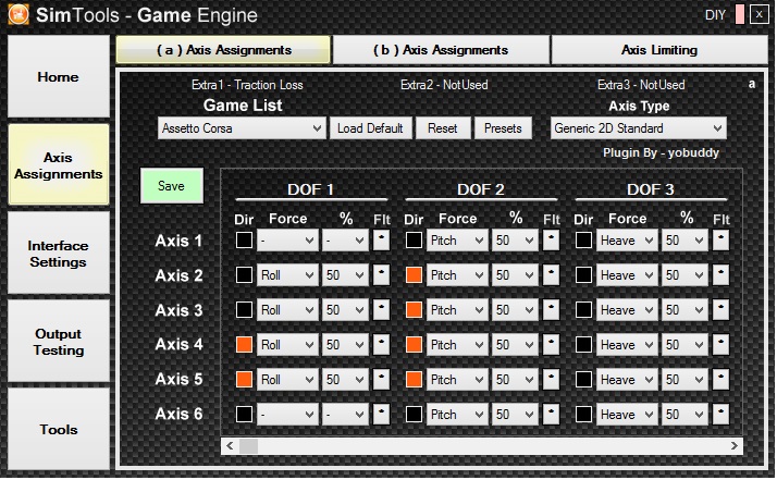

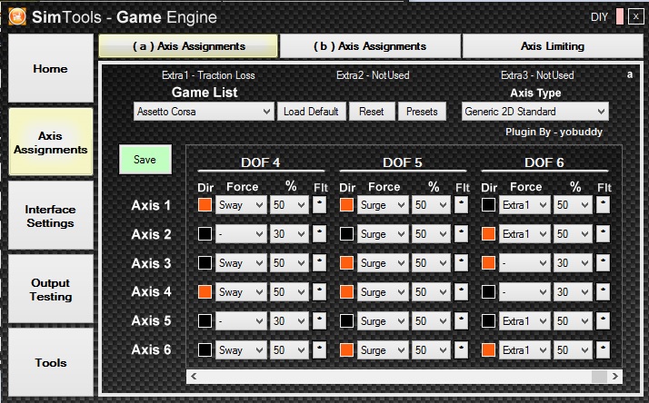

    i am not sure if i have configured well my axis assignments so some advise from the 6dof guys would be appreciated.
    here are my axis assignments
    Axis 1 is the the back left actuator and Axis 6 is the back right actuator counting clockwise.
    i know my percentage is high but could not find a setting i liked with smaller percentage(combination with tuning center) .
    too bad i cant get on it to make a better profile.

    @Zed agree with you. with eaorobbie's code and LFS plugin is a good start for people to get familiar with simtools
