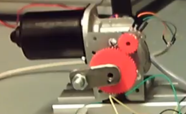

    I've recently noticed this cool design that would save a lot of time and give position feedback quite efficiently. Does anyone know of any STL or .OBJ files like this?

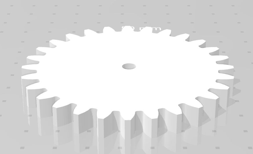

    I designed this gear in tinker cad. It's designed to fit a 12 volt wiper motor but my require drilling.
    The attached file is a txt file extension but if you change by renaming it to a .stl it should open as that.

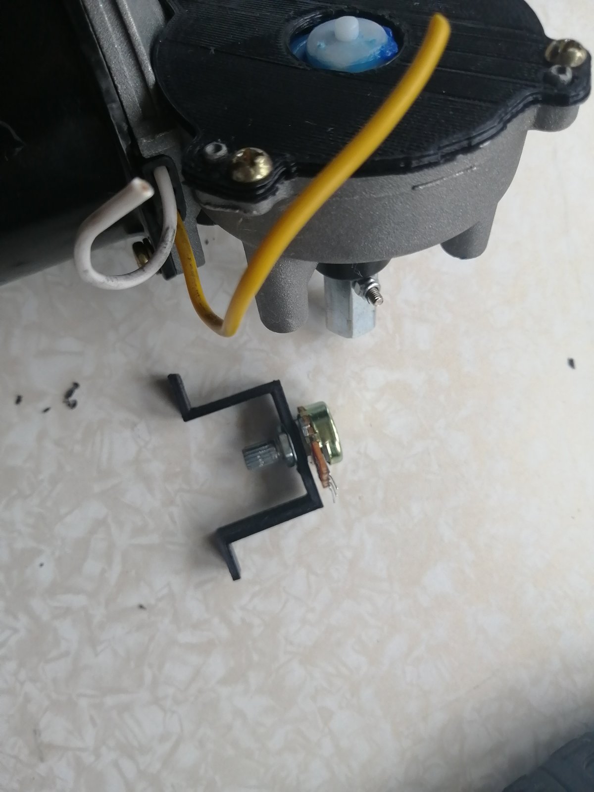

    Hi, in the end I never used cogs I used a 3d printed bracket to go on the back hold the potentiometer and it has a hole to spin with it. It works perfectly fine and will also avoid destroying the poentiometer as it's glued and will easily fall off under to much pressure Here is a picture. IMG_20200704_185508.jpg
