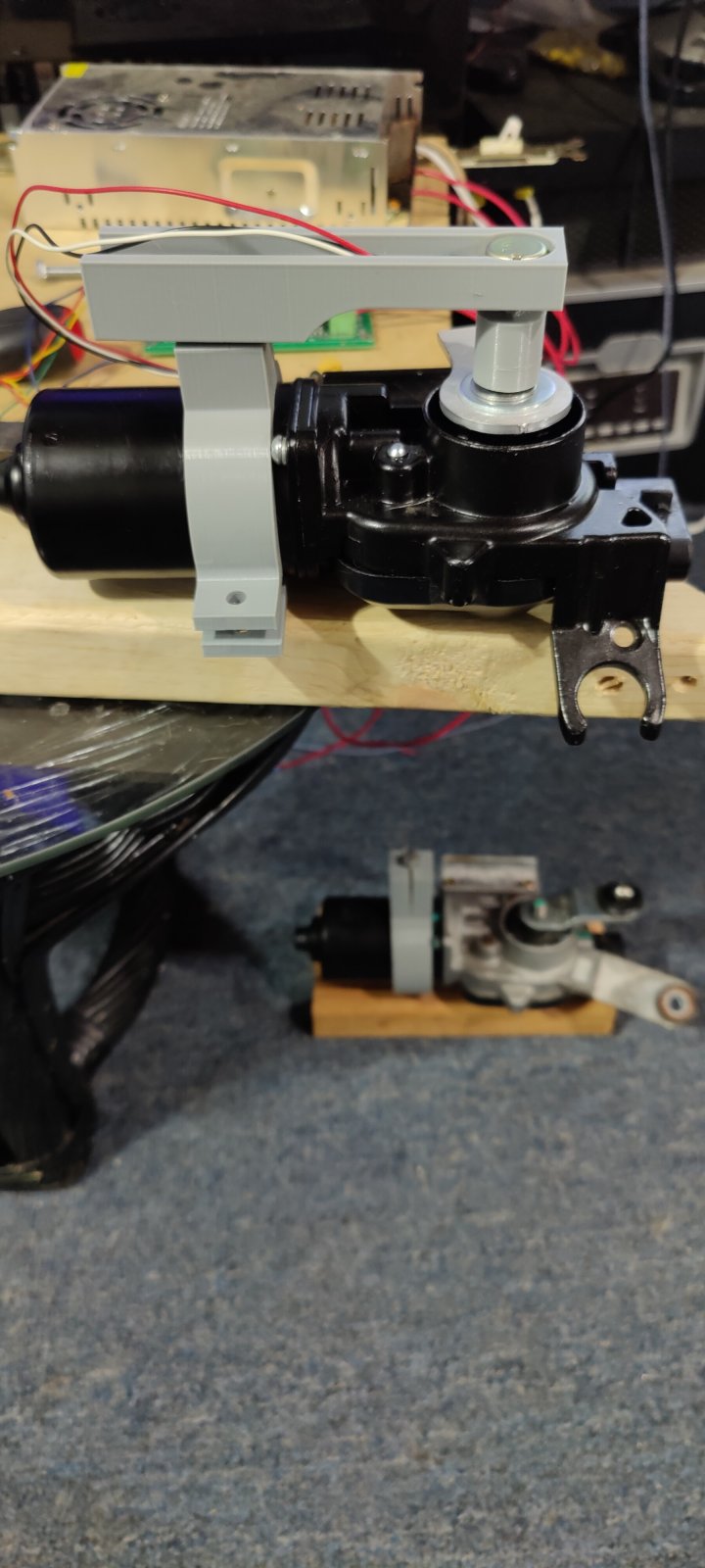

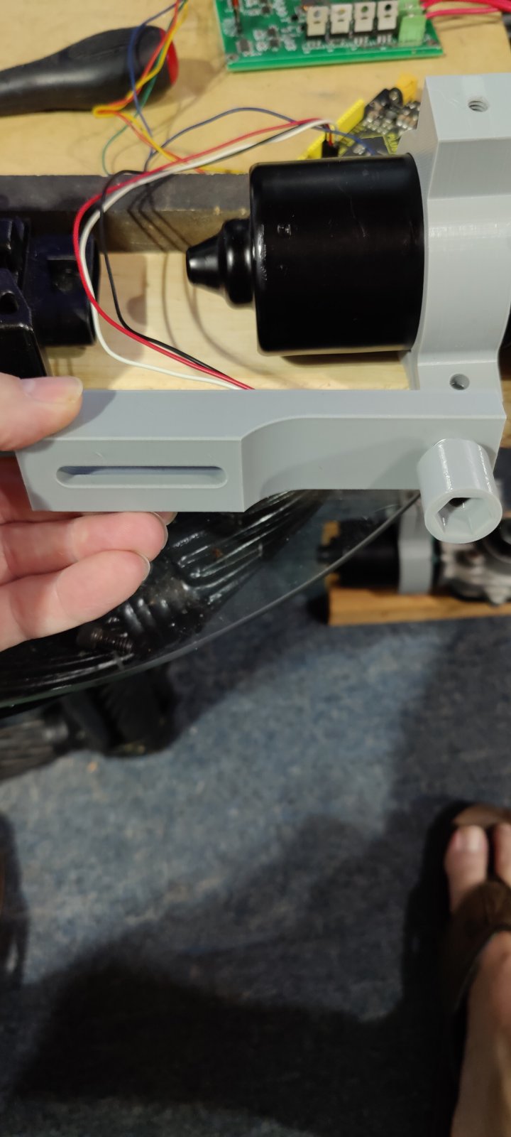

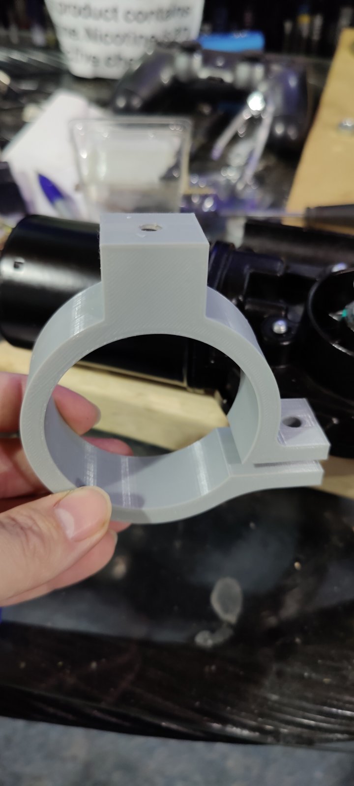

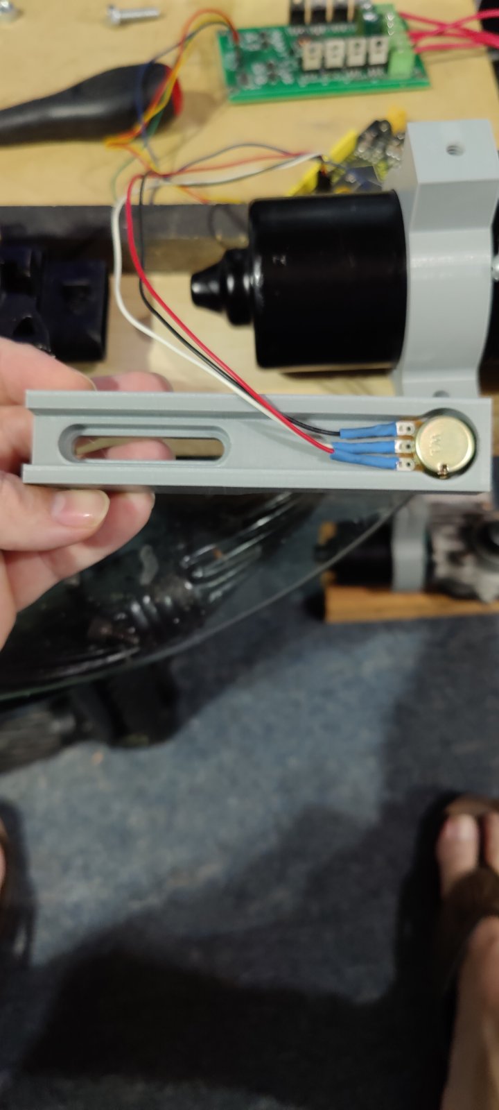

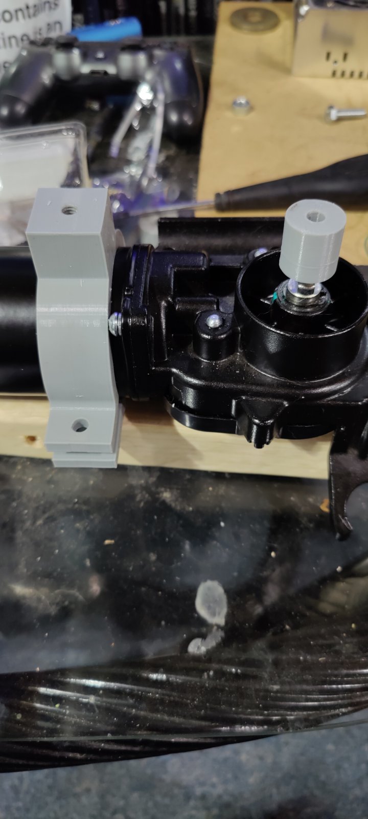

    Here is my design for mounting a pot to a wiper motor . this design is simple and takes about 7 hours to print all three pieces . This is designed to fit wiper motors from 06 Chevy equinox .
