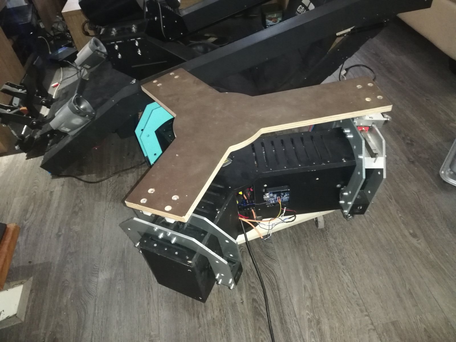

    i like the bicycle idee ..... i did some simular project for older people in a take care home with a bicycle with no motion , just pedaling and steering ..they could bicycle real life in there old town there lift one,s ..and keep them in action .
    some idee , cheap 3 dof with motion box . wp motors 24v with yaw also . myself and the seat 120 kg , no problem lifting .

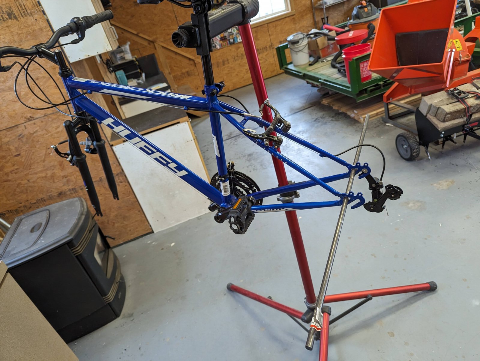

    Very cool. I've decided to go with https://www.aliexpress.us/item/3256...il_item.2.49fef19chsoEc3&gatewayAdapt=glo2usa these motors and these gear boxes: https://www.aliexpress.us/item/3256...il_item.2.49fef19chsoEc3&gatewayAdapt=glo2usa at a 50:1 reduction ratio. This should allow for a wide range of experimentation. I'm not light and there's also going to be a handlebar servo up there and a car alternator (probably if my eddy current brake expirements pay dividends) and my not so light frame, as well as the bicycle and whatever mounts.
    I tried buying a mountain bike on facebook marketplace but didn't want to pay $150 for some rusted out mongoose from 2004. Walmart had this Huffy (don't laugh it's a prototype) that I got for $88. I got 10% off because it had been used, the chain stay was beaten up and there was dirt all over it. They even left their lock on the bike lol. Anyway it will be interesting.

  7. adog6000
    adog6000 New Member
    Jan 31, 2024
    14
    84Coins
    The sacrificial Huffy.

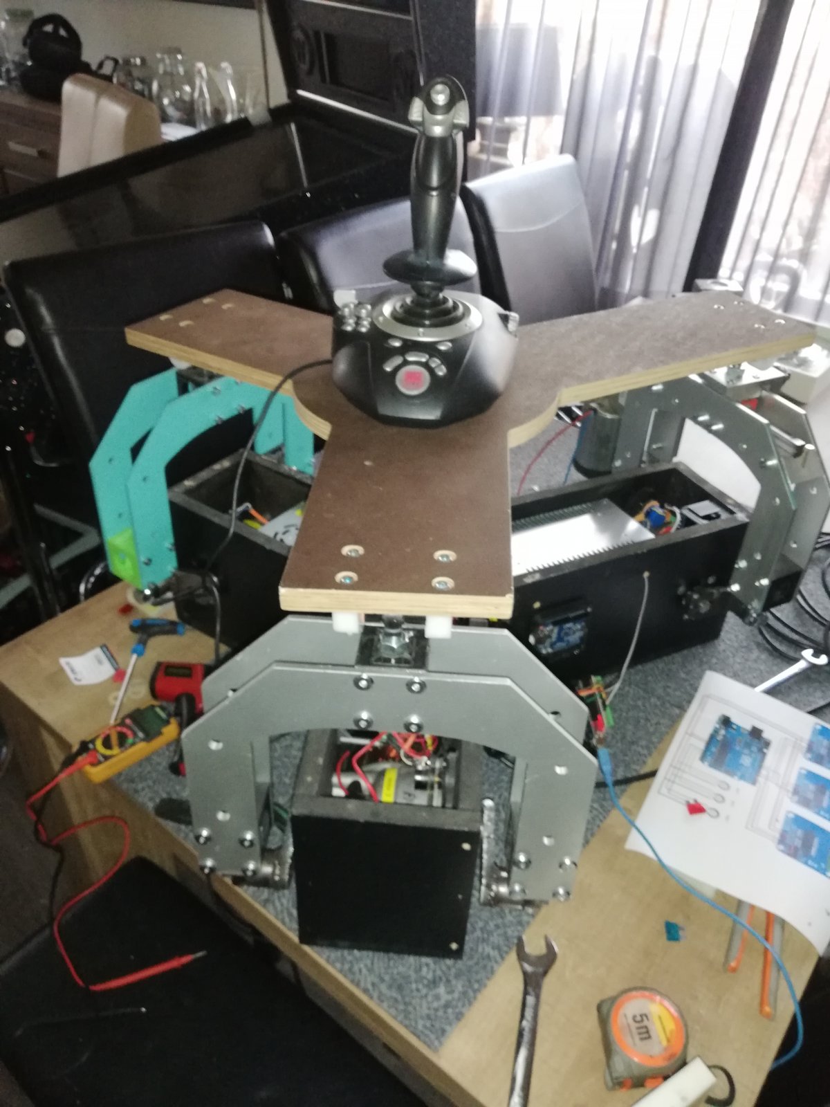

  8. adog6000
    adog6000 New Member
    Jan 31, 2024
    14
    84Coins
    So you're sitting on the joystick? Hmmm. :cheers:o:
  9. harrie
    harrie Member
    Oct 1, 2022
    48
    coevorden
    221Coins
    +20 / 0 / -0
    Arduino, 4DOF
    :grin funny guy .......... i also doing/making a flight sim 360 roll 360 pitch ... with f16 scaled cockpit in polyester. therefor was the old joystick , did buy me warthog system .
