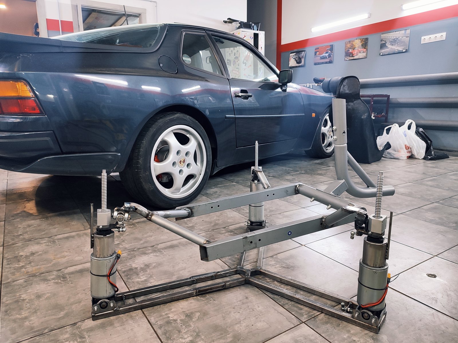

    Trying to build my first moving sim with resources and space i have
    After a long readings and watching youtube i went from moving seat with wiper motors to some 3dof platform
    I'm trying to build silent and smooth-moving thing, with not a lot of travel but with Heave.
    Going actuator conception(not worm-geared)
    Hope i'm on the right way
    Also a haven't too much space for it, only 1 meter width and 2 meters of length
    List of components:
    1. Motors - DC brush motors Dunkermotoren 24v
    2. Ballscrew 1605
    3. PSU MeanWell 320W 18-24V one for each motor
    4. IBT2 - 1 or 2 for each motor
    5. Hall-type potentiometers
    And also a lot of bolts, nuts, lasercut and wires )
    So i'm started....

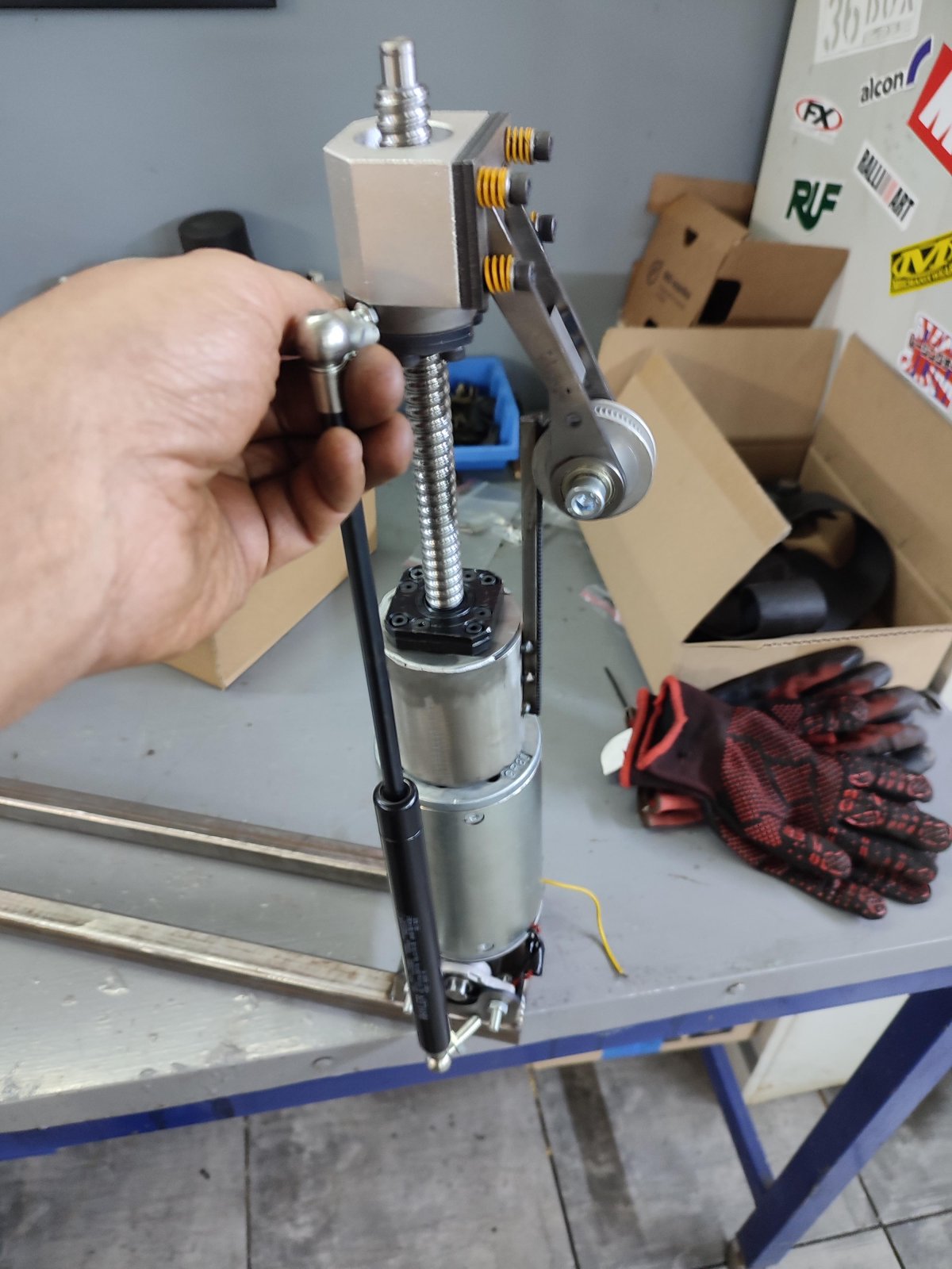

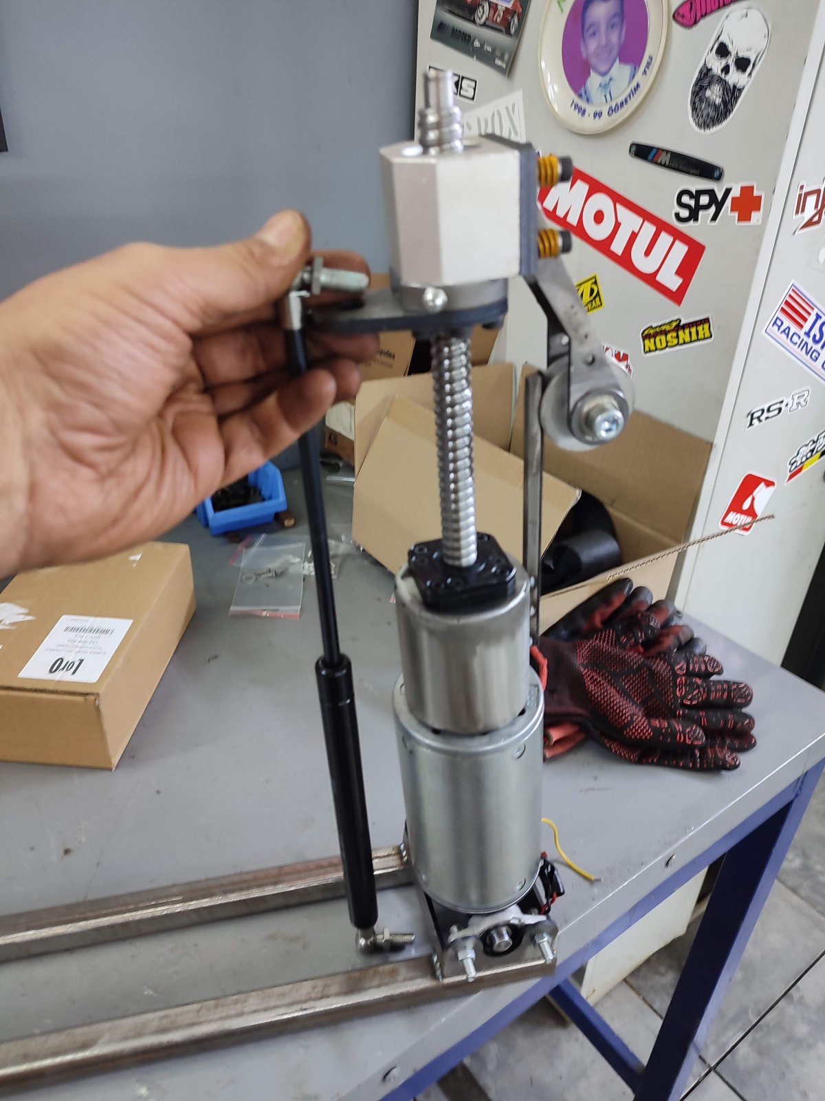

    Two of three brothers are ready

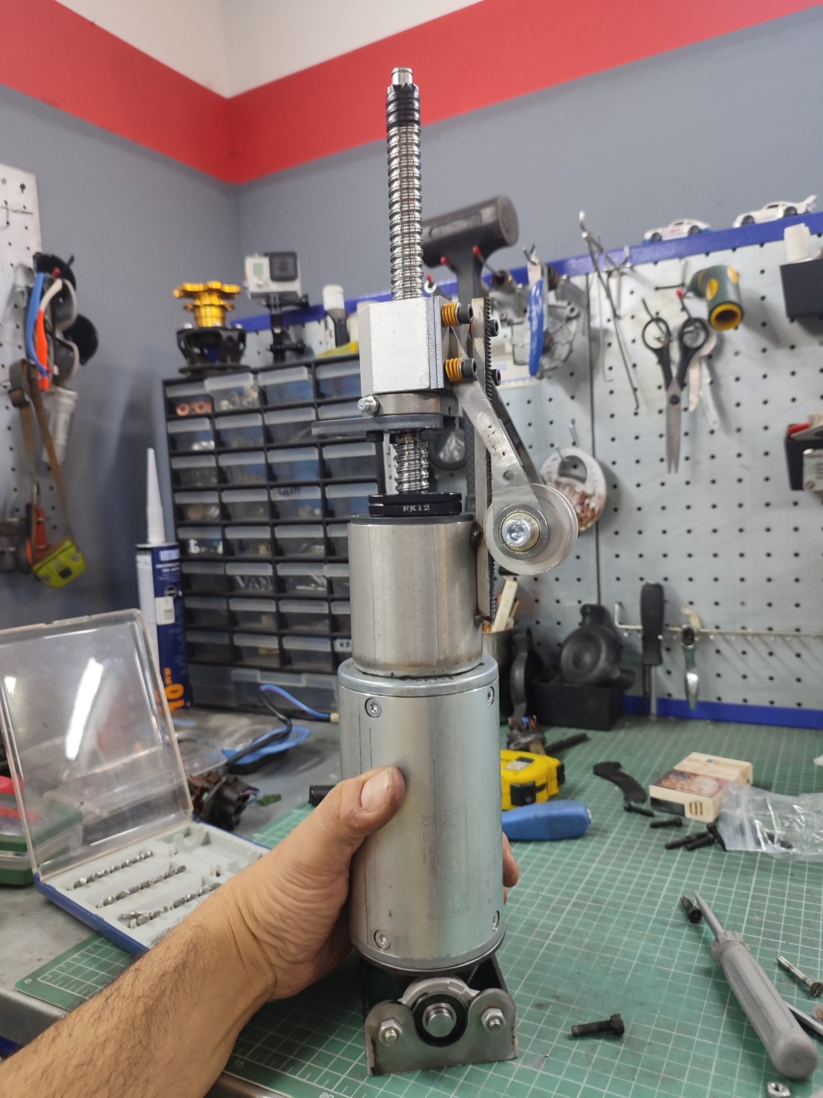

    Feedback potentiometer system must look weird, but it works

    But the actuators cannot work without seat platform - it will broke itself

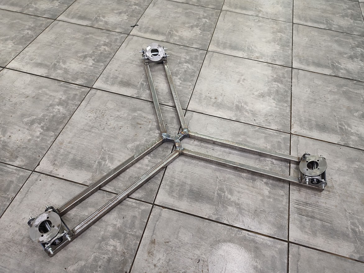

    Base is ready

    Can you tell me the width of your base please ?
    And what do you think about gas struts placing - like this:
    : IMG_20240225_024839.jpg
    Or like this:
  7. early_m
    early_m Active Member
    Jul 28, 2016
    318
    Chelmsford
    814Coins
    +345 / 4 / -0
    I would place the strut as per your first photo, within the frame. That way all travel will be equal.
    My 3dof frame is approx 1m wide

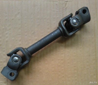

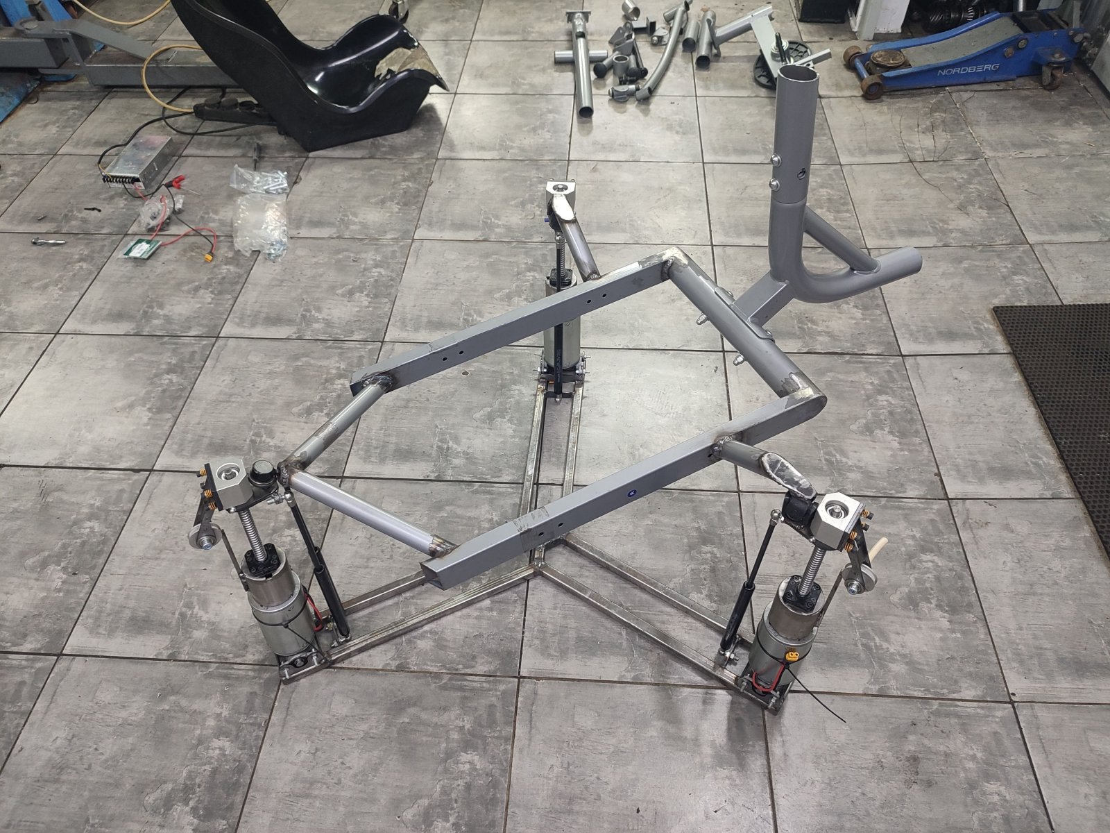

    Take old trainer to build seatbase of it :grin
    Had to bought U-joints instead of bull-eye - to avoid rotating of ballscrew nut - success, it's stop rotating

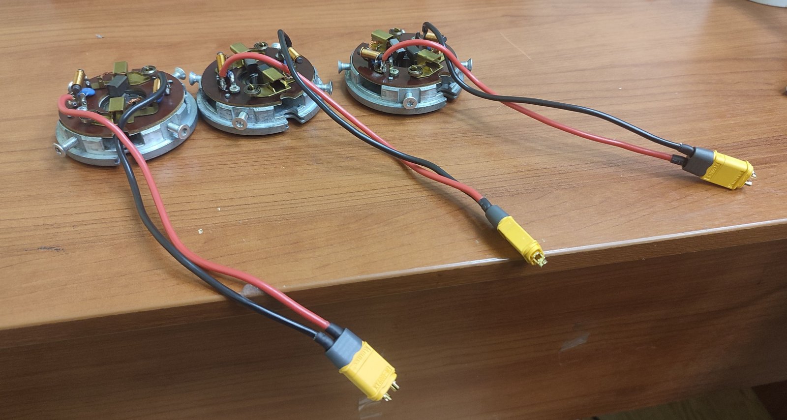

    Soldered new thick wires to motors

    Installed u-joints on every corner, add length to rear beam (ab. 8 cm) to move COG a little backwards
    I'm the worst welder in the world )))

    I take it the pot will be attached to the wheel that travels up and down?
    What is the torque and rpm of the motors?
  12. m50b20
    m50b20 Member
    Jan 4, 2024
    72
    62Coins
    +54 / 1 / -0
    Yes, you are right, it's already installed, but i removed them till i'm finish welding and cutting
    Not the best decision, but i like it for hall sensor pots
    0.6 nm, 2900 rpm

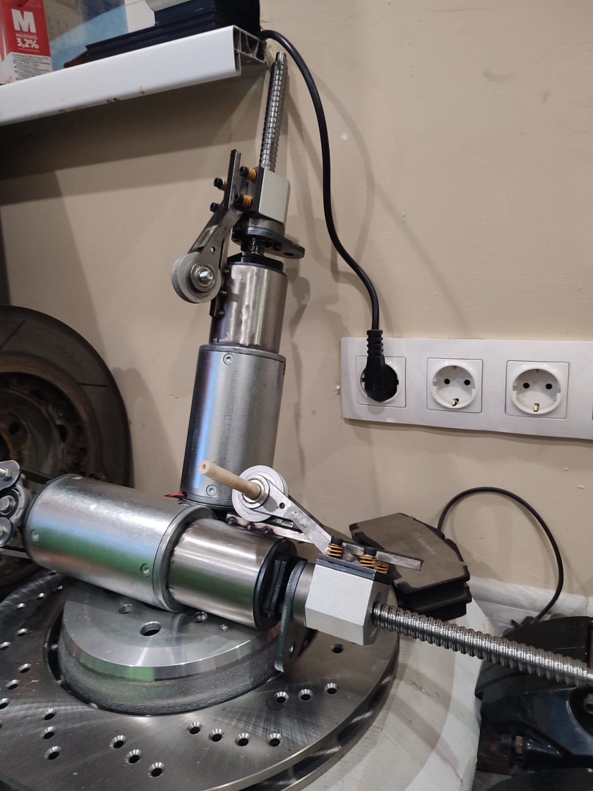

    Is there a gearbox on them?
    Do you know what output torque you achieve with the ball screws?
  14. m50b20
    m50b20 Member
    Jan 4, 2024
    72
    62Coins
    +54 / 1 / -0
    No any gearbox. There is a same amount of torque on the ballscrew shaft because its directly connected to the motor shaft. One motor installed on the corner lift me up with ease without gas strut and really quick. But real talk is what it will be with quick direction change. Let's wait for me to install electronics and start smc3

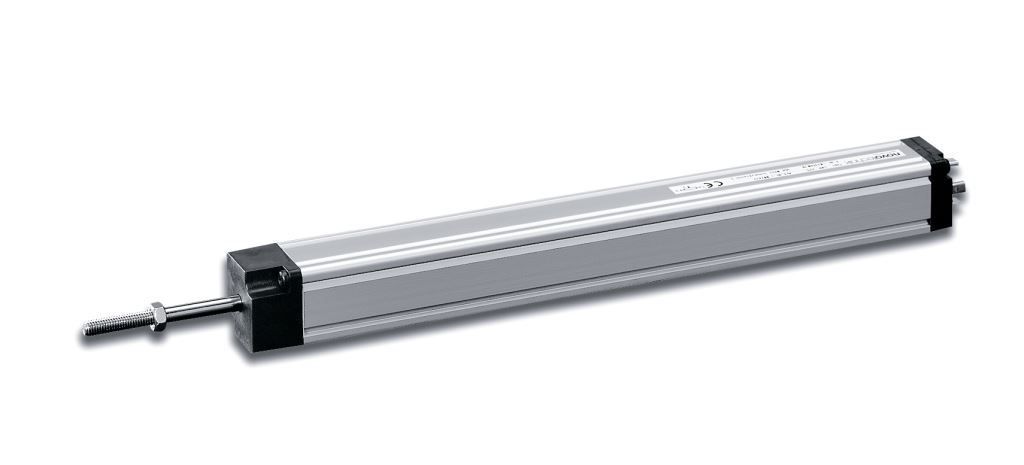

    I much more like the concept of linear potentiometer, maybe i will buy it for testing later, there are some on Ali

    Could be a g
    Could be a good idea, although a hall effect pot without any end stops would offer safety from breaking if over extending
