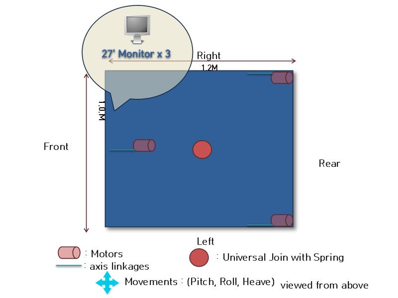

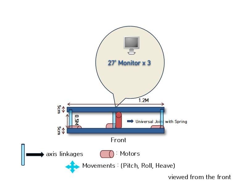

    Before you go too far ordering things @hunijjang it would be a good idea to work through a design. Even if it is just a sketch to start with post a picture of your design idea here and members can give you feedback on what is likely to work and what will not work.

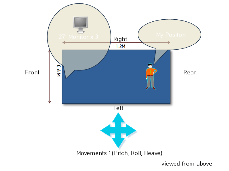

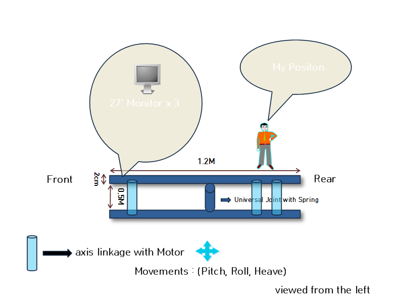

    Yes, that was too far ordering. :rolleyes:
    then, It is starting, I'm being a worried. ;)
    I did attached file with 2 pictures as you shown, I was drawing it such as powerpoint then saved png files. :D and I know that my pictures was terrible. :(
    Thank you advised me. :)

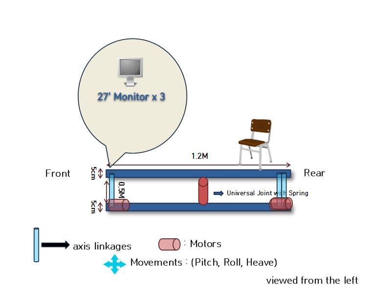

    Hello all :)
    Its arrived last week Saturday. (3 x Pololu Jrk 12v12 USB Motor Controller with Feedback and Etc)
    so, I try to make the necessary testing to 1/10 scale, Within a week.
    and I have updated the attachment file but also that is lousy. ;)

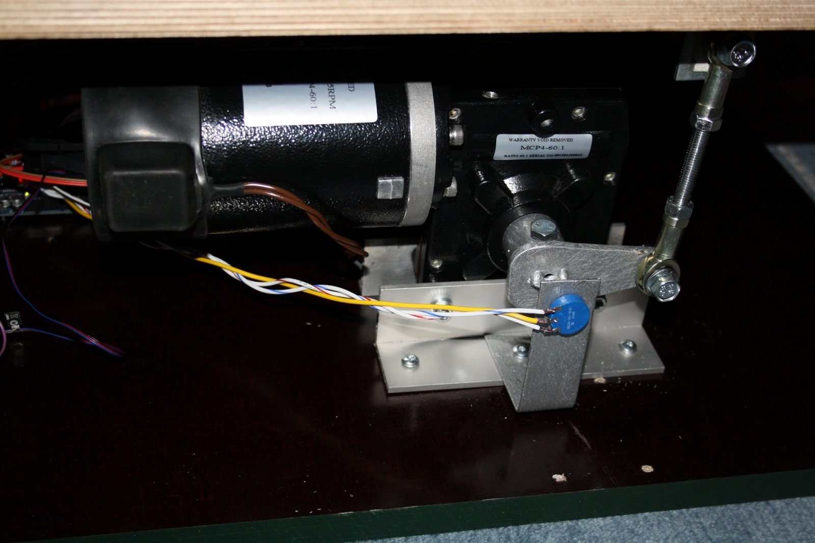

    It is maybe, producted of wood frame. http://www.xsimulator.net/community/threads/2dof-motion-base-for-playseat.5976/ and looks great.
    and Do you know where can I buy this http://www.xsimulator.net/community/attachments/img_4267-jpg.16748/ on the right side linkage.
    also the Moter mounts looks great!
    I planning to order this motor x 3 http://www.ebay.co.uk/itm/12V-DC-Ge...al_Components_Supplies_ET&hash=item58b2cd2323
    Right hand 2, Left Hand 1 and that is fine to the fit in the my frame design? ;)
    Thanks again.
