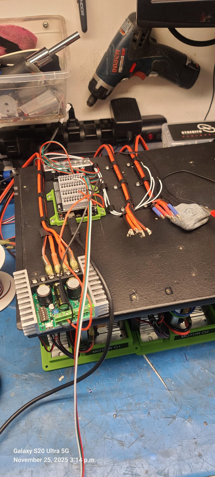

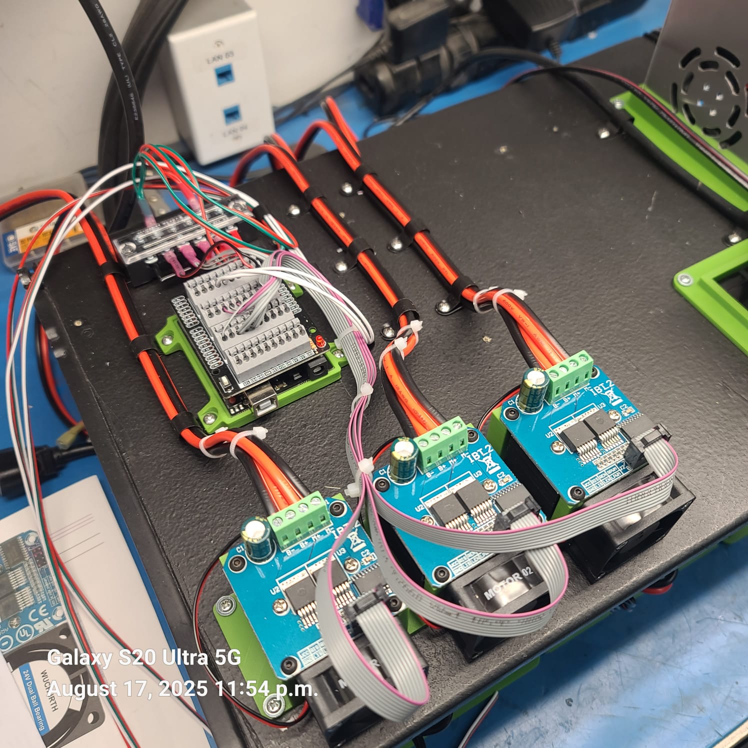

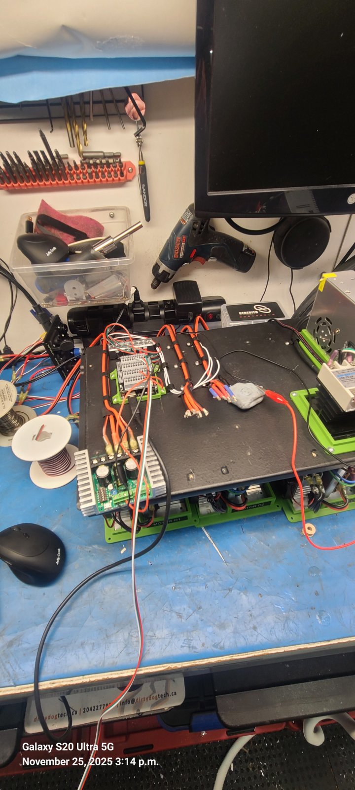

    Trying to calibrate my traction loss motor. This being the first of the 3 DOF. I've been fighting with this for over a week and can't seem to make any headway. Below I've listed all the specs of electronics I've used as well as all of the diagnostics I've attempted so far. I started with 3-IBT2 and then moved to a sabertooth 2x32 for the front motors. I've tested the traction loss motor with the sabertooth as well. I've also included photos and links to video of what is happening. Any suggestions would be greatly appreciated! Thank you!

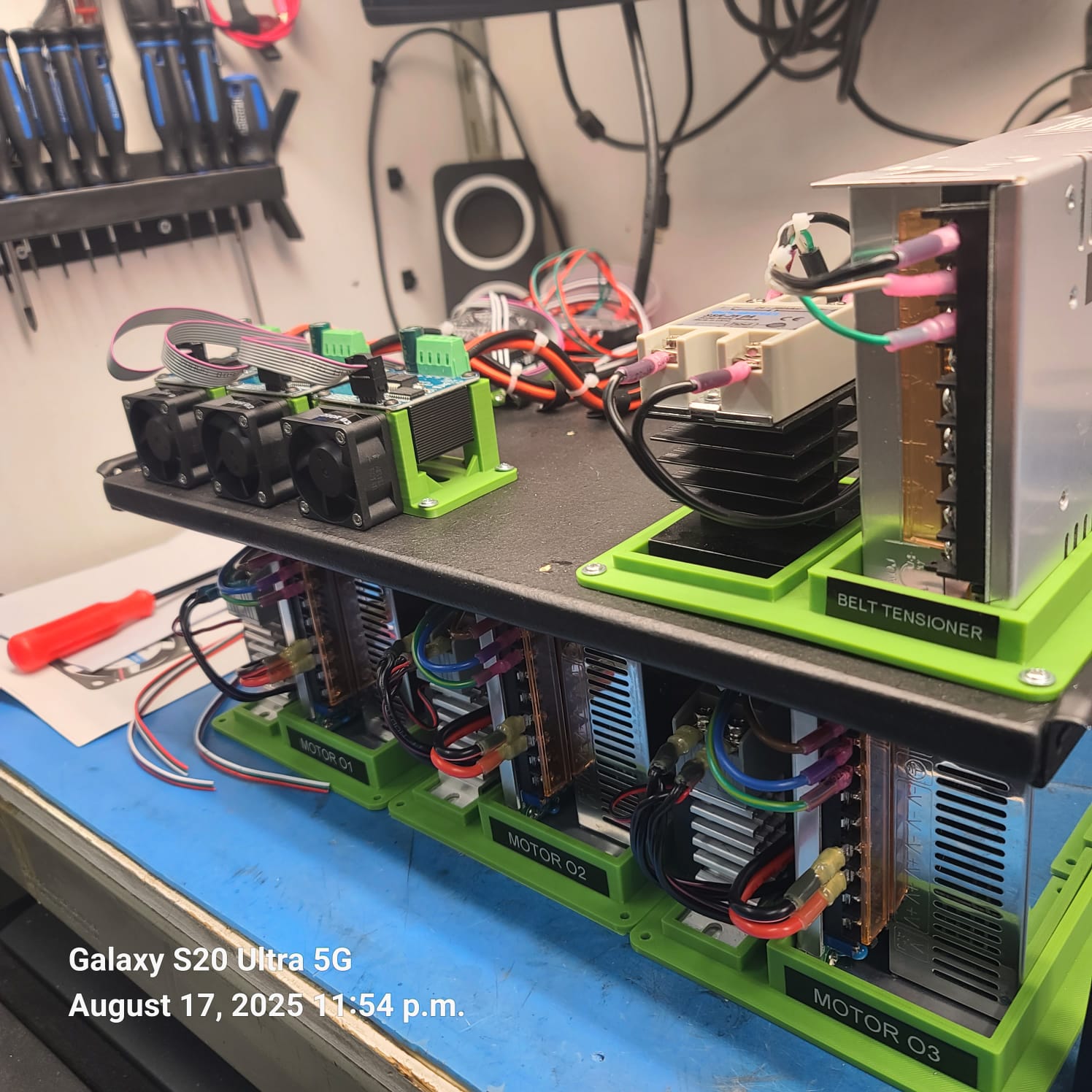

    3 - POWER SUPPLIES (one for each motor)
    - AC 170-250V to DC 24V 41.6A 1000W
    - Dialed in to exactly 22.5v
    - (12v 20A Computer Power Supply for low voltage testing)

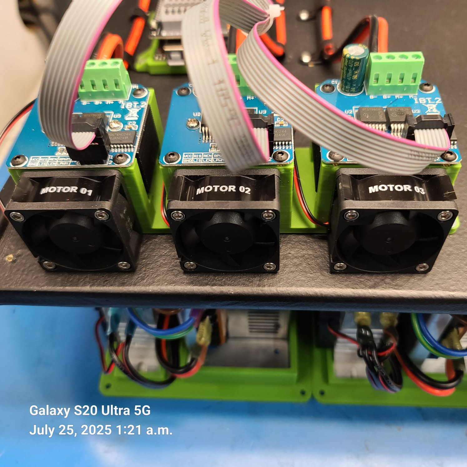

    3 - MOTOR DRIVER MODULES
    - IBT-2 BTS7960 43A H-bridge Double Motor Driver Module (Traction Loss Motor)
    - Sabertooth Dual 32A 6V-24V DC Motor Driver (2 Main Motors)

    Just a guess but try setting PWMmin=0, PWMmax=200 and PWMrev=120, rerun the Sine test and please post the result.

    You seem to have reduce Kp considerably. Can you please keep it at 400 for now, just to try and get a baseline with increased PWMmax and PWMrev.
    Similarly, it looks as though Max Limits and Clip Input have been dramatically reduced. Please just change one setting at a time and post the result, don't play with multiple settings at the same time.
    The aim is to get a ballpark initial setup, then refine from there.

    That may well be the case for your particular hardware, but initially it is all about trying to find some reasonable baseline, based on the provided SMC3 fundamentals: https://www.xsimulator.net/communit...3dof-motor-driver-and-windows-utilities.4957/
    So, the steps below are the foundation:
    Disconnect the motor power supply
    Make sure Simtools is not running – we’re not ready for that yet!
    Wire up the Arduino (with SMC3 installed) to your H-Bridges and connect to your computer via USB
    Run the Windows SMC3 Utility software and make sure it communicates with the Arduino (There is no need to set baud rates, they are not configurable)
    Set the Kp, Ki, Kd, PWMmin, PWMmax, PWMrev to 0 for ALL motors (This will make sure the motors don’t move)
    Set Clip to 255 (you need to do this first) and Limit to 255 (This will give you plenty of margin if something goes wrong while setting up)
    Turn on the power to your motors – nothing should move at this stage!
    Set Kp to about 400
    Now slowly, increase PWMmax… at some point the motor should start to move. When it does check the “Green” feedback line is moving toward the “Blue” target position.
    If it is then that motor and feedback is wired correctly - proceed to test other motors.
    If it is moving away turn off motor power immediately (or quickly reduce PWMmax again). In this case you need to either reverse the wires to the motor being tested –OR– reverse the +5V and GND wires to your feedback pot for the motor being tested (do not do both). Restart the test from the beginning.
    Do the above for each motor
