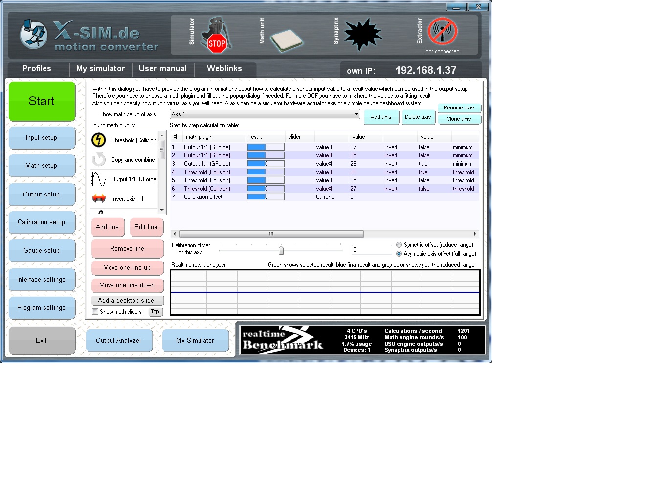

    I am planning to build a triangle model: three vertical actuators. This type of mechanics will move up/down and perform pitch/roll rotation. But the question is can I mix to these movements simulation of lat/long acceleration or some other type of forces?
  8. bsft
    Yes you can, on my sim, I run on each axis - motor, lateral, longitudinal, vertical and pitch, all on the one motor. I just invert forces when the need to be and set numbers. I also add collision effect to soften harshness on lat, long and vert.

    heres a screen shot of my math section for profiles on one motor. I use 3 forces and 3 collision effects to suit the force.
    Any further questions about this, you will need to refer to my signature

    Firstly, I no longer use the previous software as shown in the picture.
    I still only run 2 DOF and use the current beta testing simtools .
    So I only have 2 axis, but on each I run the new forces.
    Surge - car acceleration and braking (also gives a gear change up jolt)
    Sway - side to side lean of car going into and out of corners
    Heave - bumps
    Pitch - feeling of going up and down hills
    Havent used roll, cannot quite seem to get it right.
    There is no collision effect in this software as the guys got the max/min settings right so you set a number and go on the force/feeling you want.
