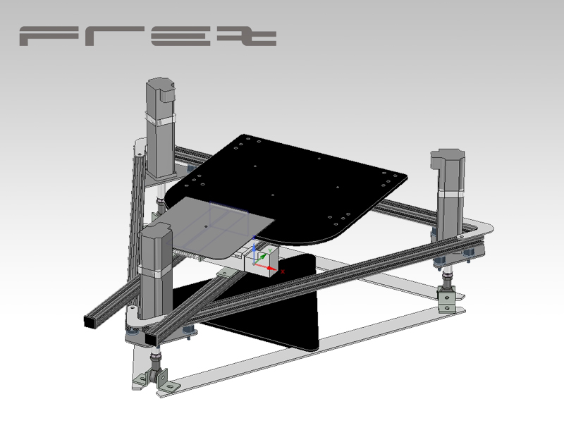

    Hi friends . I XX. from Turkey. I was doing research for a long time. My goal is to make 3DOF motion platforms. I have information about the software and circuit design. But news of the engine and the driver could not decide should you choose for motion platforms. I do not know about the engine and driver.
    CAN YOU HELP ME ?
    3fof motion platform features;
    -Load Capacity: 150/200 kg
    -3 motor
    - I do not want Actuator
    - Motion platform height 50 cm
    - I use the screw shaft. or reducer gearbox
    Yup .
    Weight capacity for 150/200 3DOF motion platform with a list of materials you can give me?
    I could not find too much source in turkey ..
    Thank you.

    Here is a recent discussion about lifting mass for heave, the requirements are significant: http://www.xsimulator.net/community...actuators-to-xxx-4-actuators.7359/#post-87064
    The other option is to have assisted heave, you can find different approaches to it under 3DOF here: http://www.xsimulator.net/community/faq/what-kind-of-simulator-for-me.16/
    This is my compact assisted heave: http://www.xsimulator.net/community/threads/dx-racer-compact-simulator.5866/
    You can check the FAQs for resources and suppliers, such as with motors: http://www.xsimulator.net/community/faq/dc-motors-shopping-list.32/

    Thanks for the answer. but still I could not decide on the motor. 150/200 kg carrying capacity;
    How should be emotor specifications ?
    Dc motor or Ac motor ? I want a small but potent motor .

    Hello again. I want to use an motor as powerful product in this link . What characteristics of this motor ?
    Link is http://www.fasetech.net/

  10. bsft
    @doktorherbal , you do realise the sim video above is a 2 DOF balanced point sim
    There was a discussion somewhere here about this ride
    Ah, here it is http://www.xsimulator.net/community/threads/racingcube.7325/
    3dof Lift will be expensive more than likely.
    3dof balanced point ( drift frame) is a lot cheaper to build. and you still get the feeling of heave.
    Just a suggestion.
    Dave.
