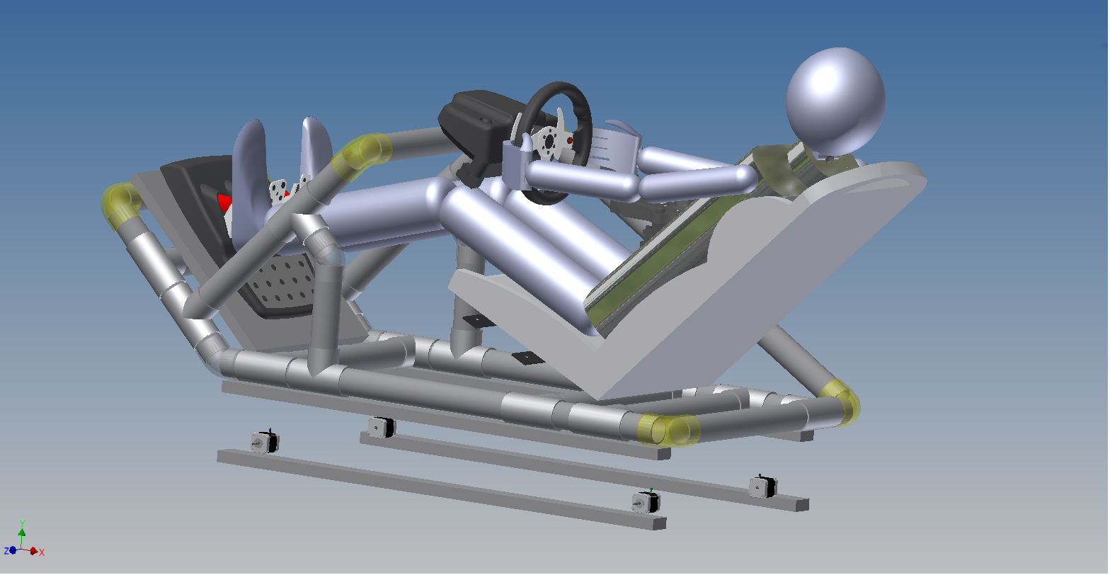

    I'm doing a 3dof sim using stepper motors. The thing is that i have no idea how to get the motors to work with the simtool software. If you'd all be so kind as to help me with this part i would be very grateful.
    This is a model of what i would like my sim to look like, there are some pieces missing obviously but that's roughly what it would look like.

    as far as I know, no one has yet got steppers working, but I could be wrong.
    Any reason why you want to use steppers? Apart from being small size?
    And nice design, looks like something I had in the past

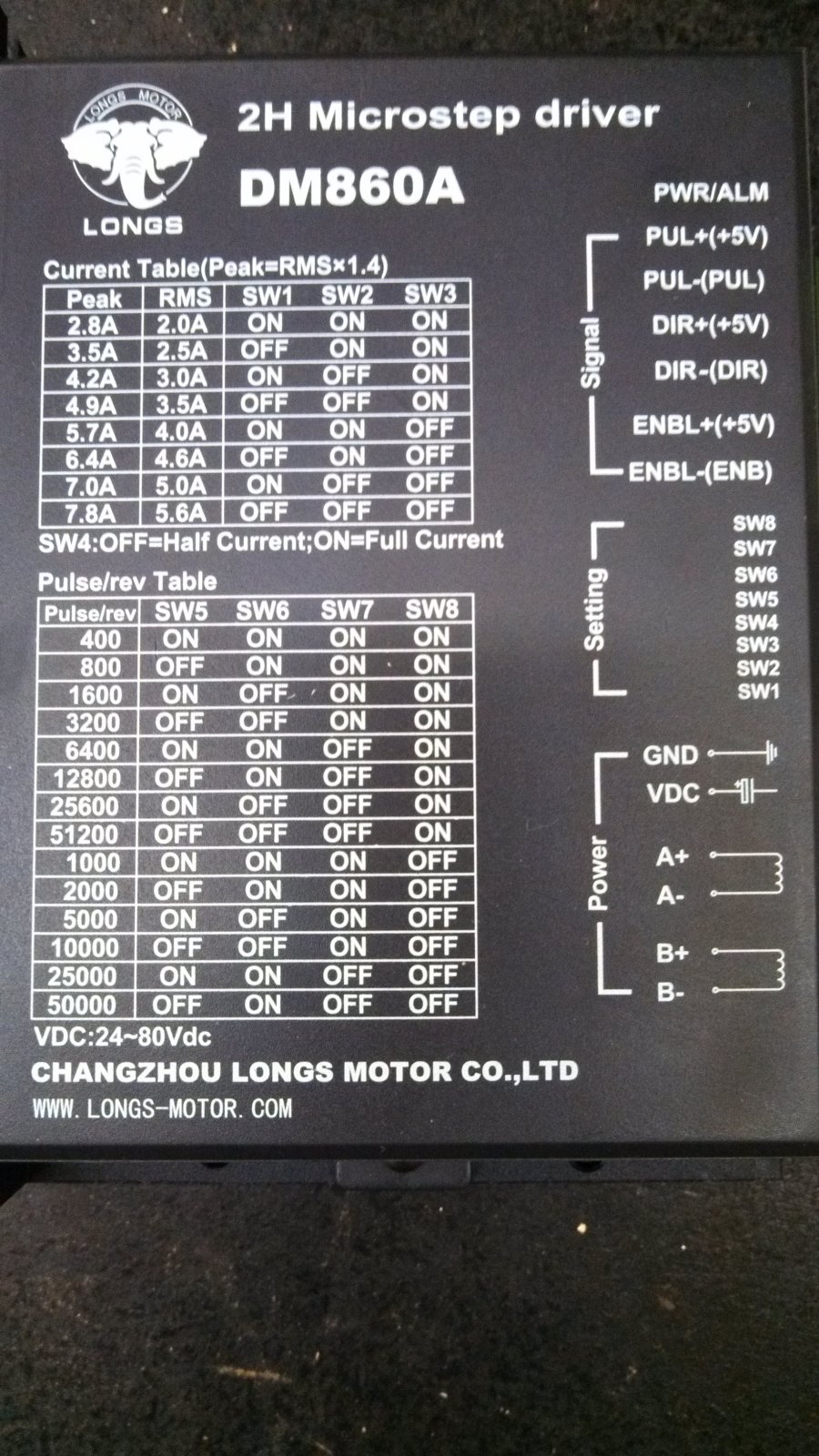

    ok I have nema 34 motors 3.5 amps, recommended voltage is 24-60v. I also have drivers for them that say they are 24-80V.

    Ok that clears a lot up, ok most driver like this can be driven by a micro controller, quiet easy to do with the Acelstepper library that can be found to make it even simpler to run with less commands to confuse you.
    Ok some details on the driver please, what we are looking for is pulse + - and a Dir + - , most can be driven by gnd both negatives and sending pulses to the pulse + to represent how many steps to take and applying a positive or negative feed to the Dir + to drive which direction it steps.
    So sorry a little more details on the driver and we should be able to put something together to begin testing with before you commit to a build.

    This is the driver that I have for the motor. Does this give the information you wanted?

    Ok @jackon680 this unit wires up and is used exactly the same as mine does. So test code I have should work for testing so we can sort it and finalize this for SimTools use.
    Ok for wiring.
    Pul+ - 5v Ard
    Pul- - Digital out pin on Ard, will advise once I check my code.
    Dir+ - 5v Ard
    Dir- - Digital out pin on Ard, again need to check my code.
    GND - -ve of Power Supply for stepper, plus also goes to the GND pin on the Ard
    VDC - +ve of Power Supply for stepper.
    I need to check my code but the Ard IDE does have something you can test with.
