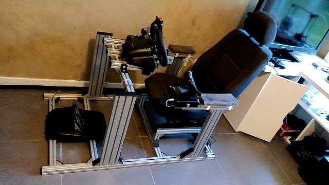

    Hi all,
    Finally, I will rejoin you in this crazy thing of homemade motion sim !
    After years of envy and doubts, I am now waiting for my simukit 400W kit to arrive at home.
    Meanwhile, I have designed the seat :
    It is designed to handle both wheel and HOTAS, as I am a huge Elite Dangerous fan.
    First question for the ones who own a simukit : What is the width of the base ?
    My rig is 80 cm width, will it be good to place it on the base ?
    Until next time !

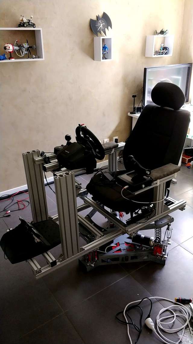

    Ok guys ! I am back in business :)
    Here is a video of my first try with the cockpit mounted :
    Since then, I have redone the third potentiometer(?) cable, and have fully eliminated the jitter.
    I then had a first try on trackmania with my little son (5yo) on a short track : even with the effects at 50%, it was impressive !
    I was not impressed by Project CARS (1), the surge effect (acceleration / deceleration right ?) is not enough present, even with an increase scale of effect.
    However, on Assetto Corsa (I hate their GUI, how conter intuitive it is...) effects were perfect !
    I will try tonight Wings of Prey and war thunder, then start working on Elite Dangerous.

    Hi Fluke !
    I needed to relearn how to solder ^^ I think I create a loose electrical connection by heating too much the first time. The wires are tinier than I think.
    Things I learn doing / redoing this :
    Heat the solder iron at 350°, and do not apply it for more than 4 seconds on the smallest wires.
    Have some length on the unwrapped wires to the pot : you do not want them to be tense.
    It is also important to have the gnd common to all the pots.

    Thank you for your help,
    stargazer
  12. axenic
    axenic Member Gold Contributor
    May 15, 2017
    46
    IT engineer
    Brest
    - 17Coins
    +24 / 1 / -0
    Hi stargazer !
    Sorry to respond so late...
    1)The PSU come with a switch 110/220, however, you will have to source the power cable with US ("outlet"?) connexion.
    2) The kit come with everything you need, minus the cockpit and the way to connect it to the kit.
    I personally had to drill 4 holes were it was the more convenient.
    3) Simtool license does not come with the kit. You will have to source it by yourself, here : https://simtools.us/license/
    I took the professionnal one because of the remote profiling. As I play mostly in VR? GameDash does not concern me.
    4) The platform is really very compact, it is an equilateral triangle of about 80 cm (31.5 in) side. Mind the fact your cockpit will most likely be larger. (For reference, I find mine compact, and it is 70cm x 120cm. (27.6x47.2in)
    after second reading, you seems to be interested in the height. As in the picture, the highest point (the seat) is at 150cm (59.1in).
    5) the kit took a long time to arrive, because of a shortage on some references. Moreover, even if the guys are sympathetic are prompt to answser, there were some pieces missing in my package.
    Bear in mind I also had some pieces broken during the assembly, because of a bad design. They told me this was fixed by now, but I had to engineer (and print) my own gears to correct it.
    To be honest, I am not that thilled about the price I paid, and I think I found some US 3DOF makers when I was searching online. The full kit is about 2000€, and you will have to pay some more taxes on it plus the extra for the shipping. (The packages were very heavy).
    Do not hesitate if you have more questions, I will gladly answer them !

  14. axenic
    May 15, 2017
    46
    IT engineer
    Brest
    - 17Coins
    +24 / 1 / -0
    Hey ! I like your approach. I have the same. The 6DOF is in sight, but I though I should up my level with a 3D0F one.
    My cockpit is hand made, with aluminium profile. I sourced them on a european website : motedis.
    I think in the US you have something similar called 80/20 (BTW, I am interested in an explanation of this name.)
    I first based my ideas on this one : https://www.motedis.fr/shop/Friends...n-09/2017/KPCR-Piez-RIG-Expert::99999866.html
    with mods to support my HOTAS and a shifter and a TV.
    After assembling it, I wasn't found of the result : too heavy, too broad. So I restarted from scratch and build my own design, wich you can see on my post.
    It cost me a total of 615€, but I have nearly twice too much pieces. Most of them have been recycled on "b-sides" projects, most important one is a support for my second keyboard and laptop. (The one which drive the motion rig).
