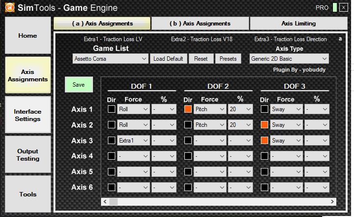

    I have problem to setup good settings to play in Assetto Corsa on 3dofrality H3 version.
    I spent many houres but still can`t setup anything.
    I setup all settings on 0% and try setup Pitch
    When i setup it on 1, 3 ,5 or 10% i feel when car braking and sometimes accelerate, but accerate is a liitle bit. I feel change gear from time to time. If i setup more than 12% of power when i braking seat is moving to rear, but only right motor.
    When im going straight 50km/h and don`t accelerate and braking seat is moving also.
    Is worse situation when i put everythink on 0% but roll on 1,3,5 10,15%
    car is moving left=right left right also when im going straight slowly as in terrain car on very bad road.
    When i`m in curve seat is moving on good way but also moving on every sides and is not comparable to be in curve.
    I will try setup again it today, but don`t have idea how to do it well. I have also many different settings to setup.
    Possible somebody have this simmulator and resolve this problem. I will be gratefull for send to me good settings on V3 or P3, P2, H2. Or help to setup all, screen, tip - whatever.

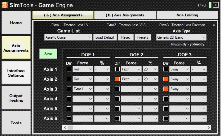

    i see problem when i setup pitch
    Only one motor have reaction on gas
    I tried all combinations
    pitch 20%
    testing in game: gas - brake
    DIR:
    black-black seat moving left-rgiht
    red-red - seat moving left right
    red-black-only left motor has reaction
    black-red - only right motor has reaction
    In my opinon two from motors should mobe not only one.
    21,030
    147,878Coins
    +10,880 / 54 / -2
    Checking or unchecing the Dir orange will determine which way each axis moves and this is the movement SimTools expects: https://www.xsimulator.net/community/faq/which-way-to-set-simtool-axis-movements.230/
    So you either have the Dir box allocation wrong or a motor is reversed, because the likes of sway should have one Dir box checked and the other not, roll would be the opposite, and sway leans away from a corner.
    Stick with Extra 1 for traction loss in games that support it.
    These are the steps to create and refine a motion profile: https://www.xsimulator.net/community/faq/steps-to-create-a-motion-profile.228/

    [UPD] Main problem was in Region Settings for Windows 10.
