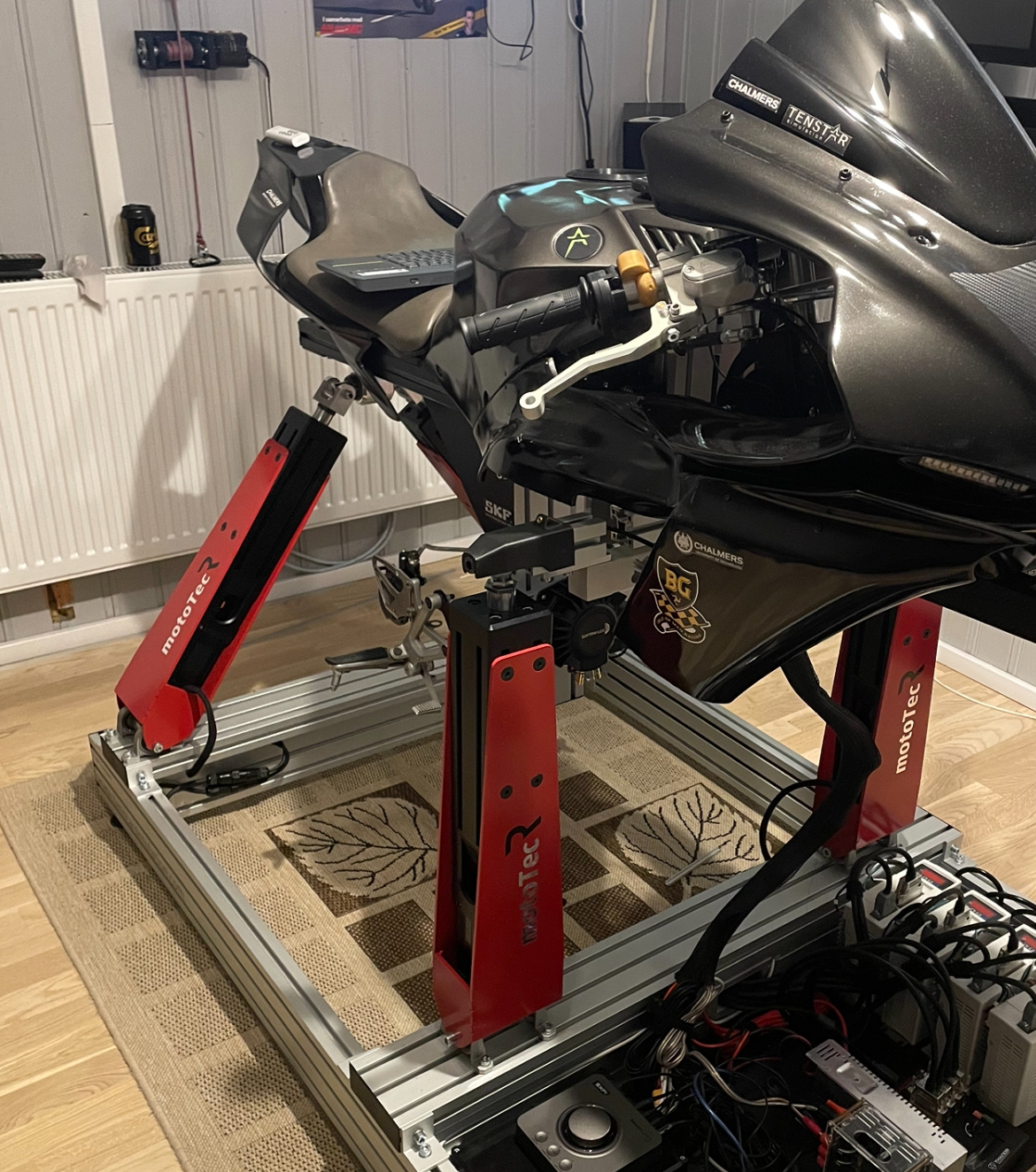

    I built my bike rig like that.
    Works good with Simtools. Didn’t try any other se yet, but I know Simhub does not support it.

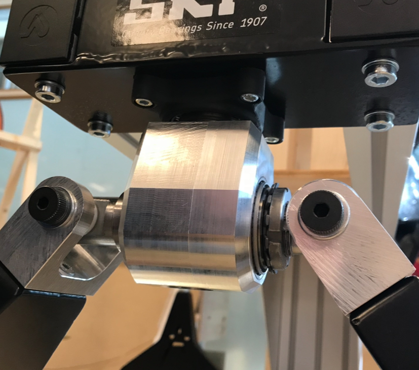

    Also may I have a look at the rear joint please ,I was thinking of using a ball joint setup.

    +244 / 4 / -0
    Thanks!
    Yeah, the rear joint was a pain.. It’s a custom thing with something like 20 parts.. If I was smart I would have gone the ball joint way! Haha
    I have the AMC, yes

    Hi Chris,2 things,I was under the impression that the 2 front actuators should be on a cardan u joint or similar and the rear fixed on one axis like the d mover and quibik v20.

    +244 / 4 / -0
    Yeah, that’s the tricky part of the setup. The front needs to be free to move in all axes except the y axis (side to side) but still be flexible enough to accept the change of distance between the front actuators caused by the roll motion. The rear needs to be free to move in all axes but the x-axis (front to back). The extra fourth dof comes at a cost ;)
    My axis setup is a motorcycle mess, not really applicable to cars. But the general idea is to use the fronts for roll/sway, rear for traction loss, all four for heave and pitch/surge.
  12. Chris_Beeves
    May 31, 2019
    349
    2,016Coins
    +244 / 4 / -0
    If you have the chance I would advise you to build a scale model with RC servos. That really helped me understand the setup.
