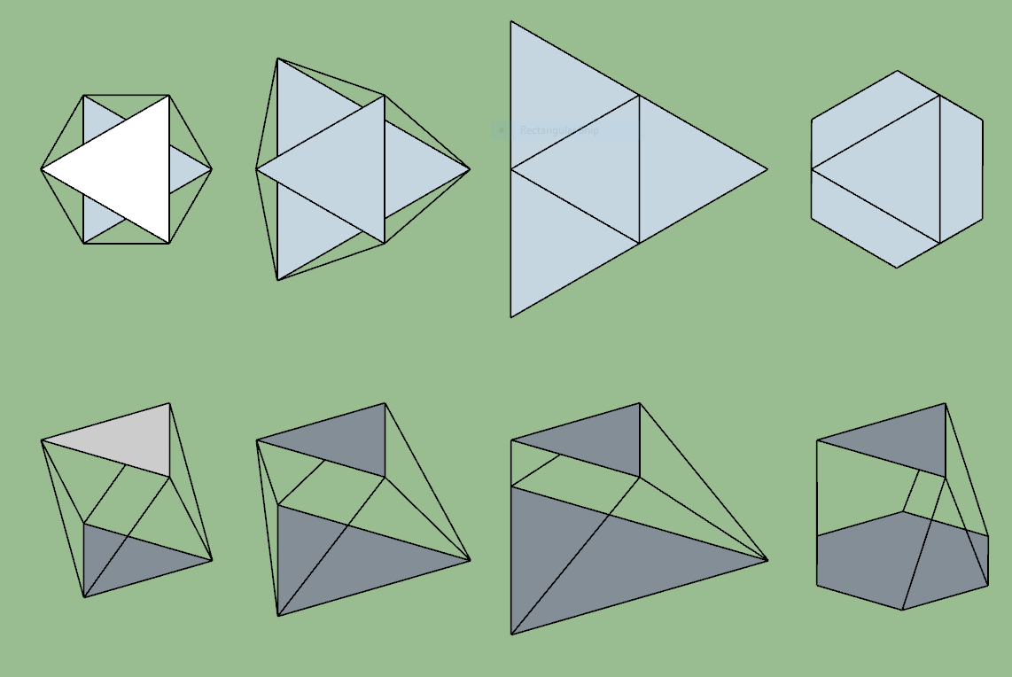

    Well I'm going all in. Going to build a 6 DOF Sim f1 seat. Still at the design stage and realized there are different geometry used. I'd like to know if what the advantages and disadvantages there are in: Programming, function, stresses, movement....
    Pictured are the options I've seen, there may be others.
    Feedback or info on the subject greatly appreciated!

    Hey @PaulB,
    you can find here some things I wrote in regard of the design:
    https://www.xsimulator.net/community/threads/basics-6-dof-stewart-platform.9396/#post-119948
    I wouldn't build design number 1 because of the stability. The momentum of the upper platform could tilt the whole rig.
    Also number 3 is a little bit difficult because of the angle between the actuator and the floor. The lower it is, the stronger motors you'll need…
    With design 4 you have less yaw, sway and surge than with number 2, but you'll have more heave;) It's up to you to decide what YOU want:)
    I hope that helps a little bit.
