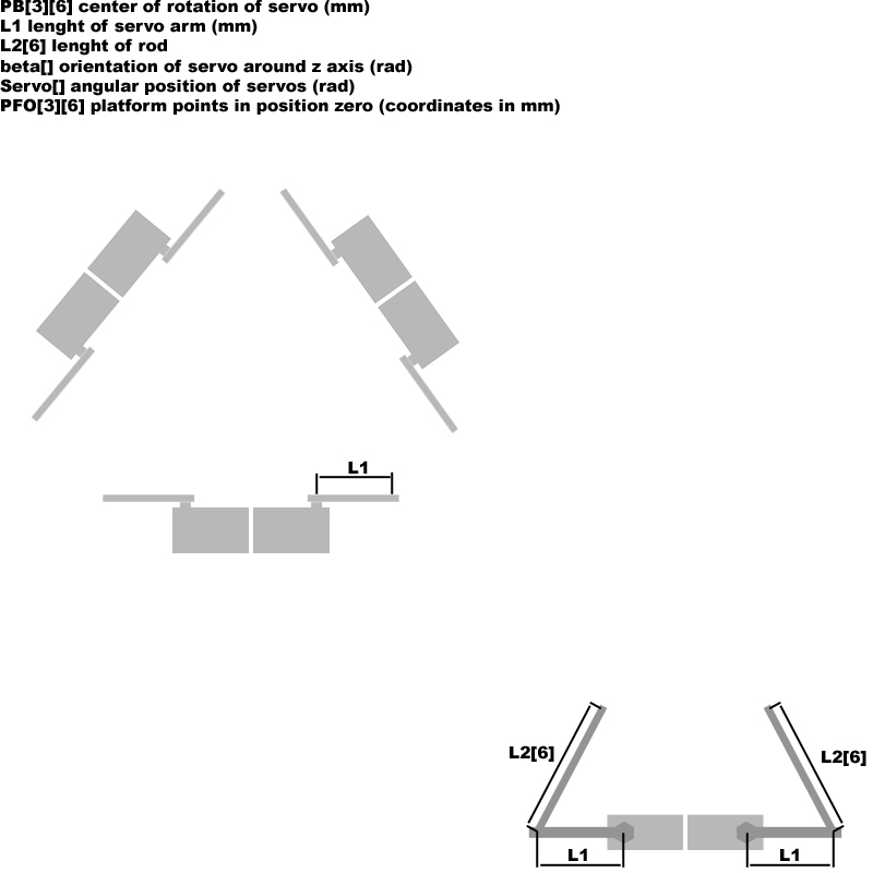

    Hi all, here is the post where I'll give some explanations on the 6 dof master source code. See here about this software:
    http://www.x-simulator.de/forum/new-6dof-stewart-platform-for-a-school-project-t1622-10.html
    You can edit the file 6dofDlg.cpp to change:
    Go to void C6dofDlg::InitConst() to change platform's design:
    PB[3][6] is the center of rotation of the servo (coordinates in millimeter)
    L1 is the lenght of the servo arm (millimeter)
    L2[6] are the length of the rods. (millimeter)
    beta[] is the orientation of the servo around z axis (radians)
    Servo[] are the angular position of the servos (radians)
    PFO[3][6] are the platform points at position zero. (coordinates in millimeter)

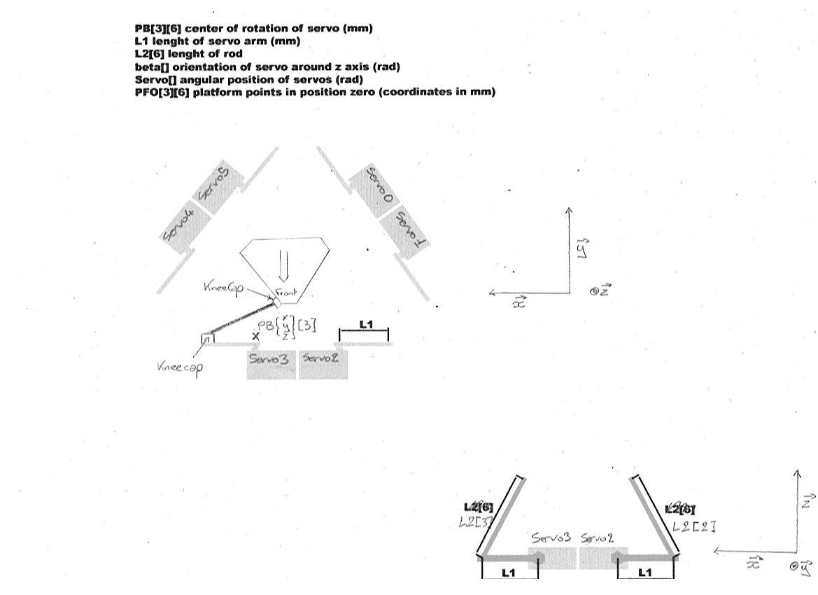

    Could you complete / correct the image of the platform design image? And are you thinking about a possibility to a program feature to change the platform settings / com settings into 6DoF Master Software without getting a compiler, so its possible to change the design for everyone use's your software...
    Greetings mbo
  20. Robin
    Robin New Member
    May 8, 2009
    44
    51Coins
    Very correct graphic. I've drafted a little more information on it, if it can help. I'm working on the software to enable to edit its own platform and base points, but it's useless if you can not save your settings, so I got to enable that too.
