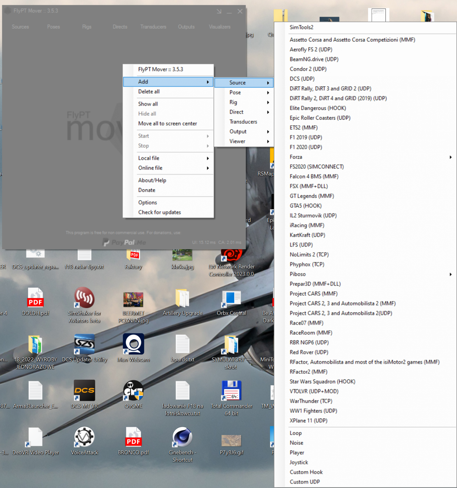

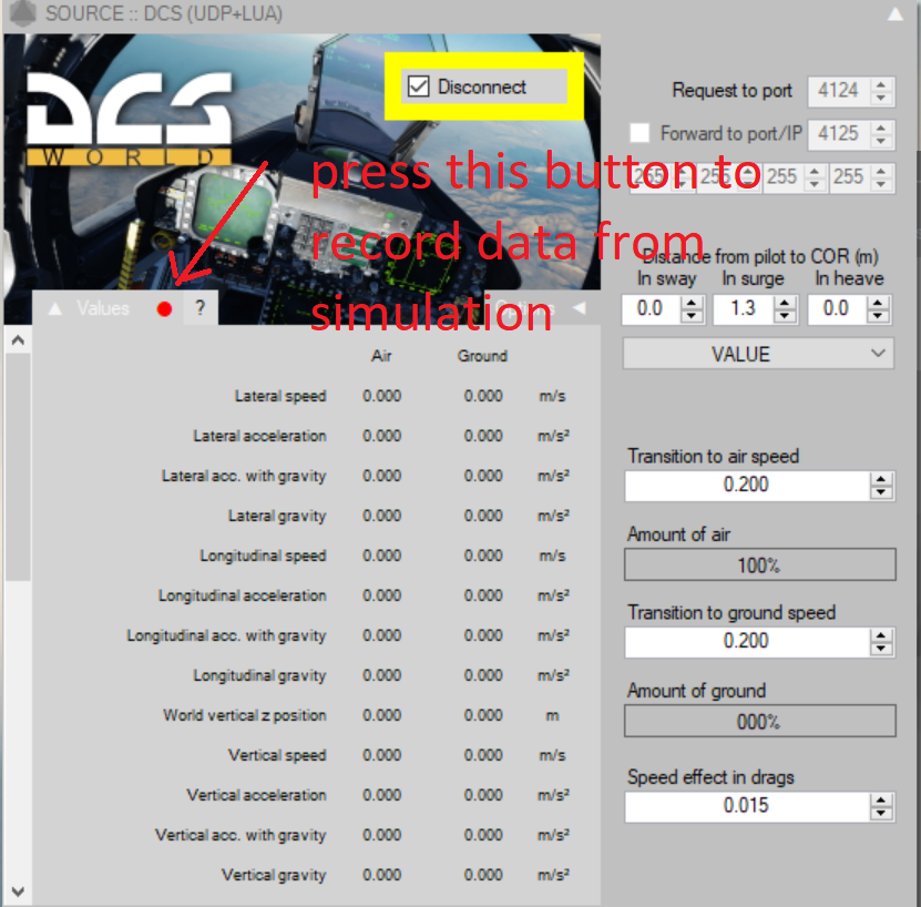

    I wonder whether there's a way to record from a static version of a run with, say Assetto Corsa (A software I'm familiar with), all the cues given to a hypothetical 6 dof platform. Meaning: to record in a file all the platform poses in function of time given by a short (or long) run. That will help me, through a binning algorithm to better calculate design parameters of my platform.
