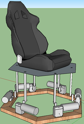

    All 6dof simulators connect their motor with the platform using a V shape connection, why not connect the arms as illustrated below ? and what a the benefits of using the V shape connection?

    The design above depending on couplings used (not obvious in the diagram) it would either fall over, or not work properly. A Stewart platform is all based on triangles, which make it very strong and stable.
