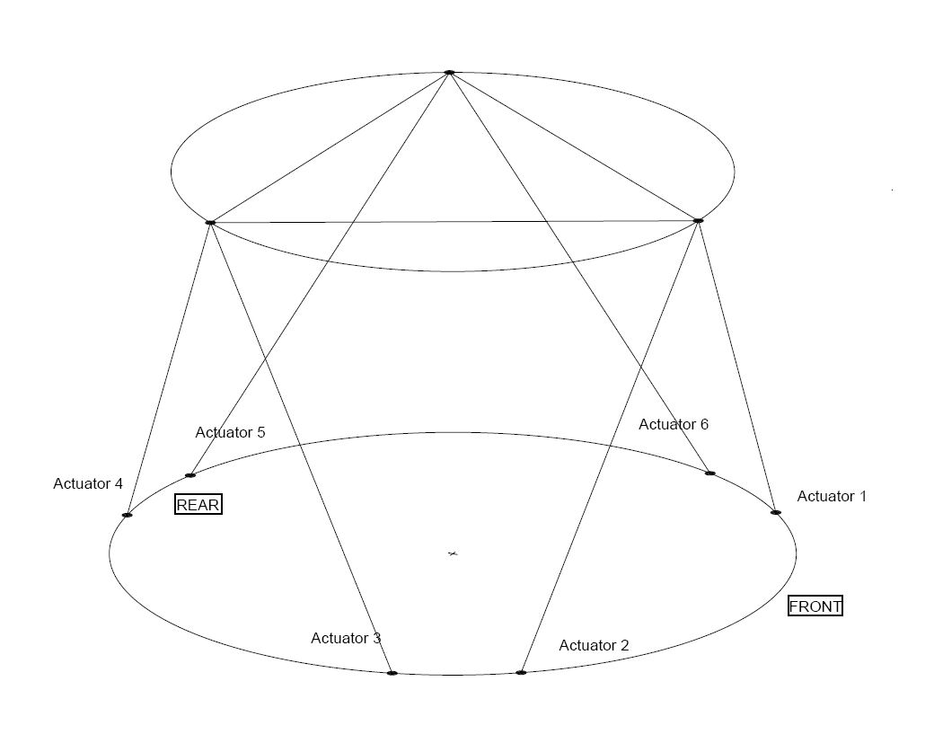

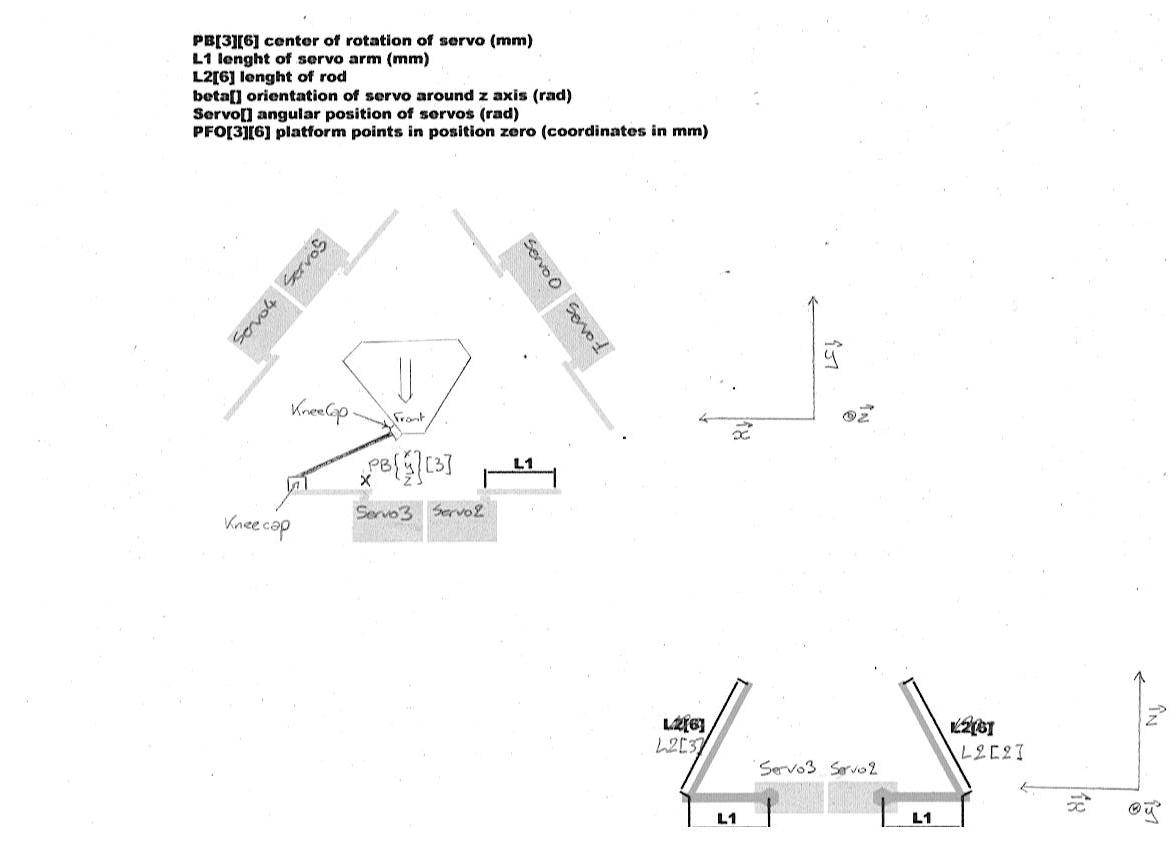

  10. tronicgr
    tronicgr
    The problem is that each software (Robin's VS Ian's) use different base numbering on the base. See each one and you will notice the difference:
    You could try shifting around the servo numbering as I think that's whats making the strange assignments happening
