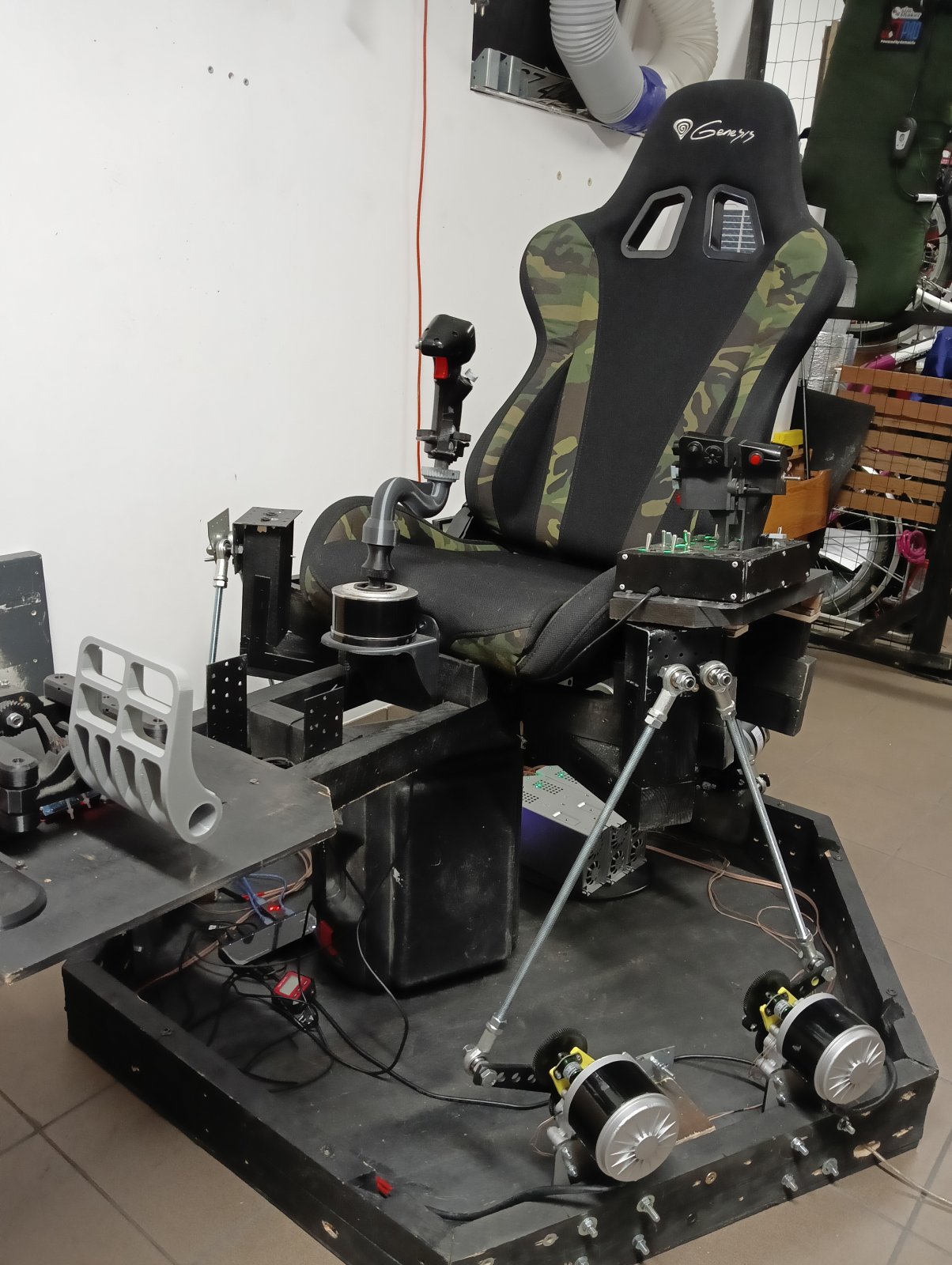

    Let me disagree :) , you can build a 6DOF for $800 just be aware of the limitations of such a kit ( less range of motion, less accuracy, more slack) but it's still a 6DOF you can have great fun on :) the most important thing is to have a good emergency stop :)

    Could you elaborate more on this? I've built a 6DOF based on 24V 250W motors and so far I've felt pretty safe knowing I have an emergency stop.
    But I make no secret of the fact that I am a beginner in building motion platforms.

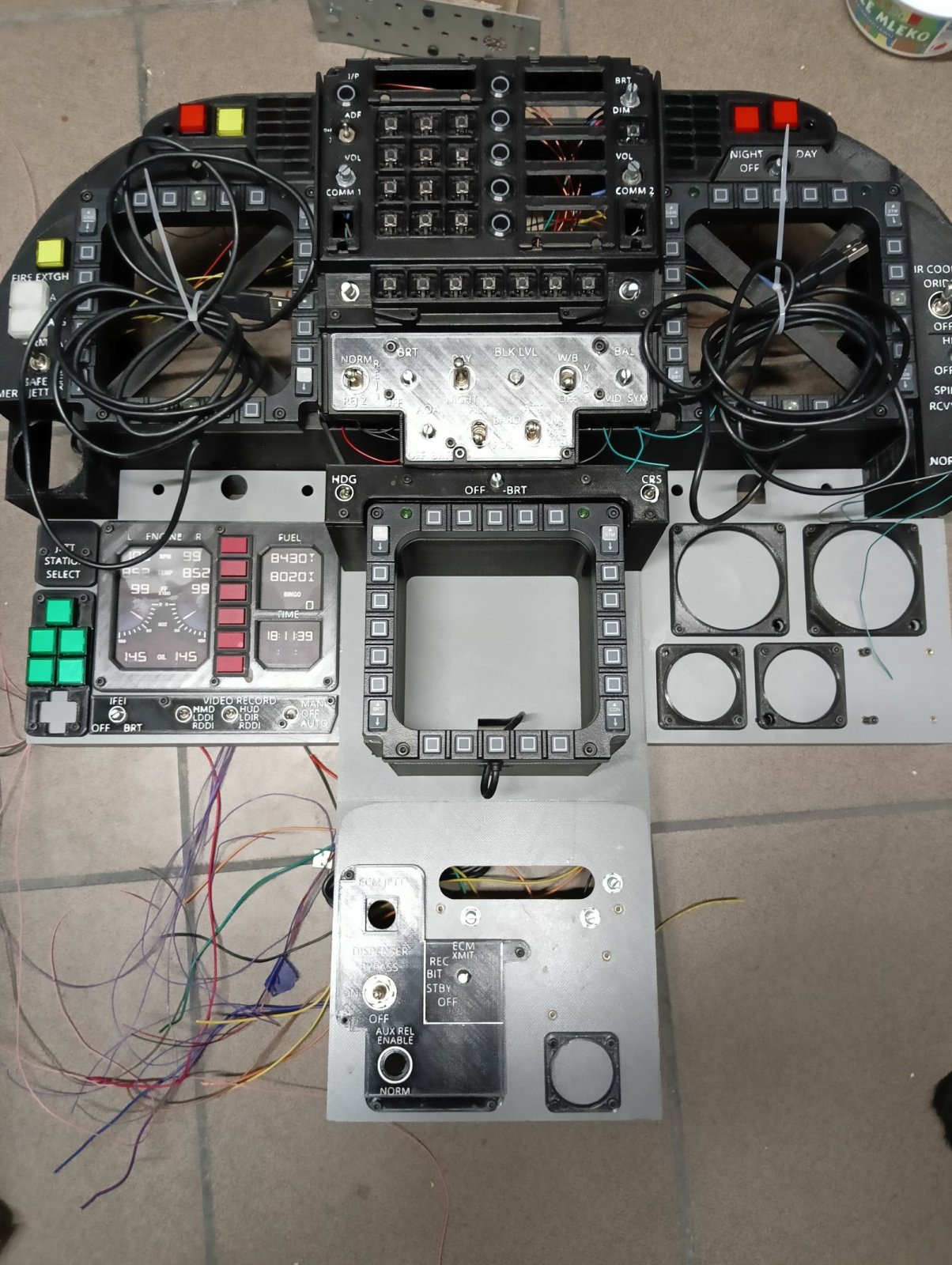

    I'm not offended :), your cockpit is really impressive with the fact that I'm limited by the power of the engines so it has to be as light as possible, well and it will be used only for flying in VR so it lacks all the simracing equipment which as I noticed weighs really a lot.
    There will be one more element, that is the front cockpit of the F/A-18, without MFD screens which I can't see in VR anyway.

    Many people have succeeded with the 24v250w electric wheelchair motor, 8cm arm.

    i have built a couple of sims now
    use a commonly available dc motor like from a wheelchair - but use 2 at a time !
    i use 12 motors on one of my 6dof - it is very powerful
    each actuator is 800w - it never gets warm
