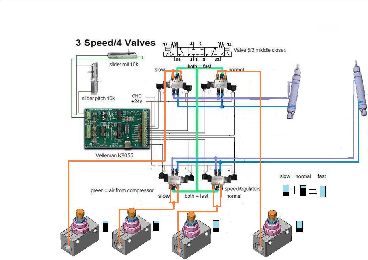

    I have recently purchased 2 Rock'n'ride motion simulators, 1 vm110 Vellman usb board, 1 vm129 relay board. I plan on upgrading the board in the rock'n'ride to use with x-sim. I would like the rock'n'ride to function at 3 speeds.
    These are my questions?
    Can I use the valves that come with the rock'n'ride to achieve the 3 speeds? (IE combine the valves from both R'n'Rs into one system).
    If not what kind of valves do I need and can you provide me with an example of 1 or 2 so that I know what to look for. (I was planning on using a 24vdc setup).
    Is there anything that it appears that I am not understanding?

    Yepp, you need a 4 pair of valves.

    Ok - So should I or should I not by 5/3 valves? Does anyone have a rock'n'ride already setup using the vm110 & vm129 as well as 8 24vdc valves? If so can you given specific info as to the valves you used?
    The two prior posts only make me more confused. I don't understand the black and white diagram. The color diagram makes sense to me, but I am told that it is incorrect.
    I have the vm110 & vm129 boards, the r'n'r', have not purchased valves as of yet. How should I best proceed?

  7. mgmillward
    mgmillward New Member
    May 2, 2009
    10
    0Coins
    Re: 8 Valves for Rock'n'Ride to perform at 3 speeds?
    I found this wiring diagram.
    [img600px]http://www.x-simulator.de/main/images/stories/x_sim_content/3speed_4valves.jpg[/img600px]
    It appears that there is no common ground for the valves but rather that the valves input come from the 12v power supply and the output to the VM110. Is this correct?
    Michael

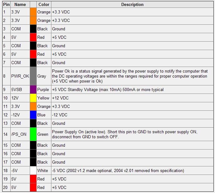

    I found this pinout diagram for an atx power supply connector. (Attached)
    According to the pinout I use yellow (10) as my 12vdc positive and blue (12) as my negative. I must short out green (14) with a common ground (15) to turn the power supply on.
    I connect yellow (10) and blue (12) to my vm110. I connect 1 wire from each valve also to the yellow (10) and connect one wire from each valve to the vm110.
    Then I connect the sliders and I should be all setup.
    Does it make a difference which valve wire I connect the vm110 and which wire I connect to my yellow (10) 12v+?
    Michael
