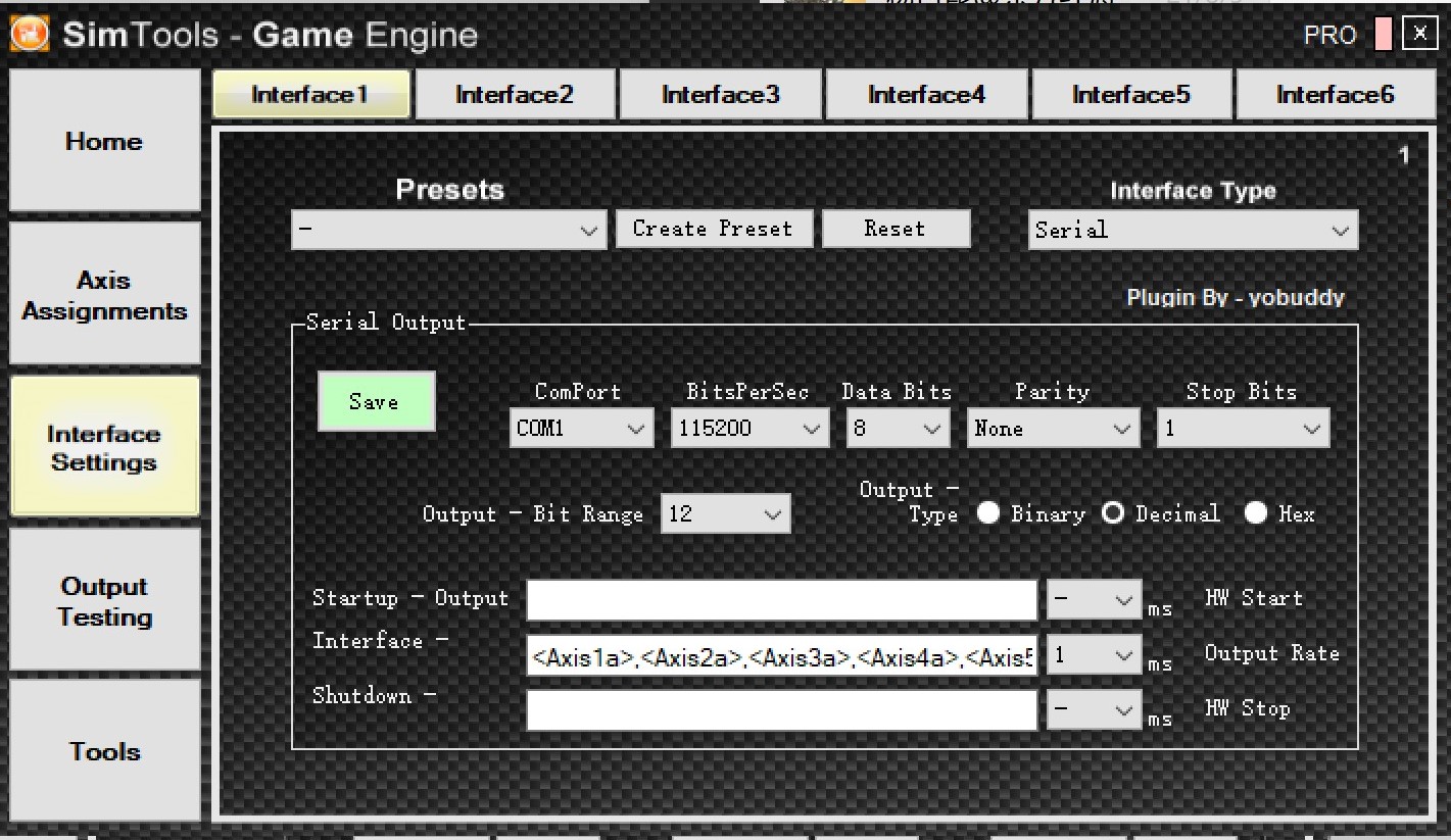

    I use this https://github.com/knaufinator/6DOF-Rotary-Stewart-Motion-Simulatormethod.
    When I compete almost work, I found my Esp32 cannot simulate the servo.
    I use https://github.com/fbrussa/VirtualSim to test, it work very well.

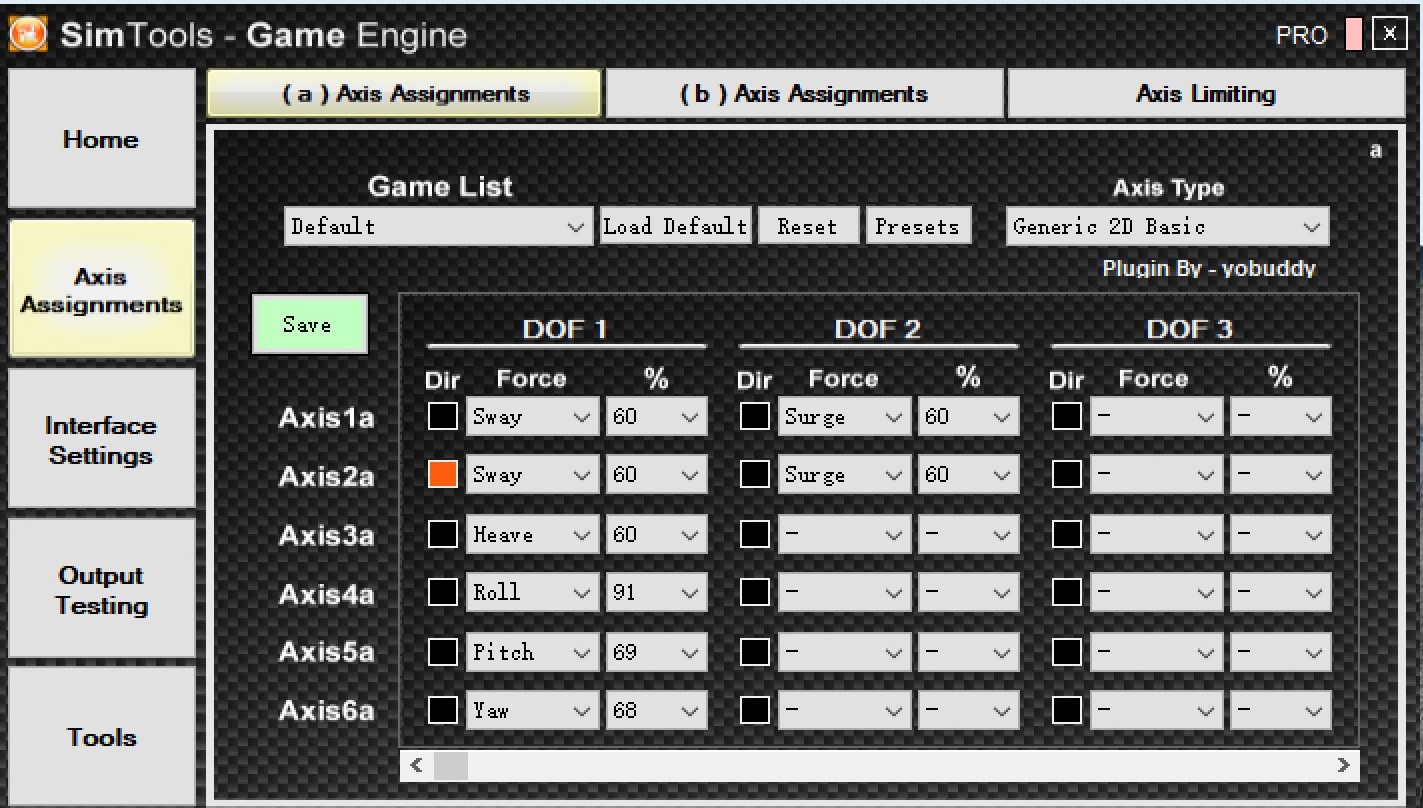

    Sorry for not providing enough information. I am still not familiar with how to use this forum. Let me first send my settings page to you. SharedScreenshot01.jpg

    Just to clarify, the VirtualSim works as expected, with its recommended settings?
    But the @knaufinator code and configuration does not, is that correct?
    Does Output Testing work at all with the @knaufinator code and settings?

    VirtualSim works as expected,.
    VirtualSim needs to use network mode, while @knaufinator needs to use serial port mode. Their output methods are different, one is [A<Axis1a>][B<Axis2a>][C<Axis3a>], the other is <Axis1a>,<Axis2a>,<Axis3a>,<Axis4a>,< Axis5a>,<Axis6a>X

    Yes I understand they are different, does Output Testing work with @knaufinator's code and settings?

    @knaufinator's code and settings does not work. the servo stop all the time
