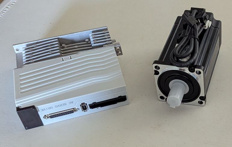

    Recently picked up this servo and driver off Amazon because it was suspiciously cheap at $106 for the set.
    Sounds too good to be true but oddly enough it arrived and works.

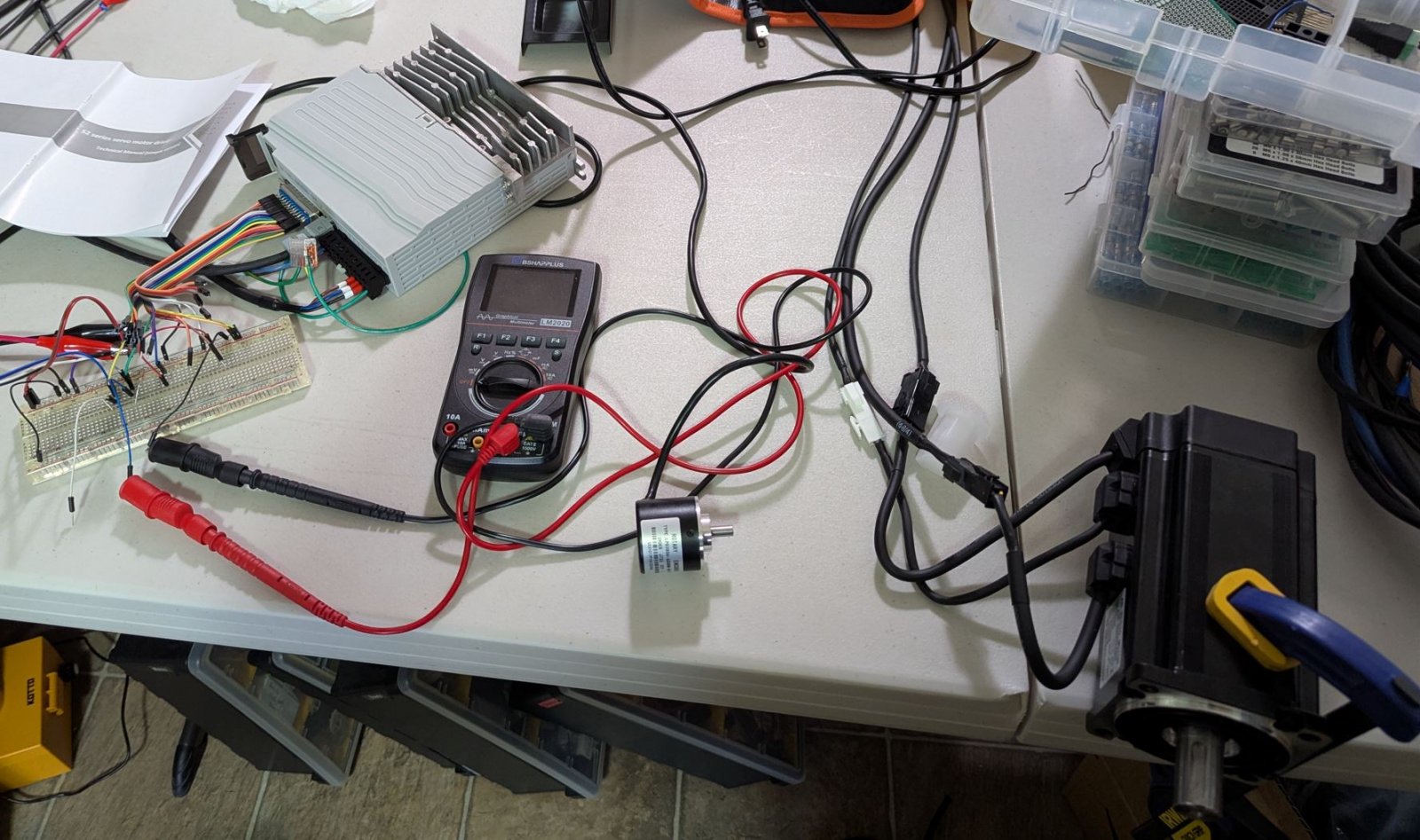

    • Running at 110V unloaded it's able to get up to about 3.5-3.6kRPM.
    • Running at 110V I was able to confirm, with my limited instruments, that it could produce ~6Nm peak torque. It may, with better testing and its full voltage, be able to reach its advertised peak torque of 7.2Nm.

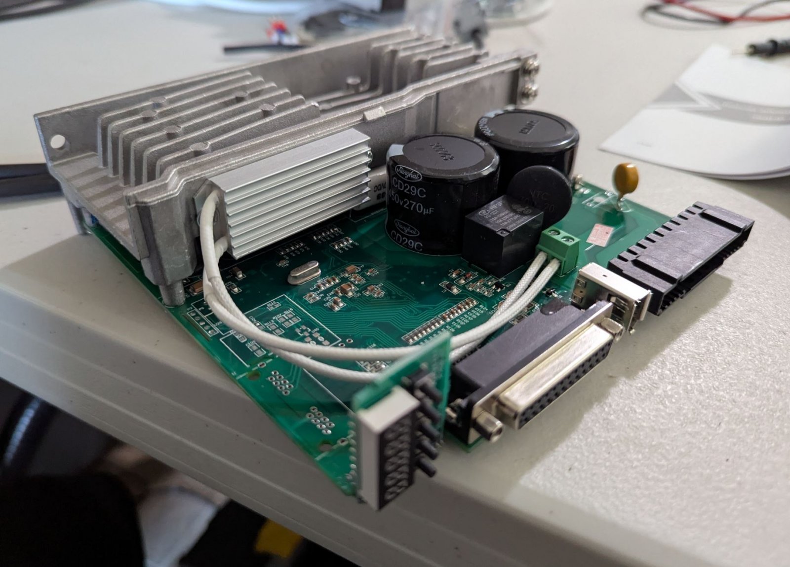

    • There is no serial port, even if the manual/product page says there is. Not sure if the firmware would support it if you populate the empty headers.

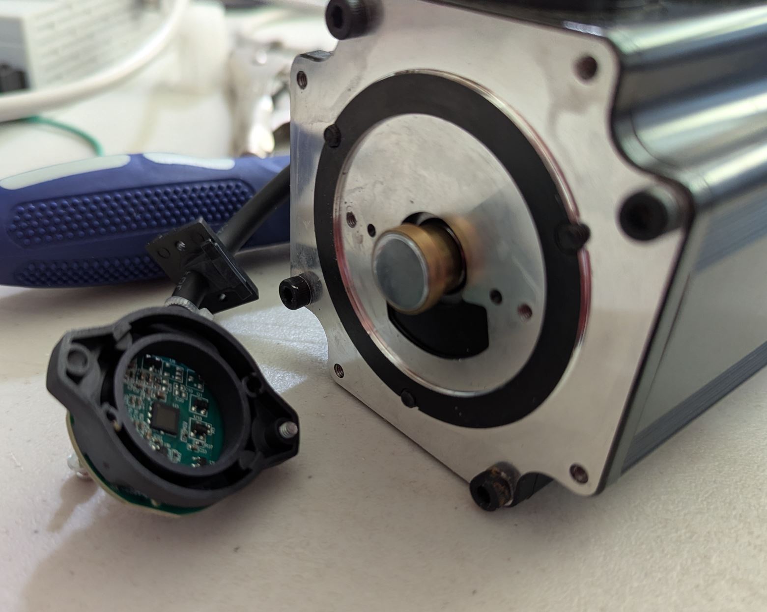

    • It appears to use a single-turn absolute position encoder. Likely it communicates with the driver via some sort of serial method instead of the usual quadrature.

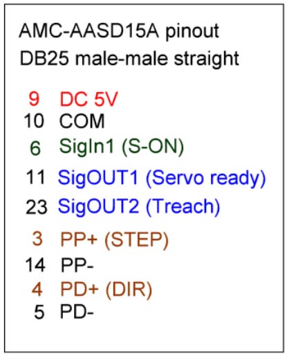

    • The encoder/position data is not available as an output on the parallel port.
    • The parellel port IO is rated for 12-24v. However, using 5v for the enable signal appears to work fine. Wired for single-ended quadrature inputs, I found I needed about 11.6v for it to work reliably. If I configured it with a fake differential signal (VCC and ground are different, right?) it seems to work fine at 5v.
    • Opening it up, it appears to have an internal brake resistor.

    • All the parameter numbers I've looked at in the manual match up with AASD-15A parameters so far.
