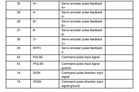

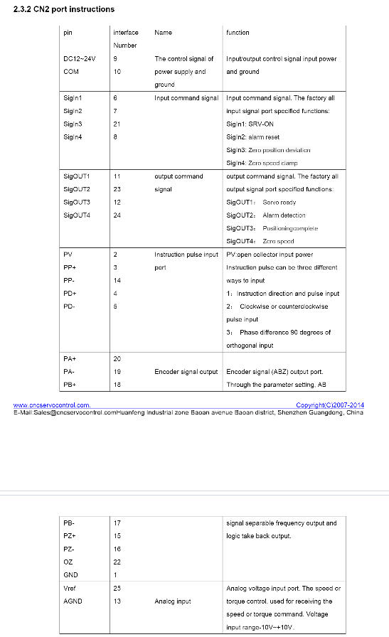

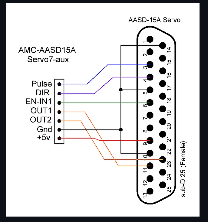

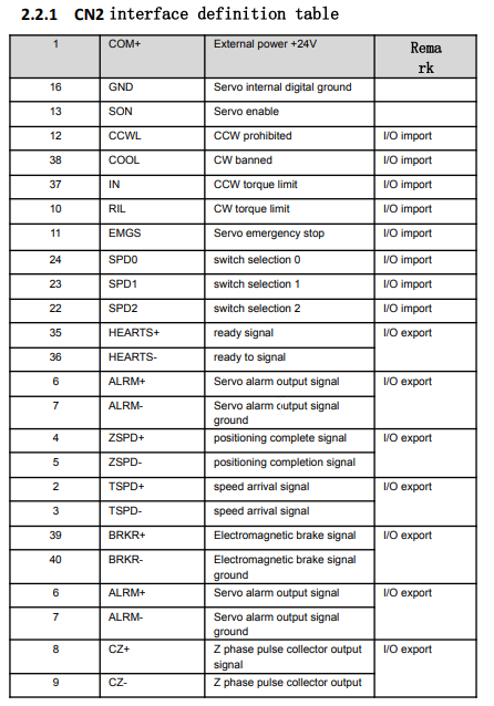

    Hey all,
    I have 4 750W (500mm/s, 150kg) actuators left from a previous project that I want to put on my sim rig for 3 DOF. The main issue is that while they are AC servos and AC drives, the pinout of the COM (CM2) port on the servo drive is a DB44 as opposed to the AASD-15/ @Thanos DB25. I understand there are some tuning parameters that would have to be adjusted. But looking at the pinout from both (attached + manuals) is there a way to make this work? (I can work around the 5v-24V with an IC)
    Thanks all,
    AASD Pinout:
    DPx200 Pinout
