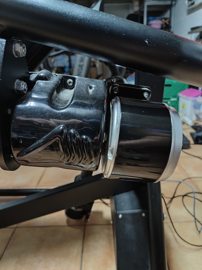

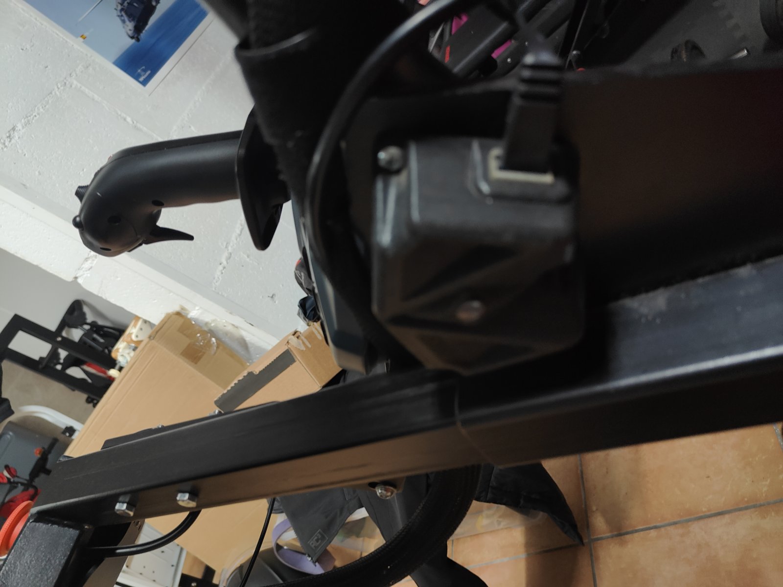

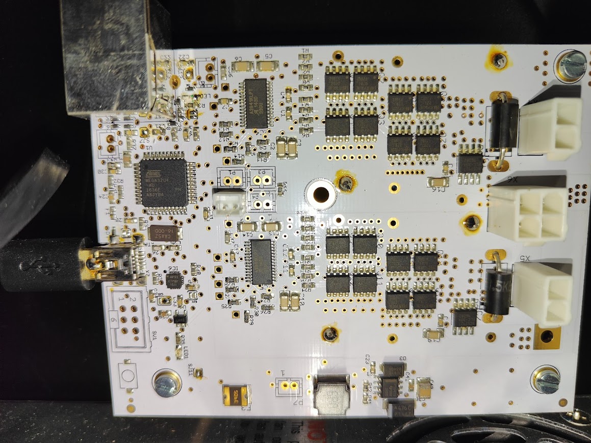

    Thank you for creating a topic for my motion rig.
    As for the hardware, unfortunately I don’t know much about it :(
    But I opened the cover of the electronics section and took a picture of the control board.
    I also took a picture of one of the two DOF motors, in case that helps give you some clues to assist me.
    Thanks a lot!

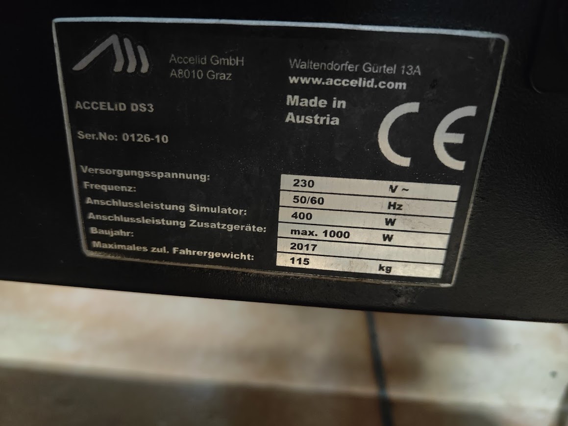

    Are there any product codes/stickers that help identify the hardware used?
  5. yuyu
    yuyu New Member
    Apr 21, 2025
    13
    75Coins
    +7 / 0 / -0

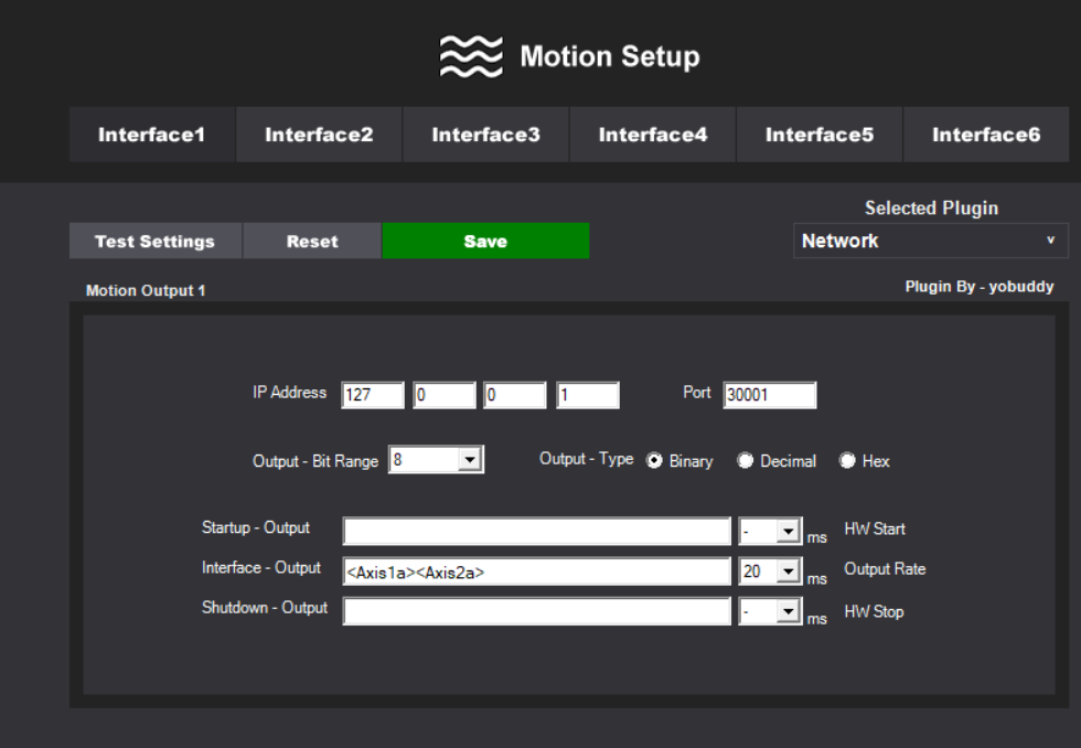

    Just wanted to share some progress and hopefully help others with the same hardware.
    I initially tried using the Serial interface of the DS3 rig, but I gave up on that route. It was overly complicated to reverse-engineer, and the COM port monitor tool I was using hit its 14-day trial limit — so that made things even harder.
    Luckily, I managed to get the rig working using the Network interface (UDP) instead.
    Turns out, the DS GUI app (which controls the rig) has a hidden gem in the "Extra" tab: a "Simulate" button that activates the motion interface and allows you to test UDP data without needing to connect the rig.
    With some trial and error — and a lot of help from ChatGPT :cool: — I figured out the correct data format DS GUI expects. I now use SimTools v3, which sends out axis values over UDP, and a small Python script that acts as a bridge between SimTools and the rig.
    The result:
    • SimTools outputs to port 30001
    • The script converts the data and sends it to DS GUI on port 21777
    • The radar in DS GUI controls the actual seat movement (2DOF: pitch & roll)
    For anyone else with this rig:
    I'm sharing:
    • The DS GUI app
    • The working Python script (with a small GUI to start/stop and view logs)
    • A precompiled .exe version if you don’t want to mess with Python
    https://drive.google.com/drive/folders/1RBUUUTnt7naWBJVnGz7jWZqS0WZXSswh?usp=sharing
    Right now, I'm using the Python proxy to handle the data format conversion between SimTools and the DS GUI.
    If anyone knows a way to do this directly from SimTools (like using a plugin or better interface config), I’d love to get rid of the extra script.

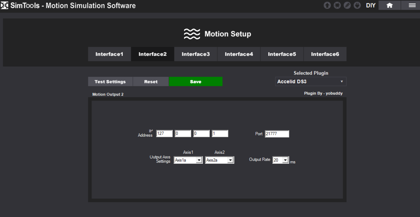

    Just a quick update for anyone looking for a plugin for the same motion rig.
    Thanks to @yobuddy, I now have a fully working plugin!
    You can download it from the attachment below.
    I’ve also included a screenshot showing the interface settings.
    Hope this helps others with the Accelid DS3 rig!

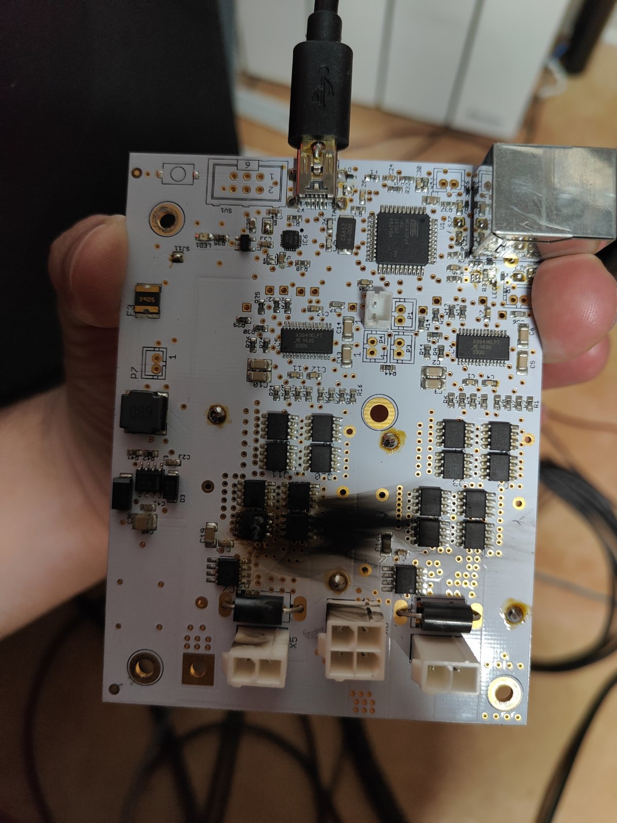

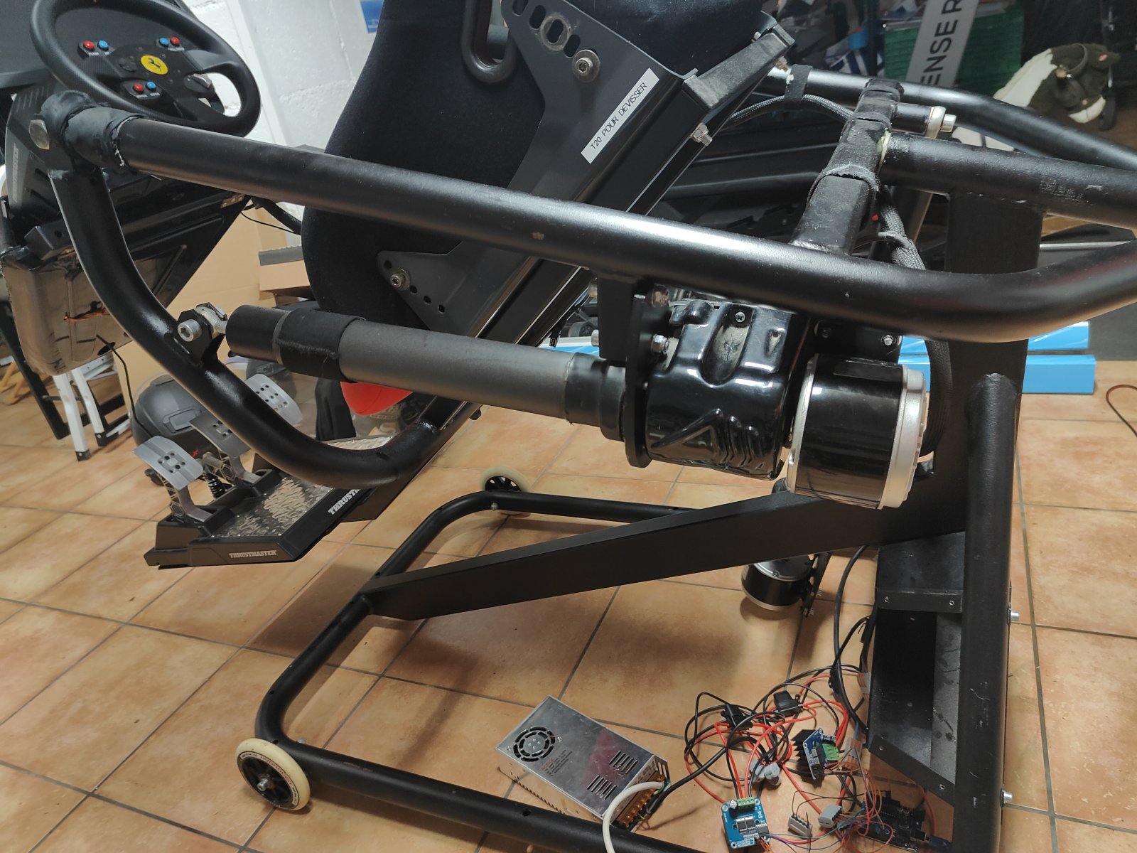

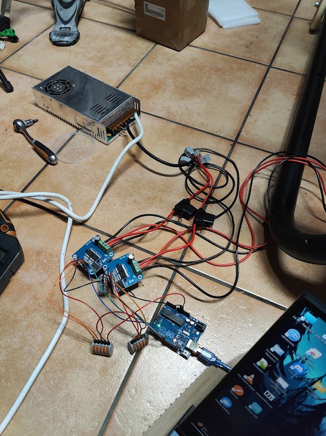

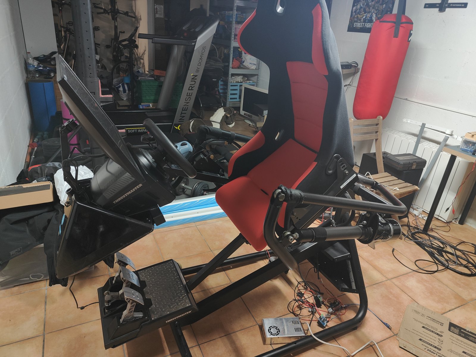

    Hello @yobuddy @noorbeast , I'm reaching out again for help because unfortunately, the electronics of my motion simulator have burned out :(.
    I've tried to build an equivalent using an Arduino board. My simulator has two MY1016 motors that drive screw-type actuators. There are no sensors, and I have no idea how the original software was able to detect the seat position (probably through software estimation).
    I’ve done some firmware tests with ChatGPT, but I still don’t understand how to get everything working properly—especially how to brake/hold the seat in a given position and how to estimate the position reliably.
    Do you think it would be possible to run SMC3 without potentiometers? Or am I absolutely required to couple each motor to a potentiometer?
    If that's the case, I've already purchased WAVGAT 3590S 10kΩ pots, but I’m still not sure how to physically couple them to the actuator arms. :(
    video of the test with arduino and bts7960 :
    https://photos.app.goo.gl/9dXArN8K9W25u8Df7
    Thanks for your help
  14. yobuddy
    51,403Coins
    +5,202 / 19 / -0
    The motor on the unit looks like a my1016, or something like that.
    Does it have a sticker on it saying what it is?
    It defiantly looks like you have the actuators powered and moving (without any feedback for now)
    There would have to be some way for the actuators to report there position. So there must be a "pot" or hall effect device on it somewhere. As there is no way for them to just guess the position or anything. If you can find what they were using for positioning feedback, you could probably adapt the whole sim to smc3.
    Chat soon!

    Hi @yobuddy,
    Thanks a lot for your reply!

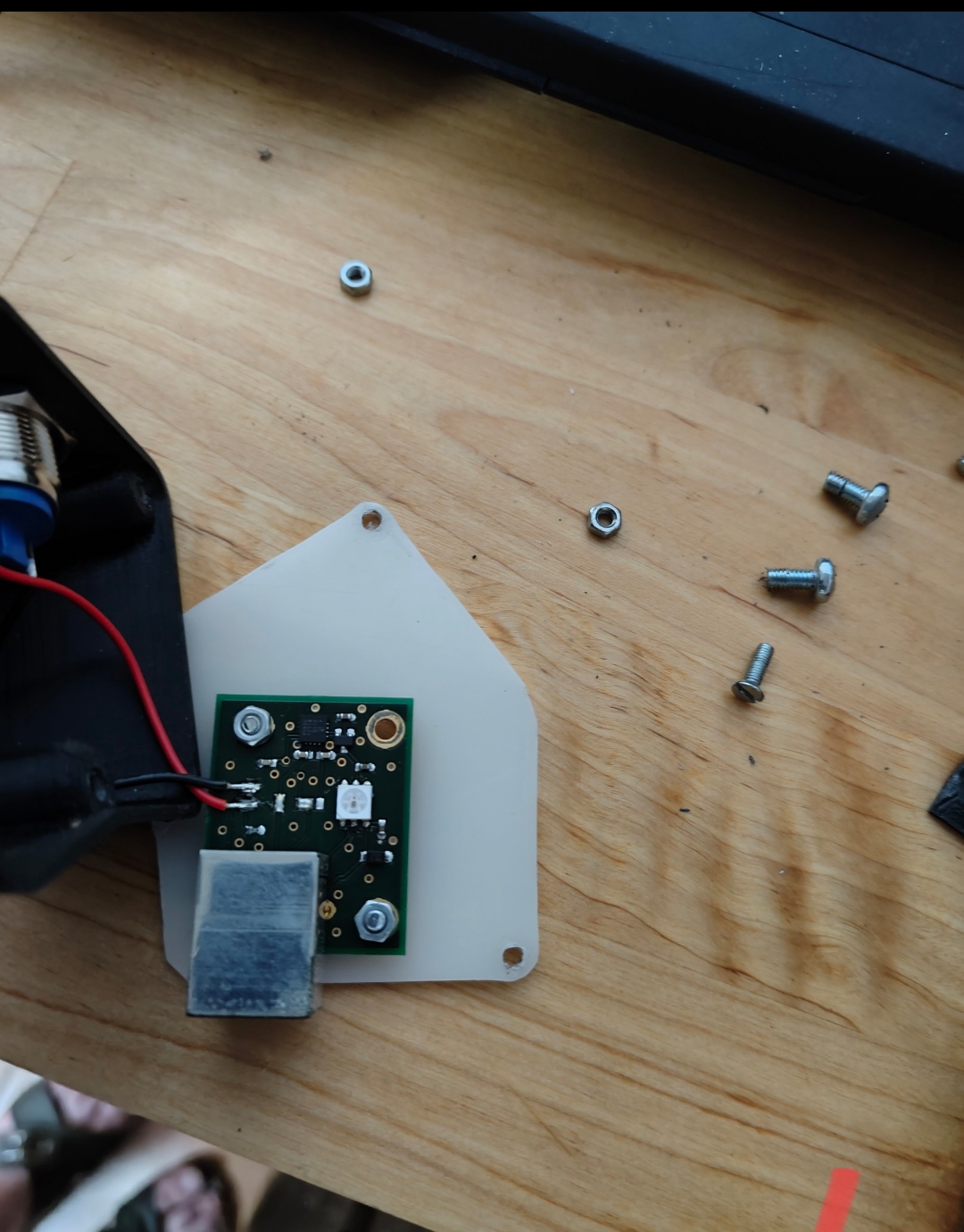

    Looking at the burned board, there are only two pairs of DC wires for the MY1016 motors and four wires for the power supply. There's also an RJ45 port, but it seems to be just for a start/stop button and a LED.
    I didn’t see anything that could provide feedback. maybe I need to take a closer look

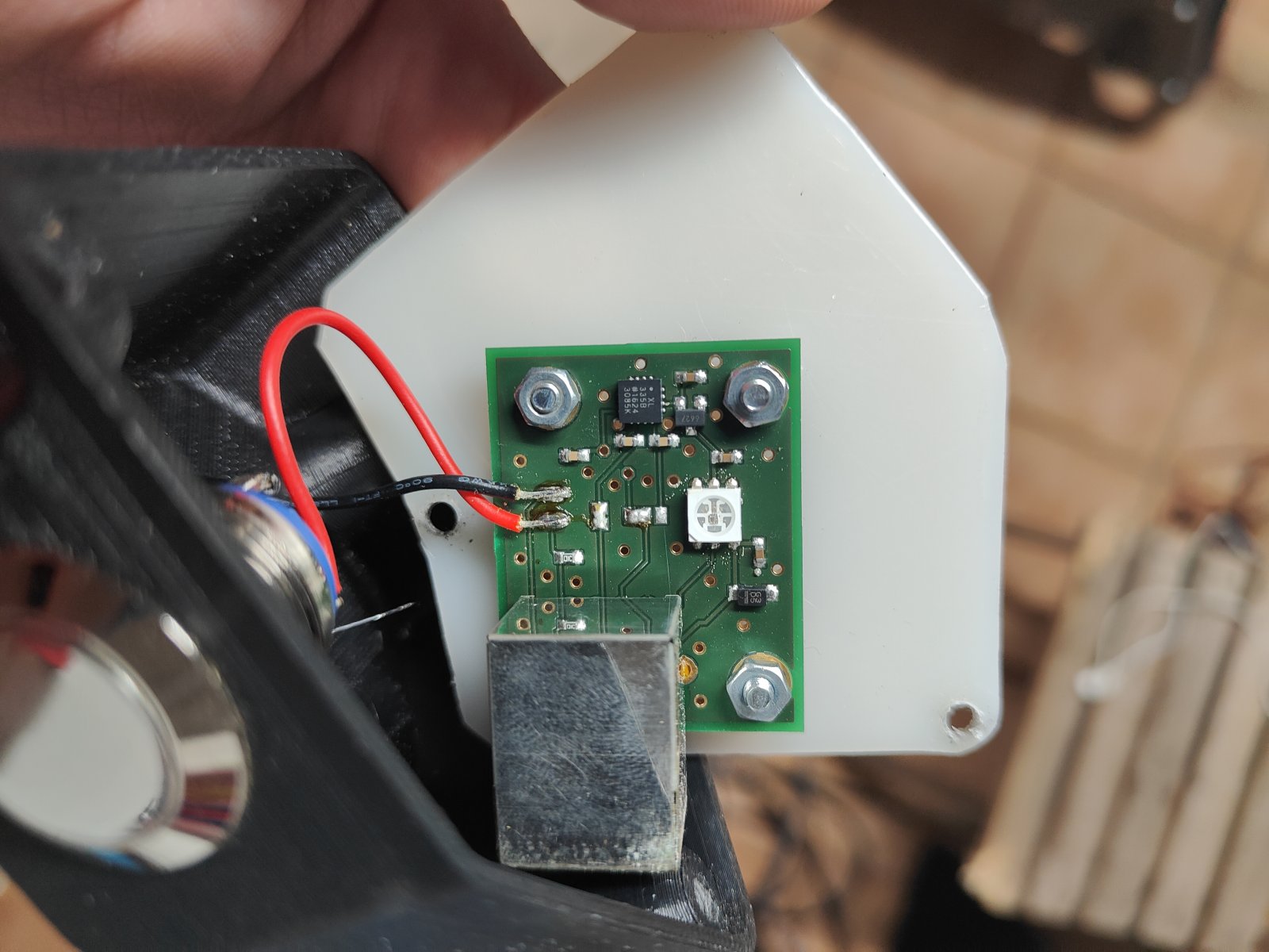

  16. yuyu
    yuyu New Member
    Apr 21, 2025
    13
    75Coins
    +7 / 0 / -0
    I took a look, and there’s nothing that seems to provide feedback. I took a picture of the board connected via RJ45, it just has a LED and a button.

  18. yobuddy
    51,403Coins
    +5,202 / 19 / -0

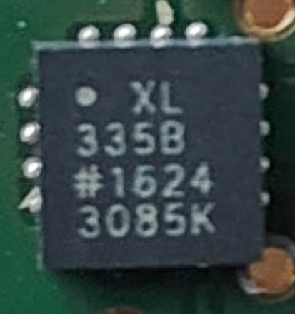

    My guess is the PCB itself has a IMU on it, so the sim can tell the roll and pitch of the simulator.
    It would explain why you can not find any other hardware on the sim itself.
    If this is the case, then you will need to add the 'pots', or alter smc3 to use an IMU like they did.

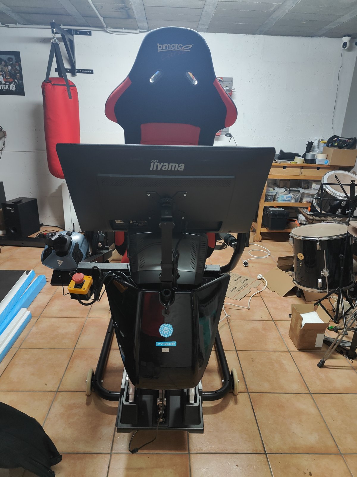

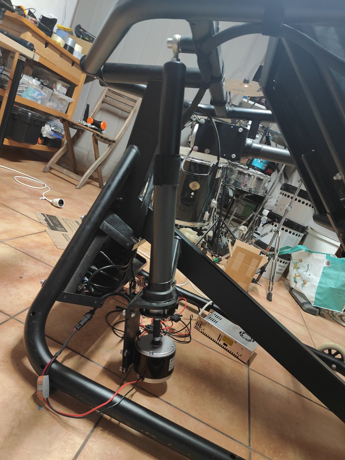

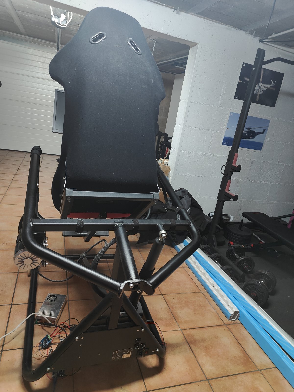

  19. yuyu
    yuyu New Member
    Apr 21, 2025
    13
    75Coins
    +7 / 0 / -0
    Thanks again for your help!

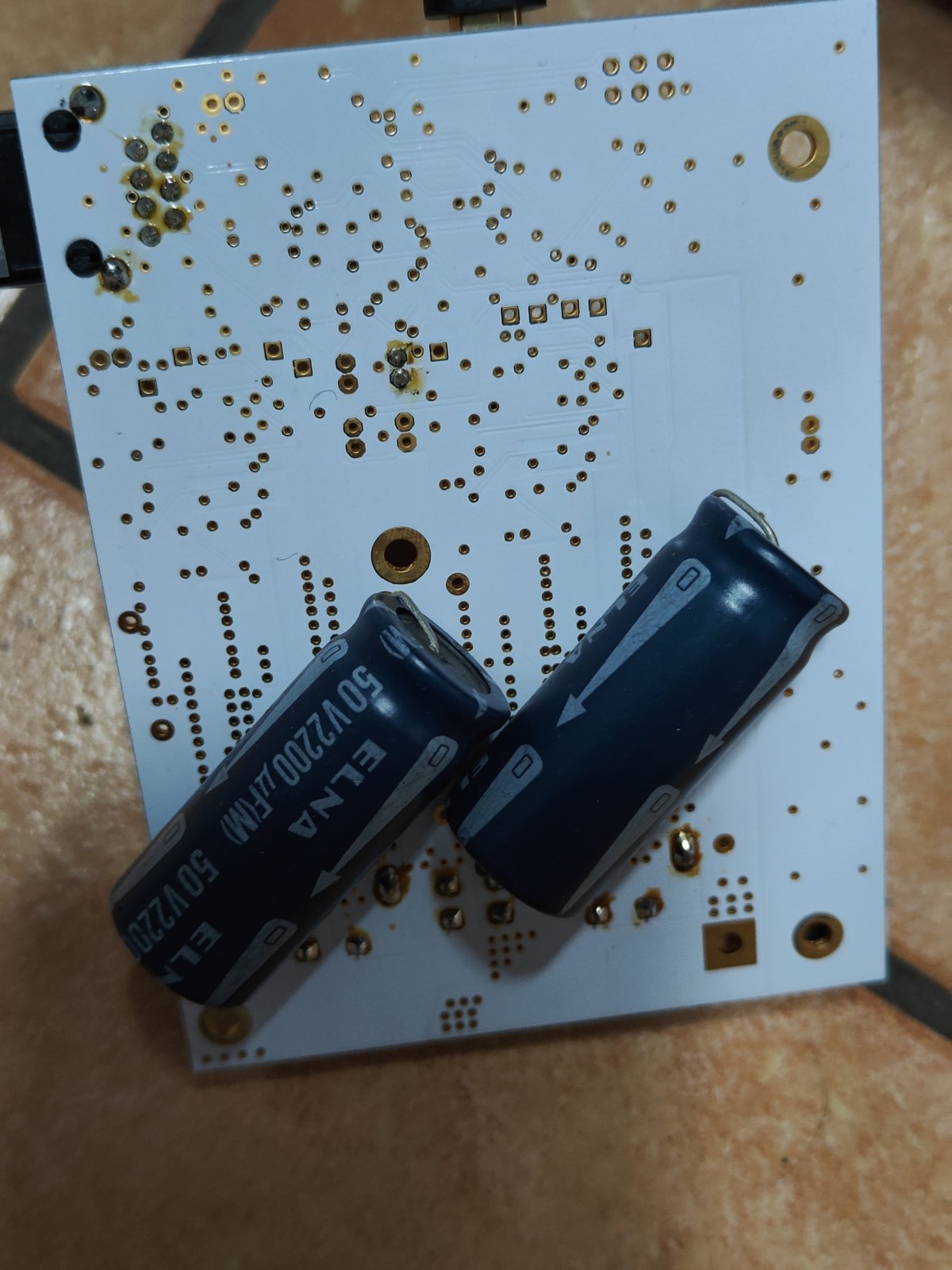

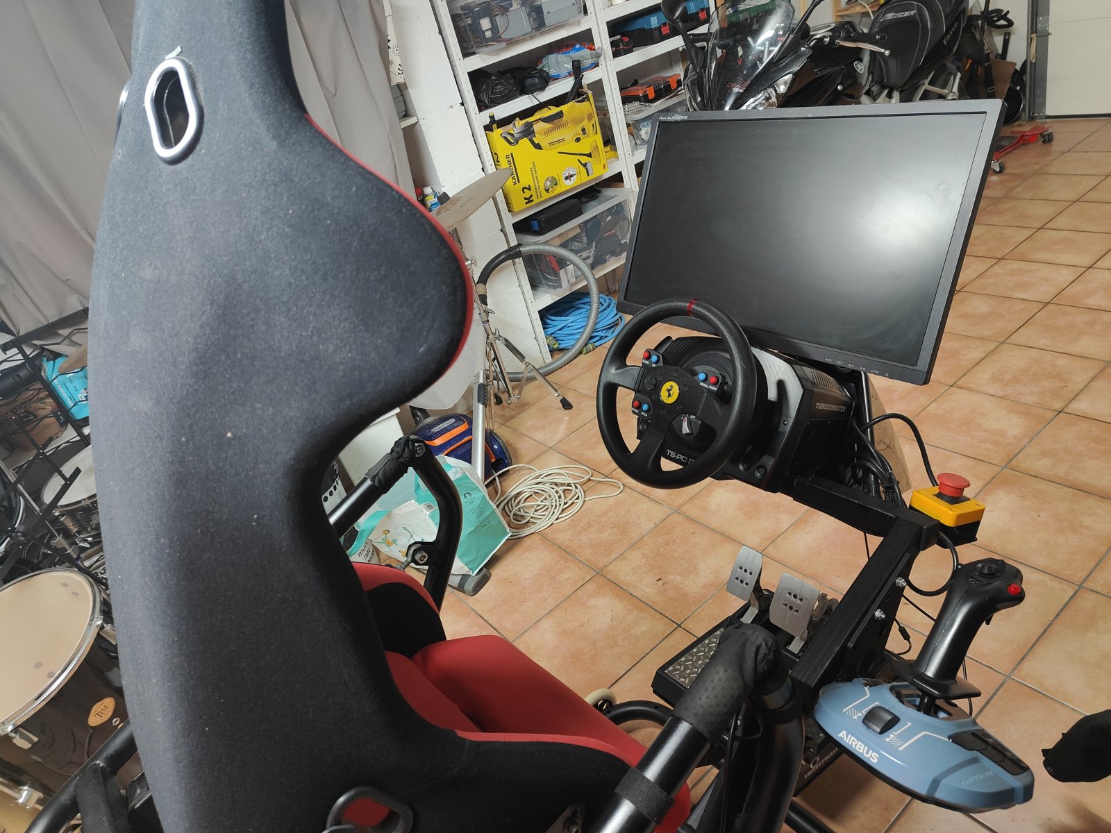

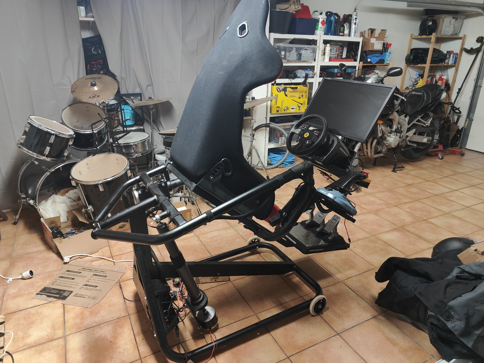

    I've uploaded several photos so you can see how the system is built.
    The main board is fixed and doesn't move at all, so there's no way it could include a motion sensor.
    The only place where a sensor might be located is on the small PCB connected via RJ45, but I really don't think there's any kind of sensor on it either.

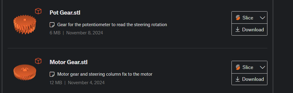

    I found this project: https://www.printables.com/model/1062501-my1016-ffb-steering-wheel/files, which should help me connect a potentiometer to the MY1016 motor.
    The 3D models are included, and I had the parts printed by a local company, I’ll be picking them up today.
    Once I’ve installed the potentiometers, I’ll start testing with SMC3.
    In parallel, I’ve reached out to someone from the seat manufacturer to see if they still have the original firmware, it would be very helpful to understand how the system worked originally.
  20. yuyu
    yuyu New Member
    Apr 21, 2025
    13
    75Coins
    +7 / 0 / -0
    You're right @yobuddy , I checked again and there is actually an accelerometer on the small board, it's the XL335B chip.
    I’ll see if I can do something with it to use it with SMC3.
