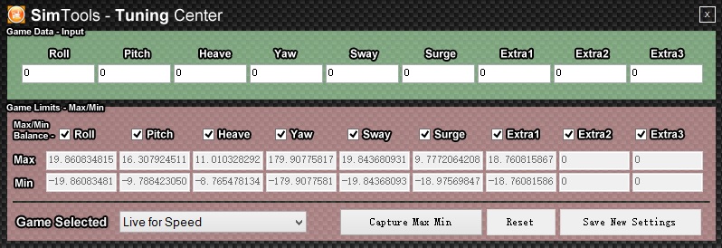

    Yes, I have done that, and I found that the captured min/max value is actually smaller than the default, so I don't think that's the problem.
    Here is a screenshot:
    And I suppose the 'min/max file' is the same thing as this?

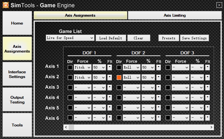

    May I see you axis assignments for LFS, screenshot?

    Here's the screenshot:

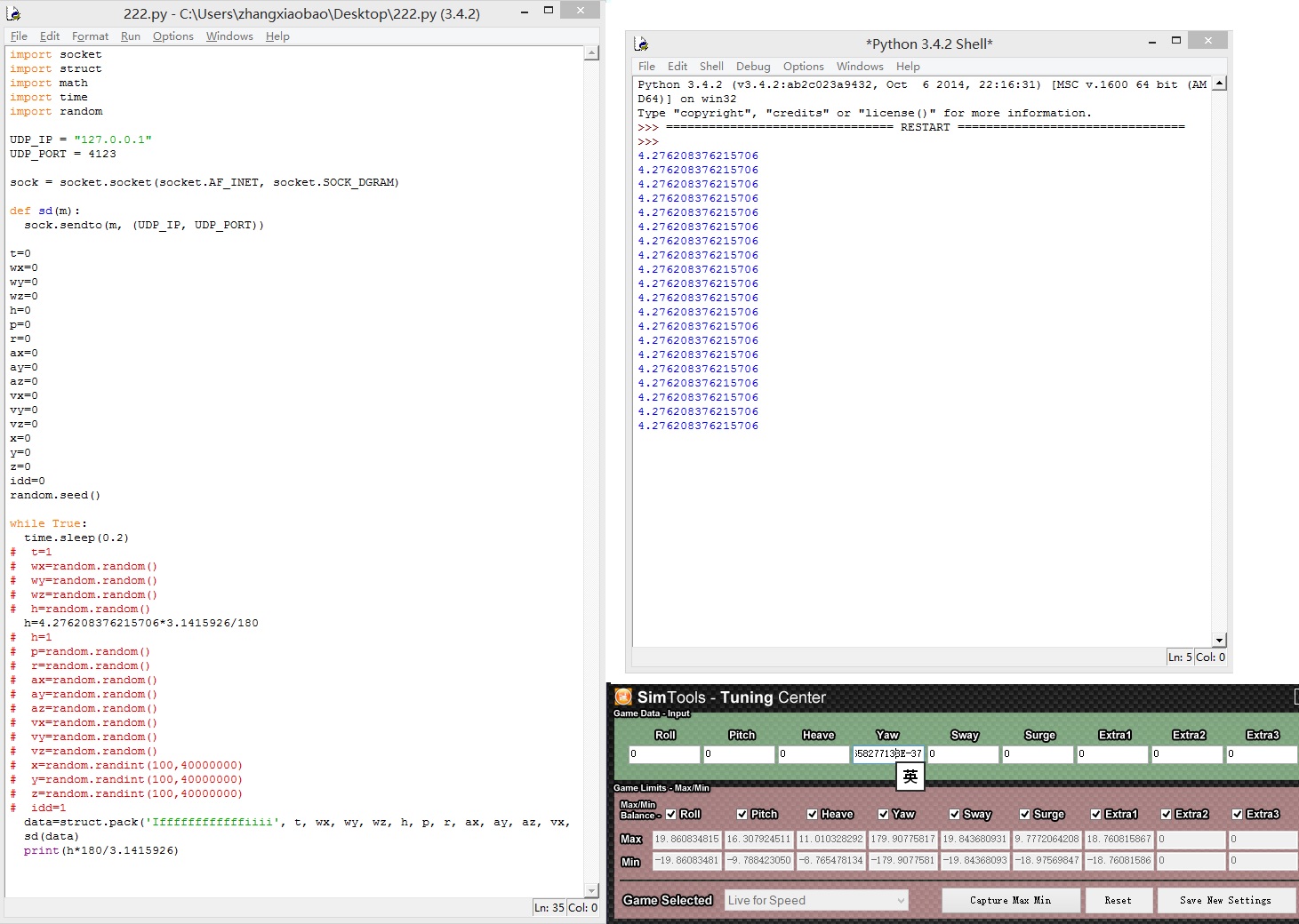

    So, guys, today as I was playing with OutSim and trying to debug this issue, I found a strange thing. For certain values of heading, pitch, roll or other inputs, a wrong value is shown in "Game Data" in "Tuning Center".
    I have absolutely no idea why would this happen. If you're interested here's the script I used to debug (Python 3.4):
    http://pastebin.com/10VNhVwT
    If I run this while running LFS, I expect to see a yaw of 4.27 in "Tuning center", while it shows 3.35966658277133E-37.
    Can you replicate this behavior?

    You are aware that outsim outputs the values in world coordinates while these are output in local coordinates in SimTools?
    Before comparing the OutSim output, you must do this mathematical transformation.
    Otherwise I expect the values to be different (OutSim vs SimTools)!
  18. zhangxiaobao
    zhangxiaobao New Member
    Mar 25, 2014
    10
    300Coins
    SCN5, 6DOF
    Yes I'm aware of that. It seems that OutSim outputs positions, velocities and accelerations in world coordinates, while pitch, roll and heading is local. I have also done the transformation from radian to degree. For some values that I input, the value shown in Tuning center is the same as printed, while for some it's very different(shows a very small or very large number). I found this out by first using random numbers.
