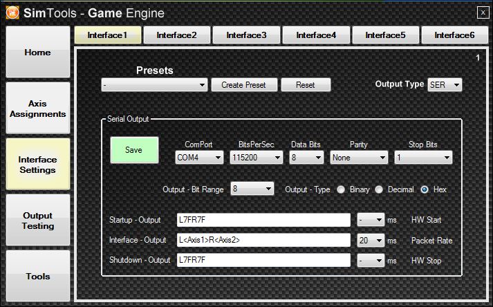

    thanks for you reply i will buy later the plugin for my games,
    a question
    now i 'm using arduino and motor shield
    here there is very good tutorial
    xsimulator net/community/marketplace/arduino-code-2dof-and-2-pins-direction-hbridge-motomonster.67/
    but i try to move the axis in output mode but when i push TURN ON the motor go
    after i try to move the axis don't move in any mode
    now i have this configuration like the att
    in axis assignement i have all in preset default "sim force gt"like tutorial
    but no move for motor
    why?
    thanks for all

    The difference from SimTools 1.3 to SimTools 2 in setup is that in the Interface Settings instead of axis defined like this <Axis1>, it now has designate grouping for a or b in SimTools 2 for each axis assignment, like this <Axis1a>
    So in your case it will be L<Axis1a>R<Axis2a>

    thanks for your reply buy i try and don't work
    work only with L<Axis1>R<Axis2>
    push"turn on" and the motor go in position but don't work with slidebar

    Sounds like you are trying to use the old SimTools 1.3 with SimTools 2 plugins, that will not work.
    Upgrade to SimTools 2 and the settings I gave are correct for it.
    SimTools 2 does require a license to use anything other than Live For Speed, which is included for testing purposes.
    You can purchase a SimTools 2 license here: https://simtools.us/license/
    There is an eligability criteria but genuine DIY motion sim builders can get a DIY SimTools 2 license for free: https://www.xsimulator.net/community/faq/request-a-free-diy-simtools-2-0-license.262/

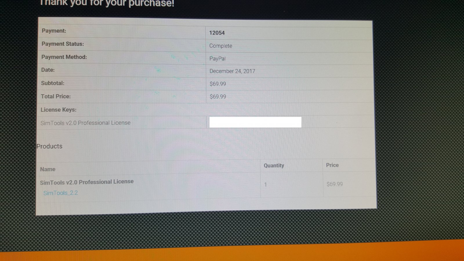

    thanks for reply i have buy a licence for 69 usd and active it but i have active 1.3?or i can use now for sim 2?please say me how i can do

    I'm sure that i 'm using 2.2 i have download 2.2 sim tool

    i try and now i'm sure that is 2.2 but don't work..in incredible only a motion on start later nothing

    Sounds like both got installed together.
    Simply uninstall simtools (and say yes to the "Remove old files and settings")
    Then reinstall v2 and give it a whirl!

    Hi good now works!thanks!a question where i can found for video move a tutorial?i see that sim tools have this feature thanks for all and good year!
