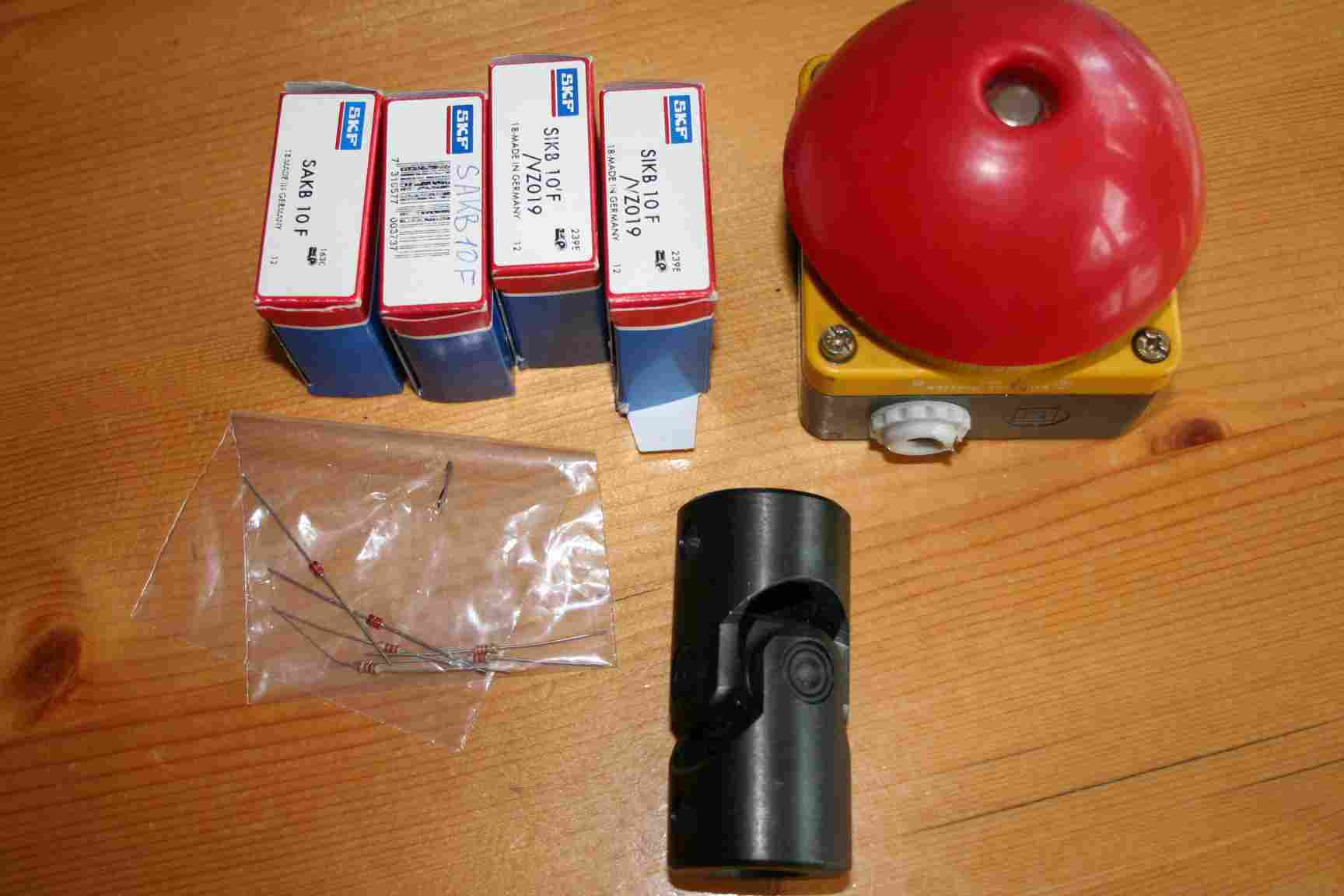

    What I bought until now!
    Is something missing?

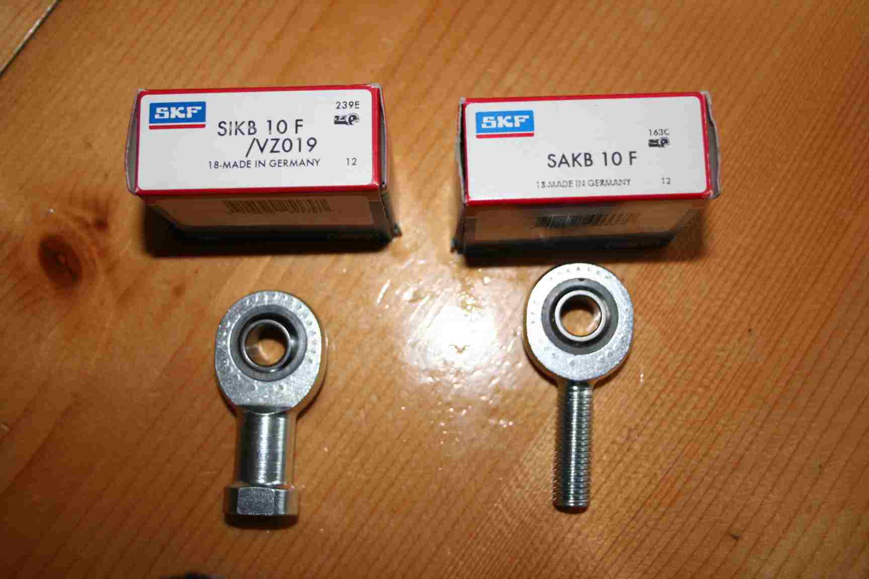

    this are the correct Joints for the SCN5 Rod end
    SKF Part Nr.: SIKB 10 F /VZ 019 with Pitch M10X1,25
    but be aware they are very Expensive Listing Price is arround 45 € but I get them for less than the half !
    You have to deal hard with your Local Dealer.
    The other one on the Pic is with M10x1,5 standart pitch, for my bottom end. I use 30mm Bosch profiles where I can cut the Pitch in the middle hole.

    Hi Kai,
    cheaper would it been that to buy default ball joints with M8 and than cut the needed fine pitch winding as Ego suggested one time.

    In my opinion thats not so good for stability reasons to cut the fine pitch in normal pitch.
    With every turn you cut the old pitch away, after 6 turns there is nothing left. 6x 0,25 = 1,5mm.
    You need another 6 Turns to get another full Thread Turn.
    You can´t turn the joint 12 Turns on the Rod ,so you only have one Full Pitch and 5 Pitches who become smaller and smaller.
    Even if you use a counternut you won´t have the full strenght.
    It´s hard for me to explain these technical Things in english, but I hope it becomes clear what I mean.

    so I bought the Power supply and the converters !
    Adapters for the Cardanjoint are on the way !
    One problem left: The connectors for the SCN5
    Is there anybody who wants to buy actuators and needs some Connectors too?
    So I would buy some more and we can share the shipping costs.
