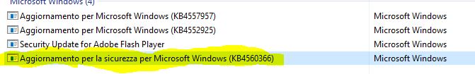

    Today there are 2 other small updates, but they are not system.
    I took a screenshot of the updates.
    The test I did is to uninstall the updates, but the 4560366 does not uninstall.
    I tried this, but simtools does the defect described above, it only works 100%
    Then I installed all the updates again and always sim tools works only 100%.
    At 99% it feels little and slow, from 98% to 0% and equal to 0. Aggiornamenti del 10-6-2020.JPG

    I did it guys ....
    with the uninstall option I was unable to uninstall the whole update.
    I tried with the option return to the previous version of windows and everything is back as before .... sim tools included ...
    I'm very happy.
    Now I have to be careful not to install the new Windows update ...
