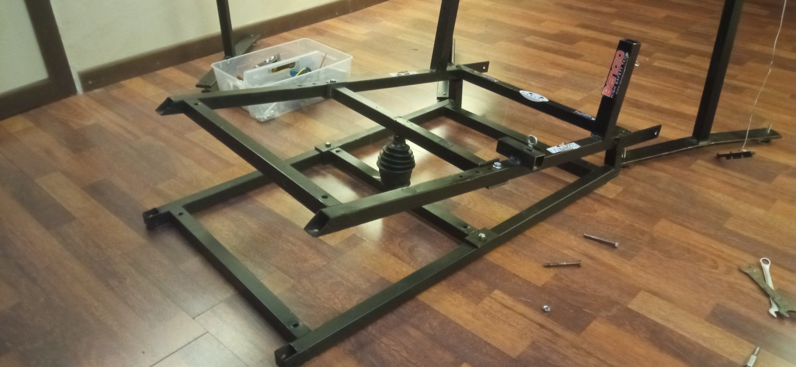

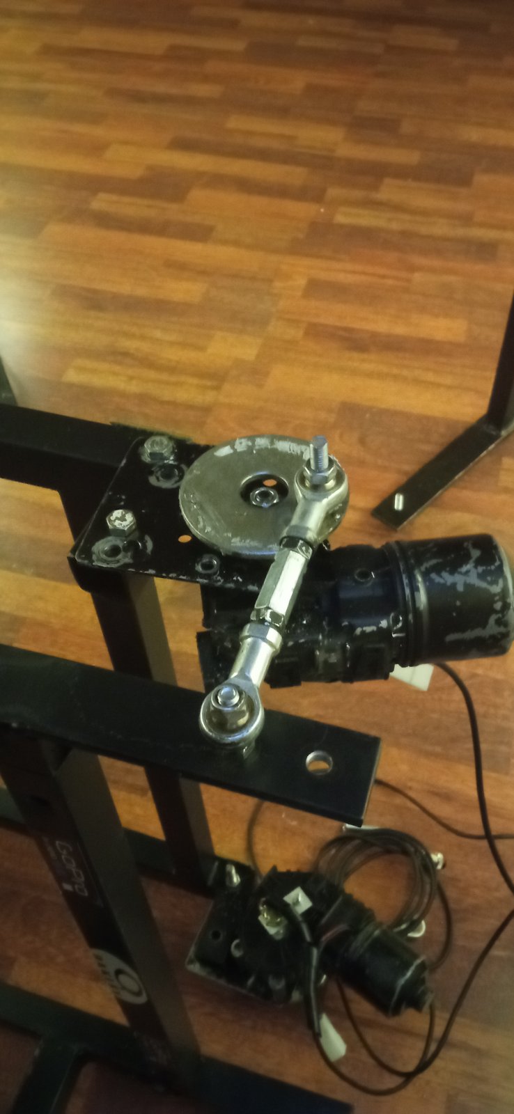

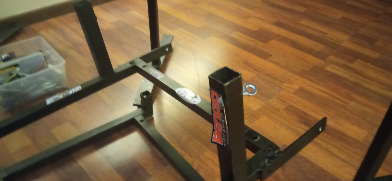

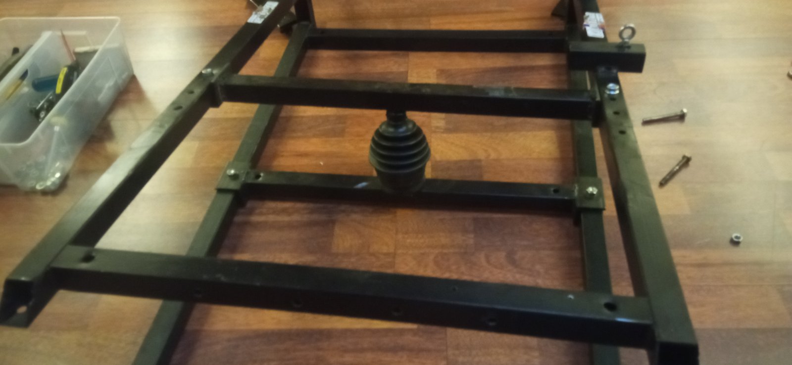

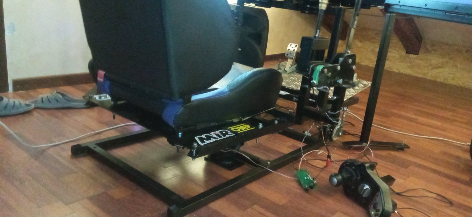

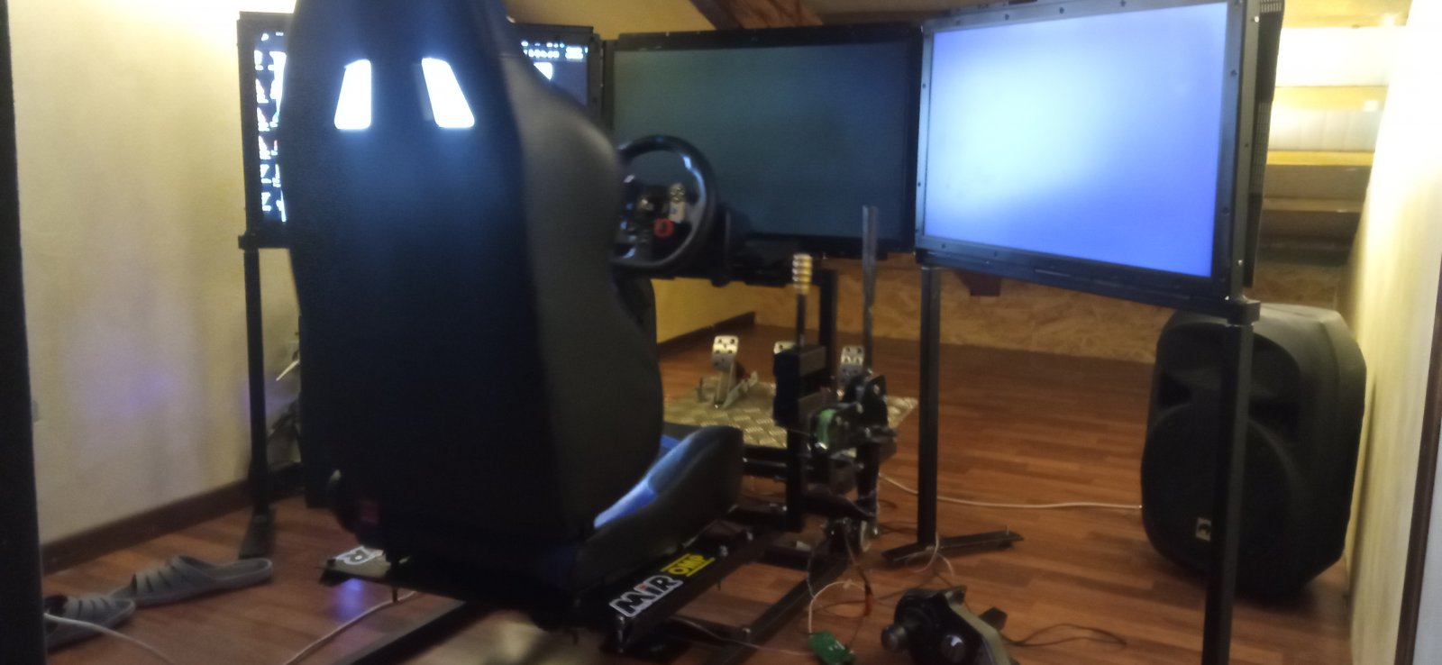

    after a few months of inactivity I come back with an alternative solution where instead of just moving the seat the movement is total. Let's talk about the steering wheel and pedals. As you will see from the photos, I placed the two DOFs in the front with the constant velocity in the center. In my opinion, the result is good even if it loses some sensitivity (we have other weights to move).
