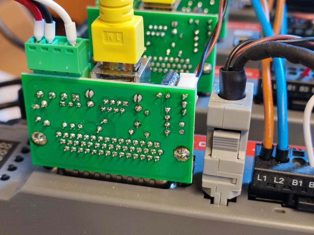

    I've made adaptor PCBs to fit the A5 pinout to the layout of my own motion controller which uses RJ45 cables. But I think it would be no big deal to make something similar for the standard DB25 pinout of the AASD servos. Lichuan_A5_DB44.jpg

    Ahh very interesting, the A6 are confirmed from factory not to support the torque signal (17 for output here) in position mode , thats pitty for rotary rig users where torgue is a really good way to home.. . i also invested hours to get it working before asking factory
