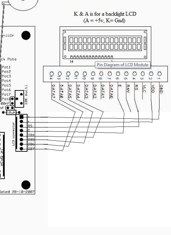

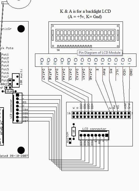

    I just noticed in the schematic that the LCD has some sort of board.. Is there any info on making this board?
    the first picture below is from the sacamtic that tronic made.. The second i the schematic how my lcd is currently attached.
    notice on my the RW is not connected.

    The R/W of the LCD should be connected to Ground... !!
    If you still have problems with it take a look in this post on how to power the backlight directly from the powersupply, and use a potentiometer to fix the contrast (needed for most Blue LCD's...!)
    post13837.html#p13837

    i have now connected R/W to ground.
    I am still getting the same problem. The back light comes on but nothing else. (no blocks or anything)
    I will try connecting a pot to it as in ur post, however it is not a blue LCD its a standard Green one..
    I also tried connecting A to +v nd K to gnd. however this didnt do anything differnet. (i didnt think this was the problem as the back light was coming on)

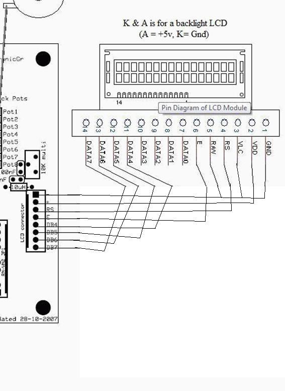

    wahoo
    Wahoo, I figured it out.
    I didnt have the contrast pin set to 0. It works now.
    for those noobs (like me) who might have problems with their LCD this is the wiring i did to get mine to work.
    Im onto the next step now!!! :) correct lcd.jpg
