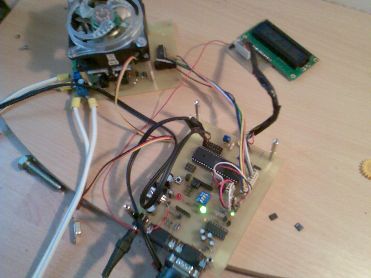

    I have managed to finish the amc1.5 and h-bridge1.2b. All works fine... :)
    But now I'm trying to enter the hyper terminal.
    I'm running vista 64-bit and have installed hyperterminal 6.3 from hillgraeve.
    Had some trouble opening comports but now it says connected.
    Although nothing is happening. No text is appearing in the window.
    I'm using the 22mhz crystal with firmware v1.0. When I set dipswitch 2 to on
    the amc does not display hyperterminal mode on the lcd.
    What can be the problem?
    gr. Jeroen

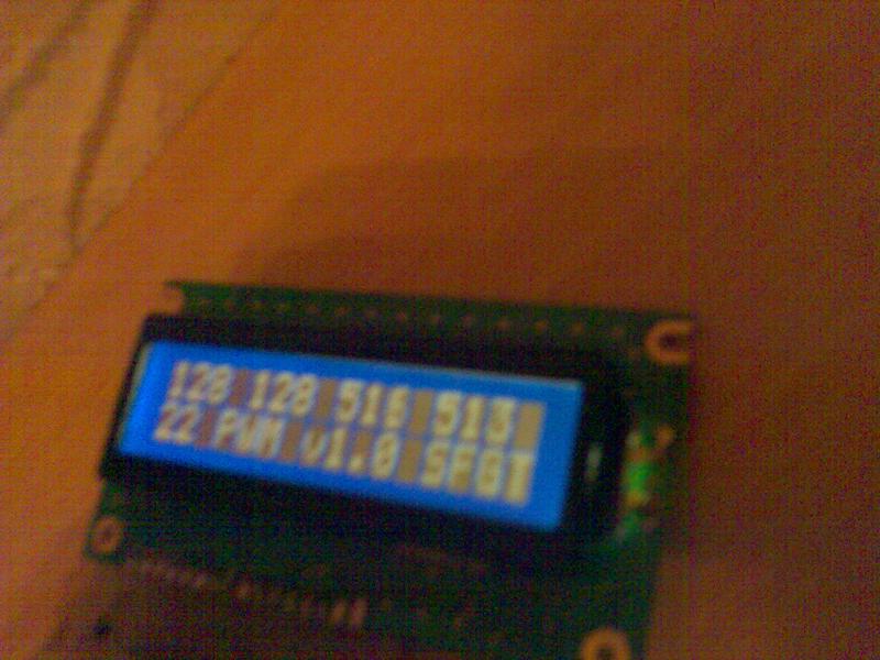

  3. Jeroen
    Jeroen DoctorXeno
    Oct 3, 2007
    120
    Holland
    - 55Coins
    Hi michael,
    No it does not. The lcd display the potmeter values and 22PWM v1.0 SFGT.
    gr Jeroen

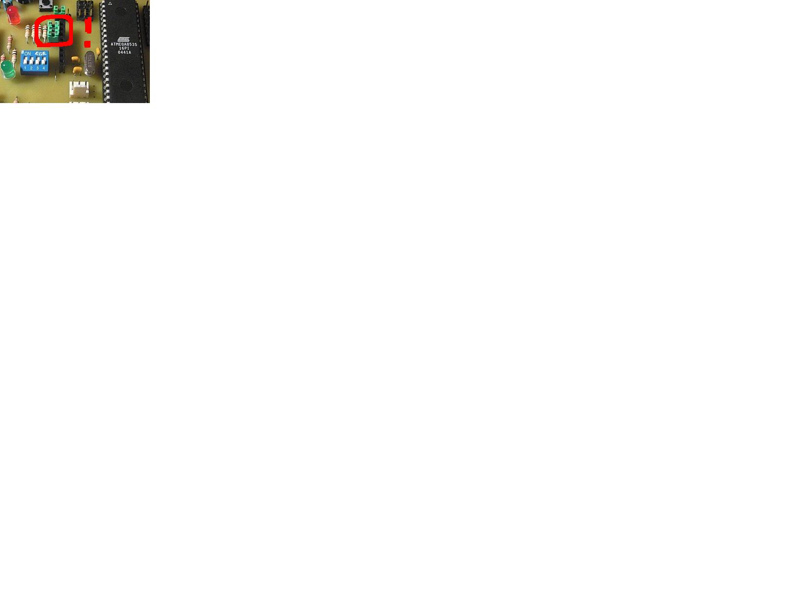

    Hmm strange :? . Do the dipswitch works correctly?, and do you have set the 3 jumpers (over the dipswitch) onto the board like in the picture?.
    I think or hope Thanos will have an answer.
  5. tronicgr
    tronicgr
    Hi Jeroen,
    Have you attached cables to both RX and TX ports? This is required for the two-way communication with hyperterminal.
    Also try to set the flow control to NONE in the hyperterminal settings.
    What worries me is that you didn't received the message AMC1.5 setup KP , TIP:use Terminal on the lcd screen. Perhaps the pull-up resistors are not in place? Can you post a photo of the board please? It would help to clarify these issues better.
    Thanos

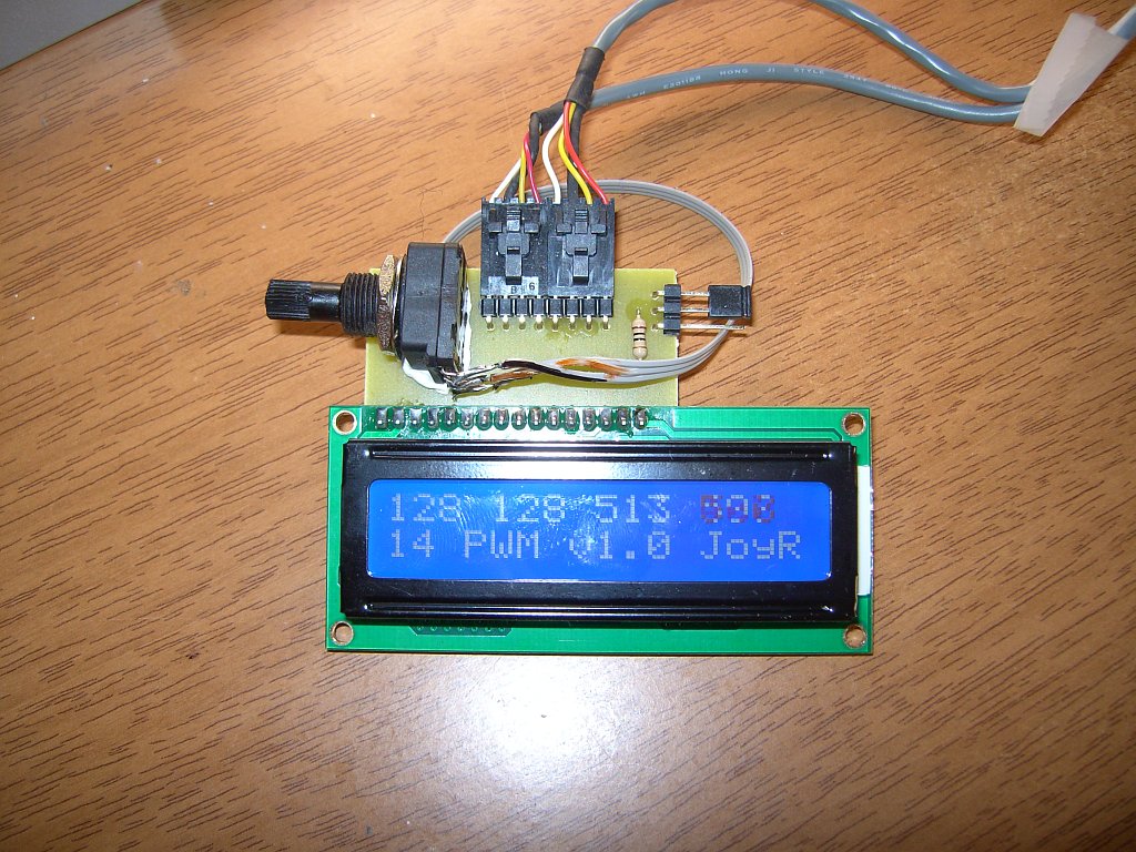

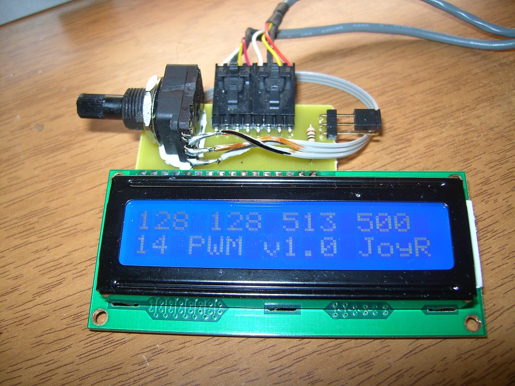

  9. tronicgr

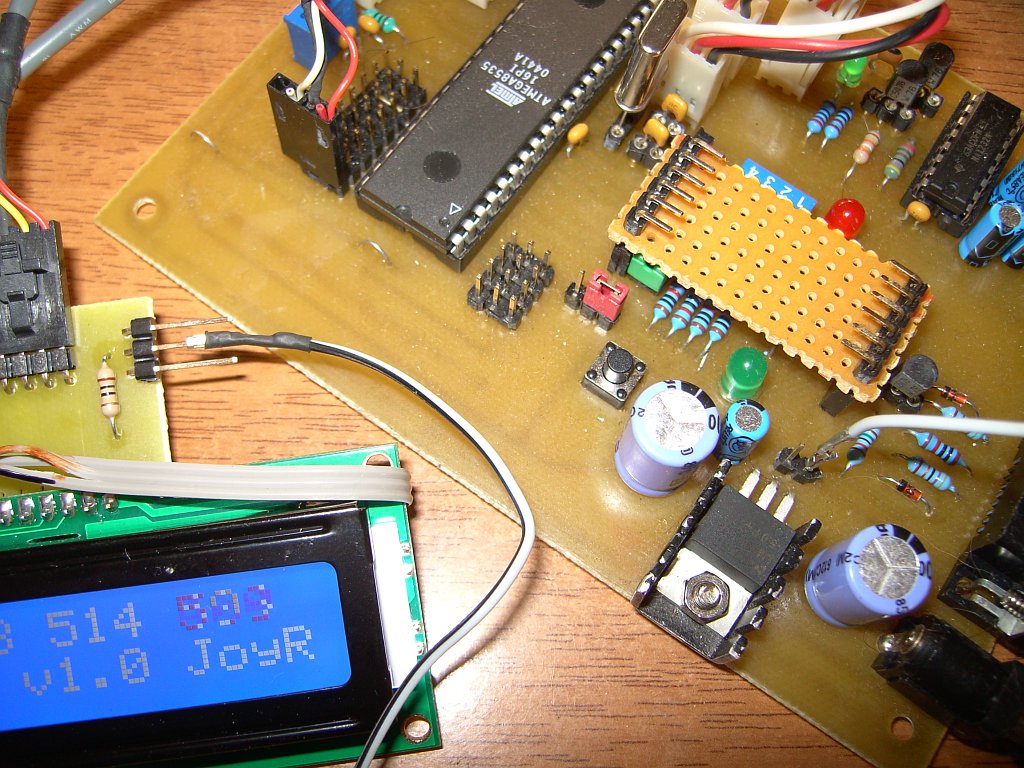

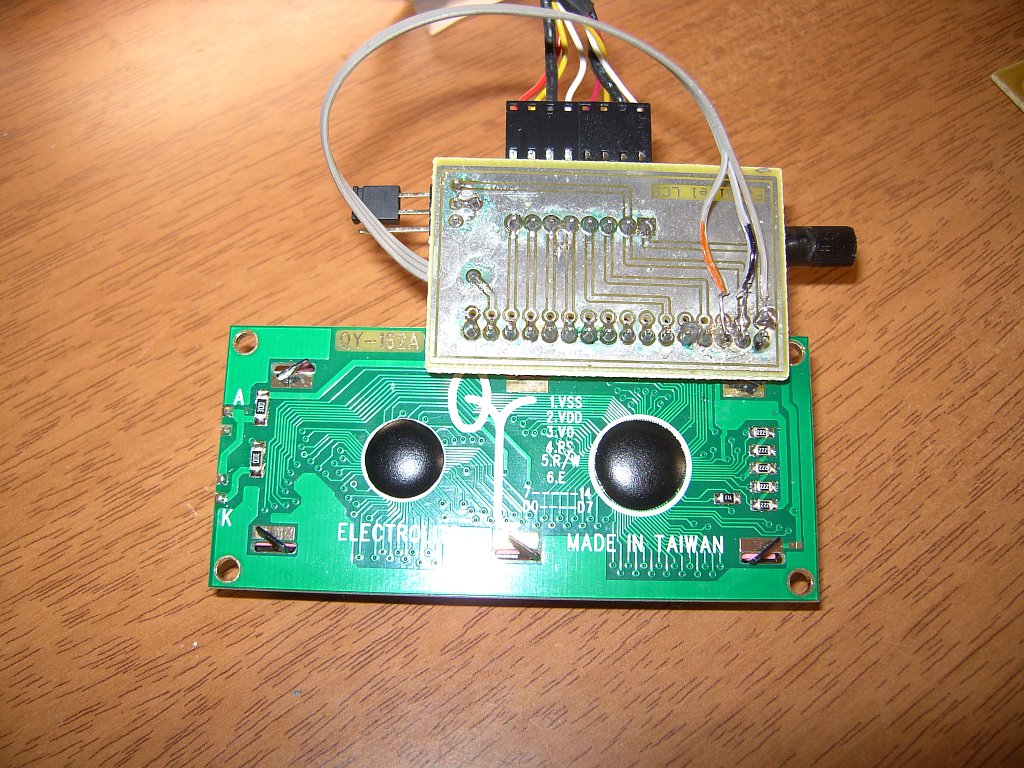

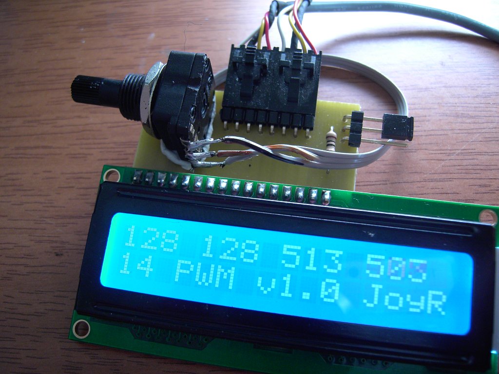

    tronicgr
    Hi Jeroen,
    I noticed that you are using LCD with blue backlight. These LCD's don't work with backlight OFF...
    The backlight draws a significant amount of current from the LM2940 regulator making it hot. I have left my setup with this blue LCD (backlight ON) for about an hour and the regulator was very hot even if I had used on it heatsink. Guess what. I could not either connect to the hyperterminal either after that.
    I can suggest to use a higher resistor on the LCD board perhaps 20 or 50 ohm...
    OR use a piece of wire to connect the middle pin of the jumper switch for the backlight with the input pin of the LM2940 that exists on the AMC1.5 board!! This will give pure amps to the backlight directly from your power supply bypassing the LM2940!!!! Be aware that the input voltage not be more that 9volts or you may overheat the LCD leds!!!! See these photos:
    Also noticed that you cannot operate them without the backlight ON. You can't see anything otherwise. On my existing board design the contrast pin is grounded for the maximum contrast, that works well on normal green LCD's but not on these ones!!! So I decided to add a potentiometer to control their contrast as well. I had to cut the traces around pin 3 of the LCD and solder a wire that goes to the center pin of a potentiometer (wiper), I had marked that wire with orange color on my photos. The rest two cables of the potentiometer goes to ground and to +5v.
    I hope this helps out.
    Regards, Thanos

  11. Jeroen
    Jeroen DoctorXeno
    Oct 3, 2007
    120
    Holland
    - 55Coins
    Hi Thanos,
    Thanks for the info about the lcd. You are right. The regulator was getting very hot and I could not read the lcd very good, only on an angle.

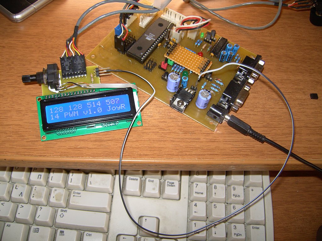

  13. Jeroen
    Jeroen DoctorXeno
    Oct 3, 2007
    120
    Holland
    - 55Coins
    I just programmed the 18.432mhz firmware. No problems at all...
    Connected a wire between the LM and LCD. So far so good.
    And 6 volt input.
    But... still no hyperterminal. The converter is connected on
    com1. That is working fine. Hyperterminal says connected
    but nothing is happening.
    gr. Jeroen
  14. egoexpress
    egoexpress Active Member
    Dec 13, 2006
    3,839
    Germany - Frankfurt/M
    421Coins
    +10 / 1 / -0
    Show us a pic, where we can see how you have wired the RX TX connectors. And put a lamp pointing to the board, while taking the picture.

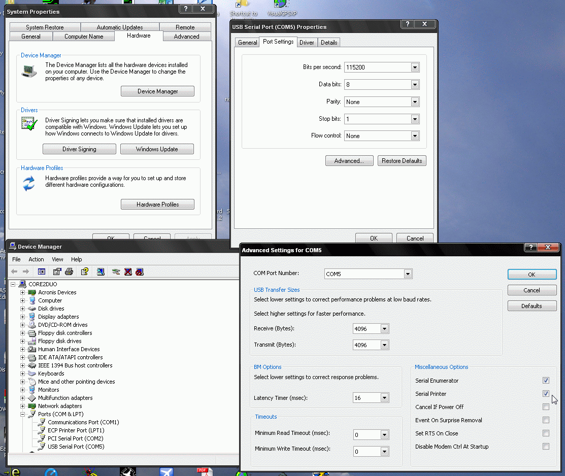

  15. tronicgr
    tronicgr
    You said the magic word... Converter. If this is a USB converter based on FTDI, you can go to the COM port settings and enable the Serial Printer option.
    I had to do the serial printer option on my Digitus USB2Serial converters to be able to get hyperterminal to work. Otherwise the hyperterminal just sits waiting to autodetect the baud rate!
    Ego is right. A photo would help us to see if something is wrong with your cabling as well.
    Regards Thanos

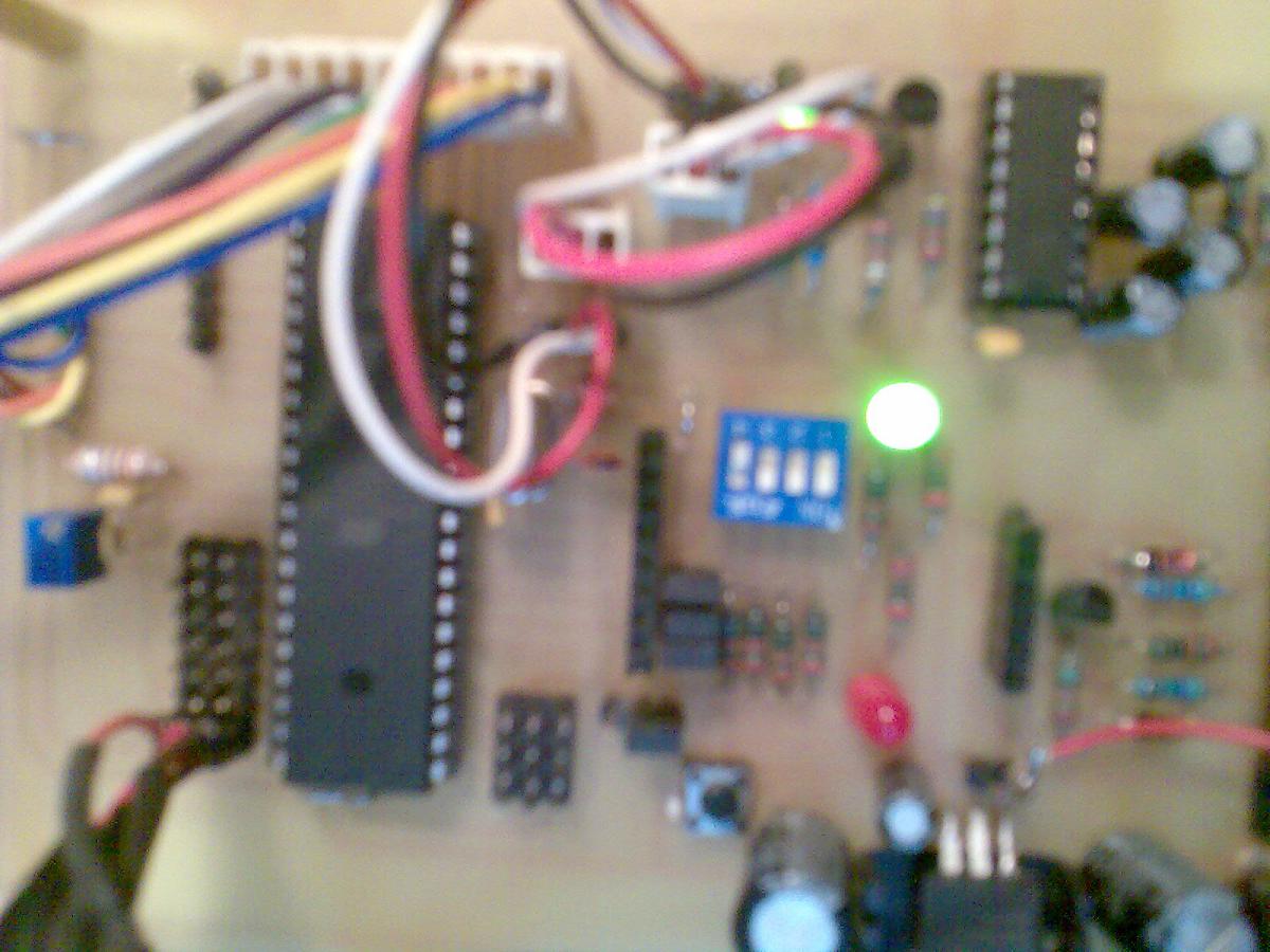

  16. Jeroen
    Jeroen DoctorXeno
    Oct 3, 2007
    120
    Holland
    - 55Coins

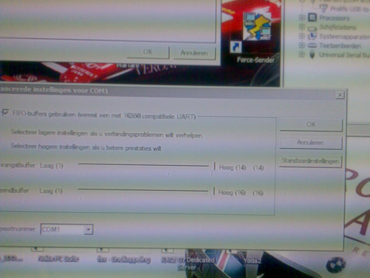

    Excuse me for the dumb question... but where can I
    find the serial printer option? You mean in windows?
    Sorry for the pics, can't get them any better.
    gr. Jeroen
  17. tronicgr
    tronicgr
    Yes its in your computer device setting:
    --> System properties
    --> Device manager
    --> USB Serial Port (COM5) (or COM1...)
    --> USB Serial Port (COM5) Properties
    --> Advanced
    --> Serial Printer box (place a tick)
    Thanos
  18. Jeroen
    Jeroen DoctorXeno
    Oct 3, 2007
    120
    Holland
    - 55Coins
    Hi Thanos,
    There is no such option or window in my vista x64...
    In the advanced window the only thing I can change is the comport itself.
    And on my other computer which runs on xp its the same.
    gr. Jeroen
  19. tronicgr
    tronicgr
  20. tronicgr
    tronicgr
    Jeroen, sorry but you have to buy a FTDI based USB2Serial converter...
    I have never used Prolific USB2serial converters, and not heard of anyone got them work with my electronics.
    If you read the SCN5 threads too, you will see that all USB-2-RS485 converters they use are based on FTDI chipset... :blush:
    Regards, Thanos
